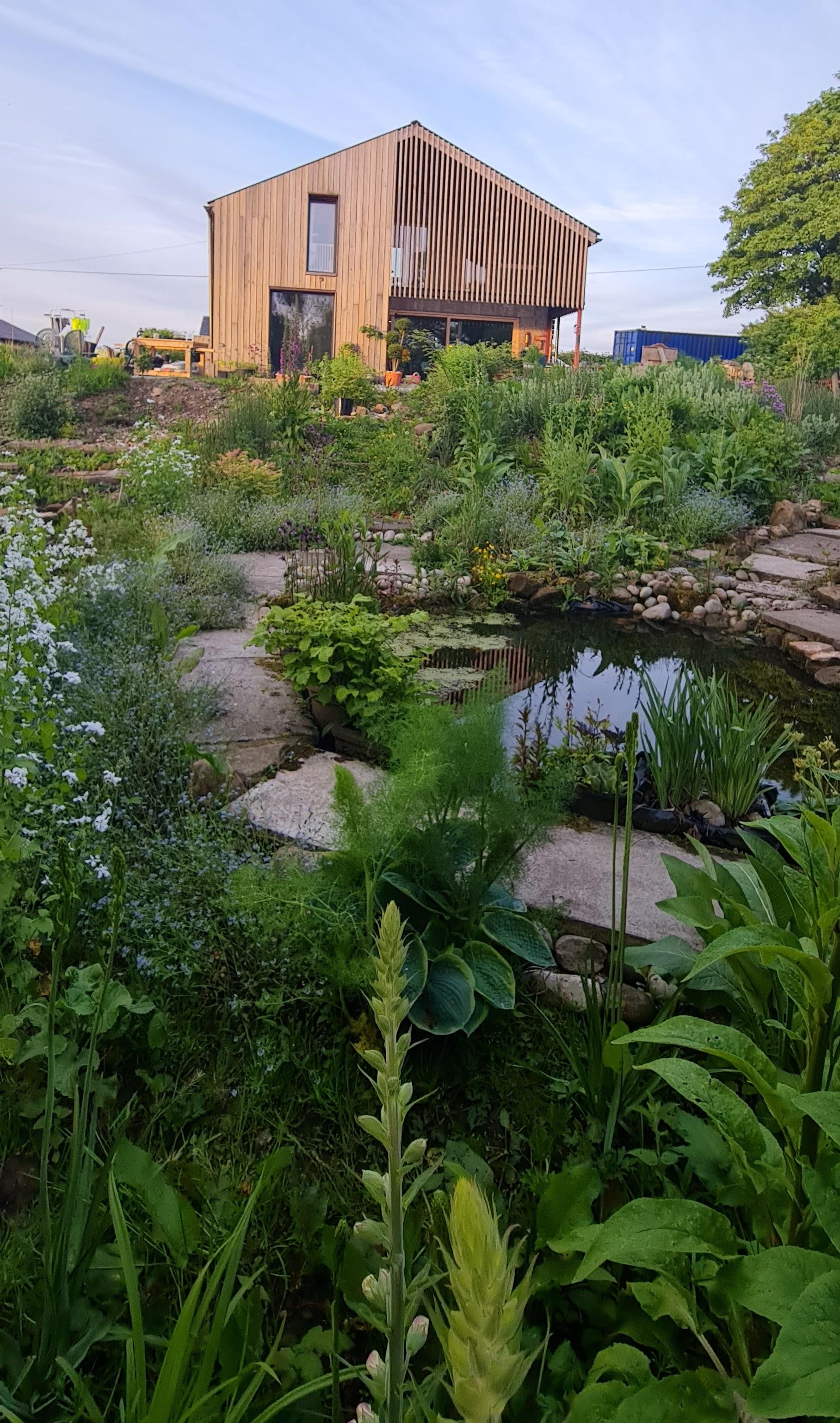

ToughButterCup Posted September 9, 2023 Share Posted September 9, 2023 (edited) 7 hours ago, carou said: ..... Building Regs now have this tank in their drawings and I'm hoping they will see that it's not necessary. Any experiences/thoughts on this please? Thats what happened to us and this - without any discussion this is the result .... The BCO could not have cared less about the SUDS stuff. I had to - or rather I made him listen to - the way all the roof water runoff is ducted to the pond via ( the yet to be built) rainwater gardens. I also took notes about the conversation and sent him a summary of what we discussed via email. Bottom line: if what you propose is anything like in line with National guidance then you needn't worry. Fill yer boots here. Good luck Ian (PS , yes, I have fallen in.) Edited September 9, 2023 by ToughButterCup 2 Link to comment Share on other sites More sharing options...
