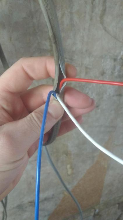

Onoff Posted September 8, 2023 Posted September 8, 2023 I just tidied the 3-core swa feeding my garage. In reality it's "3-phase" cable. For single phase use, brown stayed brown, sleeved the grey with blue and the black with green and yellow. Tbh it's pretty easy to get cable with "proper" colours. Search "single phase armoured cable". CableColoursLeaflet.pdf
Onoff Posted September 8, 2023 Posted September 8, 2023 27 minutes ago, TonyT said: Proper colours are red yellow and blue Nah, we should get all patriotic & go back to red, white and blue:
FuerteStu Posted September 8, 2023 Posted September 8, 2023 20 minutes ago, Onoff said: Nah, we should get all patriotic & go back to red, white and blue: My only concern about those wires is the grey sheath.. Isn't that the tasty oily stuff that rats love to nibble on?

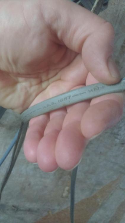

Onoff Posted September 9, 2023 Posted September 9, 2023 9 hours ago, FuerteStu said: My only concern about those wires is the grey sheath.. Isn't that the tasty oily stuff that rats love to nibble on? Polythene inslated cable with a pvc sheath to BS1557. So 3-cores, red, white & blue, no earth, Imperial 3/0.29 I think, 3 tinned strands per core equates to about 1.5mm2. It was like new. Found in a time warp, unfinished outbuilding of an elderly neighbour. BS1557 was withdrawn in 1954! 1
Mattg4321 Posted September 9, 2023 Posted September 9, 2023 Loads of that still in service in good condition! It’s rubber insulated cable you want to be careful of, especially if it’s the lead sheathed stuff! Only ever seen that still in service once in my 20+ years.
Onoff Posted September 9, 2023 Posted September 9, 2023 8 minutes ago, Mattg4321 said: Loads of that still in service in good condition! It’s rubber insulated cable you want to be careful of, especially if it’s the lead sheathed stuff! Only ever seen that still in service once in my 20+ years. Found some black rubber sheathed in one of the original walls here (<1930s). Not connected to anything but like new. There must have been some sort of preservative used in the bricks and mortar back then! I remember bundles of lead wiring in my first house (built in 1865). Still had the gas mantles on the wall. Was obviously electrified sometime after 1965. Then pulling the stuff out of the walls from the lime plaster and loads of it falling off!
