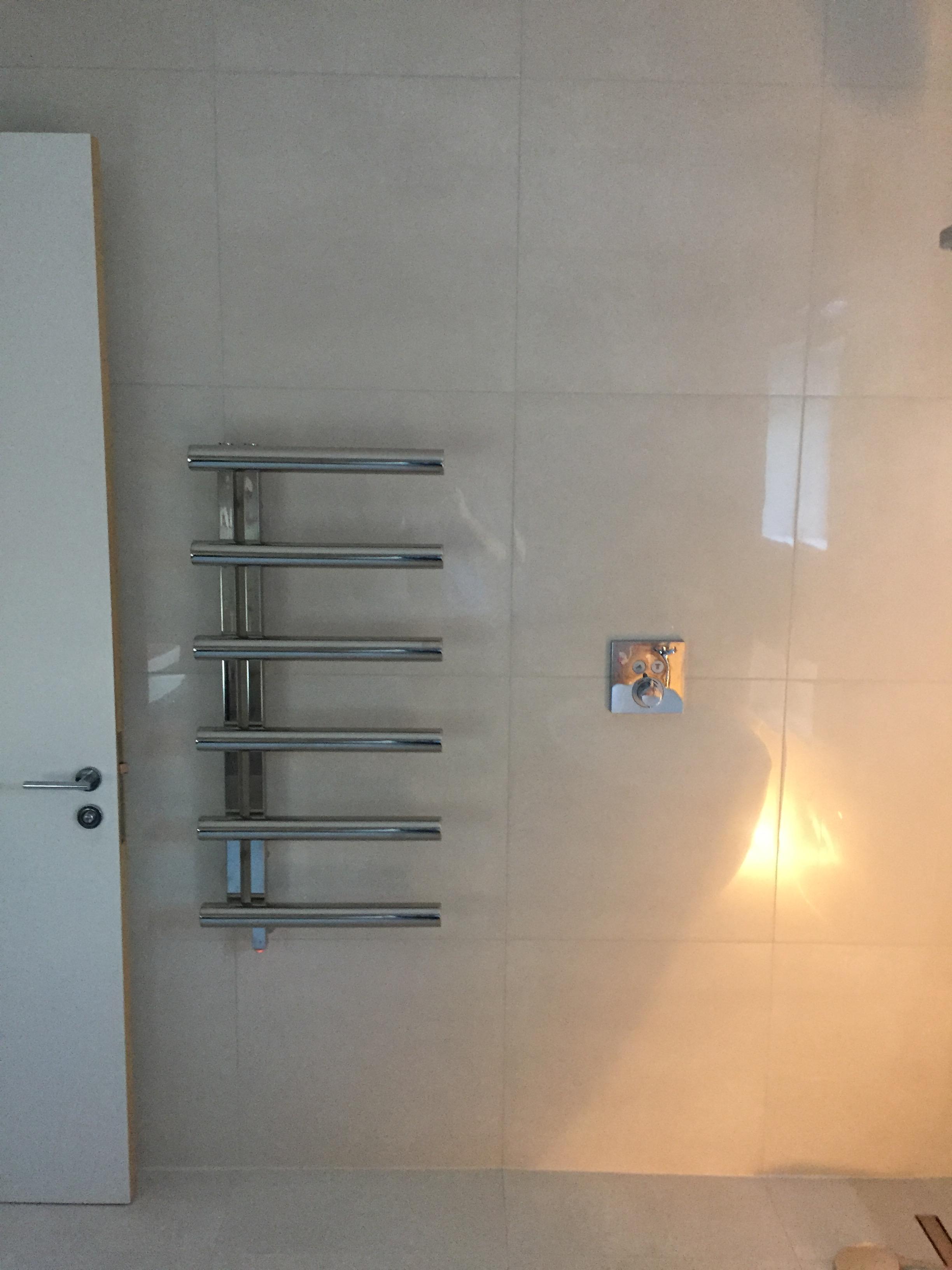

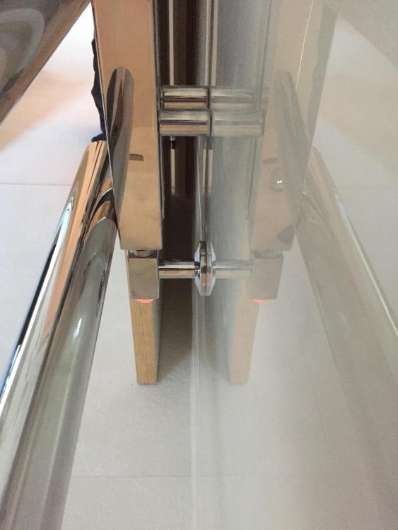

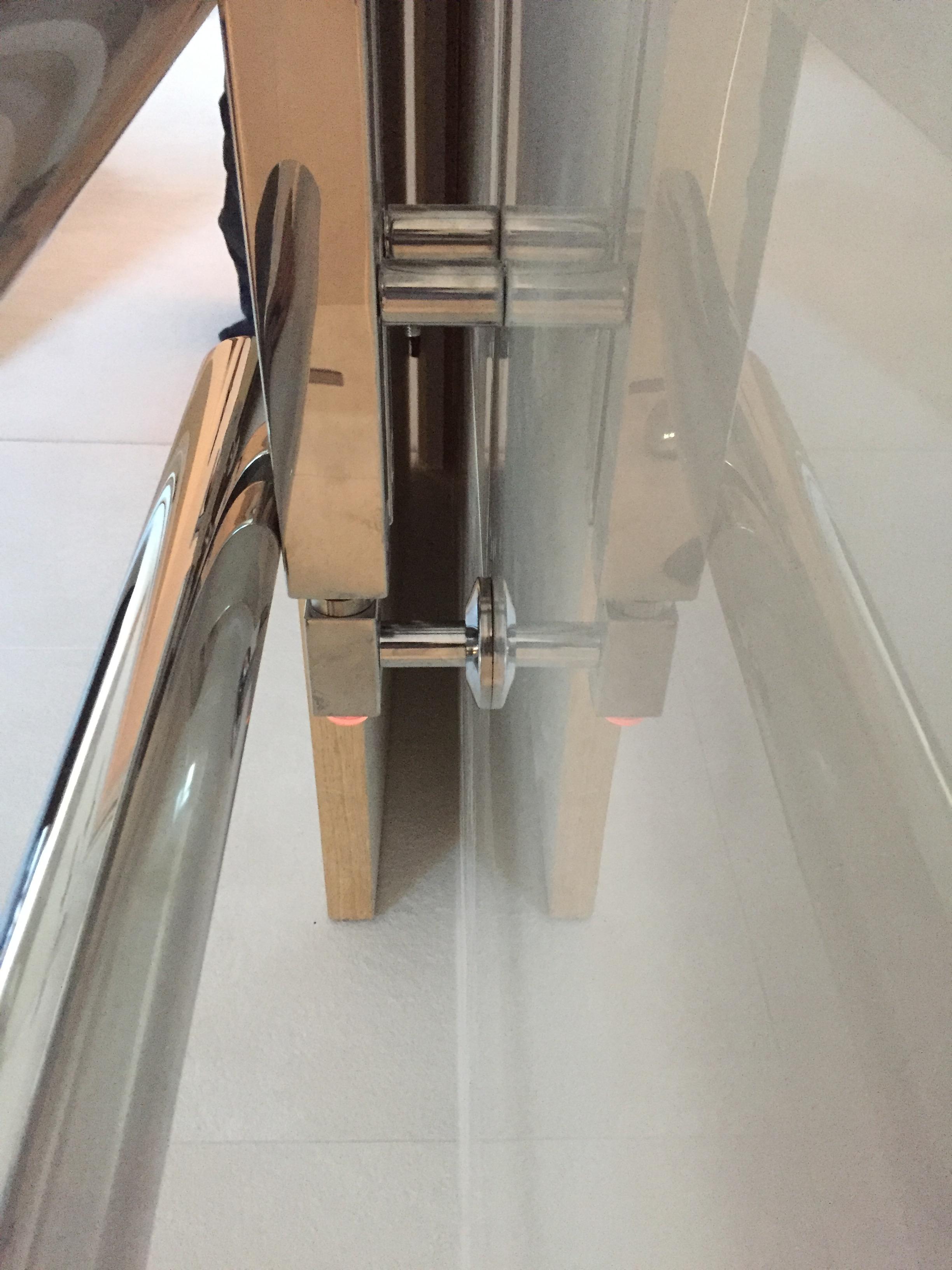

Onoff Posted August 26, 2017 Posted August 26, 2017 IP55 towel rail's are available btw. As are ones where the "flex" is hidden in the fixing bracket.
Nickfromwales Posted August 26, 2017 Posted August 26, 2017 2 hours ago, Onoff said: IP55 towel rail's are available btw. As are ones where the "flex" is hidden in the fixing bracket. The lower one is the cable transit.
lizzie Posted August 26, 2017 Posted August 26, 2017 48 minutes ago, Nickfromwales said: The lower one is the cable transit. Like your towel rail. I am just starting to look. Any recommendation for suppliers?
Nickfromwales Posted August 26, 2017 Posted August 26, 2017 @lizzie Its not my bathroom . I'm just a guy that fits these wonderful things The pics I post are from clients houses as I'm a self employed tradesmen who, one day, may get to join the lucky home builders here. That one came from a reseller, ( bathroom showroom ), but you can purchase one from somewhere like This directly. Not cheap, but it is a nice unit.
