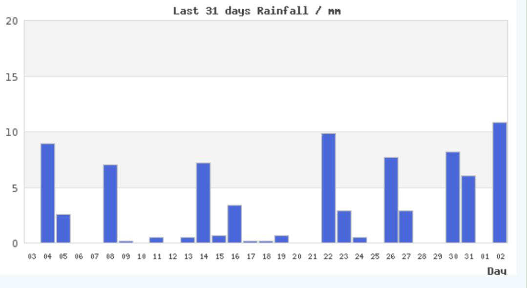

Was it exceptionally rainy today?
If so, could it be caused by a failure somewhere else i.e. gutter.

I estimate we’ve had 11mm of rain today, nothing excessive. Here is data for the last 31 days for a weather station about a mile from our house (showing 11mm there, today):
It’s not a gutter issue, as this is on a part of the roof above the gutter. In any case, I can see both gutters and neither is blocked.
