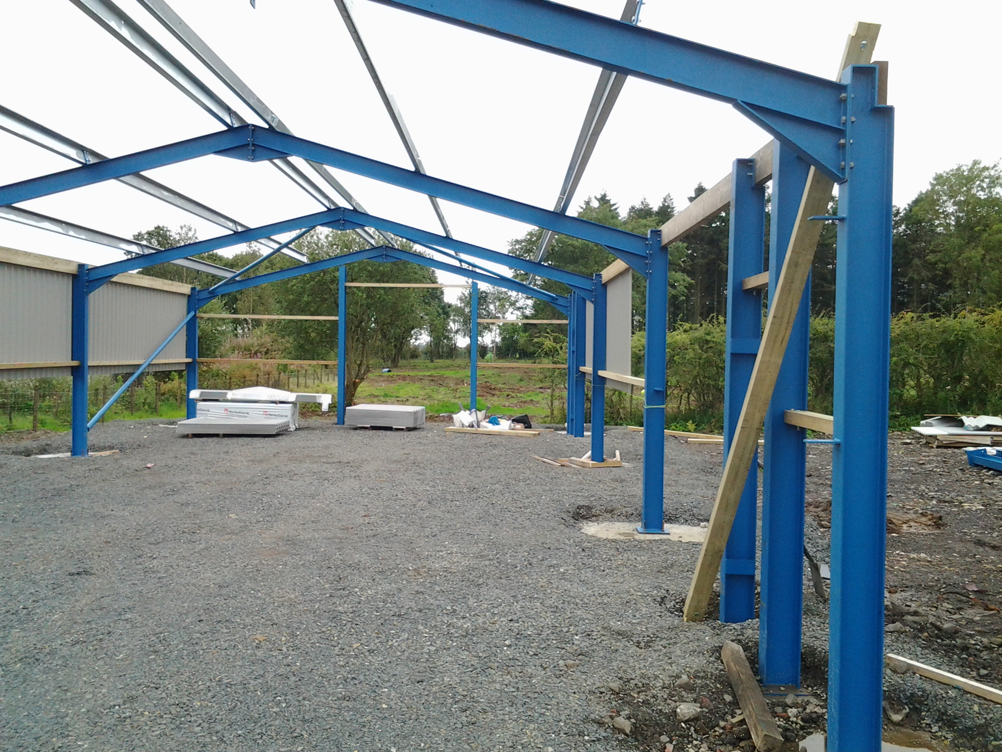

Simplysimon Posted August 21, 2017 Share Posted August 21, 2017 hi all, been off forum for a while, progress with house is slow, still waiting for building warrant and structural engineer. i have though, got started on the shed, frame up and cladding started. simon 2 Link to comment Share on other sites More sharing options...

Simplysimon Posted August 21, 2017 Author Share Posted August 21, 2017 60'x30', a big meccano kit! first one i've done and i'm quite pleased!, 'insulation' is the fibre cement roof. need a decent size to build the kit in, will end up as 2/3 stabling 1/3 workshop/garage for me. it's surprising what you can do with a tape, a water level and a merlo! simon Link to comment Share on other sites More sharing options...
Roger440 Posted August 21, 2017 Share Posted August 21, 2017 What did you do for foundations? Are they 1 metre cubes? Link to comment Share on other sites More sharing options...
CC45 Posted August 21, 2017 Share Posted August 21, 2017 I've just completed a shed like that for a mate. We dug holes and then poured a concrete base in each hole - all at the correct depth - frame then sat on these. Worked out well for us. Others bolt them down. We put around a m3 around each leg. Link to comment Share on other sites More sharing options...
Simplysimon Posted August 21, 2017 Author Share Posted August 21, 2017 @Roger440 started out at m3 but i was unhappy with condition of ground, went down 1.5m and then hardcored back up. @CC45 did you use bolt boxes/cones? Link to comment Share on other sites More sharing options...

CC45 Posted August 22, 2017 Share Posted August 22, 2017 No, we decided that the two of us were unlikely to get them in accurately enough. We dug holes and then put a level concrete base in them - the frame sat on these. We squared it up and then filled the holes in. Took 3 of us a day in total. Link to comment Share on other sites More sharing options...

Simplysimon Posted August 23, 2017 Author Share Posted August 23, 2017 shed supplier was http://www.buildings-uk.com/ they were very helpful with the details, oh and by the way, they also do metal stairs. quality of steel and manufacturing is very good. simon Link to comment Share on other sites More sharing options...
