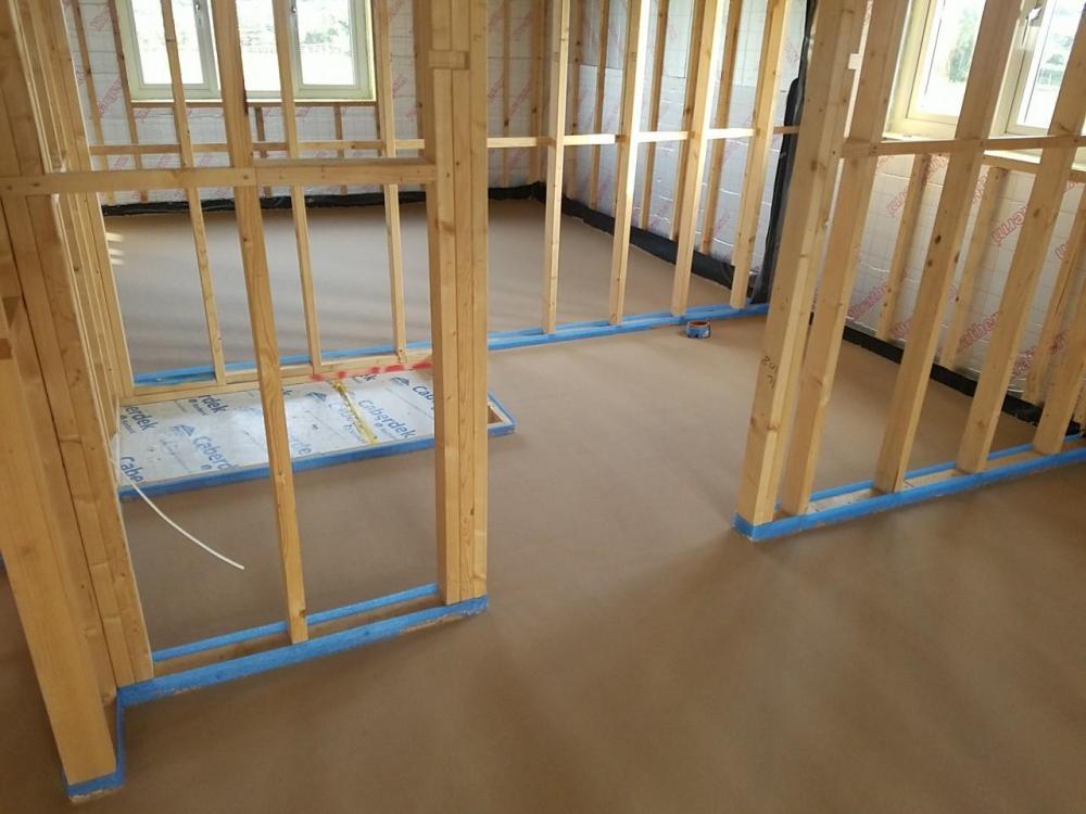

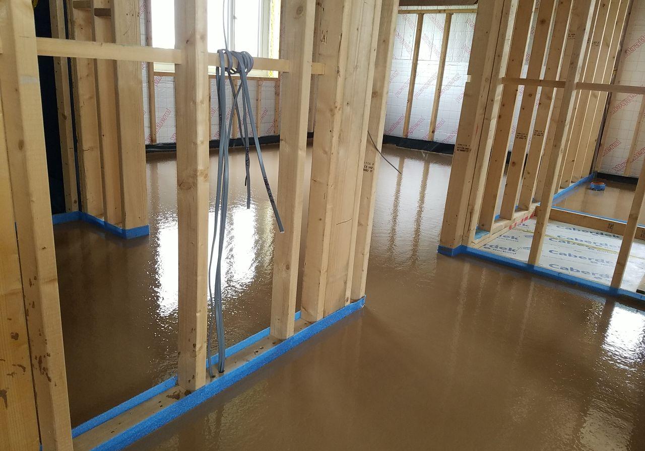

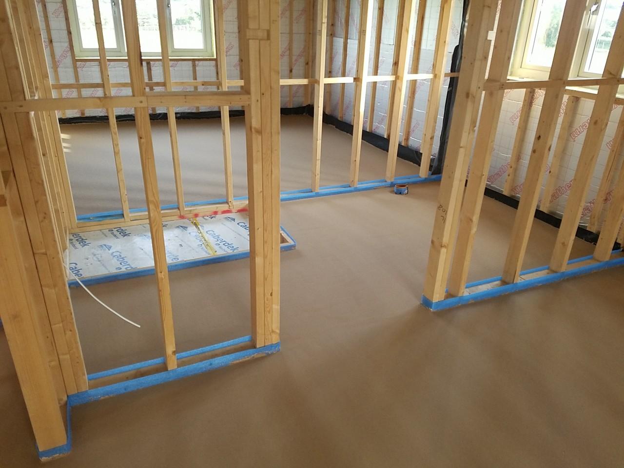

Time for another landmark. Upstairs pipe loop installed, screed poured today as planned. Remarkable stuff- I was expecting runny,  but just how coarse the aggregate in it is surprised me.

and it's set. hard. Amazing, makes quite the difference to the feel of the house. But then, ten-odd tonnes of mass will do that.
Is it self levelling?
almost. they set datum tripods and then fill to that level, before dappling the air out and moving any small amounts around to give it the best chance.

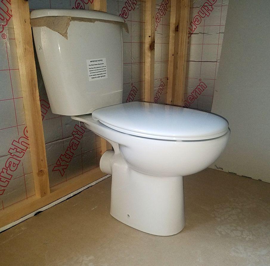

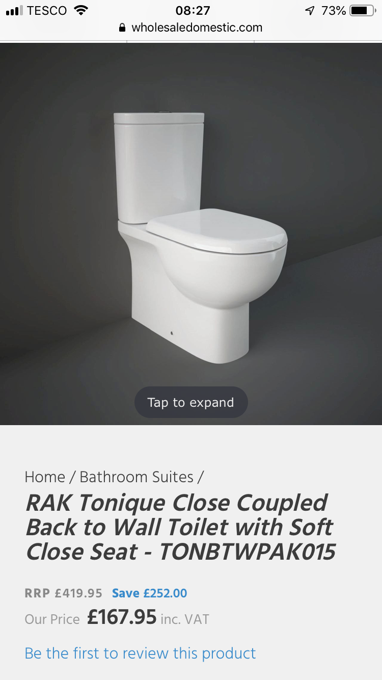

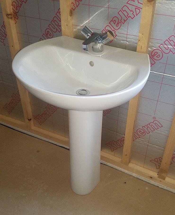

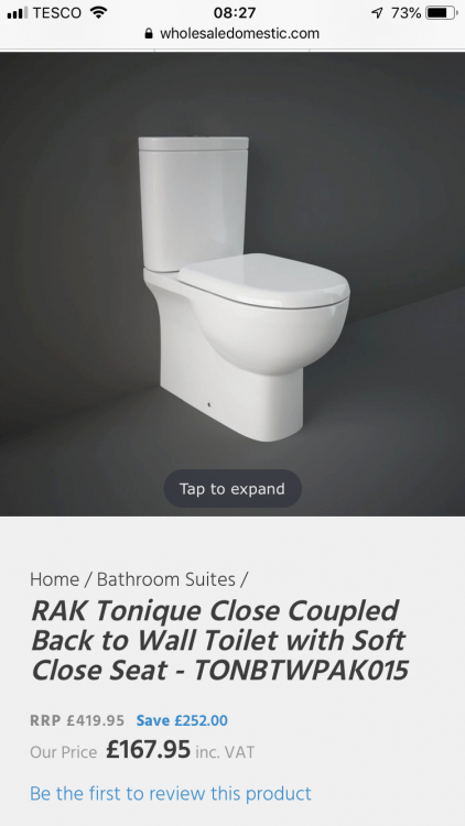

Goodies. Haven't unpacked the bath fully yet, but it's a big'un, a 1400 symmetrical corner. Threw some ceramics together for a look-see, as I hadn't actually seen them in the flesh prior to purchase. Lecico Atlas Smooth, we have a Lecico suite currently and I've no problem with the quality, this range has the look we wanted (SWMBO wanted a classic round bowl but with no hard-to-clean external detailing) at a nice price-point
I fitted a sink very similar (Homebase) but put the wc like that back in the box and went wall hung.
Much nicer to look at and easier to clean.....or so I'm told!
A fiver says you fit a bog roll holder before I do! ?
Edited by Onoff
neither back-to-wall nor wallhung were acceptable domestically. And I'm all for an easy fit *and* easy life. So bog-standard (sic) it is for us.

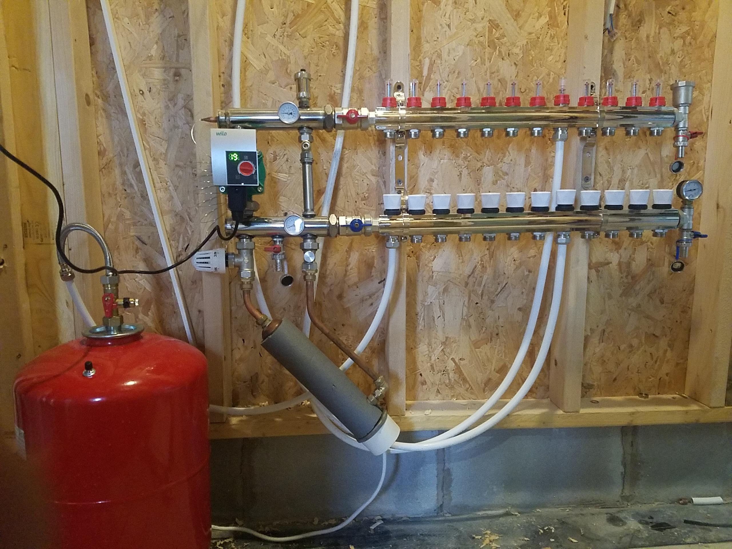

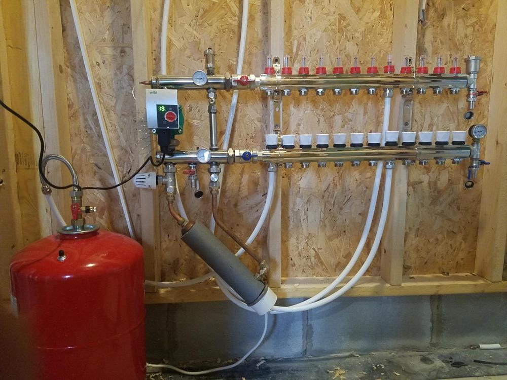

Got tired of using fan and halogen heaters.  So plumbed a Willis into the main manifold and got some circulation to the upstairs loop, which covers the landing/balcony, the big bathroom, and the ensuite. I couldn't quite get enough flow through the willis just by closing the bypass over so it's duty cycle was a bit low; conveniently I was able to set a length of 15mm copper into the end of the bypass pipe (vertical, to the right of the pump )to force flow down into the cold end of the immersion. Much Better. Got the loop up to 23c return temp today and the house did feel a lot warmer for it.

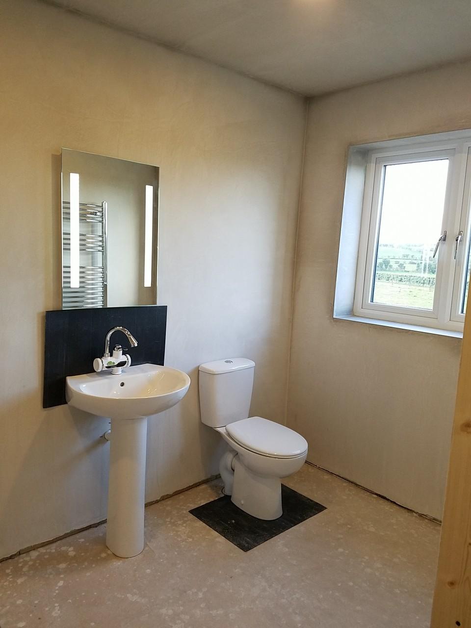

just the door to hang now. A touch more civilised than a site loo, yes?
what dat blue stuff sticking up from floor?
Perimeter expansion strip isn't it?
ta, mate got a load left after having an extension done; now I know I can use it ?

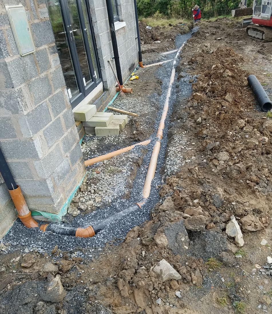

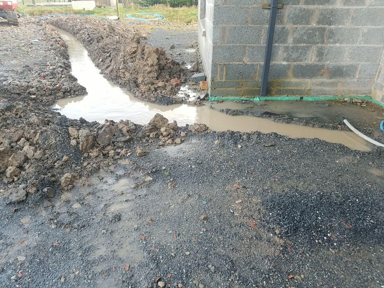

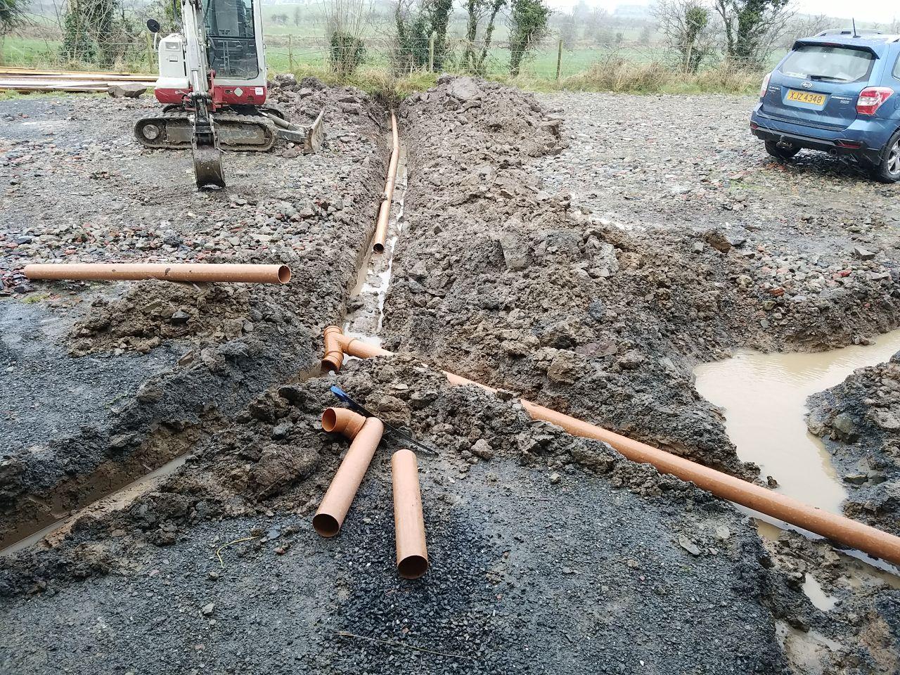

More progress today, more milestones. Paul was down bright and early (freezing!) and by the time I called down for the morning update he'd cut a fine-looking trench out the front to let the front downspouts and future ACO run straight out to the open field drain.
...which dealt nicely with the weekend's problem. The trench dug for the mains water drained into it.
We then brought the water into the house, dropping from the long 32mm down the lane to a 25mm at a toby, so we've local isolation. Sent me up the lane to turn off, and them promptly made the joint live before I had a chance to even get the screwdriver out of the car. Phone line is in alongside it.
For completeness, here's the rear and right rainwater drainage, with a rare sight on Sandy, in the trench, trying not to lose her wellies to the clay. All the foul works sit on top of this pretty much so we'll need a few loads of rubble now to build levels up past them. No piccies of the foul yet, must do that for my records.

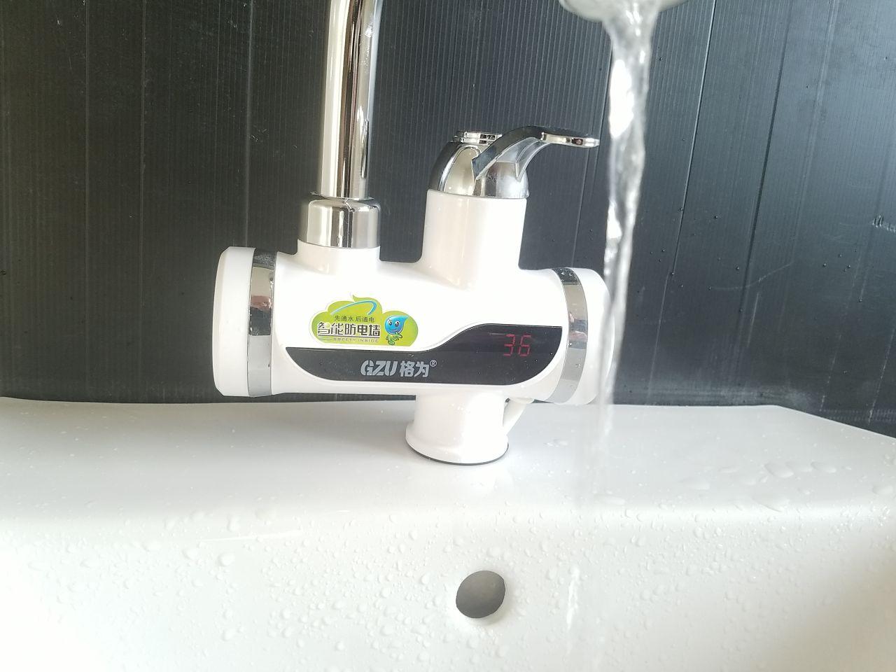

And the final result? Loo flushes, and Chinesium hot-water tap works. Bought on a whim but it's actually a pretty smart item. I stripped and checked it for all the usual Chinese failings. Metal clad element, earth wire connected to it, overtemp and underpressure control. Super.
