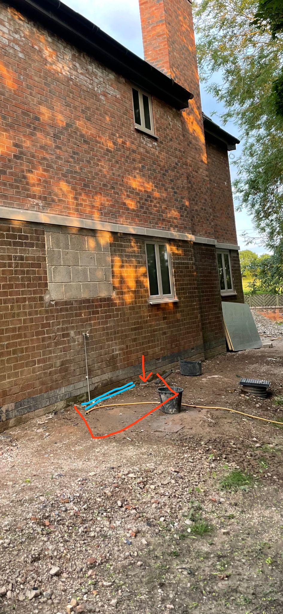

richo106 Posted July 5, 2023 Posted July 5, 2023 (edited) Hi All I need to install an ASHP base and was planning on doing this out of concrete so it’s nice and solid. Also was going to make it 200mm wider and longer than the unit to give it 100mm overhang all round…is this enough? Or overkill? What would be a typical build up of a base for ASHP? (weight approx. 140kg) I have attached a picture of the side of my house and a badly drawn sketch of where it’s going. The red arrow indicates where my soil stack is going. The ASHP installer suggested an Aco drain at the back up against the house connected into the soil stack so all the waste water can run into that? Also I was planning on the base to be level with 1 brick down from top of blues? Any reasons why to make it up to blue level or does it not matter at all? Any advice/better ways to do it very welcome as always Edited July 5, 2023 by richo106

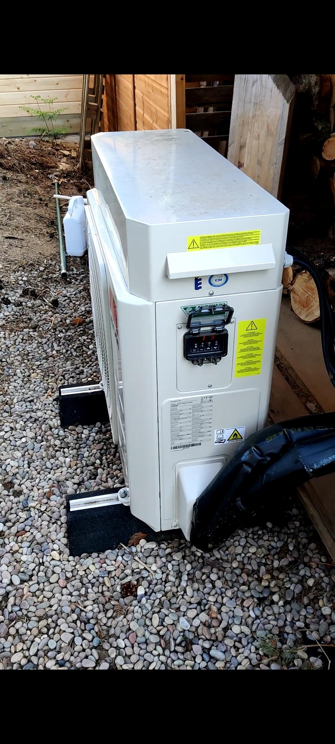

JohnMo Posted July 5, 2023 Posted July 5, 2023 Mine is just sat on gravel, with 600mm deep rubber feet. Seems happy enough.

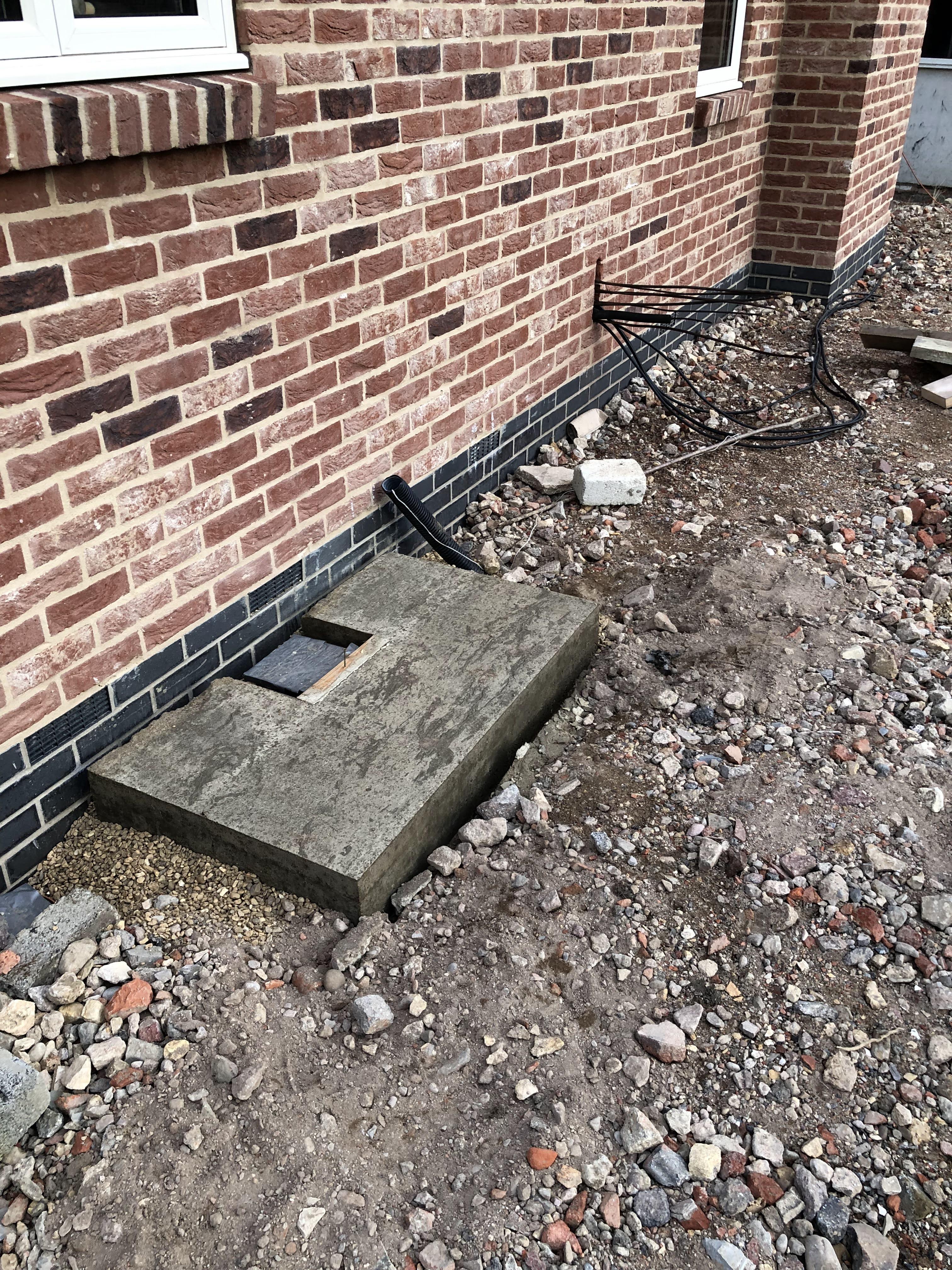

crispy_wafer Posted July 5, 2023 Posted July 5, 2023 here's mine, poured yesterday so still green, polythene covered it when it rained so a little rippled in places but itll do. I've got rubber mounting feet for the ashp aswell. Gully in the middle for any condensate to run into, needs an extension/riser piece to make it flush when I get round to picking one up.
richo106 Posted July 5, 2023 Author Posted July 5, 2023 Thank you all I’ve been having a think, and decided to go with a concrete base as originally. It’s down the side of my house that’s out the way any. @crispy_wafer what is your build up? Hardcore? 100mm concrete? Wood shuttering?

crispy_wafer Posted July 6, 2023 Posted July 6, 2023 On 05/07/2023 at 21:43, richo106 said: Thank you all I’ve been having a think, and decided to go with a concrete base as originally. It’s down the side of my house that’s out the way any. @crispy_wafer what is your build up? Hardcore? 100mm concrete? Wood shuttering? Expand Crushed concrete buildup is very deep on that side, all whacked down so didn't bother with anything else under it. Knocked up some shuttering from 6*2, bits of it in the background of that pic, screwed where I could still get to them to undo once the concrete started going off. Sits about 50mm from the wall, with a slight fall to the front. Approx 2 bags of cement used and a 3-4 barrows of ballast. As @Bonner says check the minimum clearances, I got too excited about playing with the mixer and forgot 🤫! But 300mm is needed for mine, which puts it just over the centre line of that slab so It'll be fine.

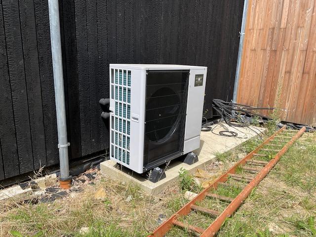

ProDave Posted July 6, 2023 Posted July 6, 2023 Two paving slabs. The place it sits needed building up a bit, so a good place to uses up some rubbble , wacker it all down, sand, wacker that again, level it and lay the slabs. It's been there about 5 years no problem. The heat pump is slightly longer than the 2 slabs but at least the feet sit on the slabs okay.
saveasteading Posted July 6, 2023 Posted July 6, 2023 Firstly I would assume that the fitters haven't read the instructions on position, so a concrete slab will make them set it off the wall. See instruction manual for position. For all the cost difference I wouldn't use slabs or just gravel. I wouldn't risk any imbalance when the fan is running. Also they have to fix their rubber feet down. Concrete will be a solid fix. As above, leave a gap to the wall and fill with gravel

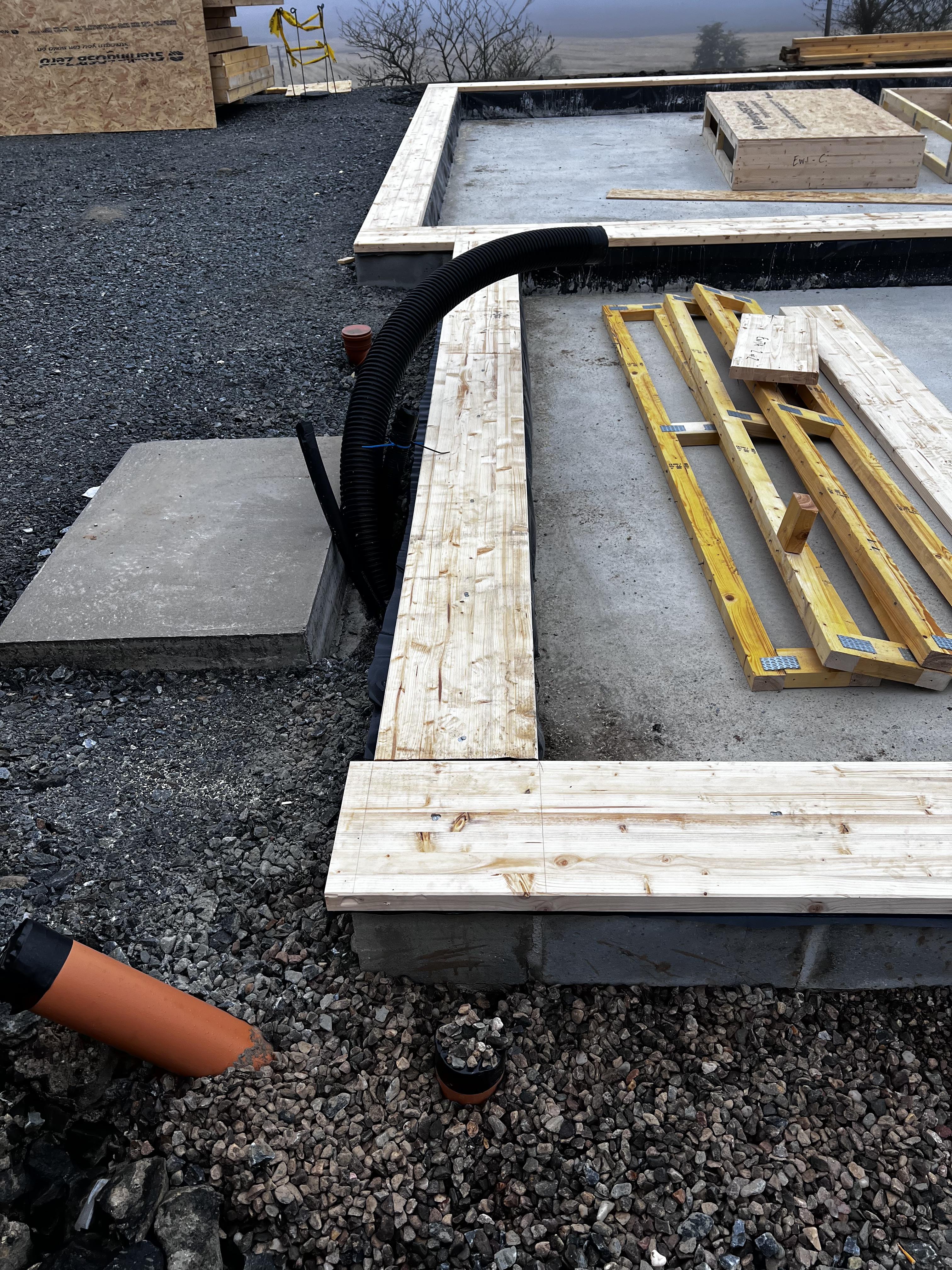

Thorfun Posted July 6, 2023 Posted July 6, 2023 On 05/07/2023 at 21:43, richo106 said: Thank you all I’ve been having a think, and decided to go with a concrete base as originally. It’s down the side of my house that’s out the way any. @crispy_wafer what is your build up? Hardcore? 100mm concrete? Wood shuttering? Expand that's what I did. with room for the A/C unit next to it (yet to be fitted)
