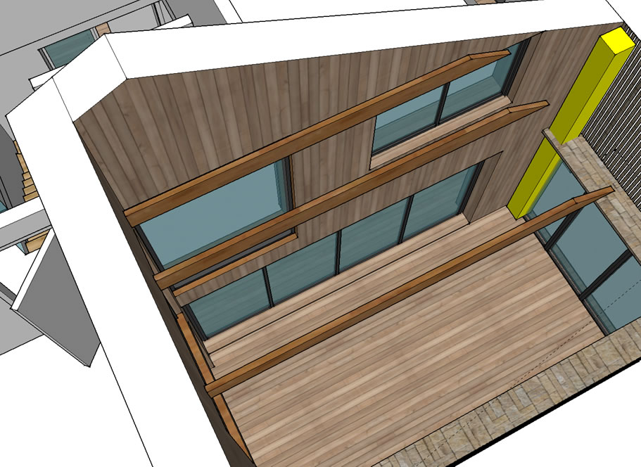

ToughButterCup Posted August 17, 2017 Share Posted August 17, 2017 Have a look at this; This is a view into our Winter Garden from way above the roof. The yellow column represents (way out of scale) one of three vertical steels, each of which supports horizontals which in turn support the barn-style cladding. For clarity, I have omitted the other two verticals and all the horizontals. The winter garden is an empty area, outside the heated envelope (see the slats allowing air to circulate) The steel structure is linked to the house : how is my question? We could drill into the ICF and bolt it on that way or we could embed anchors in the ICF and drill the steels to suit on site The first is messier than the second. There is no guidance from the SE (Tanners) on how we should marry the house ICF and the Steels. But, (I have learned to ask), how hard can it be? I mean we could just pop down to Halfords and buy some cheap M6 nuts and bolts eh?........ well perhaps not. Link to comment Share on other sites More sharing options...
MikeSharp01 Posted August 17, 2017 Share Posted August 17, 2017 (edited) Interesting Ian. I guess you don't need to worry about cold bridging so as long as you get the anchors well into the concrete core of the ICF that should do it.Do the three steel columns form a stand alone structure? (IE would it stand up without the walls or are the walls doing the racking work I wonder). If not stand alone then fixing might have to be done through two sides (at 90deg) so you have racking strength transferred to the steels in two plains. Edited August 17, 2017 by MikeSharp01 Typo Link to comment Share on other sites More sharing options...
PeterW Posted August 17, 2017 Share Posted August 17, 2017 I'd want to embed a T plate into the ICF with it being secured to the concrete and the rebar. This would have 4 No. M16 studs welded to it and then make a template for drilling the corresponding holes into the vertical steel when on site. The plate means you get it perfectly plumb with the lower plate and also stops the steel trying to compress the ICF and ensures everything stays plumb. Link to comment Share on other sites More sharing options...

ToughButterCup Posted August 17, 2017 Author Share Posted August 17, 2017 29 minutes ago, MikeSharp01 said: [...] (IE would it stand up without the walls or are the walls doing the racking work I wonder). If not stand alone then fixing might have to be done through two sides (at 90deg) so you have racking strength transferred to the steels in two plains. Forgive my lack of understanding.... racking? Link to comment Share on other sites More sharing options...
ToughButterCup Posted August 17, 2017 Author Share Posted August 17, 2017 30 minutes ago, PeterW said: I'd want to embed a T plate into the ICF with it being secured to the concrete and the rebar. [...] Let's say the worst comes to the worst and we have to pour (Tuesday and Wednesday of next week - architect's on holiday and so is Tanners) without a decision on placing T pieces inside the ICF . Could we 'bolt it on' (the Wintergarden) from the outside? For the sake of interest I attach the Briefing Pack I prepared for expressions of interest in doing the steels and the cladding WinterGardenBriefingReducedSize.pdf Link to comment Share on other sites More sharing options...
MikeSharp01 Posted August 17, 2017 Share Posted August 17, 2017 12 minutes ago, recoveringacademic said: Forgive my lack of understanding.... racking? Oooooops.... If you had a square made of four bits of timber with a nail at each corner you could squeeze it quite easily into a diamond shape - that is racking. If you put a diagonal across the square, nailed at each end, it becomes two triangles and suddenly it is much stiffer you won;t be able to deform it to a diamond without bending or breaking it - so the diagonal gives the structure racking strength. Your steels, uprights and horizontal members are in effect the square. Once you fix them to the wall the wall effectively becomes the diagonal member and makes the structure stiffer. It may be that the SE has already specified diagonal members in the steel frame in which case the wall is probably not needed to do the racking unless they have designed the cross braces to do half the racking strength work and the wall the other half - which I doubt. Link to comment Share on other sites More sharing options...

PeterW Posted August 17, 2017 Share Posted August 17, 2017 If you had to you could bury an offcut of RSJ (254x133 would work) on its side with the plates in line with each other and then bolt the steel to that. Link to comment Share on other sites More sharing options...

mvincentd Posted August 17, 2017 Share Posted August 17, 2017 Time short so might have misunderstood but; With your drawings do you have one or two entitled 'structural notes' maybe....which might have a section on 'steelwork', subsection 'connections'. Mine say for example; "All connections to comprise 4 no' m20 (8.8) bolts unless noted otherwise". Then on my plans it'll just say "steel beam to be face fixed to concrete"....otherwise they're sitting in beam pockets which have individual detailed drawings for how they're cast. Link to comment Share on other sites More sharing options...
