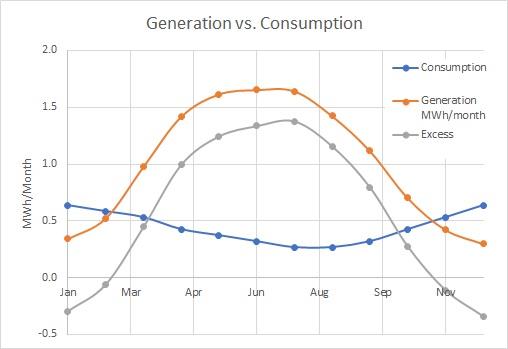

DevonBarn Posted June 22, 2023 Author Share Posted June 22, 2023 @SteamyTea 16MWh would definitely be preferable, I'll put that into the PVGIS later. I guess everything is 'off grid' down there. Thanks @Conor and @Thorfun I need to reassess annual demand, especially if 30kW system isn't possible and we need to make do with single phase. Link to comment Share on other sites More sharing options...
SteamyTea Posted June 22, 2023 Share Posted June 22, 2023 23 minutes ago, DevonBarn said: 16MWh would definitely be preferable, I'll put that into the PVGIS later. That is just space heat average (guessed). Some houses can easily use the same amount for everything else. 25 minutes ago, DevonBarn said: I guess everything is 'off grid' down there It is when you lot bust the railway line. 26 minutes ago, DevonBarn said: reassess annual demand I assume that you already have a place, so you could use your current usage as a starting point. To get a rough idea if what the space heating loads are, just model the place on floor, roof and wall/window/door areas, then use the TMY figures from PVGIS to get your local temperatures. 1 Link to comment Share on other sites More sharing options...

AliG Posted June 22, 2023 Share Posted June 22, 2023 I think the idea that summer excess PV pays for winter use is not the right way to think about things. The main reason being is that it doesn't take not consideration the £30,000 spent on the system. You can clearly get to a point where you have no actual bills to pay, but if you spend an excessive amount of money to get there you haven't really "saved" anything. I also would not base any calculation on the current Octopus 15p SEG payment. Wholesale prices continue to fall, the current spot price of electricity i around 10p/kWh. The price cap will fall in July and I would not be surprised to see the export price fall also. Once we are through the current Ukraine inflated period I would expect export prices to settle into the 5-10p range. The more PV there is installed, the more likely it is that there is an excess of PV in the summer and less is paid for it. You need to heat hot water, heat the house and obtain electricity whether by buying it or generating it yourself. In general you want to size a PV system so that you can self use as much of the output as possible, batteries can alter this calculation, but tend to currently be quite expensive. You will probably need around 5kWh per person per day for hot water. Assuming 4 people in the house that is around 7000kWh per year. Without knowing your exact insulation levels, using U-values of 0.15 for the walls, and 1ACH with 100sq metres of windows with 1.1 U-value I get around 22000kWh of heating requirement per year. With a temperature of 0 outside you would need an instantaneous heat input of 6kW and at -5C you would need just over 7kW. This plus hot water requirements would drive the size of your heating system (ASHP probably). So a few calculations. Let's keep it very simple. You need 30kWh a year of heating. Assuming that the average cost of this is 20p/kWh (e.g. with some time shifting and falling prices) then this would cost £6000 a year using direct electrical heating. If you used an ASHP with a COP of 3 it would cost £2000. ASHP pricing I think is often overstated. If you installed an electric boiler you would still need pipework, hot water tank etc. The extra cost of an ASHP compared to a gas or direct electric system is probably around £8000. An ASHP based wet heating and hot water system will cost maybe £15000. An electrical system with hot water tank (I'd say house is too large for a combo) might cost around £7-8000. These ar very rough guesses. So for an extra £8000, you would save £4000 a year at current prices, a great investment. The saving might fall to £2-3000 as electricity prices normalise. It is an absolute no brainer. So how much PV would be reasonable? You are going to need 7kWh per day for hot water via the ASHP, maybe a bit more with tank losses etc. I don't know your background use of electricity for fridges etc, but assume around 15kWh day of general electricity usage. These total to 8kWh/year. Now where you live an 8kW system might generate that much electricity but it is very skewed to the summer. Using @Alan Ambrose numbers above an 8kW system would generate around 25-30kW per day in the summer, so already more than you would be using, and you would need a battery to use all of that as some of the use would be at night. But say with this size of system you could utilise 70% of your yearly generation, very little would be wasted as peak production is not much more than normal use. You would be saving around £1680 a year at July 1 prices (5600kWh at 30p/kWh) plus receiving around £360 in payments (likely to fall soon). So a £10,000ish system would generate around £2040 a year in benefits. Now let's double the size of the system,, say 16kWh, costing £18,000 (assume some scale economy). You generate 16000kWh. You self use 50% of the electricity at 30p and export 50% at 15p. That is around £3600 on a £18000 investment (Maybe more if you have to install 3-phase). However, this is all based on recent electricity prices. Pre Ukraine war I was paying just over 12p/kWh and export prices were around 4p. Current spot electricity prices are around 10p (you have to add quite a bit to this to get the retail electricity price). Based on the current futures market I believe that a good price to use is 20p/kWh in the long run and 10p for exports. However, I think there is a good chance of a massive slump in prices if the Ukraine war ends and we can buy Russian gas again. There will be massive oversupply and prices will collapse. Using these numbers would reduce the returns of your system by around 1/3. Still good double digit returns. If however, you installed such a large system that you exported 70% of your generation I would be worried. In reality I doubt you would get permission for such a large system, so fill your boots and install as big a system as you can assuming that you are paying a reasonable price. (say £1200/kW installed). I was quoted more like £1500/kW for my parents' house on a small system that would generate less so it was not worth it. They also hardly use any electricity during daylight hours, so self consumption would be low. Link to comment Share on other sites More sharing options...

DevonBarn Posted June 22, 2023 Author Share Posted June 22, 2023 Thanks @AliG so this getting into the detail - that link in my first post is really good, goes into the details re: location/angles/temps everything so I'm pretty confident on what output we could expect on any given kW system. You're right it's entirely dependent on import/export prices, but like you say even if there's a large change, it seems to be about 50% export to import price, so you still need to generate the same in the summer to cover the winter, probably. If we're installing PV and all the gubbins really we should be installing as many panels as we're allowed to.. so @Rob99 I'll find out about 3 phase costs. I need to get more quotes in so we're not shooting in the dark, (just had a quote in for GSHP supply only £25k, and that's without digging the 1.2m trench?!). I'm speaking to a ASHP company tomorrow I'll update the thread. Also @HughF thanks for the suggestion, Multi head mini-split does look like a good and easy additional option Link to comment Share on other sites More sharing options...

Alan Ambrose Posted June 22, 2023 Share Posted June 22, 2023 >>> actually with respect the aim isn't to use less energy, it's to generate as much as we use (in £) OK I see - so the grid power you use in the winter, you're planning to pay for with exported power in the summer. Makes a certain amount of sense. So you'll be 'net zero' electricity over the year. Probably not the most economic set-up though ... you can take a stab at calculating the benefit of each incremental panel - either as actual calculations/estimates or just in concept. The first panels get great payback, the last panels get fairly marginal payback. Panels are not that expensive though - so if that's want you want, there's no reason why not. Link to comment Share on other sites More sharing options...
