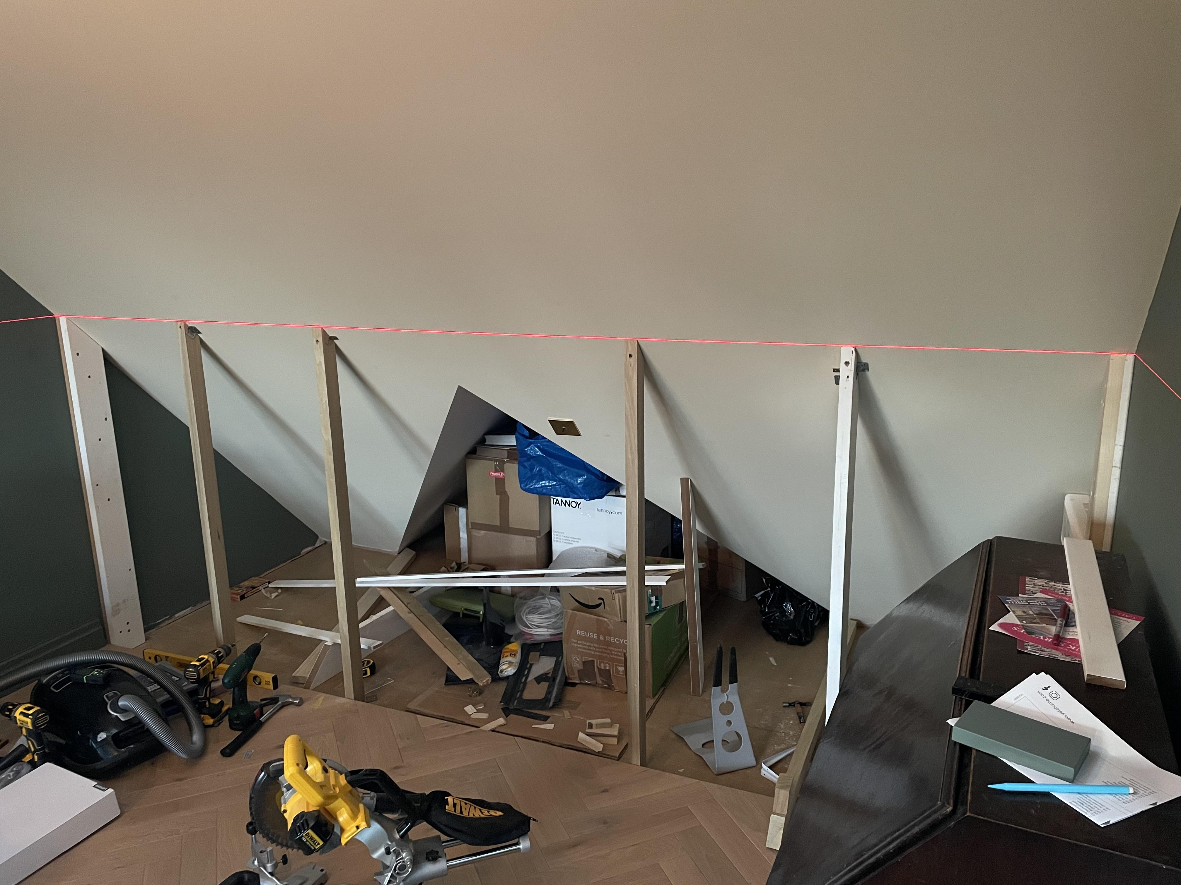

Adsibob Posted May 26, 2023 Author Posted May 26, 2023 11 hours ago, Lofty718 said: This is interesting, I was also planning to try and make some built in wardrobes out of MDF. Any photos of your progress so far? Yep. My relative bought me a laser level. Made the job so much easier: 2
Adsibob Posted May 26, 2023 Author Posted May 26, 2023 (edited) You can also see the DeWalt mitre saw on the floor. This was lent to me by the same family member who supplied the laser level. The main posts are now all in, I just need to order the spray painted MDF doors and fit them. I May also put some additional posts in towards the back of the attic nook so that one or two of the cupboards can have shelves in them. Edited May 26, 2023 by Adsibob
Adsibob Posted May 26, 2023 Author Posted May 26, 2023 (edited) So I need to order my doors. I will hang six doors, one from each of the six posts in the photo above, and I want them to go floor to ceiling. The height from the FFL to the laser line (also in photo) is exactly 1266mm for all posts except for the ones attached to the walls. The left hand wall post is 1264mm and the right hand wall post is 1270mm. There will be a 4mm gap between doors (the posts will therefore be visible, but they will be painted same colour as the doors). Will a consistent door height of 1256 work? I have taken the lowest post height of 1264 and then subtracted 8mm to allow clearance for the doors to open. But I’m wondering if this will give me clean horizontal lines top and bottom? Other option is to go for 1258 which is 1266 (ie the height of 4 out of the six posts) subtract 8mm and accept that the left most door will only have 6mm of clearance between it and the floor and the right hand post will be a bit more visible. doors are going to be 18mm thick MDF, and a bevelled 45 degree back edge along the top to fit nicely under the sloping ceiling (although this is closer to 47 degree slope). Edited May 26, 2023 by Adsibob
Russdl Posted May 26, 2023 Posted May 26, 2023 (edited) Can you make 1220mm doors work as that is the width of a sheet of MDF, at 1250+ there will be lots of waste and more expense I suspect. A thin strip across the top of the doors of 30-40mm would let 1220mm doors work and may give a neater finish. Edited May 26, 2023 by Russdl Added a bit. 2

Adsibob Posted May 26, 2023 Author Posted May 26, 2023 2 hours ago, Russdl said: Can you make 1220mm doors work as that is the width of a sheet of MDF, at 1250+ there will be lots of waste and more expense I suspect. A thin strip across the top of the doors of 30-40mm would let 1220mm doors work and may give a neater finish. That’s an interesting thought, I will check with the door supplier.
TonyT Posted May 26, 2023 Posted May 26, 2023 Might have been better to screw a timber plate to the angled ceiling then fix the vertical timbers and similar wall plate just like making a partition looks a bit thin on substance.
Adsibob Posted May 26, 2023 Author Posted May 26, 2023 (edited) 37 minutes ago, TonyT said: Might have been better to screw a timber plate to the angled ceiling then fix the vertical timbers and similar wall plate just like making a partition i thought about that, but I would have needed to cut a 3.3m length of timber diagonally, and at the time I didn’t know mitre saws existed. I thought about buying an arris rail but even then the angle wouldn’t have been exact. 37 minutes ago, TonyT said: looks a bit thin on substance. I think it’s strong enough. All but one of the uprights are made of tulipwood, 38mm by 58mm. The one exception is MDF bound in a resin primer, which is 32mm by 125mm. Each upright is fixed at six points: three metal brackets at the bottom end; and two metal brackets and a screw that goes through the tulipwood and then into the ceiling at the top end. They aren’t carrying much weight as it’s just 18mm MDF doors. I’m sure there are better ways of doing this, but I’m just a novice DIYer, impressed that I managed to get everything pretty straight! I did ask my builder to do this (when I learned, to my surprise, that it wasn’t included in the original contract) but he wanted money I didn’t have. So I’m leaning as I go. Do others really think it’s not strong enough? if so, should be quite straightforward to add battening in between the uprights to strengthen the frame; I’m just not sure it’s necessary. Edited May 26, 2023 by Adsibob
