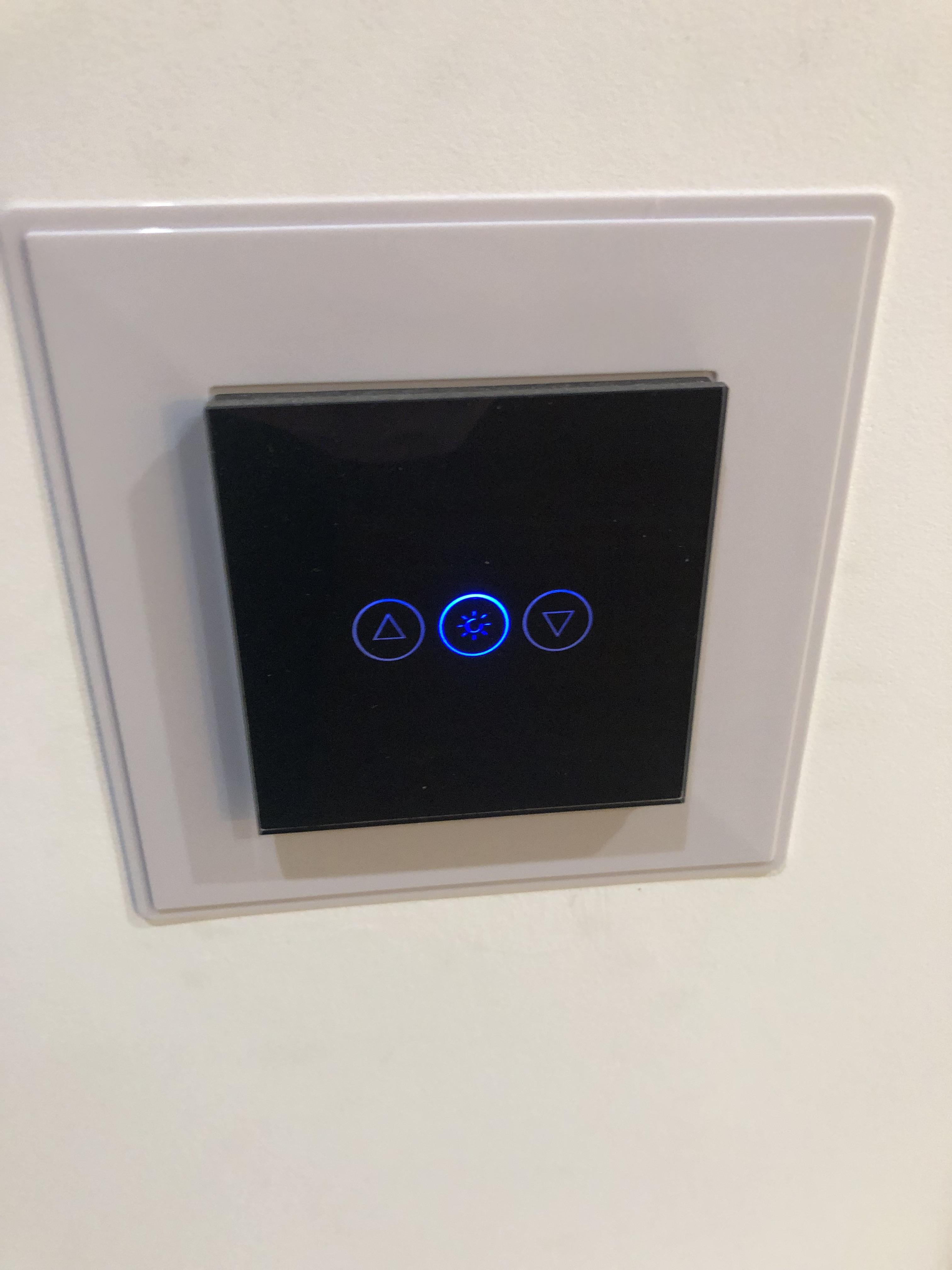

Pocster Posted January 3 Share Posted January 3 SWMBO insisted on ‘normal ‘ light switches in some places . So we have these dimmers ( with neutral ) light can be controlled without any HA but is also zigbee - so best of both worlds Link to comment Share on other sites More sharing options...

joe90 Posted January 4 Share Posted January 4 When I moved into my latest cottage the lounge had a newfangled touch dimmer switch and it would randomly turn the light on or off, I changed it to a “normal” switch 😎 Link to comment Share on other sites More sharing options...
Pocster Posted January 4 Share Posted January 4 1 hour ago, joe90 said: When I moved into my latest cottage the lounge had a newfangled touch dimmer switch and it would randomly turn the light on or off, I changed it to a “normal” switch 😎 It’s not random . I’m turning it on / off for my amusement 2 Link to comment Share on other sites More sharing options...
