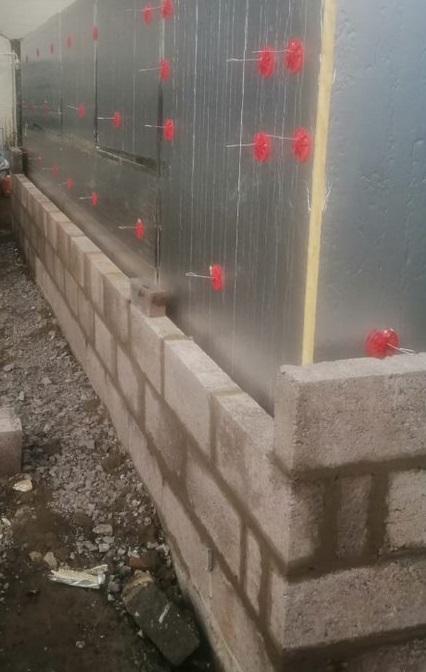

Carrerahill Posted May 5, 2023 Posted May 5, 2023 24 minutes ago, Big Jimbo said: I think i am going to end up building from block and block. The outside will be rendered on the bottom half, and cement clad planks on the top half (ventilated). I would like to achieve better than regs insulation levels if poss, and not to expensive. I am not sure im keen on the rigid type cavity insulation. No offence to any bricklayers on here, but it's hard enough to get the cavity batts fitted well, let alone tounge and groove ridged panels. I could live with perhaps battens on the inside leaf, with insulation in between, if that could also provide me with a cavity for electrics. Any ideas from the smart, and helpful people on here ? Thanks in advance. We used PIR, fully sheets with foamed and taped joints. Bricklayer put the internal walls up to a level first, then left all the wall ties sticking out, I worked out I could just push a full 4x8 sheet of 50mm PIR over the ties and they just poked through, I added the retention discs and could install about 8 sheets in 30-40minutes, it was comical how fast it went on, we got a really tight fit, jointed and taped it all and it looked like a perfect foil box. If I was doing it again, I would probably use 75mm PIR, I would even look into stretching it to 100mm PIR, but it makes the walls thick at 350mm, but then, not really that much worse than a TF and block build using block 100mm, cavity 50mm, and 150/175mm TF. So only 25/50mm in it. 1
Carrerahill Posted May 5, 2023 Posted May 5, 2023 5 minutes ago, Big Jimbo said: @Carrerahill That is a seriously neat job. Thanks, our bricklayer has been building things for us for about 6 years now, he is very accommodating, and does it all as weekend shifts so it creates timeframes for me to get my bits done without it impacting him. I know this will not suit all but it suit me perfectly. This was done last summer and I was doing 6-7 sheets a night after work before dinner - it was an easy shift. If you ask your guys to build like this and fit the insulation as full sheets you will get a nice neat job like this. I think the key here was installing full sheets to minimise joints and just generally make it look much neater. 1
