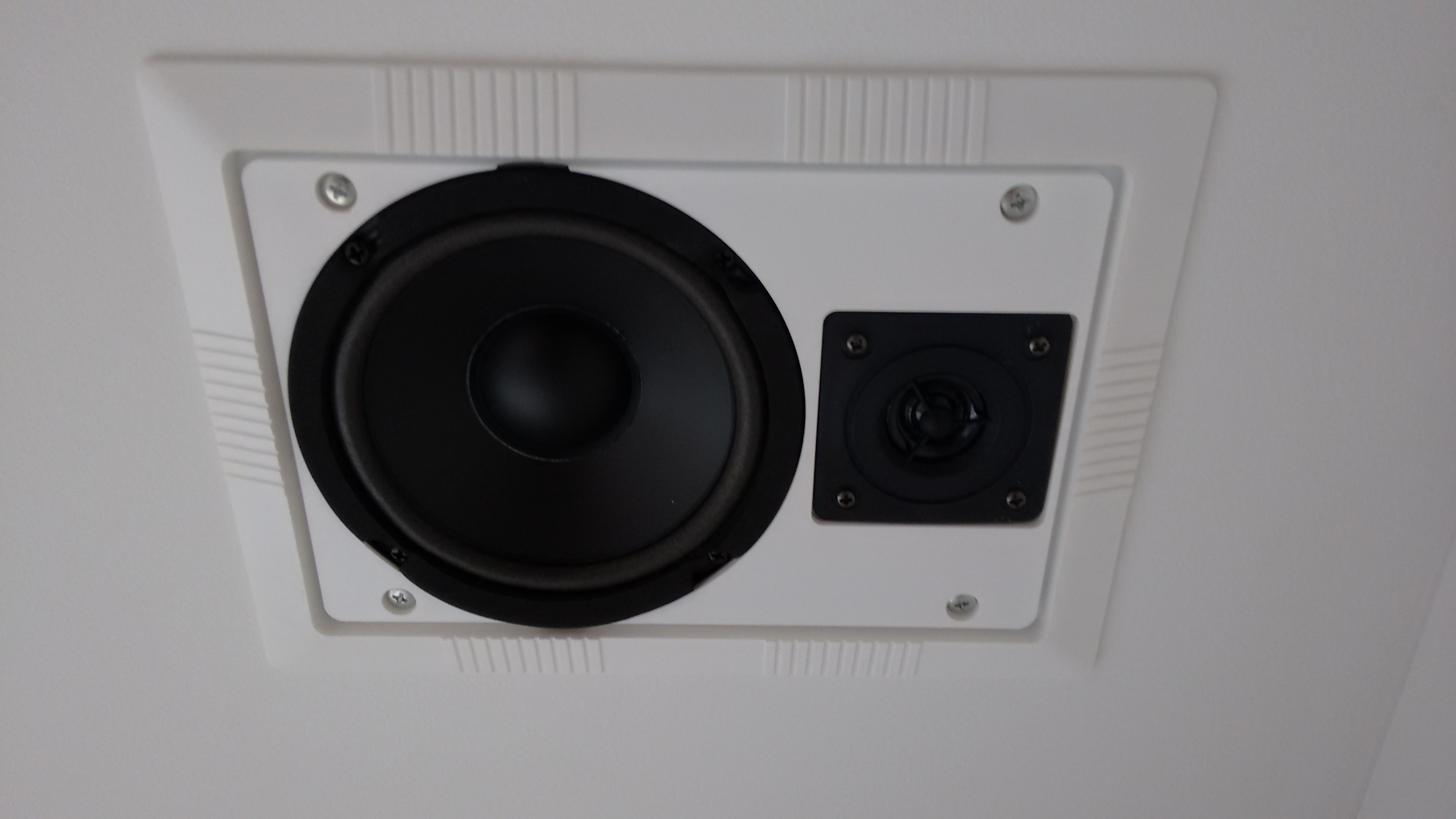

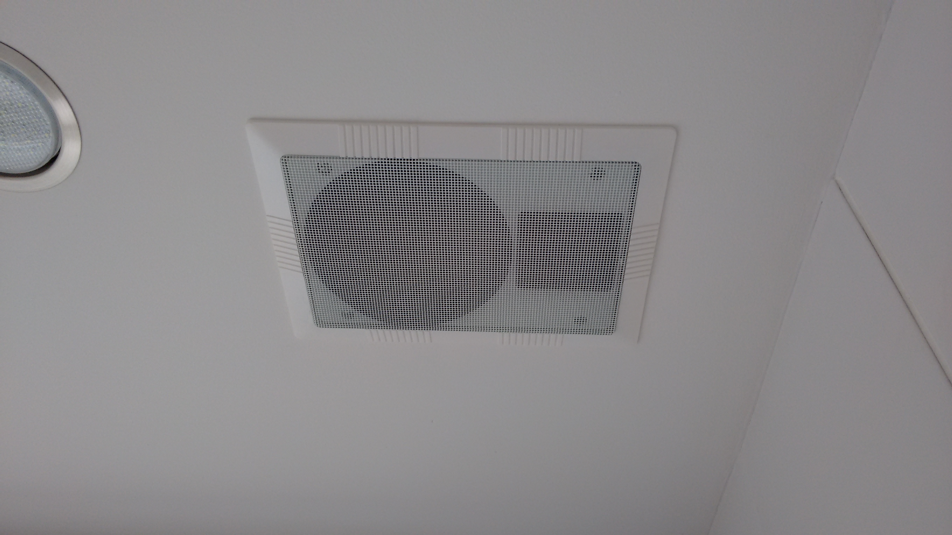

Plumbersmateuk Posted August 5, 2017 Share Posted August 5, 2017 These are mine....I put them in the ceilings and walls, got them from a place in Southend,I got a good price because I bought enough to do mine and son in laws house. Link to comment Share on other sites More sharing options...
Pocster Posted August 5, 2017 Author Share Posted August 5, 2017 3 hours ago, Plumbersmateuk said: These are mine....I put them in the ceilings and walls, got them from a place in Southend,I got a good price because I bought enough to do mine and son in laws house. How do the sound? expensive???? Link to comment Share on other sites More sharing options...

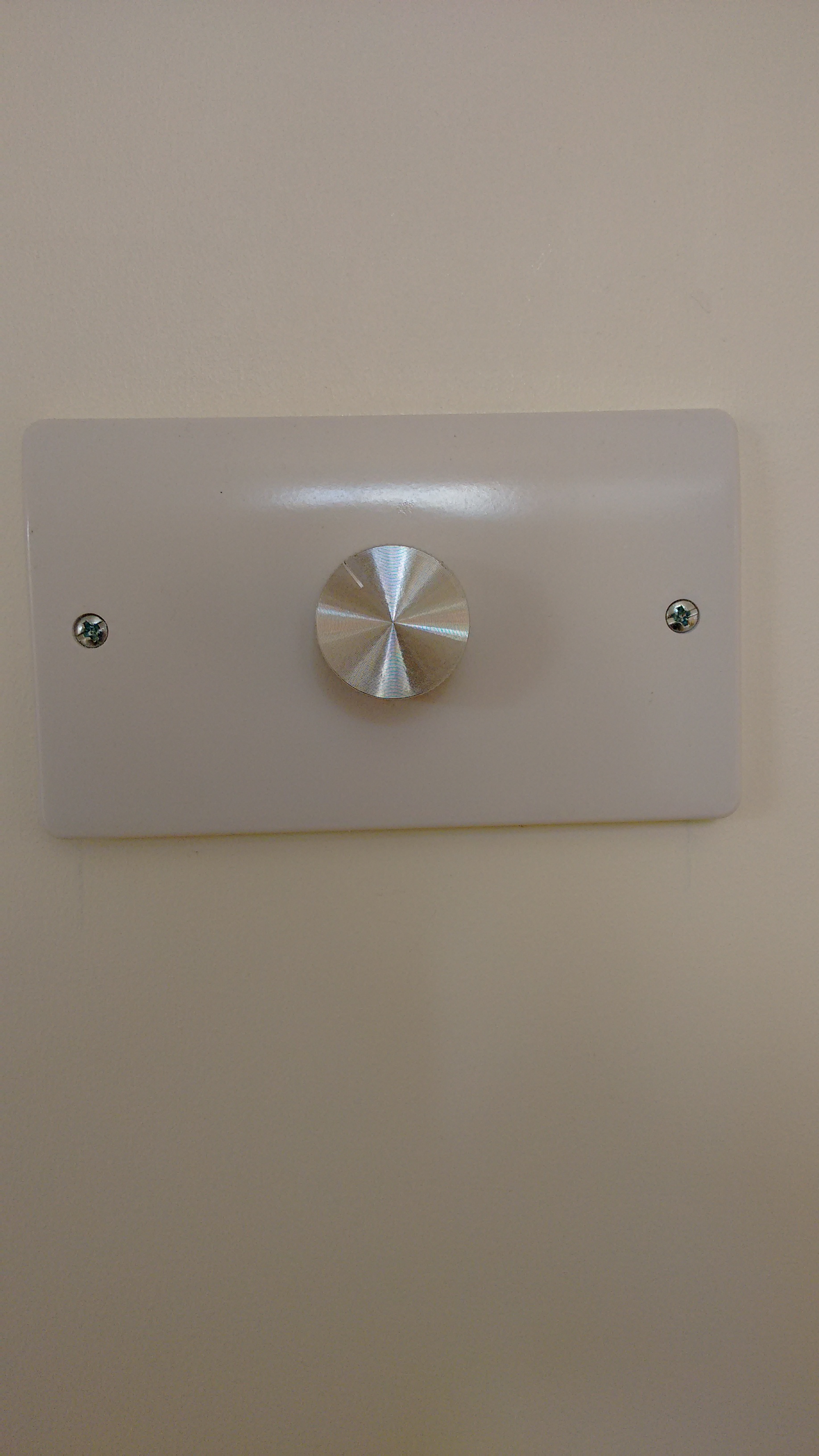

Plumbersmateuk Posted August 5, 2017 Share Posted August 5, 2017 6 hours ago, pocster said: How do the sound? expensive???? Well I think they sound really good, they are well made and heavy (loads of copper windings (I could pop one out and post a pic if needed) They were not that expensive. I will try and remember where exactly I got them. I have each pair connected to it's own volume control which fits inside a double gang patress. Link to comment Share on other sites More sharing options...
Jeremy Harris Posted August 6, 2017 Share Posted August 6, 2017 8 hours ago, Plumbersmateuk said: Well I think they sound really good, they are well made and heavy (loads of copper windings (I could pop one out and post a pic if needed) They were not that expensive. I will try and remember where exactly I got them. I have each pair connected to it's own volume control which fits inside a double gang patress. I fitted the same speakers in the walls of our living room, for the TV. They do indeed sound good, a great deal better than I thought they would for the price. Link to comment Share on other sites More sharing options...

PeterW Posted August 6, 2017 Share Posted August 6, 2017 1 hour ago, JSHarris said: I fitted the same speakers in the walls of our living room, for the TV. They do indeed sound good, a great deal better than I thought they would for the price. Any supplier details @JSHarris or @Plumbersmateuk ..?? I can see a BuildHub bulk order happening here ... Link to comment Share on other sites More sharing options...
Jeremy Harris Posted August 6, 2017 Share Posted August 6, 2017 I'm pretty sure they were Adastra IW5s. I can't find the place I bought them from, but a quick look around shows that there are lots of places selling them, like here: http://tech4homes.co.uk/adastra-iw5-in-wall-ceiling-speaker 1 Link to comment Share on other sites More sharing options...

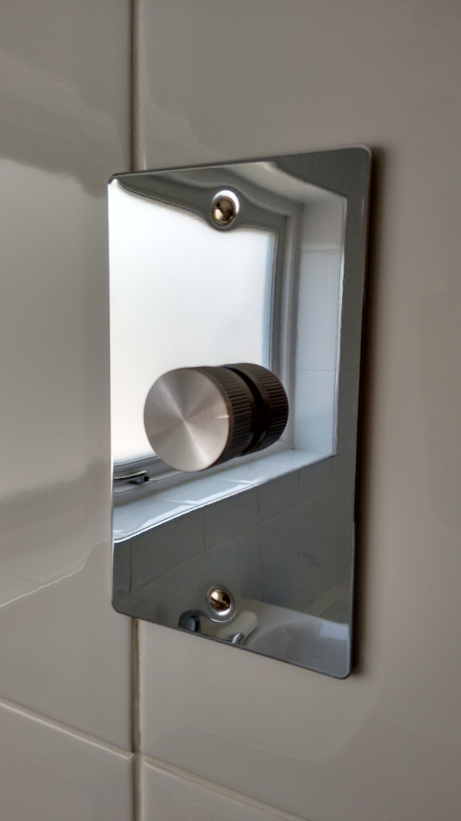

Plumbersmateuk Posted August 6, 2017 Share Posted August 6, 2017 4 hours ago, PeterW said: Any supplier details @JSHarris or @Plumbersmateuk ..?? I can see a BuildHub bulk order happening here ... Mine are the same as @JSHarris although a different name and I checked back and they came from http://www.bkelec.com/ They sadly no longer list them but that price from tech4homes is good. If my memory, LOL serves me right I paid about £18 per pair buying 12 pairs albeit 2010. They are on at least 5 hours a day and more at weekends and have given no bother. I would/am going to use them in the new house. As I said in an earlier post I have individual volume controls, chrome in bathroom and whit MK double blanks elsewhere 2 Link to comment Share on other sites More sharing options...

Plumbersmateuk Posted August 7, 2017 Share Posted August 7, 2017 55 minutes ago, pocster said: Should I get speaker hoods for in ceiling speakers ? Seem bloody expensive !!! I haven't.........I also have speakers in the bathroom ceilings and they have not suffered from the occasional hostile environment but I do have MVHR. As I said in an earlier post I installed the speakers in 2010. 1 Link to comment Share on other sites More sharing options...
