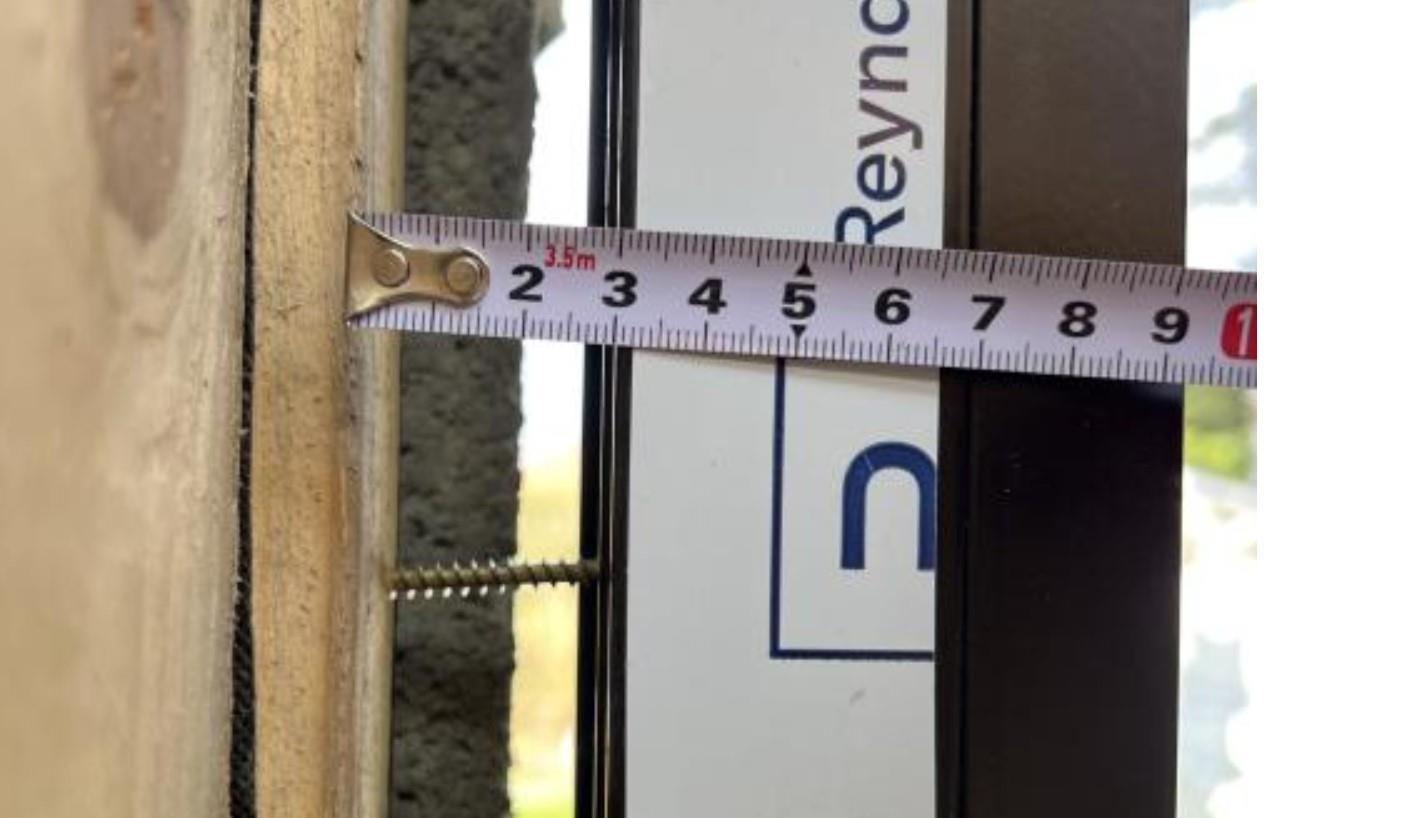

ggc Posted April 13, 2023 Share Posted April 13, 2023 (edited) Hello folks. We recently started our glazing install on our new extension. The glazing company hasn’t been back for a week or so due to an error with a door that has been ordered incorrectly (50/50 blame with us and the company I feel). Anyway, we are having quite a large shaped, fixed window installed above a sliding door This was measured by the Sales chap and one of the senior installers. There is a 30mm gap all around the frame where it (is supposed to) fit against the timbers & masonry. Is this really an acceptable tolerance for a bespoke measured measured job? Opinions gladly accepted They haven’t yet fitted the glazing to the frame. We we’re under the impression that the glazing frame should sit in behind the block work, giving a slimmer sight line, then attaching to the timber frame? Thanks in advance for opinions This I feel is just the tip of the iceberg on a badly measured job, or am I being picky? Edited April 13, 2023 by ggc Link to comment Share on other sites More sharing options...
nod Posted April 13, 2023 Share Posted April 13, 2023 I’ve frames and glass being delivered tomorrow I’ve allied 5 mil all around 30 is to much They could fit a 25 mil add on to get over this Poor measure 1 Link to comment Share on other sites More sharing options...
ggc Posted April 13, 2023 Author Share Posted April 13, 2023 9 minutes ago, nod said: I’ve frames and glass being delivered tomorrow I’ve allied 5 mil all around 30 is to much They could fit a 25 mil add on to get over this Poor measure Thanks for your answer. I had read that 5-10mm would be an acceptable tolerance. Having watched some of Robin Clevit’s videos, he seems to need to “persuade” units into position as tolerances are that close. Link to comment Share on other sites More sharing options...
nod Posted April 13, 2023 Share Posted April 13, 2023 2 minutes ago, ggc said: Thanks for your answer. I had read that 5-10mm would be an acceptable tolerance. Having watched some of Robin Clevit’s videos, he seems to need to “persuade” units into position as tolerances are that close. The screws that are in won’t hold the frames They relying on foam doing that Link to comment Share on other sites More sharing options...
ggc Posted April 13, 2023 Author Share Posted April 13, 2023 Just now, nod said: The screws that are in won’t hold the frames They relying on foam doing that Yes, similar gaps around some of the rest of the installed windows, which as you say are filled with expanding foam. TBH not what I was expecting (nothing ever is, is it) One of the windows expanding foam appears to be deteriorating already after maybe being in situ for almost a fortnight, could it be UV degradation? (Thought I’d taken a picture of it, but haven’t) Link to comment Share on other sites More sharing options...

craig Posted April 13, 2023 Share Posted April 13, 2023 1 hour ago, ggc said: ere is a 30mm gap all around the frame where it (is supposed to) fit against the timbers & masonry. Was he wearing a blindfold when he measured? 10mm all around is all you need, that window is too small for the opening. 1 Link to comment Share on other sites More sharing options...

ggc Posted April 13, 2023 Author Share Posted April 13, 2023 (edited) 48 minutes ago, craig said: Was he wearing a blindfold when he measured? 10mm all around is all you need, that window is too small for the opening. That’s the kind of answer I expected, though didn’t want to hear! 😂🤦🏻♂️ In your professional opinion, what’s my options? Am I being unreasonable asking them to manufacture it again? Edited April 13, 2023 by ggc Link to comment Share on other sites More sharing options...
craig Posted April 13, 2023 Share Posted April 13, 2023 There is no way they allow a tolerance of 30mm all around, but, stranger things happen. Ask them and check the other openings and the tolerances before doing so. Reality bites, can you live with it? Yeah probably, is it what you wanted? No. I would personally say live with it and ask for some recompense. Let's say 20% of the cost of the window and expect 10% of the cost back. To be honest, you could reject it and get into a disagreement about it & a fair bit of going back and forth, getting nowhere fast. Is it worth the headache? 1 Link to comment Share on other sites More sharing options...
Mr Punter Posted April 13, 2023 Share Posted April 13, 2023 You can mostly lose that inside with packing / insulated plasterboard and outside with render so you can still have the slim sightlines. I would ask them to contribute to the additional costs for packing out. 1 Link to comment Share on other sites More sharing options...
ggc Posted April 13, 2023 Author Share Posted April 13, 2023 5 minutes ago, craig said: There is no way they allow a tolerance of 30mm all around, but, stranger things happen. Ask them and check the other openings and the tolerances before doing so. Reality bites, can you live with it? Yeah probably, is it what you wanted? No. I would personally say live with it and ask for some recompense. Let's say 20% of the cost of the window and expect 10% of the cost back. To be honest, you could reject it and get into a disagreement about it & a fair bit of going back and forth, getting nowhere fast. Is it worth the headache? A lot of it has similar 30mm gaps! Even a large Tilt/Turn window looks to be off plumb by around 7mm at the bottom (measured with a laser level) The issue is, it wasn’t the cheapest quote , we paid for a bespoke service and tbh this isn’t meeting our expectations That angled window is 4m across, I haven’t worked out the area of glass that’s missing, but it’s more the aesthetic of the finish, as we wanted to hide some of the frame behind the block work (which the builders have created the recess to allow) If I swallow this, it means we have more render making the it look not as we wanted. Link to comment Share on other sites More sharing options...

Kelvin Posted April 13, 2023 Share Posted April 13, 2023 I’m not particularly fussy (other half would disagree) but I wouldn’t accept that. 30mm out is mistake not a tolerance unless this is their standard detail for some reason given you’ve suggested it’s 30mm elsewhere too. Link to comment Share on other sites More sharing options...
craig Posted April 13, 2023 Share Posted April 13, 2023 Call them before it goes any further and have a discussion with them, I don't know any window supplier or manufacturer that recommends a 30mm tolerance. It's an expensive **** up tbh. Link to comment Share on other sites More sharing options...
saveasteading Posted April 13, 2023 Share Posted April 13, 2023 8 minutes ago, ggc said: wasn’t the cheapest I suspect they allowed tolerance twice by mistake. The installer measured the openings, and took 15mm off all round. Then the manufacturer did the same. I don't know what industry standards there are, but I would think at least they pay for the extra cost in finishing this. 2 Link to comment Share on other sites More sharing options...
Temp Posted April 13, 2023 Share Posted April 13, 2023 Is it possible they measured the opening in the blockwork rather than the frame the windows are fixed into? 1 Link to comment Share on other sites More sharing options...
craig Posted April 13, 2023 Share Posted April 13, 2023 Just now, Temp said: Is it possible they measured the opening in the blockwork rather than the frame the windows are fixed into? It's exactly what they have done. 1 Link to comment Share on other sites More sharing options...

ggc Posted April 15, 2023 Author Share Posted April 15, 2023 Well, We have a meeting on site with the sales representative on Monday am We have asked for his measurements to be sent across to us to see what he has taken prior to the meeting. hopefully it’ll show how the error has occurred, and who to point the finger at for the discrepancy ! Mrs GGC has an incredible eye for detail, and this just isn’t to her standards, and isn’t going to allow her to sleep at night knowing things just aren’t how we visioned it sadly. (dunno how she puts up with me though 😉) They plan on getting the glazing units fitted up there next week, only two weeks after the promised install date, and about 3 weeks after this all started. I don’t know how they will get SWMBO to swallow this. Link to comment Share on other sites More sharing options...
Dave Jones Posted April 15, 2023 Share Posted April 15, 2023 yeah i wouldn't be happy with that. who signed off the order with the measurements ? You could pack out the internal frame with more timber to get it to work but your going to want the render line to match the reveal of the sliding door below it. Link to comment Share on other sites More sharing options...
