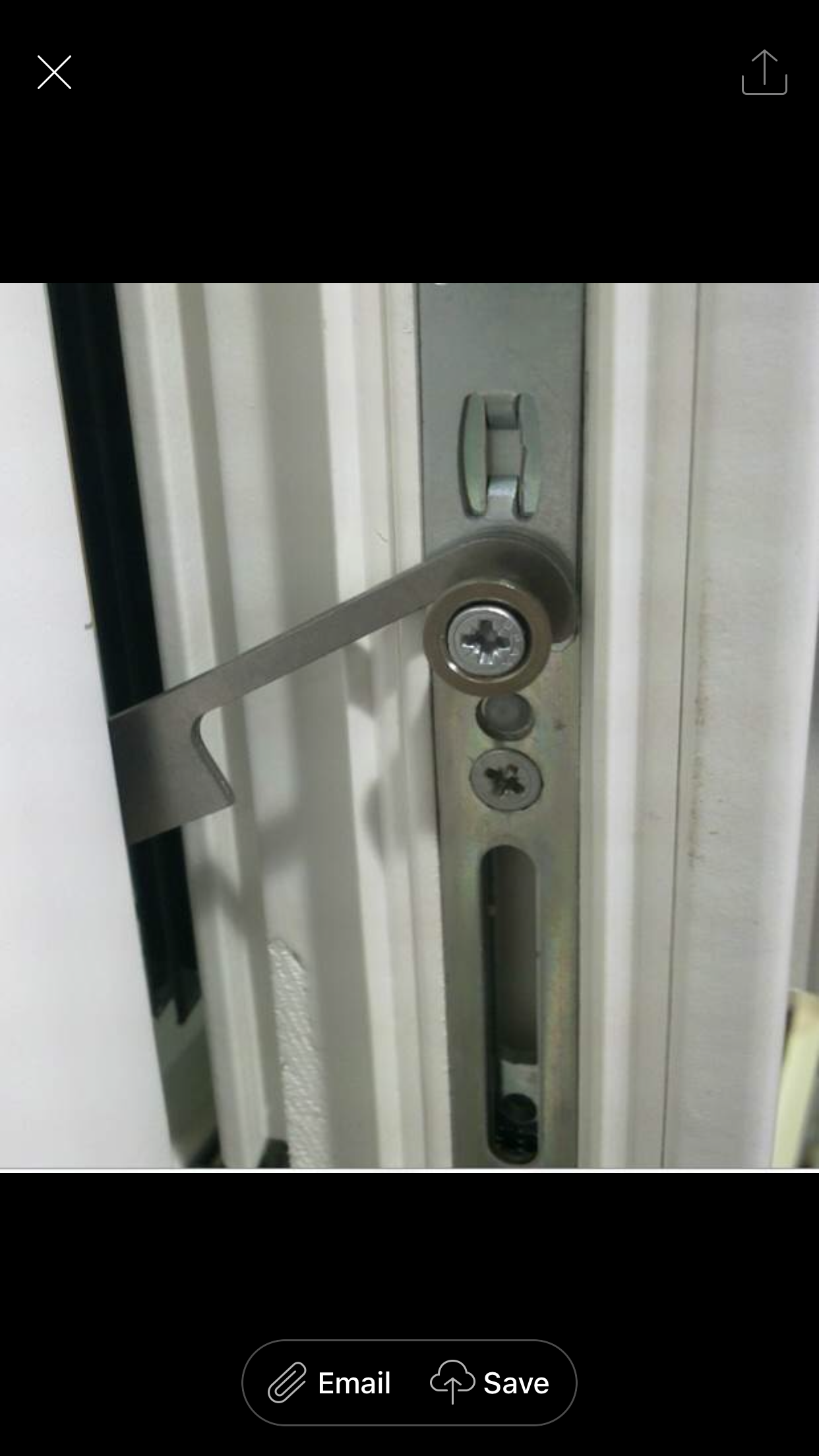

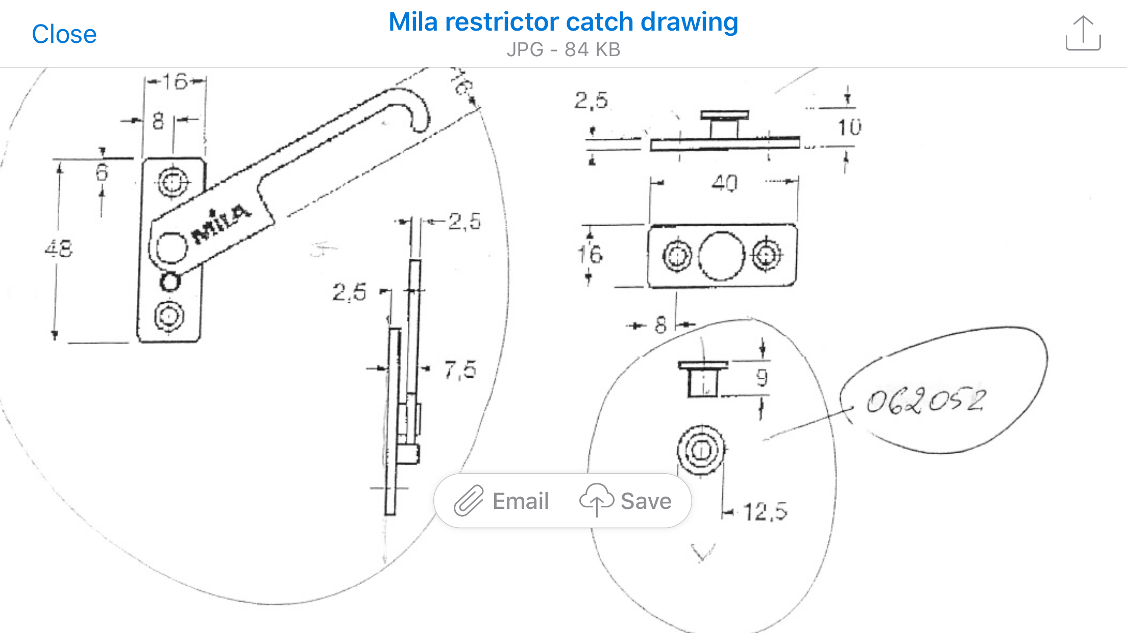

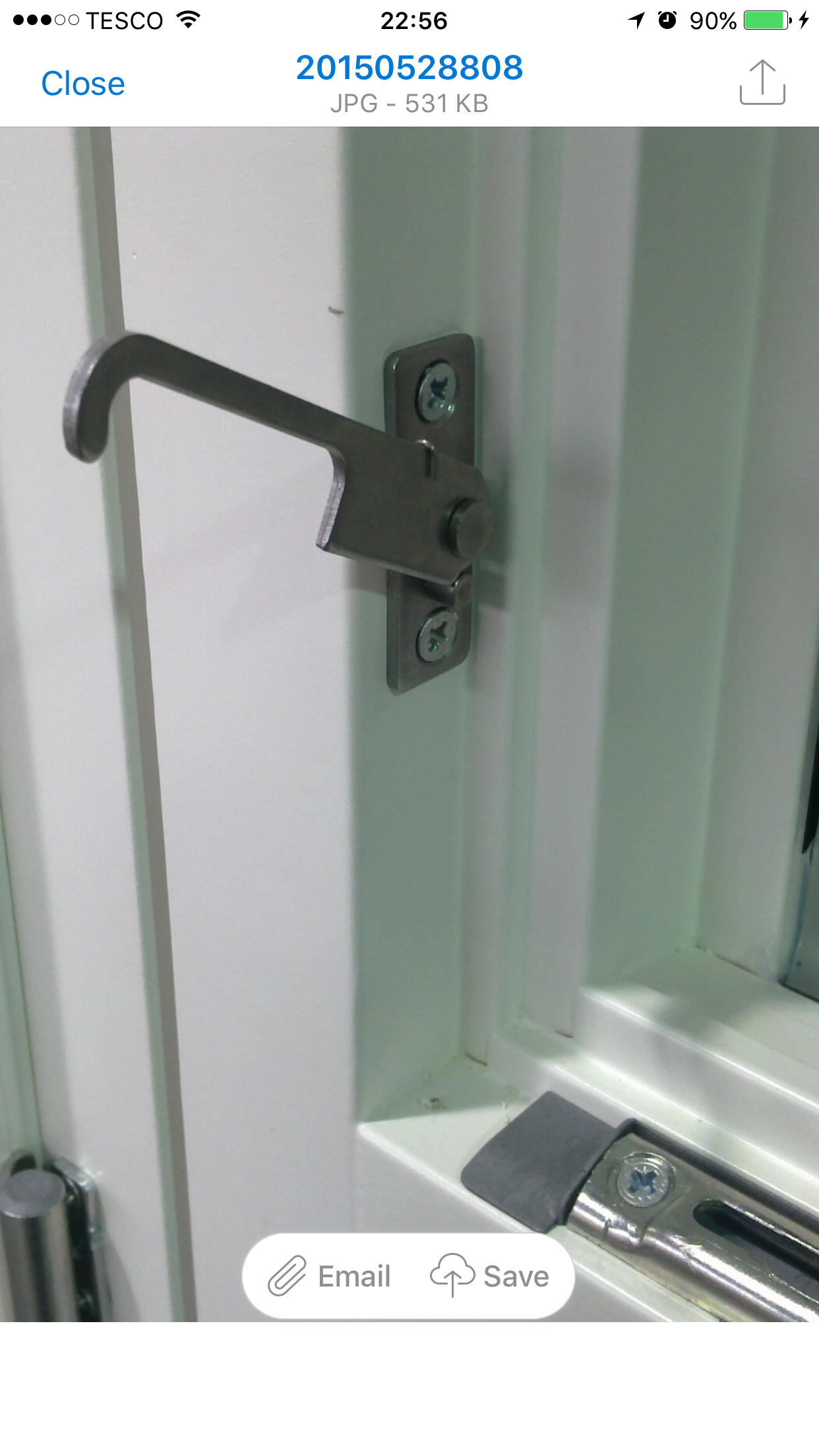

craig Posted July 31, 2017 Share Posted July 31, 2017 (edited) It's a very simple solution, the way the sash is designed makes it difficult to fit one due to space and the gearing. However, what you need to do is purchase Mila restrictor, catch and then remove one of the screws located on gearing which fixes the gearing to the frame and won't effect the gearing movement. The picture shows we used a mushroom pin, however that has been refined and we use the standard catch - it can only take one screw so gorilla glue is required for the 2nd screw location on the catch. However, it needs to be this type of restrictor from Mila. Until a a better solution is found, this is the best we have come up with and works extremely well and like it should be present. Edited July 31, 2017 by craig 2 Link to comment Share on other sites More sharing options...
lizzie Posted July 31, 2017 Share Posted July 31, 2017 1 hour ago, craig said: It's a very simple solution, the way the sash is designed makes it difficult to fit one due to space and the gearing. However, what you need to do is purchase Mila restrictor, catch and then remove one of the screws located on gearing which fixes the gearing to the frame and won't effect the gearing movement. The picture shows we used a mushroom pin, however that has been refined and we use the standard catch - it can only take one screw so gorilla glue is required for the 2nd screw location on the catch. However, it needs to be this type of restrictor from Mila. Until a a better solution is found, this is the best we have come up with and works extremely well and like it should be present. Thank you so much for sharing this 1 Link to comment Share on other sites More sharing options...

craig Posted August 1, 2017 Share Posted August 1, 2017 8 hours ago, lizzie said: Thank you so much for sharing this No worries, this should work on the Internorm window as well, it works with our system. 1 Link to comment Share on other sites More sharing options...
