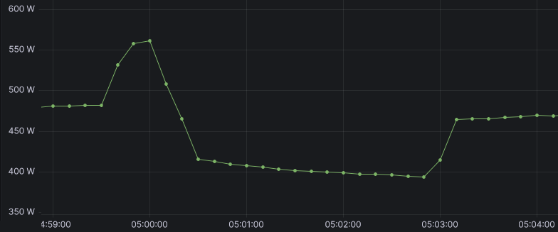

I had considered this but it's not responsive enough without a huge buffer to avoid import - it certainly couldn't guarantee no export. The start up from cold cycle takes about 15 mins where it runs things harder to get everything up to temperature, but even a change of temperature of 1 degree whilst running takes about 30 seconds to a minute to stabilise on the power graph, here's a change from the boost temperature during Flux cheap hours to the normal temperature:
Note also three minutes later the temperature sensor must have dropped a degree and it modulates back up, so very fine control is not possible. Coarse modulation between 400-800W should be possible as a function of several variables but as the CoP stayed above three and I have a small battery I've never looked into it further as everything just works. It runs 2-5am on boost, then 5-13 on the morning Flux battery charge + PV, 13-16 on boost before turning off for the 16-19 peak period and back to normal operation with the last bit of battery after that.
It also plays a little jingle when you change a setting (fine for larger time periods, but every second?) so that'd need locating and removing!
