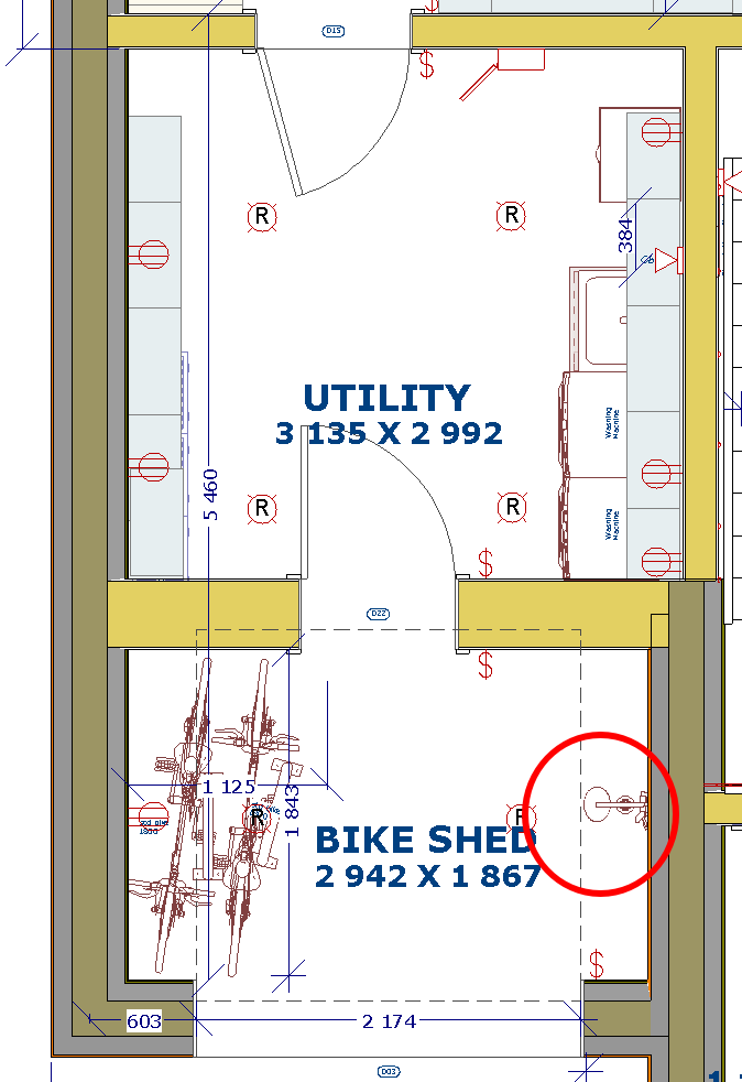

puntloos Posted February 2, 2023 Posted February 2, 2023 As per a previous discussion - Hairdryer in Bathroom - I'm .. somewhat in agreement that a power socket near a water source is not the best idea, although to my understanding modern electrical safety systems (like RCDs) will prevent ... most? badness. But that got me thinking- why are kitchens/utilities different than bathrooms? Plenty of high power devices next to running water. Perhaps not as ... runny.. as a shower or a bath but still. And in particular, at this moment I have a small shower designed into my utility/bike room As you can see currently the only power socket designed is across the room near the bikes (almost, but not quite 3m away from the shower, although I could literally use diagonal placement to stretch it to 3.01m...). Is this current design OK anyway - or will it fail some building requirements? The shed is already somewhat 'power free' and could make it completely socket-free but a few sockets would certainly be helpful..

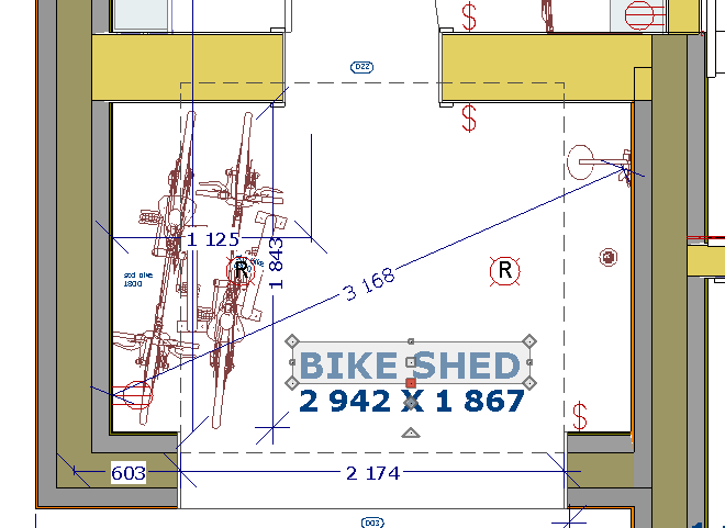

ProDave Posted February 2, 2023 Posted February 2, 2023 The wiring regs don't define a utility or a kitchen, the special location is a "room containing a bath or a shower" So whatever name you give it, your bike shed is a special location under wiring regs and needs to be treated as a bathroom. And it's too small to get a socket in there, anywhere. This caused me a headache when doing a conversion where the owner had fitted a shower cubicle in the corner of a bedroom. That whole room is now a special location. The room was just big enough to allow a couple of sockets in the opposite corner of the room to the shower cubicle, which were of course not where the owner wanted them, so plugged in there is an extension lead to power the tv sat on a dressing table right next to the shower. Bath or shower rooms I guess assume you are likely to be naked and standing in water so don't want anything touchable from there. In a kitchen you might have wet hands but you are unlikely to be naked and standing or sitting in water (I could think of one on here that might) 1
puntloos Posted February 2, 2023 Author Posted February 2, 2023 5 minutes ago, ProDave said: The wiring regs don't define a utility or a kitchen, the special location is a "room containing a bath or a shower" So whatever name you give it, your bike shed is a special location under wiring regs and needs to be treated as a bathroom. And it's too small to get a socket in there, anywhere. Why is that though, is it the 3m thing? I could manage 3.168m 5 minutes ago, ProDave said: This caused me a headache when doing a conversion where the owner had fitted a shower cubicle in the corner of a bedroom. That whole room is now a special location. The room was just big enough to allow a couple of sockets in the opposite corner of the room to the shower cubicle, which were of course not where the owner wanted them, so plugged in there is an extension lead to power the tv sat on a dressing table right next to the shower. Super useful stuff. \tx 5 minutes ago, ProDave said: Bath or shower rooms I guess assume you are likely to be naked and standing in water so don't want anything touchable from there. In a kitchen you might have wet hands but you are unlikely to be naked and standing or sitting in water (I could think of one on here that might) Clearly you've never seen me cook. 1

puntloos Posted February 2, 2023 Author Posted February 2, 2023 1 minute ago, ProDave said: Ask the IET, I suspect it is their estimate of the average length of flex on an appliance plus the reach of a person? My point being that my utility room is juuuuuust large enough to locate a socket further than 3m away. Would that make it acceptable?
saveasteading Posted February 2, 2023 Posted February 2, 2023 34 minutes ago, ProDave said: Bath or shower rooms I guess assume you are likely to be naked and standing in water so don't want anything touchable from Correct. I had this clarified. Assume naked, standing in a puddle and not too bright ( or careless , to quote last week's special word.) I can't see any bco allowing any relaxation. But in a utility or kitchen, no problem. Wet hand onto light switch is low risk...maybe a warning tingle and a spark before the cutout trips.

Mattg4321 Posted February 6, 2023 Posted February 6, 2023 Most other countries manage ok with sockets in bathrooms. As above, people just run leads anyway if they’re that way inclined. What with widespread use of RCD’s, it’s time for the IET to have a rethink imo. Also, for future reference, the distance required is now 2.5m. Not 3m since it was changed in 18th AMD 2 1
