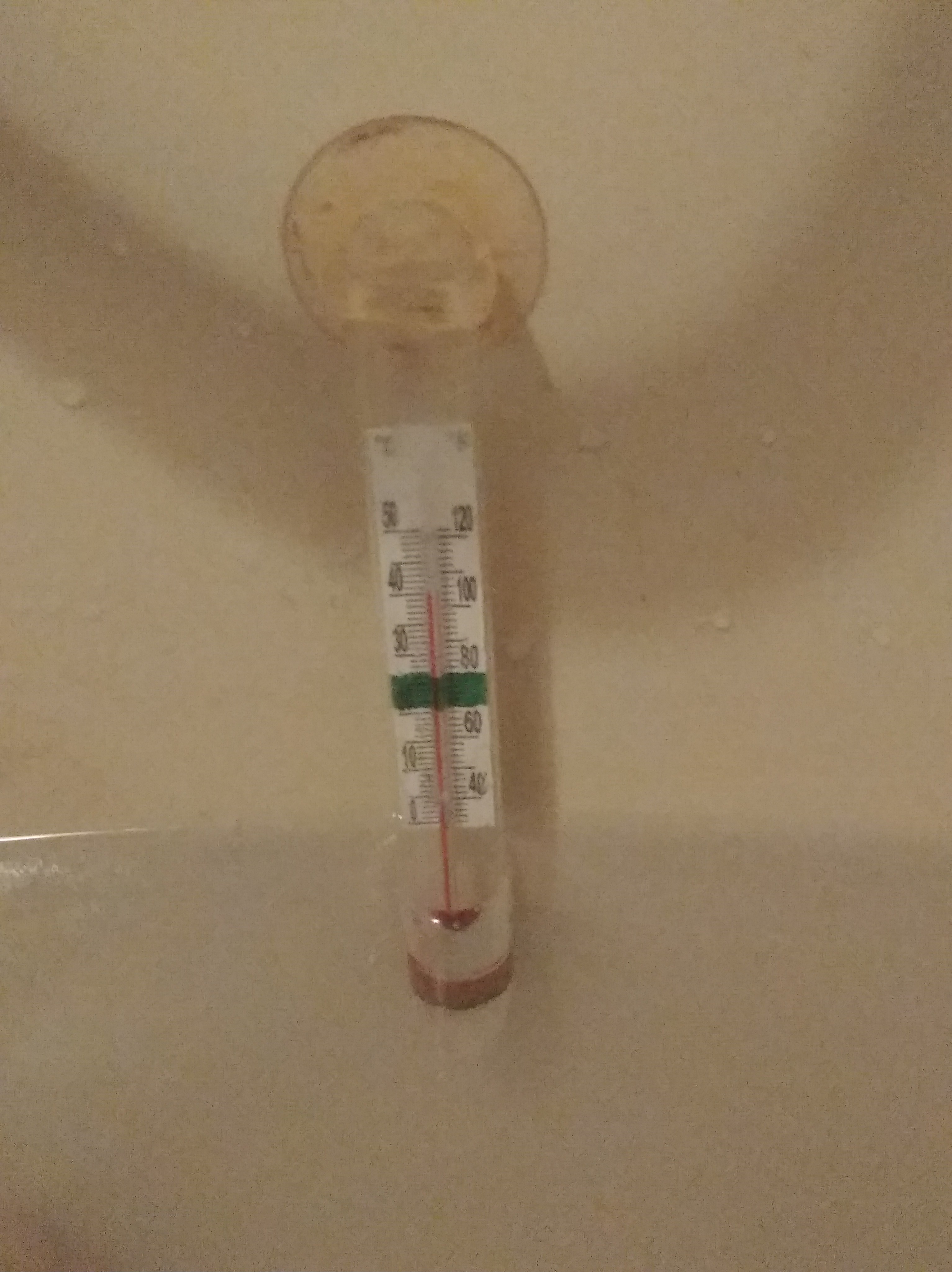

Nickfromwales Posted February 16, 2023 Share Posted February 16, 2023 Time for a reality check people!!! Get a thermometer and put it in the bath when you think, "ooh, that's just right", eg just before you pass out and then turn the hot tap back off.. Please post that temp here and lets see who ACTUALLY needs these ridiculous DHW temps. 4 Link to comment Share on other sites More sharing options...

Marvin Posted February 16, 2023 Share Posted February 16, 2023 My guess is 44C Link to comment Share on other sites More sharing options...
Gill Posted February 17, 2023 Share Posted February 17, 2023 I like a toasty soak but I'll have to guess as our tub is too big and nukes the full tank for a half bath. 41 would be my guess. I'm sure we got warned visiting Japan about temps over 43 in the onsen. Those were too hot for a long dip. Reminds me... Need to lookup compact Japanese style short deep tubs for when I get round to sorting the bathroom in 2025. 1 Link to comment Share on other sites More sharing options...
SteamyTea Posted February 17, 2023 Share Posted February 17, 2023 4 hours ago, Gill said: 41 would be my guess. I'm sure we got warned visiting Japan about temps over 43 in the onsen. Those were too hot for a long dip. I think I heard that, or something similar. Link to comment Share on other sites More sharing options...
