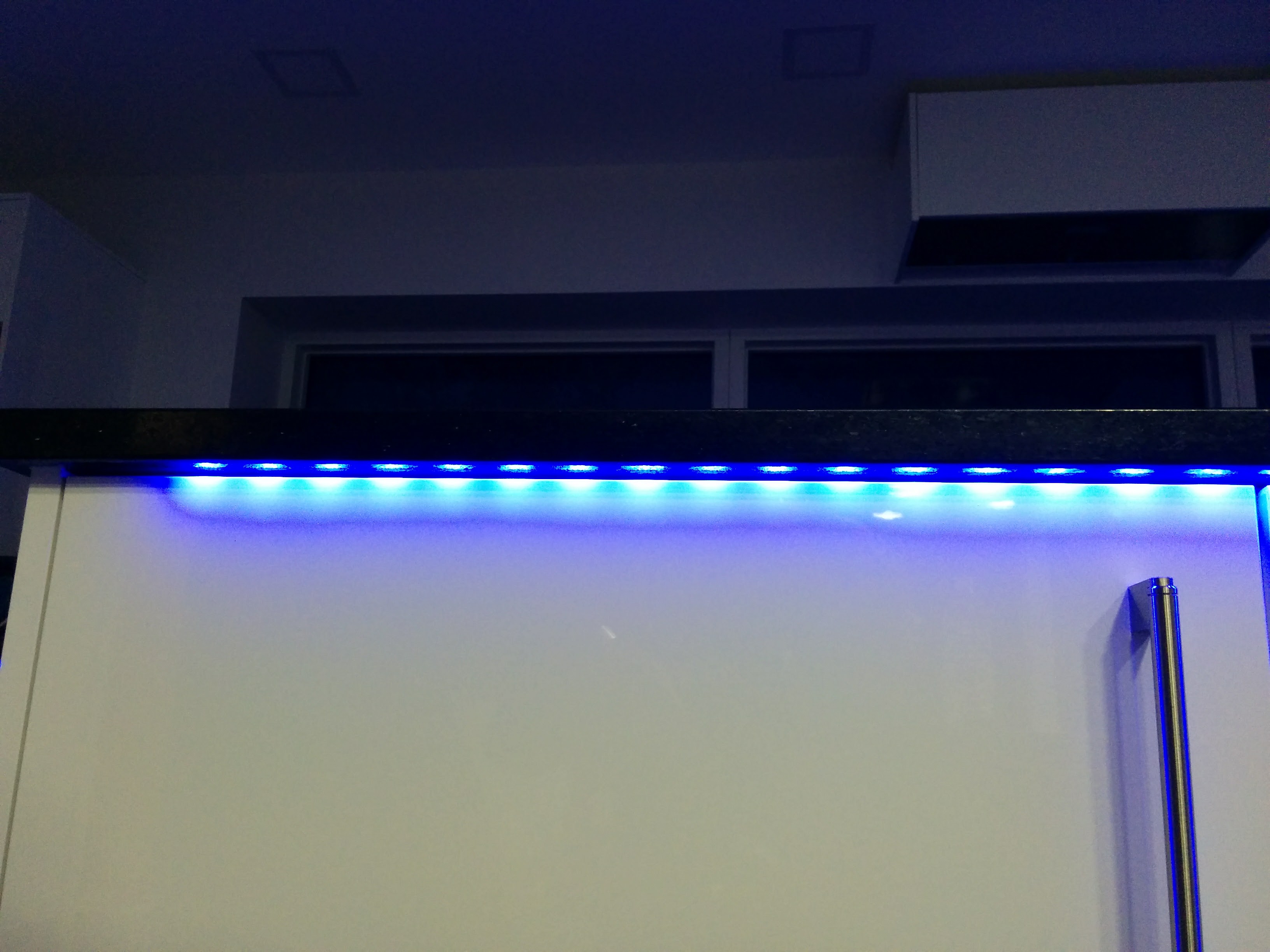

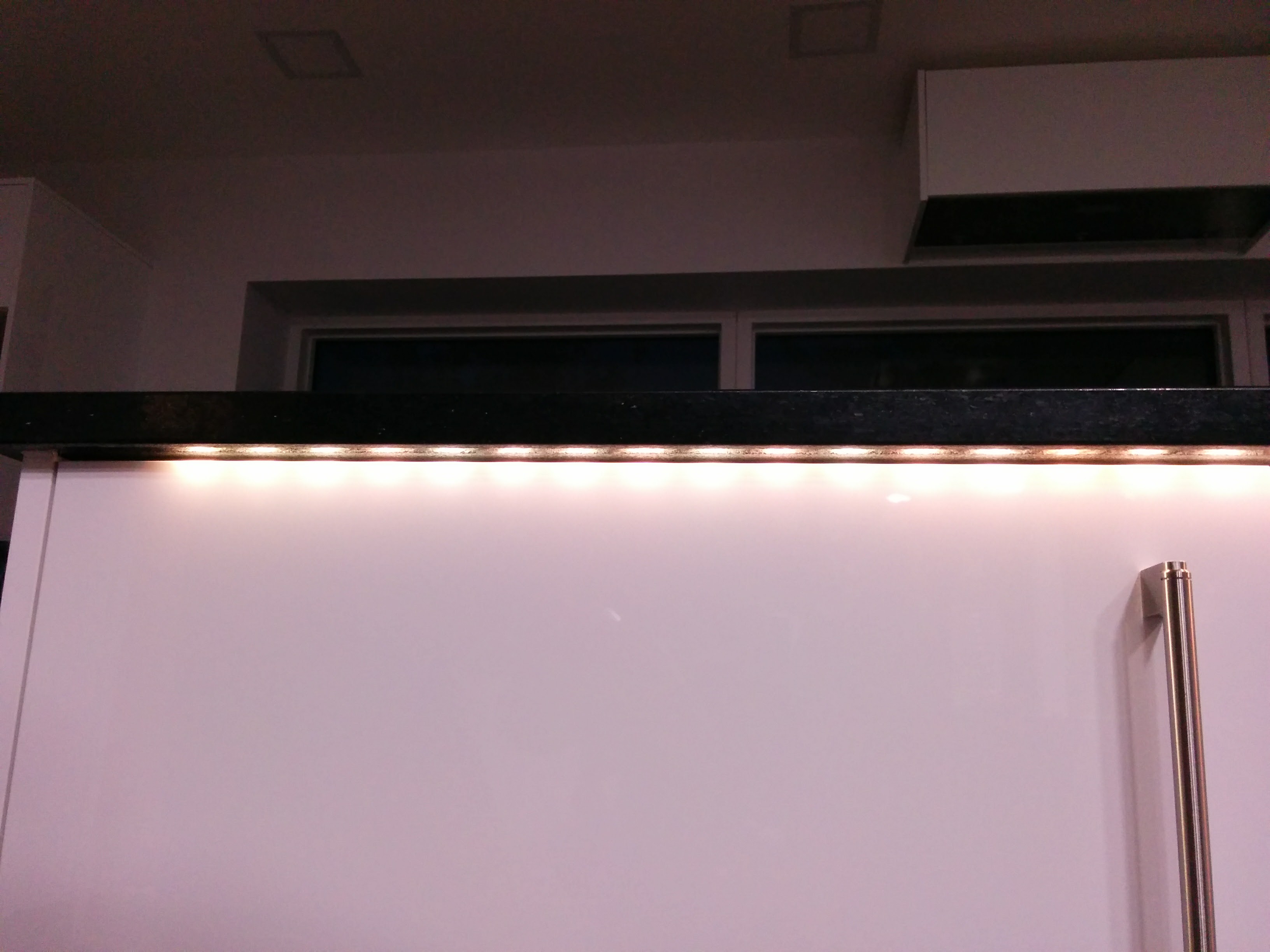

Fallingditch Posted July 15, 2017 Posted July 15, 2017 (edited) I have a granite kitchen worksurface and a granite topped island. An 11mm groove has been routed underneath the granite where it protrudes over cupboard doors and drawers. 10mm, 12V DC RGBWW strip has been fitted in the groove. It is controlled by a wall mounted controller which causes the strip to illuminate either in a single adjustable colour, or to continually change colour (disco mode, as they call it). All works really well: However, seeing the individually glowing chips rather detracts from the experience IMHO! Anyone know where I can source plastic diffusing strip? to stick over the groove and create a single band of coloured light? Edited July 15, 2017 by Fallingditch typo correction

lizzie Posted July 15, 2017 Posted July 15, 2017 (edited) 7 hours ago, Fallingditch said: I have a granite kitchen worksurface and a granite topped island. An 11mm groove has been routed underneath the granite where it protrudes over cupboard doors and drawers. 10mm, 12V DC RGBWW strip has been fitted in the groove. It is controlled by a wall mounted controller which causes the strip to illuminate either in a single adjustable colour, or to continually change colour (disco mode, as they call it). All works really well: However, seeing the individually glowing chips rather detracts from the experience IMHO! Anyone know where I can source plastic diffusing strip? to stick over the groove and create a single band of coloured light? downlightsdirect.co.uk in the led striplights section Edited July 16, 2017 by recoveringacademic Inserted hyperlink 2
Barney12 Posted July 16, 2017 Posted July 16, 2017 As @lizzie said you can get the channels with the opaque covers but I'm not sure you'll want to take out your led's re-size the channel and refit. How about just getting some 2 or 3mm opaque Perspex and bond it on or into the gap? This seller seems to indicate he'll do custom sizes: Opal Opaque Acrylic Perspex Sheet Plastic LED Lighting Sign Diffuser Material 2
Fallingditch Posted July 16, 2017 Author Posted July 16, 2017 Thanks for all suggestions. Have followed up suggestions & sent out many emails, but looks to me like I might have to go with a customised solution from @Barney12
