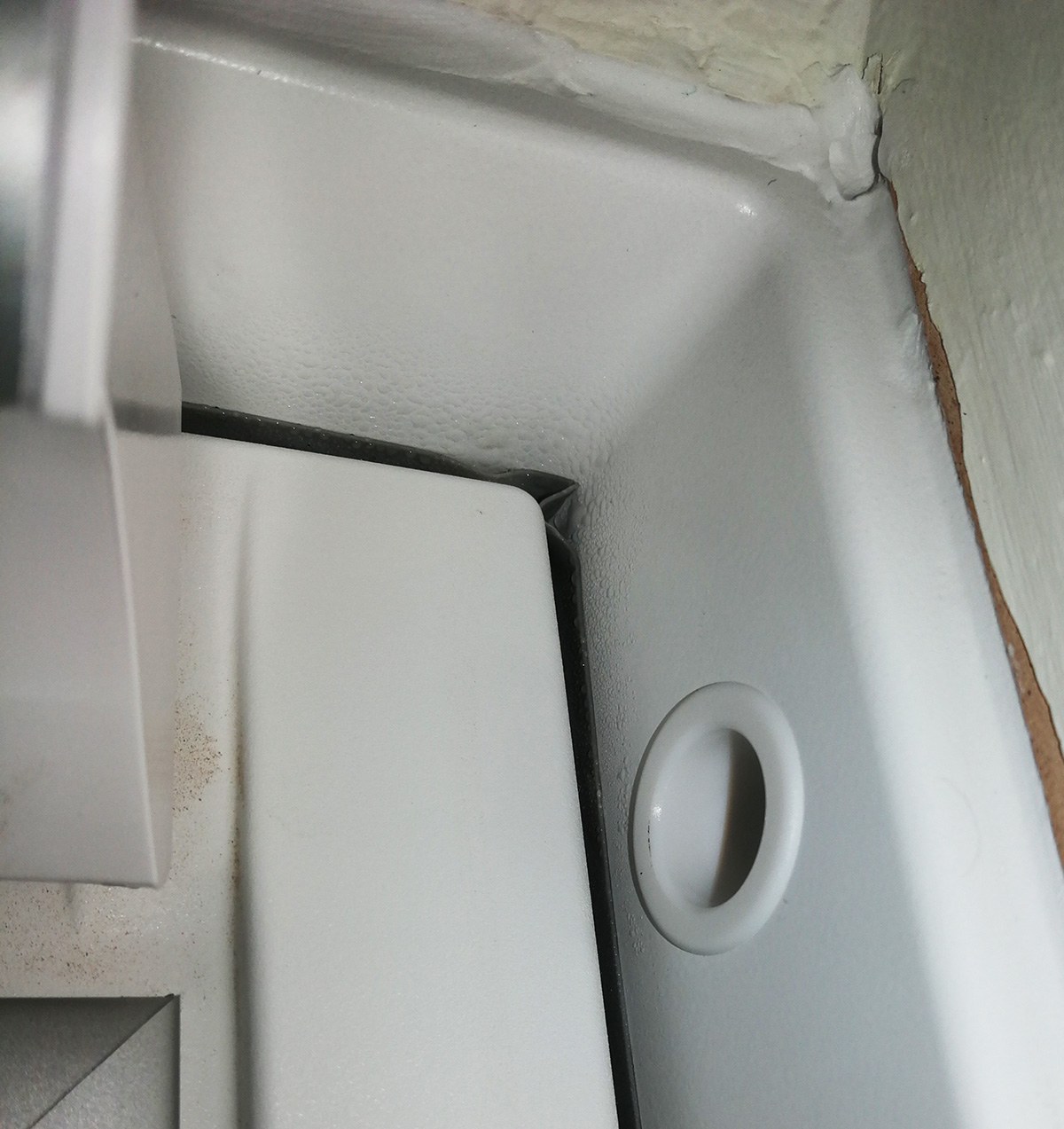

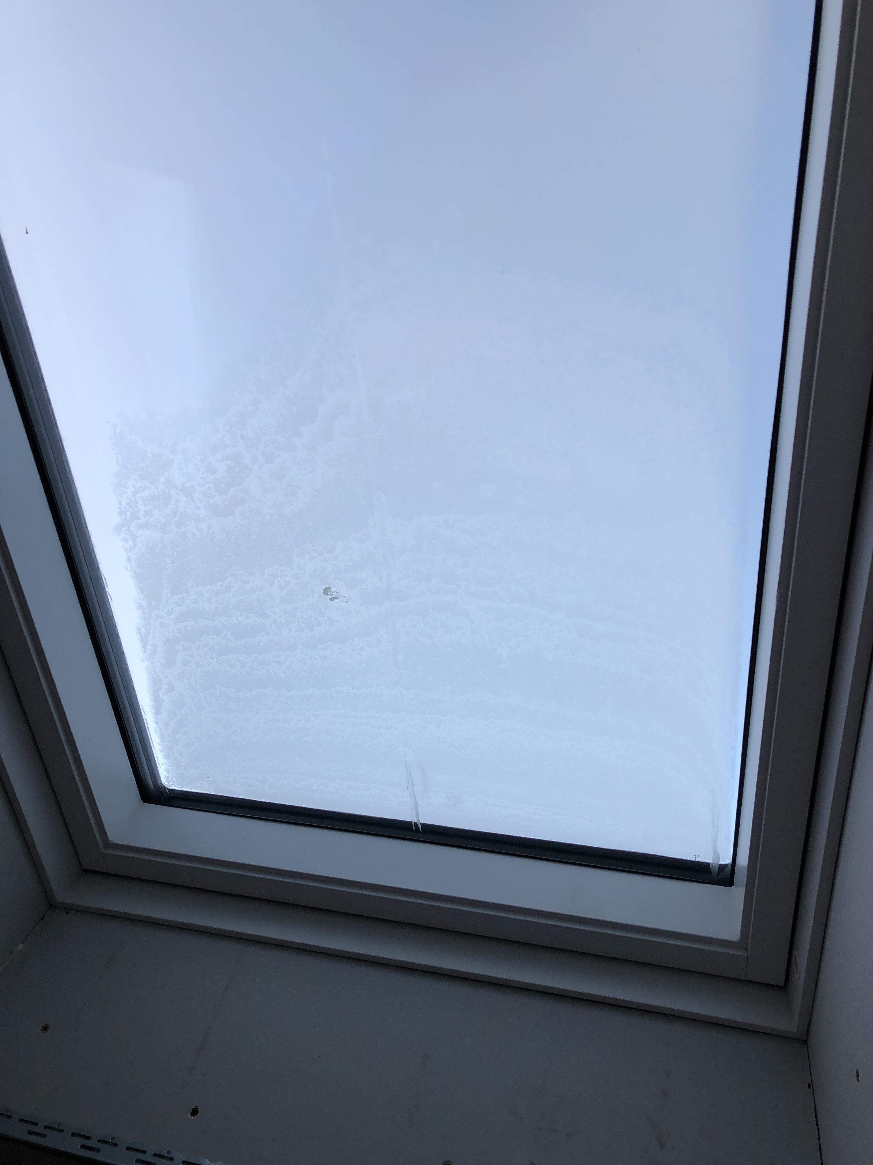

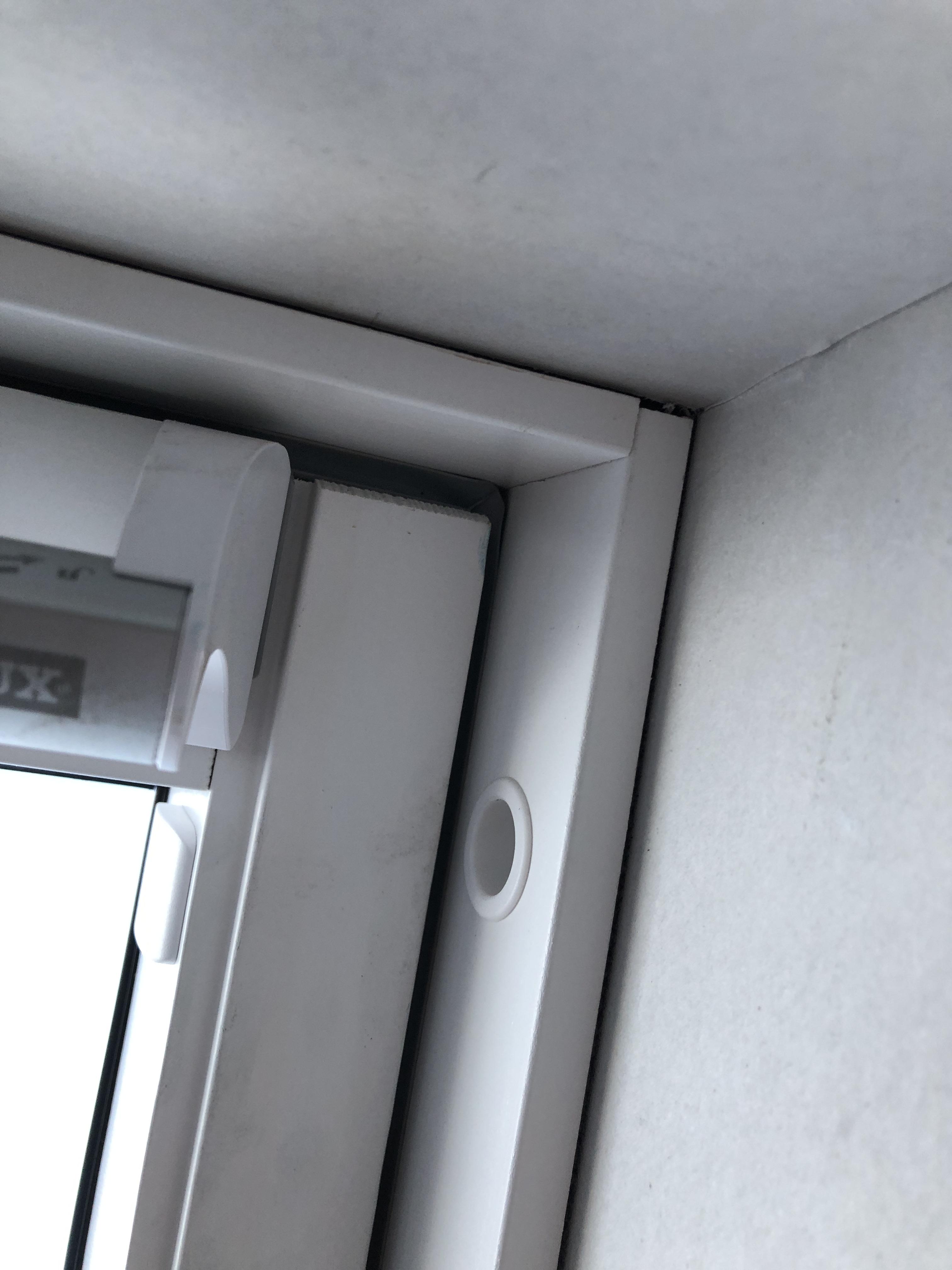

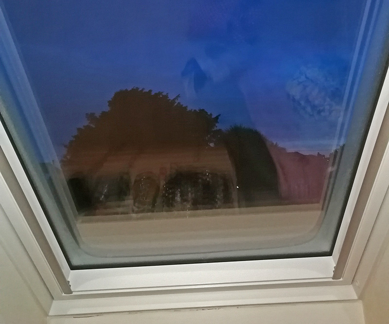

Sparrowhawk Posted January 17, 2023 Share Posted January 17, 2023 We had two new Velux UPVC windows fitted in November 2022 and went with the 62 glazing as top of the range. Codes: GGU PK10 0062 with BDX PK10 2000 When -1C/-2C outside we've had condensation on parts of the frame, and I thought they had slight air leaks at the top. So I got the installer back who said "nothing to do with me" and raised with Velux Technical support. Velux technical support have said that "Condensation is an environmental issue, there is too much moisture within the room. You have used BDX collars so we know the window has been insulated properly." Photos from today The room was at 61% RH at 10.2C this morning. -1C outside according to the Met office, feeling like -6C. In the top 4 corners, we get corner condensation on the frame. This is where I thought/think there were air leaks, assuming that was cooling them down: At the bottom on both sides of both windows, for 8 inches up from the corner we get condensation: The glazing gets some condensation round the edges of the entire window, but I was expecting that (triple glazing isn't a miracle, right) So... Is this normal/expected? If it was too much moisture within the room as Velux say I'd expect condensation around more of the frame, not specific areas. As a comparator we had a third Velux replaced at the same time in a different room in the same aspect. It's a cheaper GGU PK10 0068 with EW PK10 6000 and has no condensation issues (but is in a room we don't sleep in). RH in that room this morning was 54% at 11.1C. Link to comment Share on other sites More sharing options...
MikeGrahamT21 Posted January 17, 2023 Share Posted January 17, 2023 Mine are the 66 variety, and painted rather than PU. Its currently -4C outside, room is 15.8C and 51% RH and i've nothing on mine, just ice on the outside. Your window seals haven't been adjusted right, you see where its kind of folding back on itself on the right, you need to pull the top seal to the left to get this out. The strip of condensation on the straight bit is odd tho, must be something different there for it to collect in that specific place, and it'll likely be installation. Link to comment Share on other sites More sharing options...
Redbeard Posted January 17, 2023 Share Posted January 17, 2023 Yes, that's not right. The fact that you have condensation on some of the frame and not on the rest suggests a local shortcoming. As far as the condensation on the glazing goes I don't know the glazing spec but my triple-glazed (3G) windows (some 4/18/4/18/4/soft-coat Low E/Argon and some same spec but 16mm and 20mm spacers respectively) have *never* had any internal condensation*. What's the make-up of the Velux 3G unit? * Loads (frozen) on the outside!! Link to comment Share on other sites More sharing options...

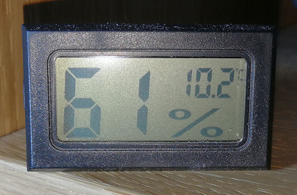

Conor Posted January 17, 2023 Share Posted January 17, 2023 We would get the same if the trickle vent is left open. Cold air falls in and causes condesation at the top of the frame. If it's closed, nothing, except a bit after a got shower. But a 10c ambient temperature hints at some serious heat loss / air infiltration. Link to comment Share on other sites More sharing options...
Sparrowhawk Posted January 17, 2023 Author Share Posted January 17, 2023 10 hours ago, MikeGrahamT21 said: Your window seals haven't been adjusted right, you see where its kind of folding back on itself on the right, you need to pull the top seal to the left to get this out. I thought so! Velux said (direct quote) "The seals look fine" when I raised this. Link to comment Share on other sites More sharing options...
Sparrowhawk Posted January 17, 2023 Author Share Posted January 17, 2023 10 hours ago, Redbeard said: Yes, that's not right. The fact that you have condensation on some of the frame and not on the rest suggests a local shortcoming. As far as the condensation on the glazing goes I don't know the glazing spec but my triple-glazed (3G) windows (some 4/18/4/18/4/soft-coat Low E/Argon and some same spec but 16mm and 20mm spacers respectively) have *never* had any internal condensation*. What's the make-up of the Velux 3G unit? I've been unable to track down the makeup, their brochure says: Thermal transmittance window Uw 0.92 - 1.0 Thermal transmittance glazing Ug 0.5 Energy transmittance g 0.47 The other Velux we had replaced in the Study has had ice on it all day long. Link to comment Share on other sites More sharing options...

Sparrowhawk Posted January 17, 2023 Author Share Posted January 17, 2023 10 hours ago, Conor said: We would get the same if the trickle vent is left open. Cold air falls in and causes condesation at the top of the frame. If it's closed, nothing, except a bit after a got shower. Re trickle vent that's a really good point. I knew I'd seen this kind of condensation before on a frame, and that reminded me it was when I left a trickle vent open (on other windows in a previous house). 10 hours ago, Conor said: But a 10c ambient temperature hints at some serious heat loss / air infiltration. Welcome to my story Last night the windows were shut in the bedroom & en-suite, but I married a woman who likes a cold bedroom, so (until today) the heating's been off in there. And the ceiling mounted extractor fan in the en-suite lets a draught in. Mind, by morning the rest of the house was 9-11 degrees so yes there's serious heat loss / air infiltration going on. Link to comment Share on other sites More sharing options...

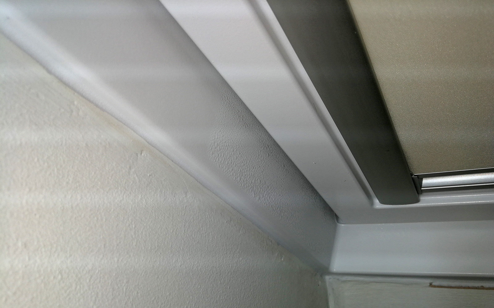

Radian Posted January 17, 2023 Share Posted January 17, 2023 13 hours ago, Sparrowhawk said: If it was too much moisture within the room as Velux say I'd expect condensation around more of the frame, not specific areas. There seems to be a very sharp cut-off in condensation part way up the left hand side of the frame. This side seems to butt up directly with an internal wall. I'm wondering what the build-up of this is and if there's a substantial cold bridge here. I forget, do you have an IR camera or thermometer? Link to comment Share on other sites More sharing options...

Sparrowhawk Posted January 18, 2023 Author Share Posted January 18, 2023 (edited) 10 hours ago, Radian said: There seems to be a very sharp cut-off in condensation part way up the left hand side of the frame. This side seems to butt up directly with an internal wall. I'm wondering what the build-up of this is and if there's a substantial cold bridge here. I forget, do you have an IR camera or thermometer? I need (okay want) to get an IR camera but I do have an IR thermometer. After wiping the condensation off the bottom part of the frame on both windows, that part measures 7.5C. The rest of the frame up the side of both windows measures 9.5C-10.1C (close to room temperature). These sides are butting up with the roof construction which is 50mm PIR between rafters. My guess for the bottom section is the installer hacked back the PIR too enthusiastically and didn't foam up to the window. Could be the same at the top, but the Velux foam collar should've dealt with this I'd have thought. Edited January 18, 2023 by Sparrowhawk Clarification Link to comment Share on other sites More sharing options...

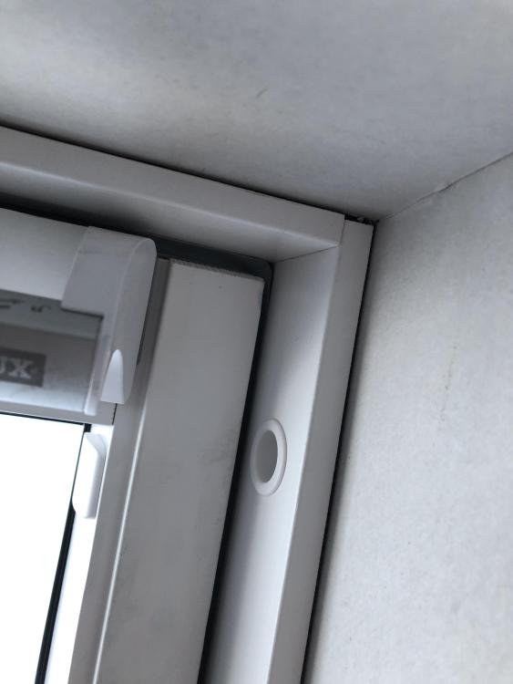

Sparrowhawk Posted January 19, 2023 Author Share Posted January 19, 2023 (edited) Velux have responded. Oh dear. My message to them, photos removed as same as above Quote Hi, Thanks for your reply. With regards to how I established air leakage, it was with a wet finger and an assumption due to the location of the condensation. I spoke with other Velux owners who say they only get condensation at the top of the frame if they leave the trickle vents open, so air flow seemed most likely. I disagree with the condensation being an environmental nature, as the photos taken today and included below show it is localised to parts of the frame. The room was at 61% RH at 10.2C this morning. -1C outside according to the Met office, feeling like -6C. In the top 4 corners, we get corner condensation on the frame. This is where I thought/think there were air leaks, assuming that was cooling down the PU: [Photo] At the bottom on both sides of both windows, for approx 8 inches up from the corner we get condensation. Above this, no condensation until the top corners. [Photo] I do not think that patches of condensation on the frames of your premium windows is expected. A photo of the 0062 3G glazing with condensation round the edges [Photo] By contrast the other Velux that was replaced in the Study (same roof, same aspect) was covered in ice externally this morning and had no condensation on the PU frame, and just 1cm x 1cm of condensation in the corners of the window glass. RH in that room was 54% at 11.1C. As I write this email at 1.30pm the heating is on full blast and it's still got ice on it. I do not have a thermal camera here at present to take measurements. Can you provide the emissivity of the glazing and PU frame for accurate calibration? Kind regards, Peter And their response: Quote Good Morning, Thank you for contacting VELUX. Condensation is an environmental issue. The problem is that you now have a window that is performing the best that it can and is keeping all heat within the room. This is proven with the fact you said the heating was on full blast and there is still ice externally. It is almost completely air tight but at the small points where it is not the moisture within the room will be causing condensation to form. This is worsened if the ventilation bar is left open as it can cause the internal sections of the window to feel cold. Naturally there will be more moisture in a bedroom in comparison to a study because of the amount of moisture caused while sleeping. You need to ensure the ventilation bar is closed and instead the windows are regularly fully opened throughout the day and this will reduce the condensation. It is not a product fault, it is the window performing well and it is noticeably different because the windows it has replaced would be no where near as thermally efficient. Please do not hesitate to contact us for further assistance. Kind Regards, Edited January 19, 2023 by Sparrowhawk Link to comment Share on other sites More sharing options...
Redbeard Posted January 19, 2023 Share Posted January 19, 2023 "It is almost completely air tight but at the small points where it is not...." Errrr....... Good luck with the 'negotiations'. Of course they may not entertain comparison with others' products but what your pics show is not typical. 1 Link to comment Share on other sites More sharing options...

Radian Posted January 19, 2023 Share Posted January 19, 2023 On 18/01/2023 at 08:29, Sparrowhawk said: These sides are butting up with the roof construction which is 50mm PIR between rafters. My guess for the bottom section is the installer hacked back the PIR too enthusiastically and didn't foam up to the window. Could be the same at the top, but the Velux foam collar should've dealt with this I'd have thought. Could do with a photo showing the velux in context with the reveal and roof but the rafters must be in the region of 175mm? With only 50mm PIR between rafters (none underneath the plasterboard crossing the rafters?) some of the reveal would seem to be flanked by almost direct contact with outside air (assuming ventilated rafters). Link to comment Share on other sites More sharing options...
