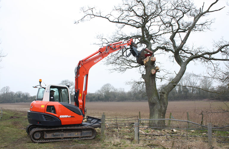

Iceverge Posted January 10, 2023 Share Posted January 10, 2023 Whats the budget for the digger? I had a 7,5t tracked Sumitomo excavator and now a Massey 860 backhoe. The 7.5t was fine for everything apart from digging big holes in the ground. It got particularly good at bursting hoses ,pinging seals and throwing off tracks towards the end. The backhoe is awkward and slow for any back actor work but the front loader works fine. Beware any soft ground however. It goes down like the titanic. It too likes bursting hydraulic hoses. Is it an option to get a tracked excavator + tree shears and operator on hire to take to down the trees? Cheaper, faster and much safer for all involved. 1 Link to comment Share on other sites More sharing options...

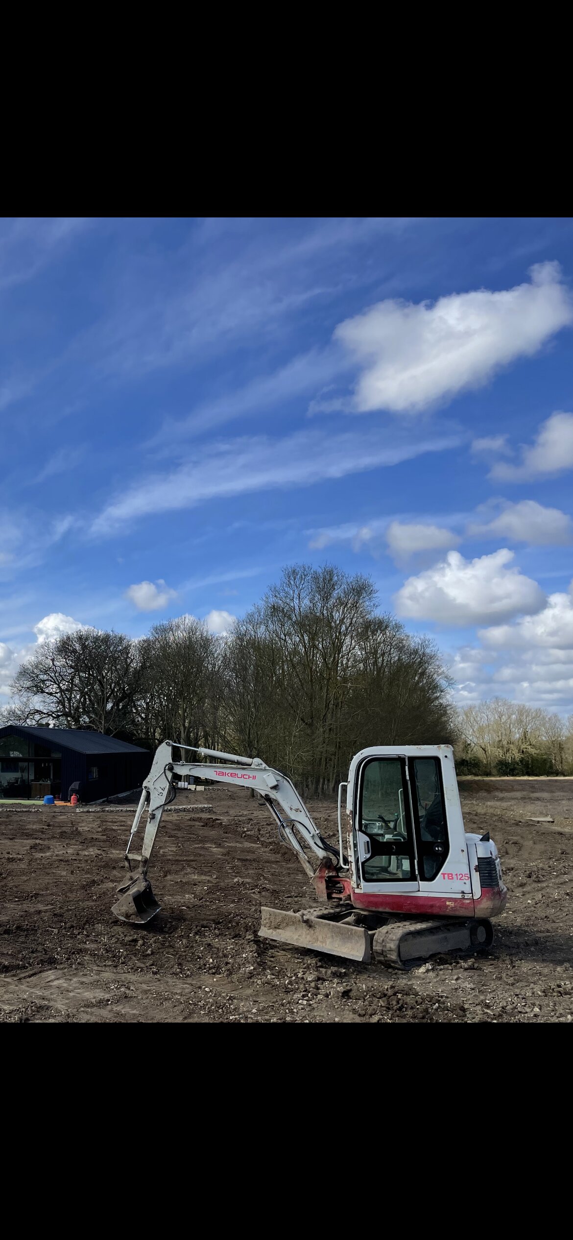

ProDave Posted January 11, 2023 Share Posted January 11, 2023 If we are doing digger pics, this was mine. That was digging the hole for the treatment plant, almost at full reach down into the ground, a smaller digger with less reach would have struggled. And on the subject of maintenance, the astute will notice a steel bar forming a temporary pin for the boom. It had just sheered it's original pin and this was the best I could muster up to get the job done until I could replace the pin properly. It was somewhat floppy like that!!!! It was a very old 3t Komatsu. Not what I was really looking for but it came up on ebay, and I put in a silly low bid and won it for £2500. It was old and worn but it worked, did everything I asked it to and I sold it for £2500 when finished. 2 Link to comment Share on other sites More sharing options...
