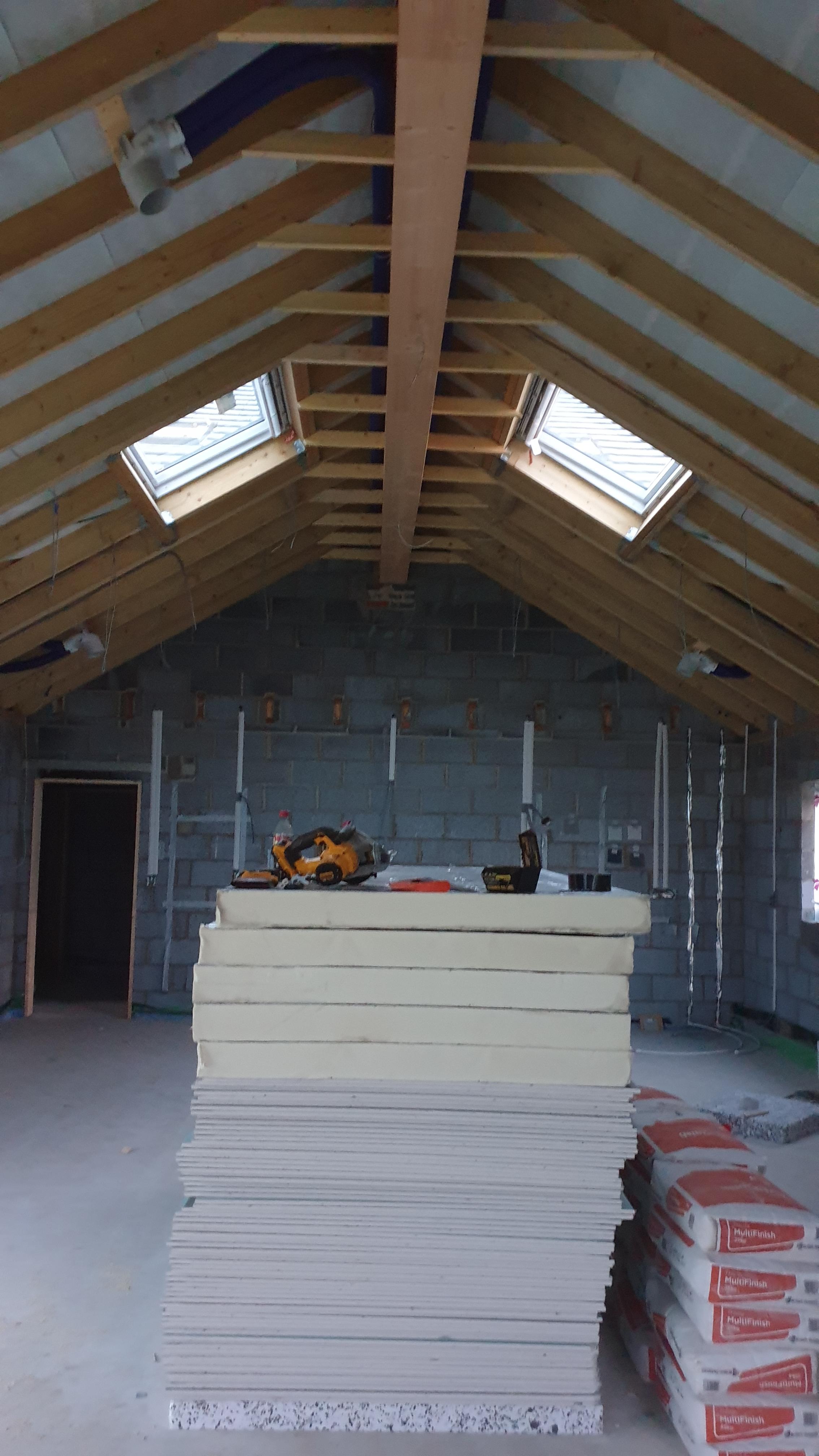

JohnMo Posted December 12, 2022 Posted December 12, 2022 Some light reading Atamate_SDAR+Paper+2019+(1).pdf On MVHR, we used posi rafters and strung the pipes through the gaps. We also made good use of coanda effect terminals.

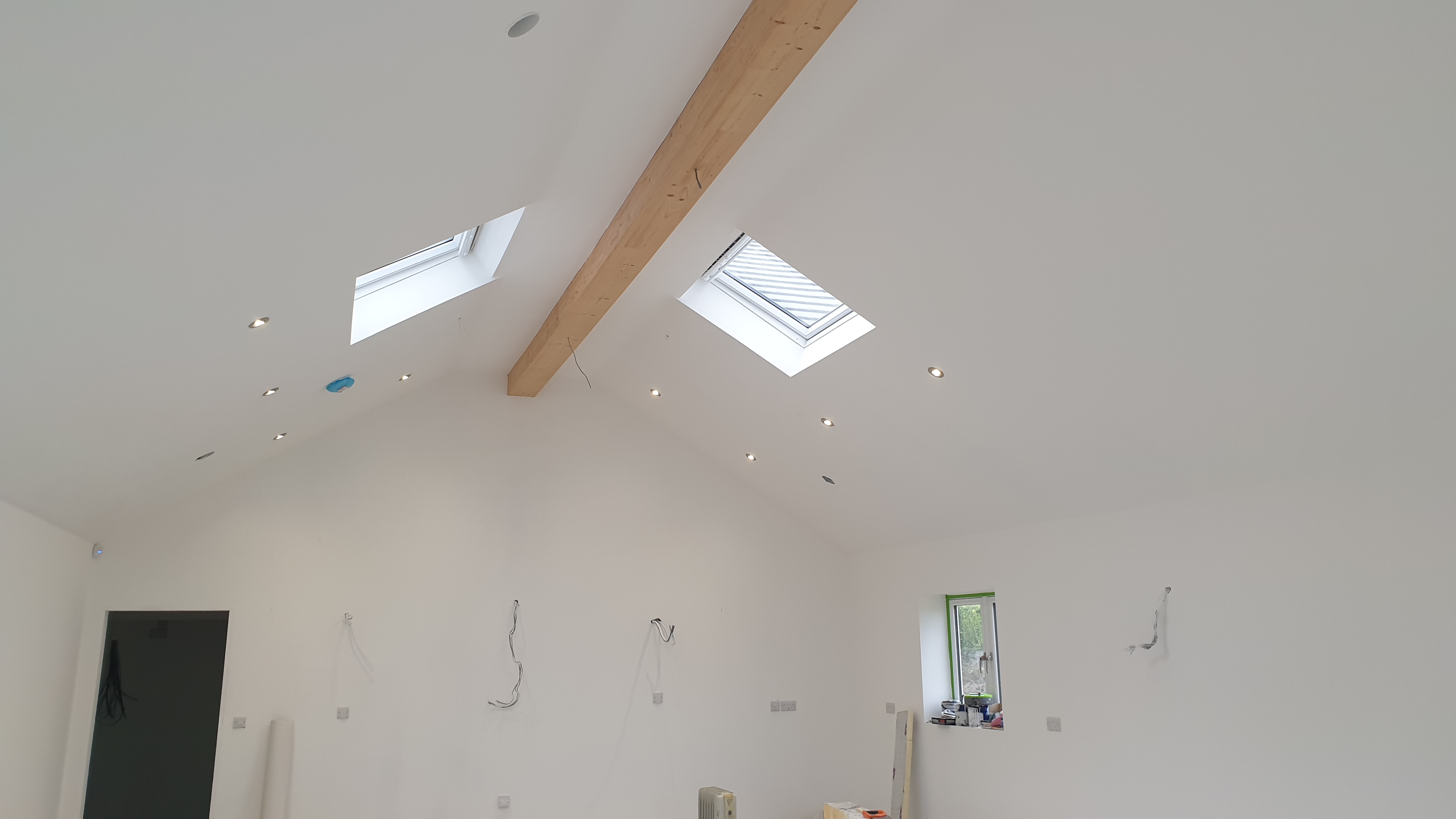

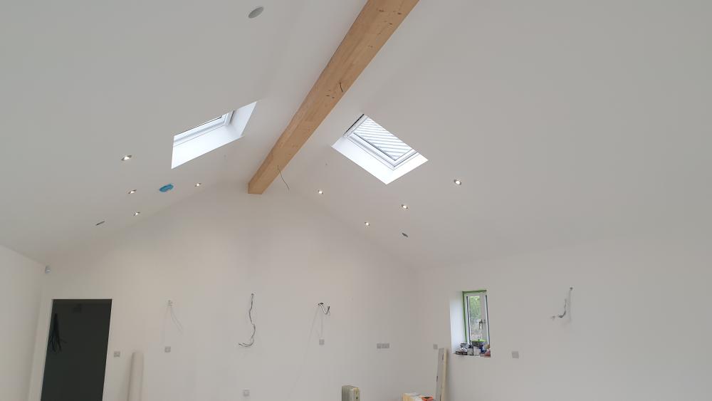

Buzz Posted December 12, 2022 Posted December 12, 2022 20 hours ago, Dean Mc said: can it still be fitted without roof / loft voids ? This is what I ended up doing , the void is lower than it needed to be but looked right for the room. 1
Dean Mc Posted December 14, 2022 Author Posted December 14, 2022 On 12/12/2022 at 18:20, JohnMo said: On 12/12/2022 at 18:20, JohnMo said: Some light reading Atamate_SDAR+Paper+2019+(1).pdf 2.47 MB · 11 downloads On MVHR, we used posi rafters and strung the pipes through the gaps. We also made good use of coanda effect terminals. On 12/12/2022 at 19:08, Buzz said: This is what I ended up doing , the void is lower than it needed to be but looked right for the room. Thanks JohnMo, I'll have a flick through. Hey Buzz, thank you. Are you still WIP or do you have any images of it all boarded and covers fitted?
Buzz Posted December 14, 2022 Posted December 14, 2022 45 minutes ago, Dean Mc said: Hey Buzz, thank you. Are you still WIP or do you have any images of it all boarded and covers fitted? Not got around to fitting the covers yet.
Dean Mc Posted December 14, 2022 Author Posted December 14, 2022 That looks perfect. Would be interested to see with covers on. One of my concerns is that as the vaulted ceilings are a feature, putting extra covers and fittings on there may have spoiled the affect.
