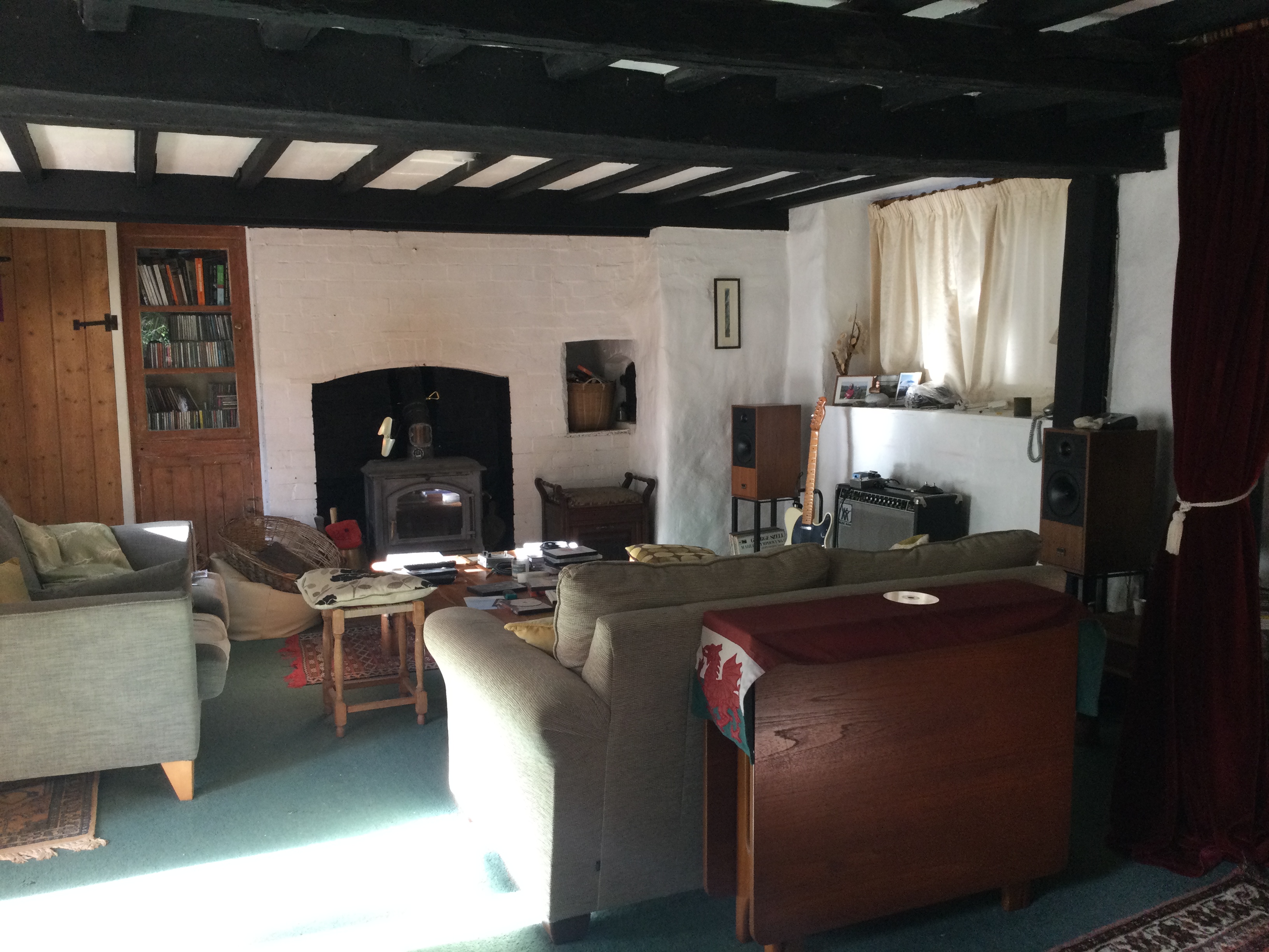

zoothorn Posted December 8, 2022 Posted December 8, 2022 (edited) Hi chaps, been meaning to propose this idea, for your expert opinions. An idea gaining traction as my build 'experience' does. Ok. My 1830 welsh stone cottage is a 6.5m x 5m rectangle. Low ceiling. Onto this main "shell", are 3 extentions, only 1 having insulation (2019). The other two 1970's extensions, are ontop (2 beds). And a ground floor addition (WC, kitchen). The huge overbearing issue is cold, in the main rectangle/ largish sittingroom. I also have the same issue in the two 1970's extentions: a camera showed just 1" of PIR, & none upstairs with 6" cavities behind plasterboard leeching cold loft air down. Now, I cannot feasably redo the upstairs extention ( without ripping out all pB & redoing with thick PIR), nor the ground floor extention (without removing all kitchen & WC fittings, excavating floors & laying 100mm PIR). So forgetting these two extentions (I don't sleep in either bedroom too.. & my kitchen & WC will always be unbearably cold. I Lump it). The one feasable room is main stone sittingroom 6x5 "shell", which I use having my 8.5kw stove in. It's so cold I run it at 375*F for 3hrs.. & back of room only achieves 16*C (my couch remains cold, as does my head, legs, back.. even a hottie on my back, hat & scarf on). Infuriating. PIR-lining the walls' interior? No, due to character loss, & space loss. So. The only option is excavate the main floor, is my thinking, & either A) add 100mm PIR, concrete cap it back to same level. Or B) add PIR -&- underfloor heating/ the whole hog idea. So firstly: is excavating & redoing either way.. a feasable job prospect? I have no clue. The main problems afaict: 1) I don't know if there is actually any PIR under this old floor as it is: daft to redo it & it makes no difference. 2) If it doesn't have (or say has 1" at best) how do I know the cold isn't 90% pouring in via the side walls instead, & so I'd be flogging a dead horse for zilch. Thanks for reading, Zoothorn. Edited December 8, 2022 by zoothorn
zoothorn Posted December 8, 2022 Author Posted December 8, 2022 As you can appreciate, there's alot if character to the inside walls. And it's not hugely wide either as it is.

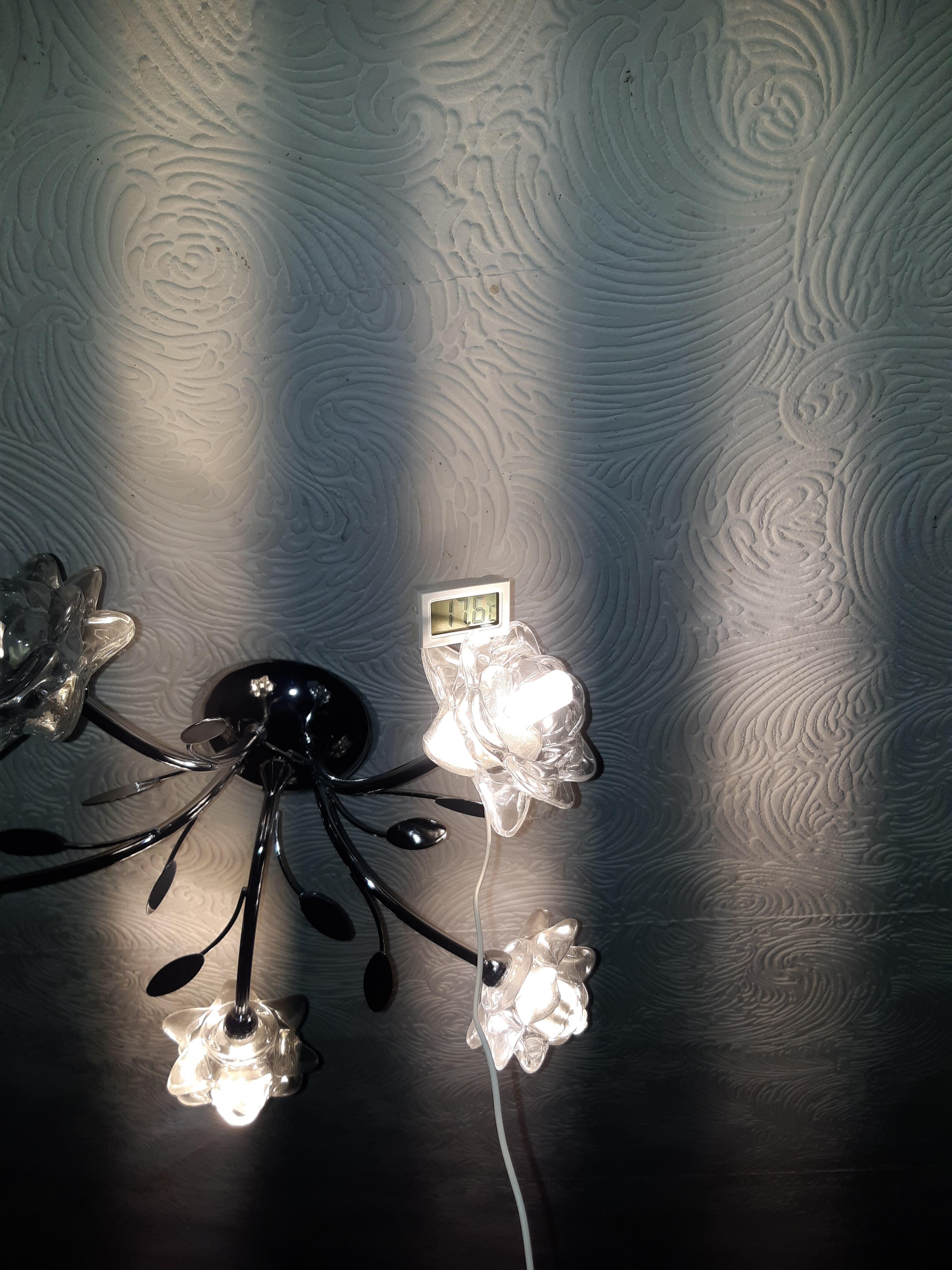

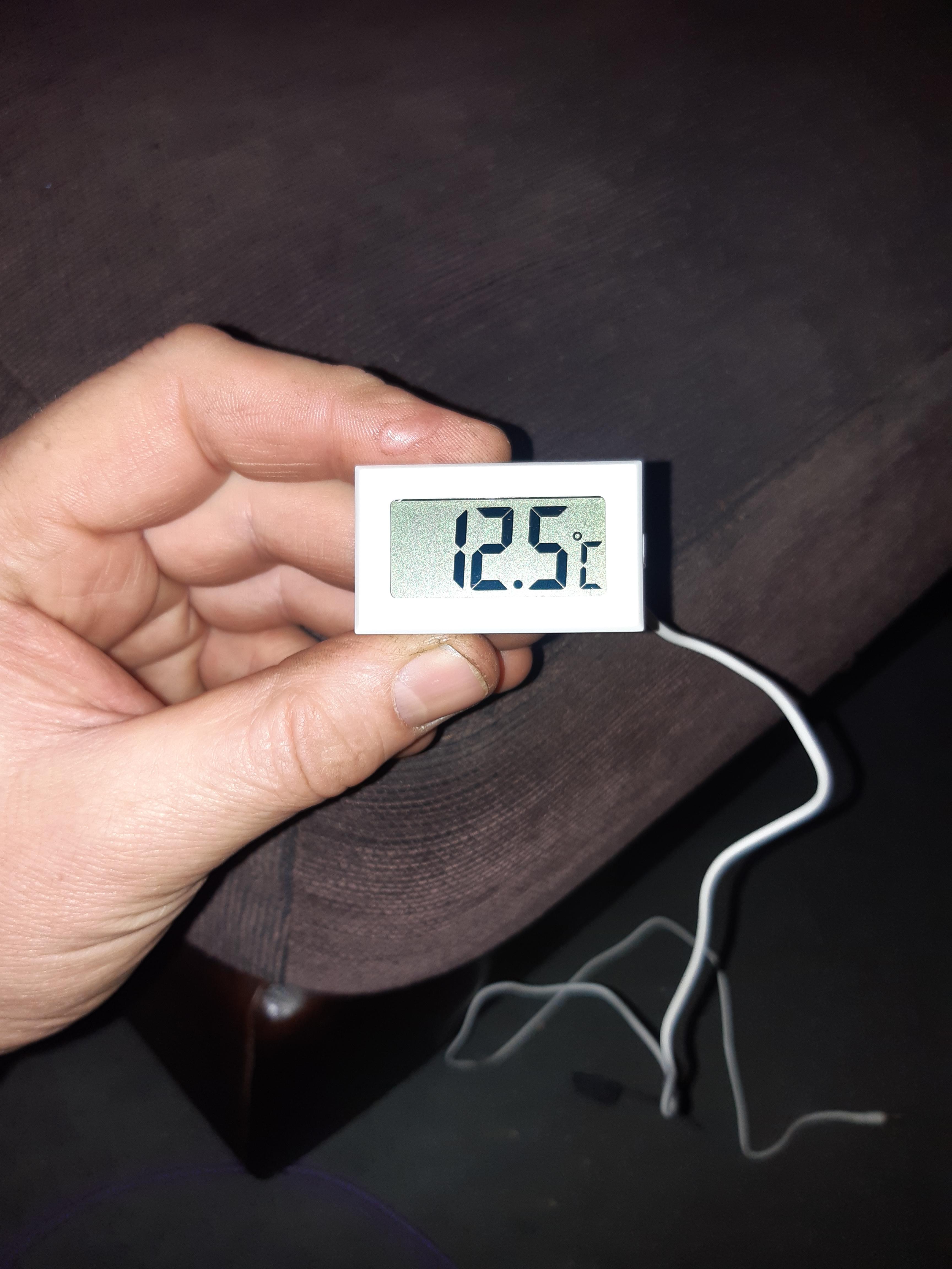

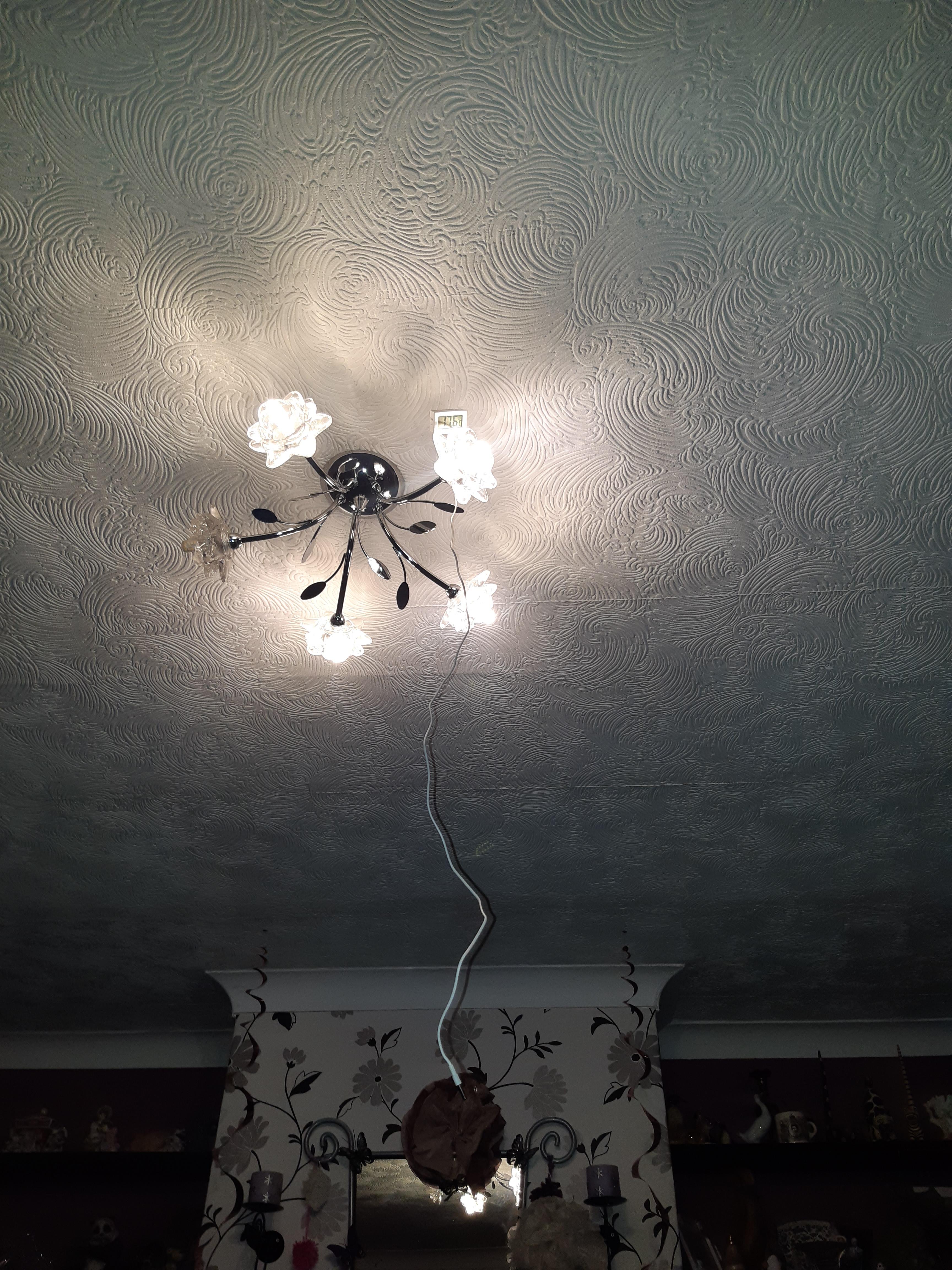

Onoff Posted December 8, 2022 Posted December 8, 2022 @zoothorn I feel your pain. This is my lounge with the probe sat on the floor: Then with the same probe hanging off the light fitting. The probe is about 5' from where it was on the floor. Quite a big issue here is the suspended wooden floors. Cold air just comes in through the air bricks and up through the uninsulated floors, through plug sockets, around skirting etc. Gutting sat here with a beanie on and under a blanket KNOWING what needs to be done and having the ability to do it. It all needs gutting back to the dirt at floor level, the joists in the ceiling and the bare brick/block walls. SWMBO just won't buy into doing it yet will happily burn through oil and sit moaning how cold it is. 1

zoothorn Posted December 10, 2022 Author Posted December 10, 2022 @Onoff I'll take a temp reading at different points in my mainroom tonight, like yours. The floor lowest 2ft defo feels like a pool of cold. 12.5*C for you though? Jeepers I thought only my bad luck encountered such temps. At the moment.. 6.8*C in my mainroom typing this, hottie on my back. Freezing nose & hands. No heating on. Im just about happy enough, spinning a few records even so: I'm so used to the cold it's just 'normal' after 6 yrs. [My cabin in comparison last ev.. 28*C ! Super toasty, t shirt & shorts, real luxury: & 0*C outside, at the most].

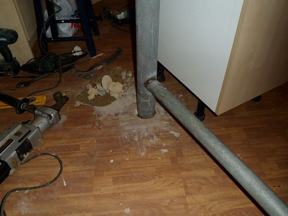

Onoff Posted December 10, 2022 Posted December 10, 2022 My kitchen floor is about 4 or 5 inches higher than the rest of the house. The previous owner had a damp issue so laid a plastic sheet down and poured a slab. When I cored out the "new" slab for the breakfast bar leg it had the old floor lino under the slab.
