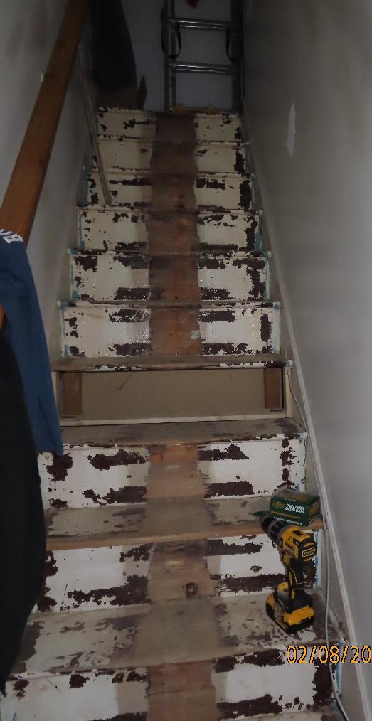

JohnBishop Posted December 19, 2022 Author Share Posted December 19, 2022 I had a bit of thinking and making and installing those drawers is a job for a pro especially if this is done between two solid walls so I am going to look into converting the stairs into cupboard units instead - a lot simpler. I think lower steps will have doors on the side and upper steps will become a door in itself so items can be put from above. Not sure if you have ever come across such solution. Link to comment Share on other sites More sharing options...

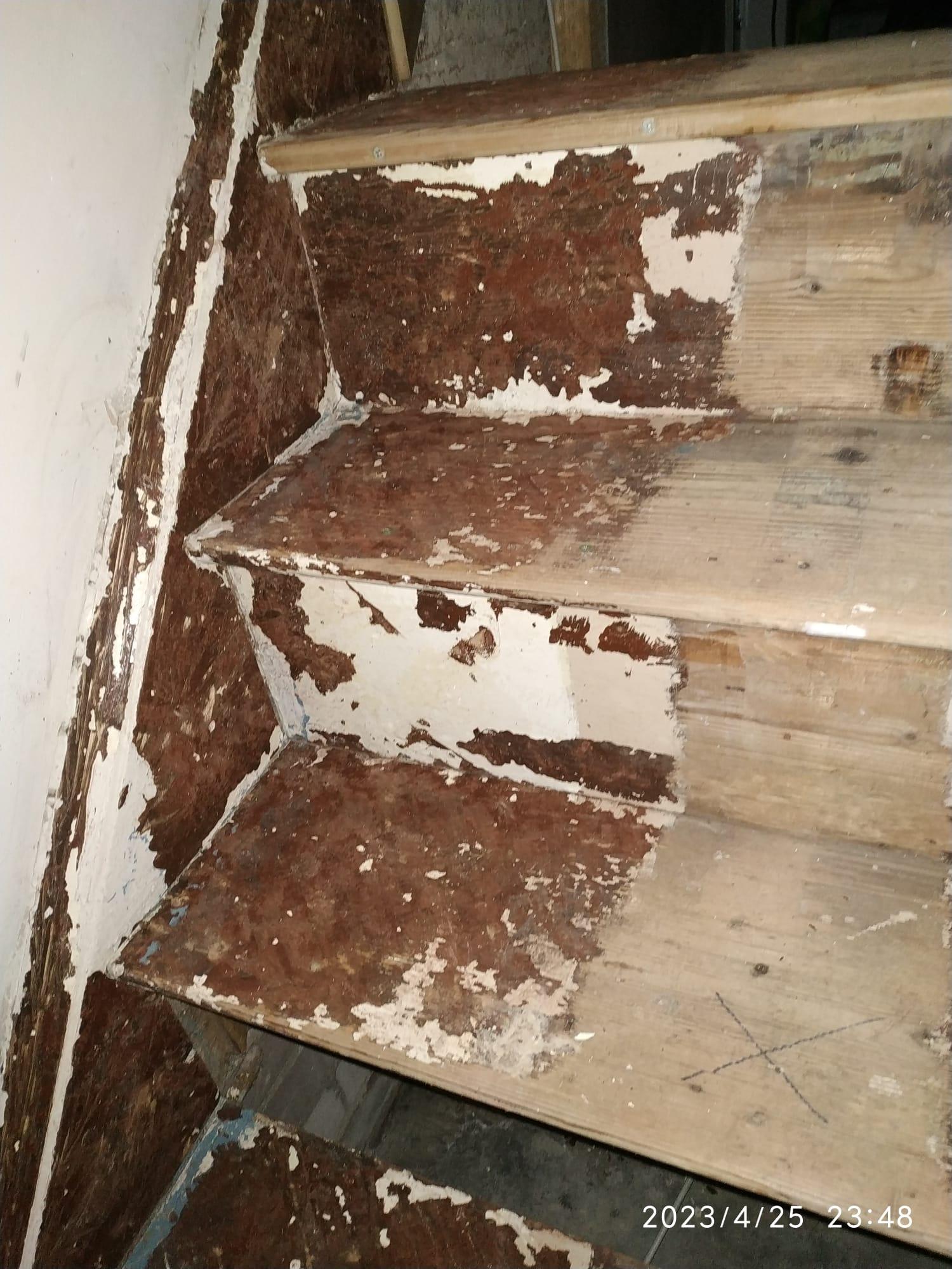

JohnBishop Posted April 8, 2023 Author Share Posted April 8, 2023 My latest idea and I think the easiest is to fit little doors on every other 2nd step and convert the space into 2 step high compartments. Since I convert these old stairs and each step relies on the other I have to ground or wall support the boards above and below the little doors. It could well be the compartment includes also the step above then 3 step compartments, doors every 3rd step. I won't do it to the very top but only halfway down because as you can see on the picture there is a space for the fridge behind the plasterboard from the kitchen side. Link to comment Share on other sites More sharing options...

JohnBishop Posted April 26, 2023 Author Share Posted April 26, 2023 It is my second day of removing the old paint and I am not even half way! I have a heat gun but using it indoor isn't a good idea besides it's like 4 layers of paint. Link to comment Share on other sites More sharing options...
