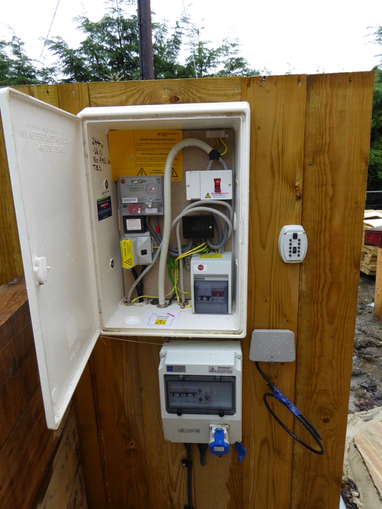

Jeremy Harris Posted July 4, 2017 Posted July 4, 2017 Welcome, As @Crofter, says, a few of us have opted to fit the meter cabinet in a wall or fence away from the house, so that we could avoid either paying for a temporary site supply on top of the permanent connection, and because in many ways it makes life a bit easier. We fitted a meter box in a thick timber fence that acts as the screen for our wheelie bins now, and fitted a caravan outdoor consumer unit, with a Commando socket on it, as a temporary site supply. Here in England this was a two stage process. I had to get the DNO (SSE in our case) to run a cable to the right place, then contracted with a supplier to install the meter and connect it. @ProDave did much the same, and he's in Scotland too, so may well be able to shed some light on how things work there. 1

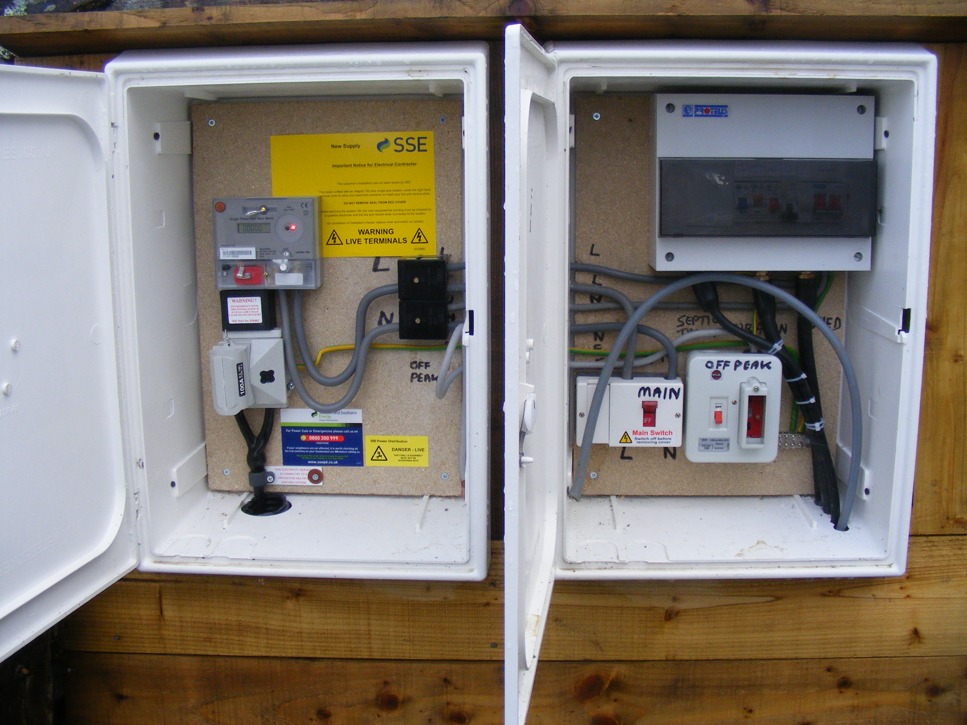

ProDave Posted July 5, 2017 Posted July 5, 2017 The 3 metre rule is when you have no switch or isolator so the cables are only protected by the suppliers fuse. It's not a wiring regs thing. it's a supply company rule. You can have any length you want if you fit your own switch fuse. Since you like pictures, here is mine. The switch fuse I am talking about is in the right hand box labelled "main" in my case with an 80A fuse in it.
Jeremy Harris Posted July 5, 2017 Posted July 5, 2017 I was a bit cheeky and stuffed everything into one meter cabinet, something that has been known to cause raised eyebrows with the supplier, but which isn't actually against any rules, as you own the cabinet, not them: The 80A fused isolator is at the top right, and feeds a length of 25mm² three core SWA that runs underground and into the house services area, where there is a ten way consumer unit. The two way consumer unit at the bottom right feeds the outside stuff, including the caravan box underneath that has the 16 A Coommando socket that was used as a temporary site supply.
