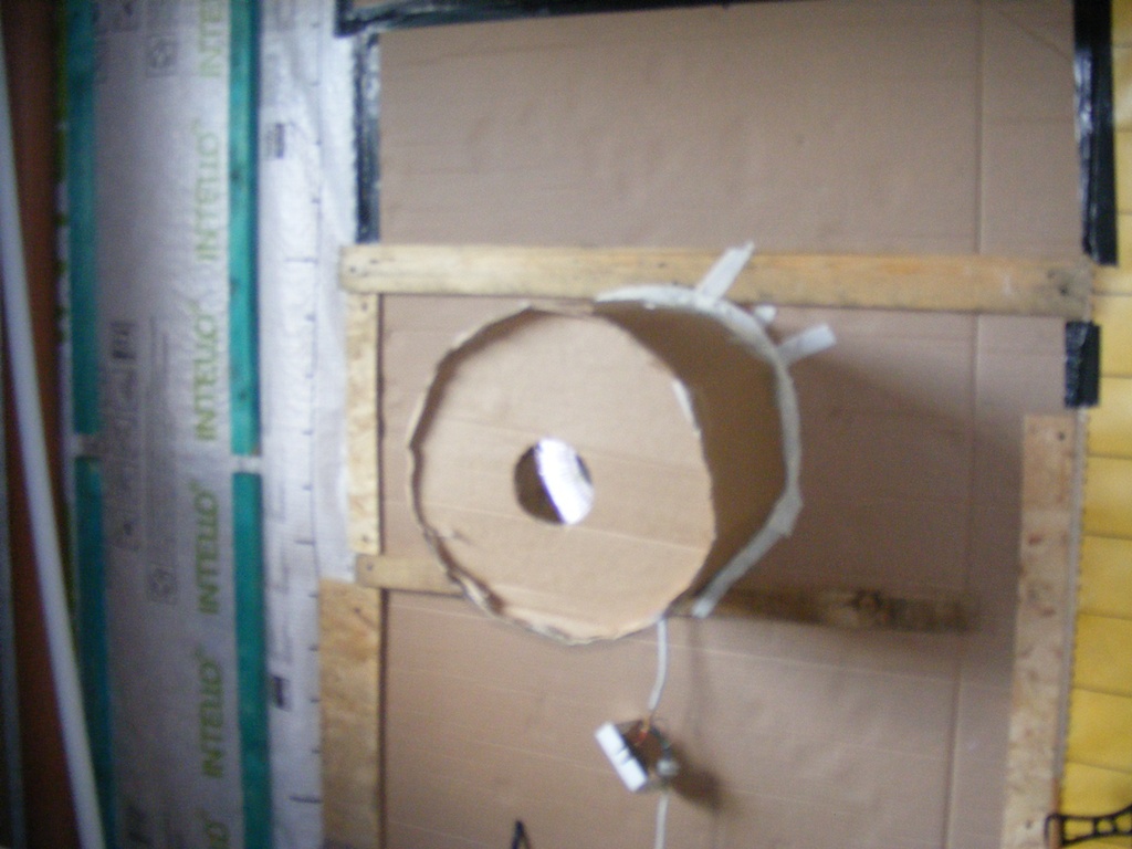

ProDave Posted July 1, 2017 Share Posted July 1, 2017 Something I have been wanting to do for a while is see how air tight I have managed to make the house, but without paying £hundreds for an official test. So take one old desk fan. Some bits of wood. A large piece of cardboard and a roll of duct tape. The first thing was just to run the fan on full speed and go around the house looking for leaks. I found a leak under the front door where it was not sealed to the floor properly. A leak in the loft at a tricky detail between the ridge beam and the OSB cladding, and a leak around where the mains comes in and cables go out under the floor. All fixed with a bit more tape and detailing. So now I have a house where there is no perceivable leaks coming in anywhere. The flow going out of the fan seems very small, and it's certainly holding a good pressure (if you open a door you can feel the rush of air enter, and hear the fan note change as it is no longer working hard) Time to try and measure something? Firstly the pressure. Normally an air tightness test is done at 50Pa. It was only when I looked up the conversion I realised that's a tiny pressure, about 2mm water gauge. So I set up my manometer, one side connected to "outside" the other side vented to the room. It's very hard to accurately measure 2mm on a U tube manometer, but I am sure it was somewhere between 2 and 3mm. So in the right order. How to measure the airflow? Simple. Just measure the air flow rate through the fan. Well my little anemometer would not register the wind speed entering the fan, it was too low to get it's impeller turning. So I had to do something to increase, the airflow. Decrease the area, AKA the "flower pot" principle. I didn't have a 15" flower pot, so I made one. The hole in the "top" is 110mm (because a bit of drain pipe was handy to draw around) Now the air flow was high enough to measure. 2.9 metres per second. A 110mm diameter hole has an area of 0.038 M2 So that gives a volumetric flow of 0.11M3 per second That's 6.6 M3 per minute or 396M3 per hour. Now my house has a volume of 480 M3 So that equates to 0.825 Air changes per hour. I'm actually a little disappointed with that. I had hoped for better. But let's not kid ourselves that this was in any way an accurate measurement. At least it enabled me to find and fix a couple of air leaks, and I am now reasonably certain there are no air leaks of significance. Feel free to tear the method or results to pieces. 8 Link to comment Share on other sites More sharing options...

ProDave Posted July 2, 2017 Author Share Posted July 2, 2017 10 hours ago, MikeSharp01 said: Great work Dave. How did you detect the leaks? Just went round feeling for them, a very long and tedious process. I was checking all joints, corners, windows, doors, cable and pipe entries. It is surprising how sensitive an almost bald head is at detecting a very small leak. Although the pressure difference seems small, you get a very noticable draught through even a small hole and in the case of a window, if you open the trickle vent in a roof window you get a howling gale that you can hear and feel easily, yet with the vent closed you can't feel or hear a thing. My main concern was to ensure that all the membrane and joints that are soon to be covered with plasterboard were leak free. In many places the membrane between the battens was blown up, inwards, showing an air leak in the fabric of the building that the air tight membrane was catching. 3 Link to comment Share on other sites More sharing options...
A_L Posted July 2, 2017 Share Posted July 2, 2017 (edited) @ProDave , is 50Pa not about 5mm on a water gauge? (5.1mm to be over picky ) Edit: or were you taking 2mm up and 2mm down on other side? Edited July 2, 2017 by A_L as in edit Link to comment Share on other sites More sharing options...

ProDave Posted July 2, 2017 Author Share Posted July 2, 2017 Looks like I ran the test at too low pressure. I did lookup the conversion some time ago on a web based converter and I am sure it told me 2mm not 5. So my test was probably only at half the required pressure for an official test. I was surprised that this little fan could generate enough pressure, it is far smaller than those used on proper blower door test rigs. That in itself I thought was a good sign. It now looks as though that fan would not get to 5mm so a bigger fan would be needed. To try this with an mvhr you would have to block either the inlet or outlet to try that test, otherwise even with one fan stopped the air would pass through the stationary fan. I still think it was a useful test even if no meaningful figures can be taken from it. I never got a Blue Peter badge as a boy. I wonder if This now qualifies me for one? 1 Link to comment Share on other sites More sharing options...

Jeremy Harris Posted July 3, 2017 Share Posted July 3, 2017 The dynamic pressure of the wind speed doesn't match the test pressure for the blower test, for a few reasons. The first is that the wind is not stopped dead by the house, so not all the dynamic pressure is converted to static pressure on the windward side of the house, only a small part of it. There's a corollary here with the Betz Limit and wind turbines - if you extract all the energy from the moving airstream (which is what full conversion of dynamic to static pressure implies) then there will be a stagnation zone on the windward side and the house will be absorbing all the kinetic energy in the wind. Clearly this doesn't happen, and the wind finds a way to flow around and over the house, so the dynamic pressure on the windward side will be a great deal lower than that implied by the wind speed. The second significant effect comes from Bernoulli's Principle. Because the wind has to flow around and over the house, the distance it has to travel is greater than if the house wasn't there. Downwind of the house the wind individual streams will join up and flow at the same velocity again, which implies that the air flow velocity over the house will have increased, so lowering the dynamic pressure. The effect of this is to reduce the pressure above and around the house, and on the leeward side, so there is an increase in pressure differential across the house, from the windward to the leeward side. However, because there is still a substantial air flow velocity downstream of the house, it's clear that, as above, the house has not extracted all, or even a significant proportion, of the energy in the wind. Working backwards this implies that the actual pressure differential that the house experiences, from one side to the other, will be a lot lower than 1/2 ρv² would suggest. If I had to guess, I would say that the worst case might be around 30% of the dynamic pressure given by 1/2 ρv² as the highest pressure differential the house would see in practice, but this will vary a great deal from one house to another, depending on the location, local terrain shape of the house, wind direction etc. On the topic of home brew pressure test fans, I made one up a few years ago to try and improve the airtightness of our old house, or at least help me find the biggest leaks. Because the air flow requirement for the fan is small, but the pressure differential is relatively high, I chose a forward sweep fan, as these tend to cope with a higher differential pressure without running into serious blade stall. I found a suitable fan in a scrap yard, a big car radiator cooling fan, but when I tried it I found that the brushed motor it came with wouldn't work well over a wide speed range. I ended up replacing that motor with a brushless DC motor and speed controller, which allowed pretty fine control of motor speed. Here's a couple of photos of the thing (it was made to fit tightly into a open window): The speed control knob allows the fan to run right down to a very low speed, to reduce the airflow rate. To measure the differential pressure very approximately I made up a sloping U tube manometer, with the sloping tube set at 30 deg, in front of a bit of paper printed up with stripey lines. The stripey lines make it easier to see the exact position of the water in the tube, as it refracts light and makes the lines look kinked. Even so, getting 50 Pa was a very rough and ready thing, and I doubt I got closer than around 20% accuracy. I did look at buying a low pressure Magnahelic differential meter, but they were a bit expensive for what was really just a rough and ready test. Link to comment Share on other sites More sharing options...
