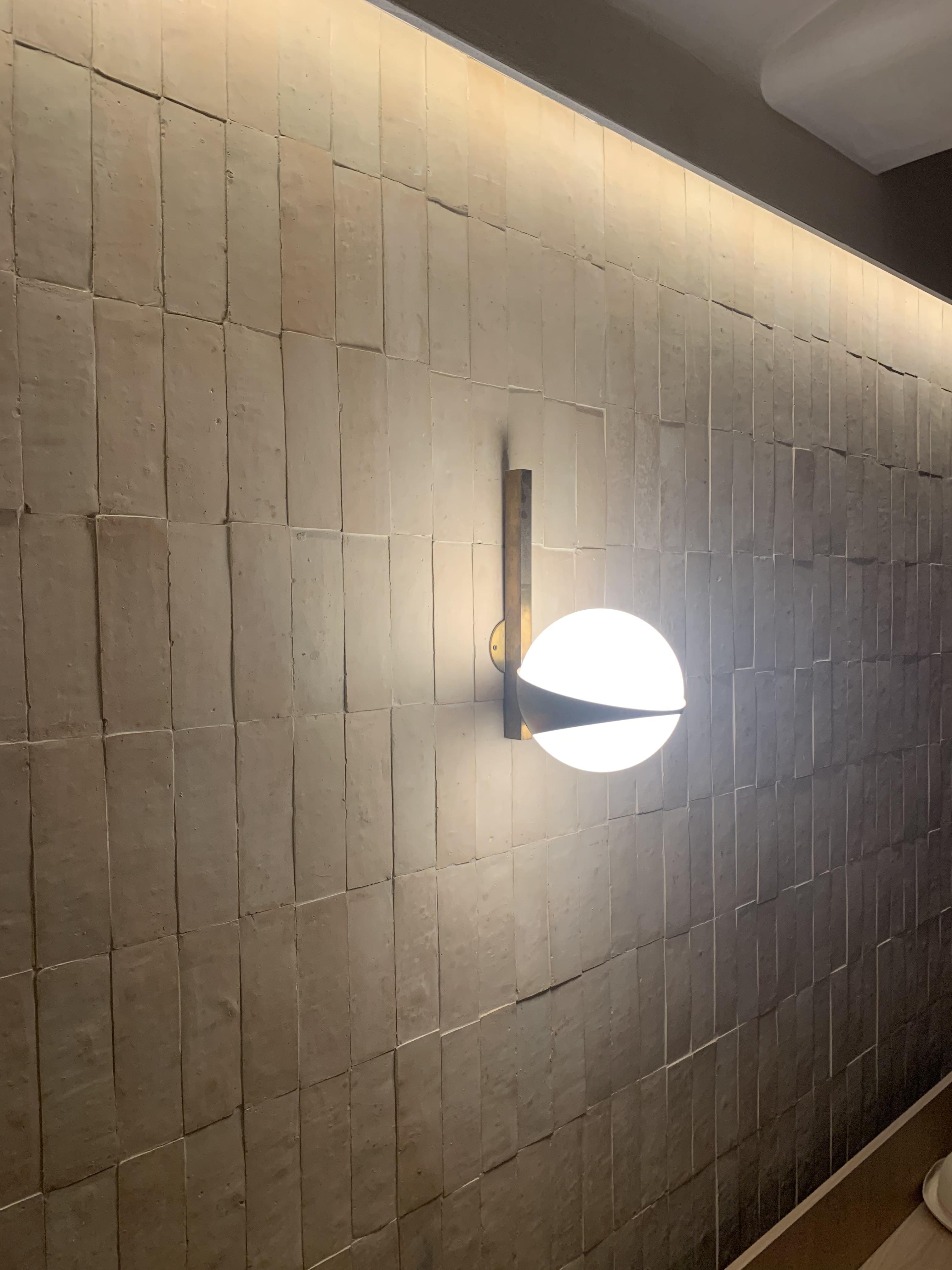

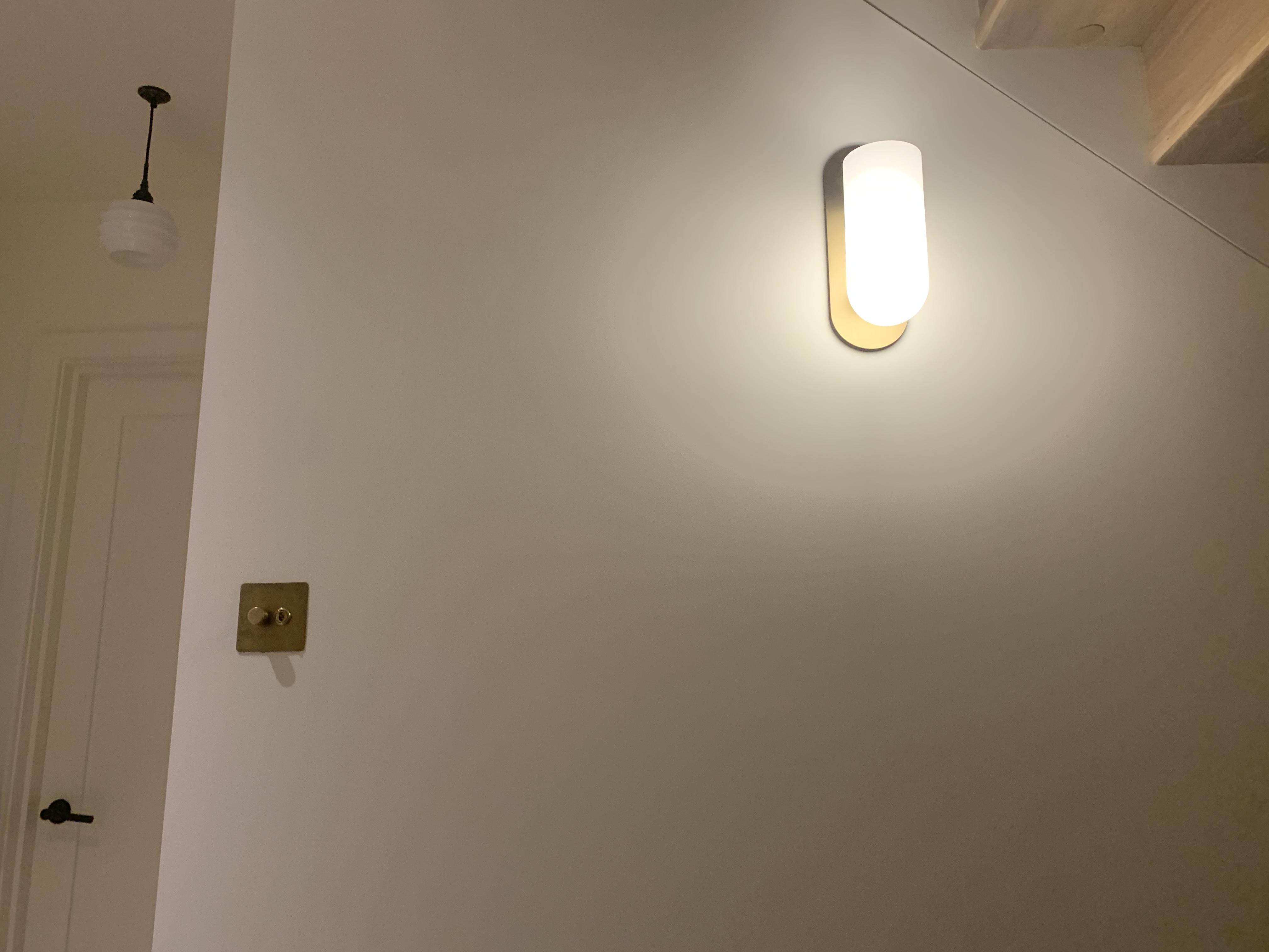

Get better wall lights. E.g. stuff that isn’t boxed in at all:
7849AC90-2F40-4FE4-99AD-CA34CDF954A1.thumb.jpeg.a7d75464abafad486f607b8ef3d75947.jpeg2973292A-AAB7-45B3-A231-A730D607624B.thumb.jpeg.81dc35fc61c1a76f8ddd82fe0b8528cf.jpeg
Sure although neither of those are to my taste. We have picked a few wall lights for the entrance hallway by Wever & Ducre
whoever plastered that needs sacking!
