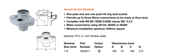

crispy_wafer Posted July 17, 2023 Posted July 17, 2023 17 minutes ago, Thorfun said: hmmm...maybe the middle one might work. depends on the distance behind the main 110mm hole i guess. do you have a link to that? Osma Soil Manifold 110mm Grey, 4S595G - Plumbing For Less

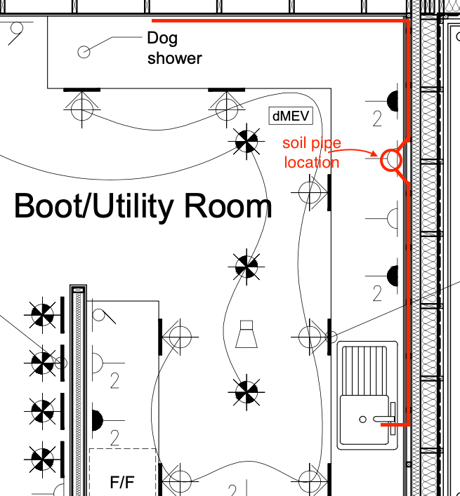

Thorfun Posted July 17, 2023 Author Posted July 17, 2023 1 minute ago, Nickfromwales said: Ok. Just zoomed in. Not yet made up. OK. You need a boss socket / collar then? yes, apart from the fact that that will make the pipes going away from the soil pipe too far away from the wall. i'd like them to be within the service cavity and i can't find anything less than 45° bend and the soil pipe is too close to the wall to allow that. make sense?
Thorfun Posted July 17, 2023 Author Posted July 17, 2023 1 minute ago, crispy_wafer said: Osma Soil Manifold 110mm Grey, 4S595G - Plumbing For Less thanks. but dimension A is way too big to fit in the gap.

Nickfromwales Posted July 17, 2023 Posted July 17, 2023 2 minutes ago, Thorfun said: yes, apart from the fact that that will make the pipes going away from the soil pipe too far away from the wall. i'd like them to be within the service cavity and i can't find anything less than 45° bend and the soil pipe is too close to the wall to allow that. make sense? Not just that, but you need 2x connections disappearing at 180° from the soil pipe, so you’d need one above the other. You can go further back (rotate that grey collar more, put a 50mm reducer into and the an M&F (aka street) elbow into it rising vertically, and then fit a 50mm double branch (aka intersection). Then 40mm reducers into each side and pick the pipes up a bit higher up.

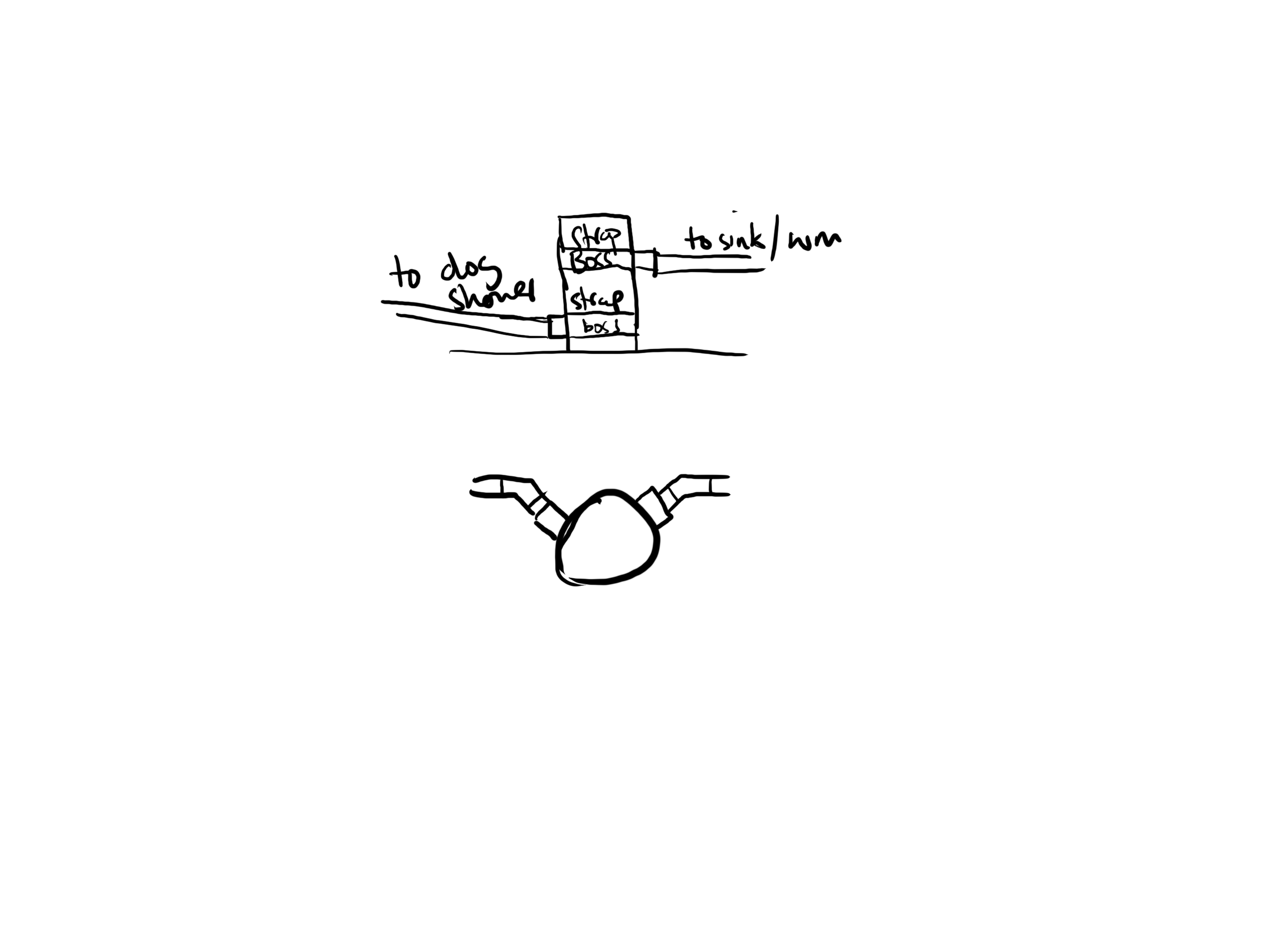

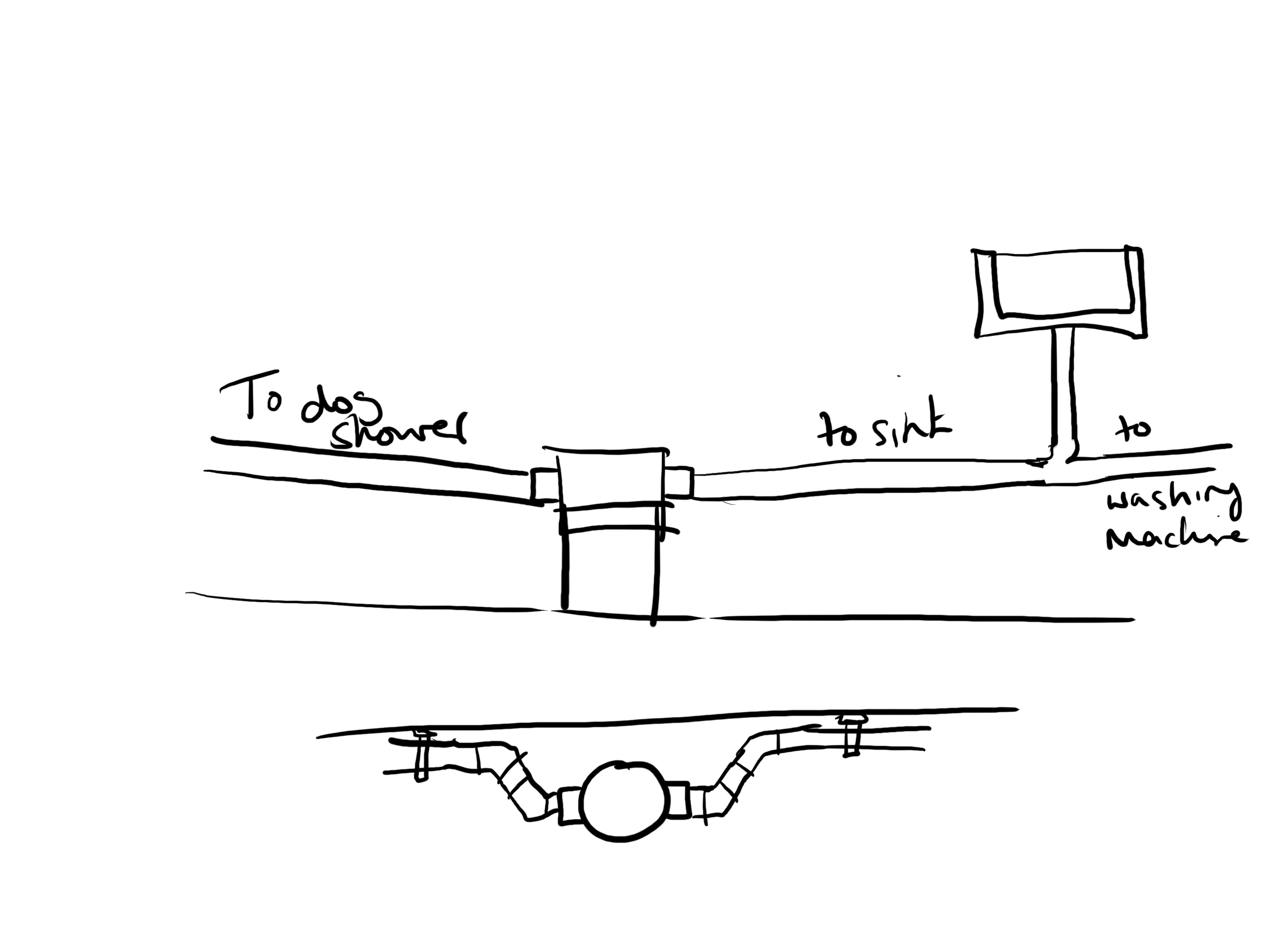

Thorfun Posted July 17, 2023 Author Posted July 17, 2023 16 minutes ago, Nickfromwales said: Not just that, but you need 2x connections disappearing at 180° from the soil pipe, so you’d need one above the other. You can go further back (rotate that grey collar more, put a 50mm reducer into and the an M&F (aka street) elbow into it rising vertically, and then fit a 50mm double branch (aka intersection). Then 40mm reducers into each side and pick the pipes up a bit higher up. tbh, not sure what you mean here! this is what I was thinking with the boss collar you linked? or like this with 2 x strap bosses the boss for the shower needs to be as low as possible to give a required fall from the shower to the soil pipe. 1
Thorfun Posted July 17, 2023 Author Posted July 17, 2023 1 minute ago, crispy_wafer said: @Nickfromwales trying to piece this together. So would that be one of these out of the boss a short piece of pipe to connect one of these then the wash m/c and shower into each branch?, and then a bung in the top. the problem for me with this solution is the shower waste will be relatively high off the ground. the higher it is going in to the soil pipe the higher I have to fit the dog shower! I do have some lee-way as we're not fitting the shower to the ground but we don't want it so high that it's hard for a smaller dog to get in to.

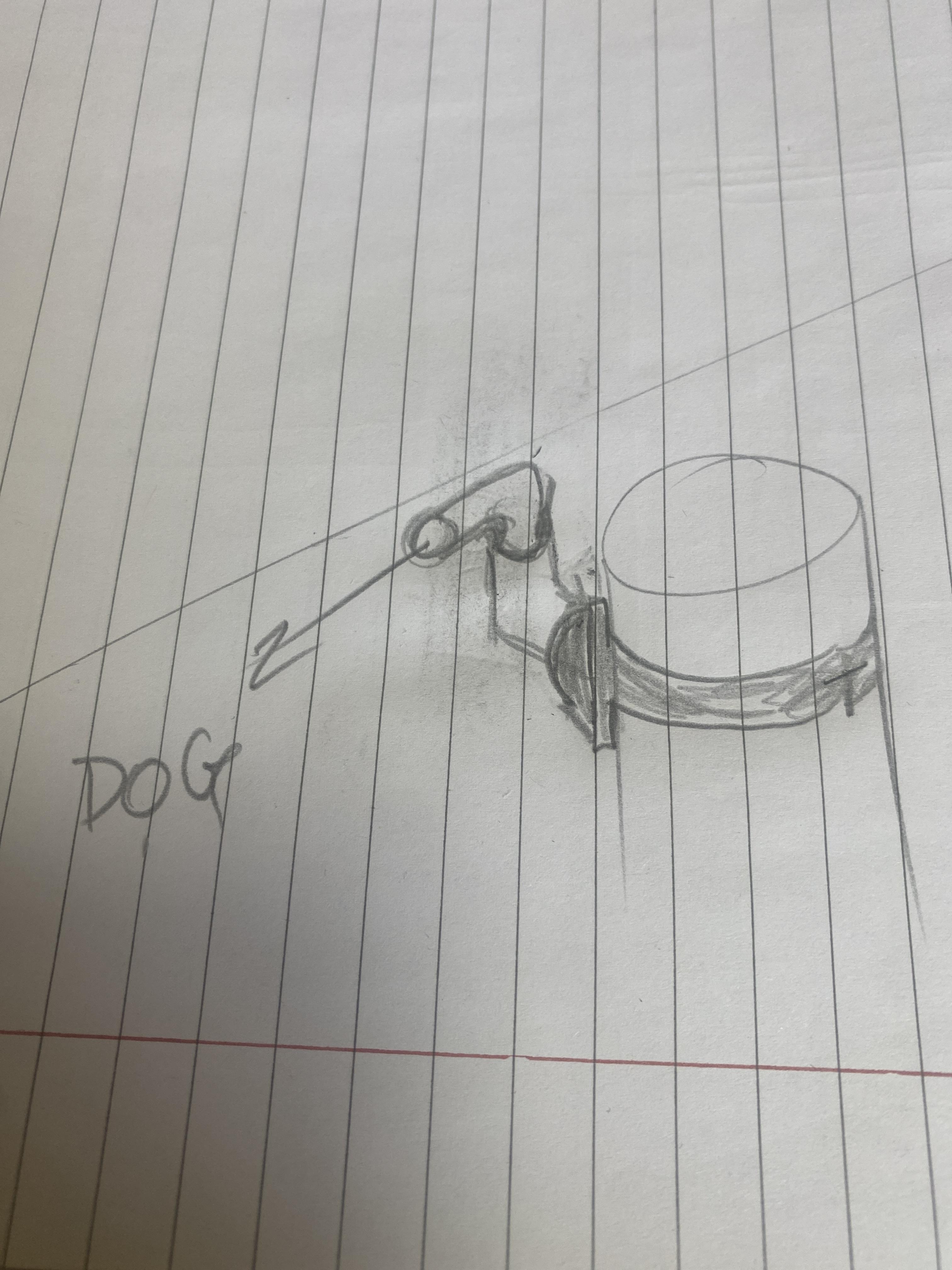

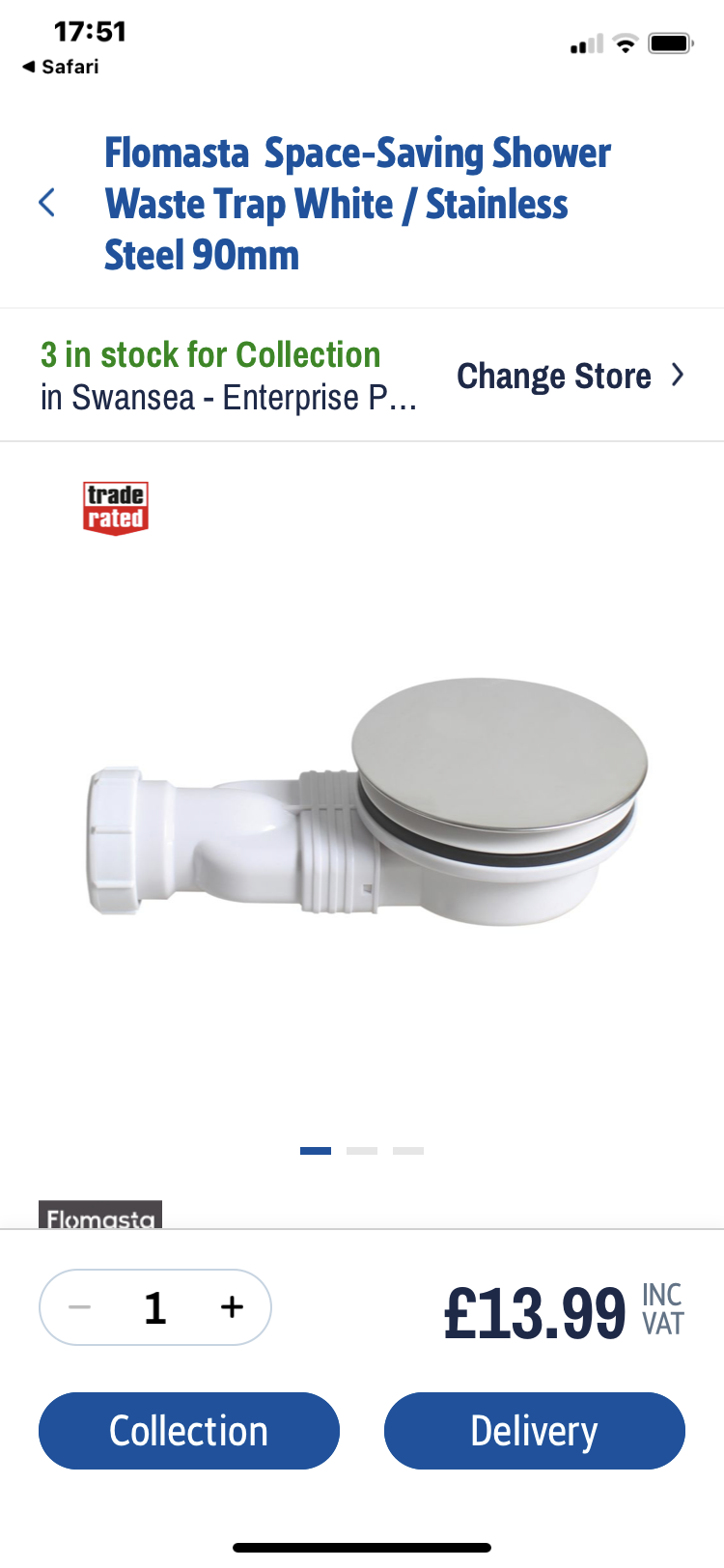

Nickfromwales Posted July 17, 2023 Posted July 17, 2023 Apologies for the shite drawing. My desktop just snuffed it. Tidy. So, you chisel out a bit of the floor, if you need to get low as a slugs scrotum, and do as per the above. A 50mm strap on boss with a vertically rising M&F bend into it, with the male 'spigot' of the bend sawn down to get it as close to the boss as possible, then rotate the soil pipe clockwise until the M&F bend is as far around as possible. Then you fit another M&F bend into the first and you’ve got a universal joint which can come off at any angle. 2x M&F bends cut down will only be apart the thickness of the pipe, so you’ll only get 50mm rise from FFL. Should be plenty fall for the dog shower tbh. Use a space saver shower trap to keep the tray as low as possible.
Nickfromwales Posted July 17, 2023 Posted July 17, 2023 You could even rise into that intersection branch (instead of the second M&F 90 bend) and do both inputs via the single boss, if there's room to sneak a 40mm waste around the back of the soil pipe. Just use a few M&F 45's in the 40mm waste to get you around it maybe?
Thorfun Posted July 17, 2023 Author Posted July 17, 2023 31 minutes ago, Nickfromwales said: Apologies for the shite drawing. My desktop just snuffed it. Tidy. So, you chisel out a bit of the floor, if you need to get low as a slugs scrotum, and do as per the above. A 50mm strap on boss with a vertically rising M&F bend into it, with the male 'spigot' of the bend sawn down to get it as close to the boss as possible, then rotate the soil pipe clockwise until the M&F bend is as far around as possible. Then you fit another M&F bend into the first and you’ve got a universal joint which can come off at any angle. 2x M&F bends cut down will only be apart the thickness of the pipe, so you’ll only get 50mm rise from FFL. Should be plenty fall for the dog shower tbh. Use a space saver shower trap to keep the tray as low as possible. 29 minutes ago, Nickfromwales said: You could even rise into that intersection branch (instead of the second M&F 90 bend) and do both inputs via the single boss, if there's room to sneak a 40mm waste around the back of the soil pipe. Just use a few M&F 45's in the 40mm waste to get you around it maybe? think this will take a little time to digest. I'm sure I'll have further questions but I need to think about your solution and draw it up! thank you once again for your valuable input.

Thorfun Posted July 17, 2023 Author Posted July 17, 2023 (edited) 3 hours ago, Nickfromwales said: Should be plenty fall for the dog shower tbh. Use a space saver shower trap to keep the tray as low as possible. ps. to be honest I actually want to use a very deep trap with a removable 'filter' type thing so the boss doesn't have to be completely at floor level. I want it to act like a catch-pit type thing so I can easily remove any mud and other stuff that comes off the dog. I've not researched them yet though but surely they exist? Edited July 17, 2023 by Thorfun
