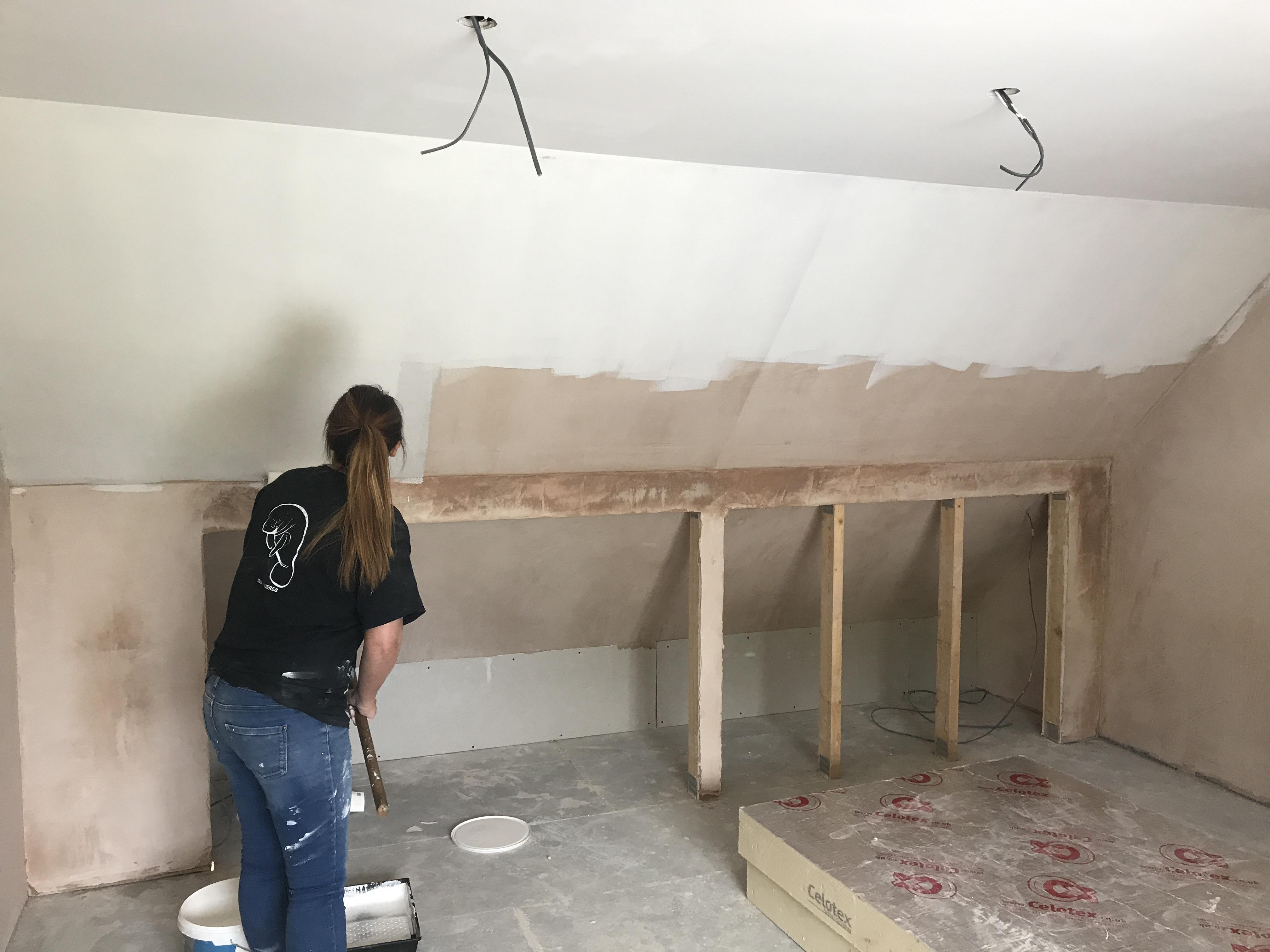

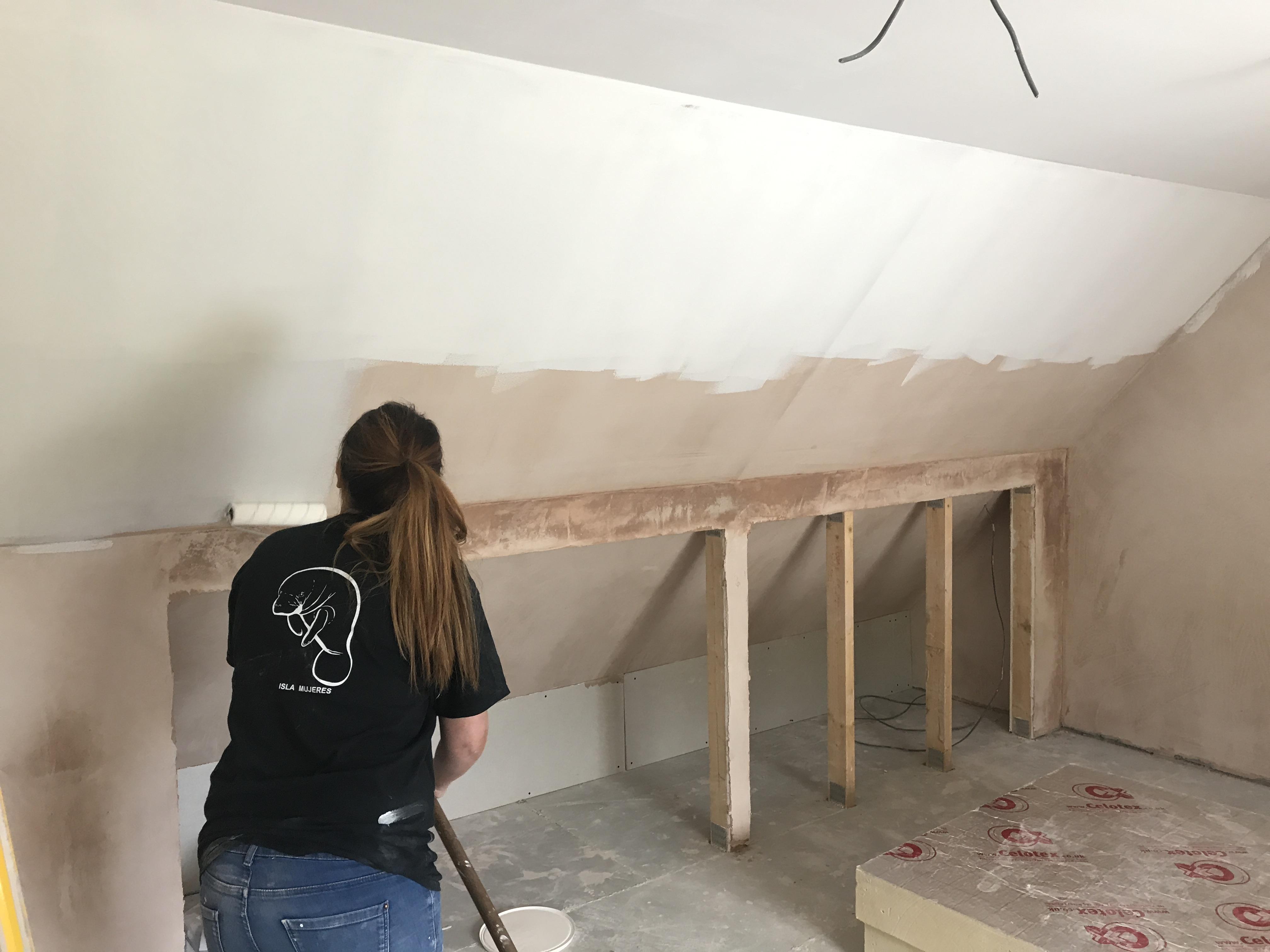

Hard to say due to the nature of the room in roof that we are currently painting, funny angles and wardrobe sections etc. 5L got 1 coat pretty much all over that bedroom in the photo which is approx 5m x 6m x 2.4m - this includes the ceiling.  We will probably be sticking to this stuff now, I've said to her if it's 10L per room at £24 to a fully decorated finish then I'm happy.
Quick calculations suggest we are probably around the 10m2/L I think - which seems acceptable?
Will be easier to give feedback back on the coverage when we are out of the roof and in to the bigger open plan sections downstairs. If I forget to post a reply feel free to give me a nudge if anyone is interested?
