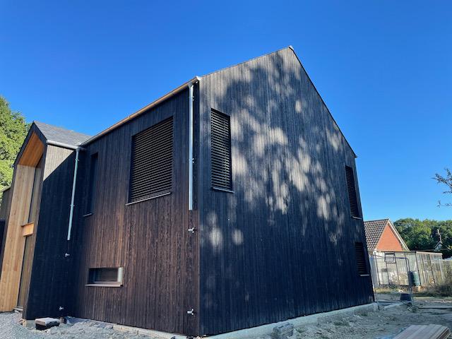

Thorfun Posted August 14, 2022 Posted August 14, 2022 17 minutes ago, Russdl said: Good point. Ours provide plenty of privacy by day - you can’t see in at all - but by night (when they’re usually up anyway) they may as well not be there. A bit like the net curtains of old. I really like the way our house looks with the blinds down. but I am a bit biased! 1
Russdl Posted August 14, 2022 Author Posted August 14, 2022 15 minutes ago, Thorfun said: I really like the way our house looks with the blinds down. We clearly have similar tastes 👍 1

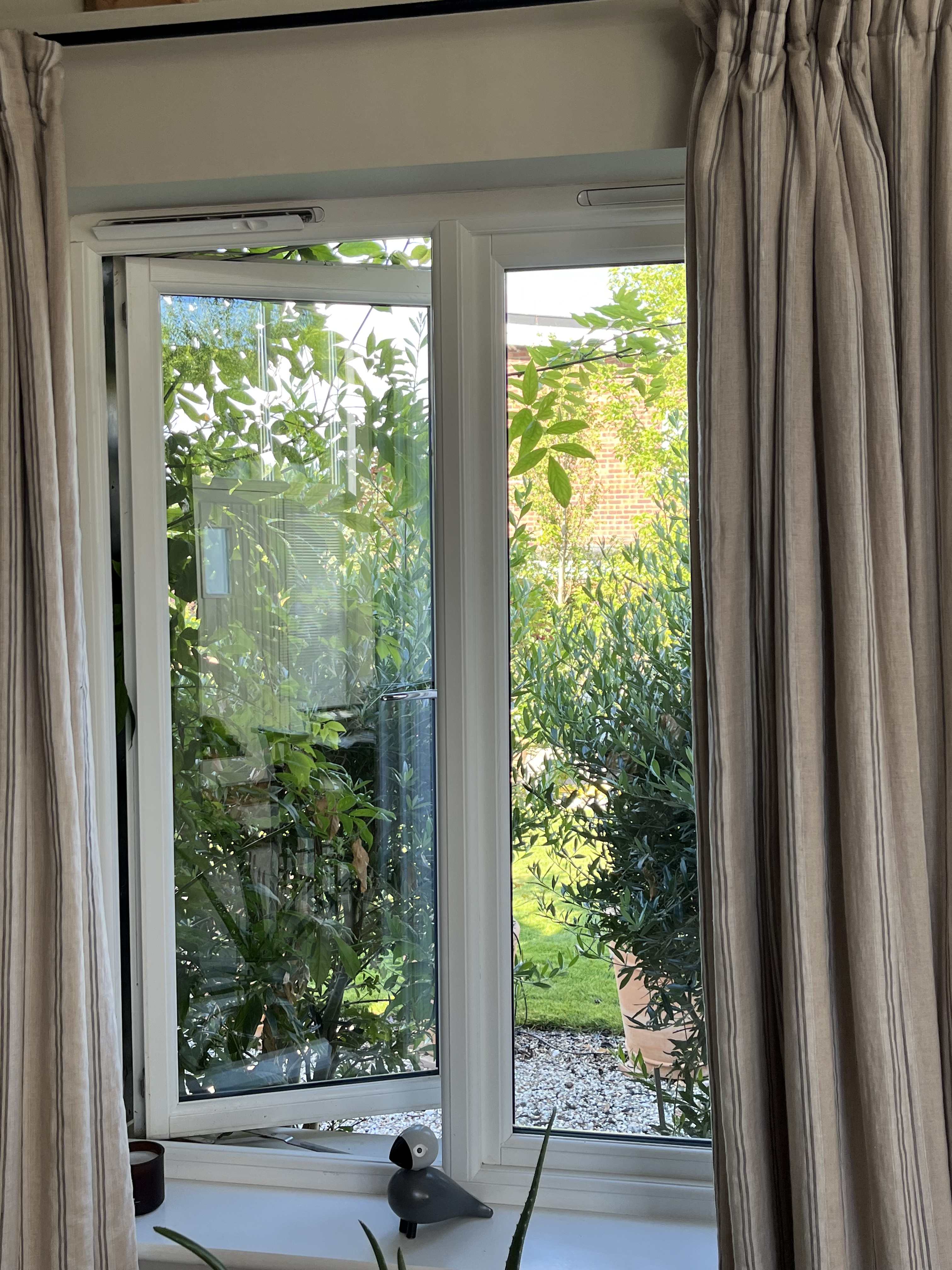

Alan Ambrose Posted August 12, 2024 Posted August 12, 2024 (edited) >>> Our secret weapon is a row of trees on the south of the plot Yes, in our existing single storey, we let the olive trees and other shrubs outside the windows grow in the summer and they make for a lovely view out of the window … and they love the sun. In the autumn, I give them a good short back and sides and we get a bit of solar gain for the winter. Very effective. This mitigation is not acknowledged in simple part O - I’m not sure for TM59 and PHPP. Edited August 12, 2024 by Alan Ambrose

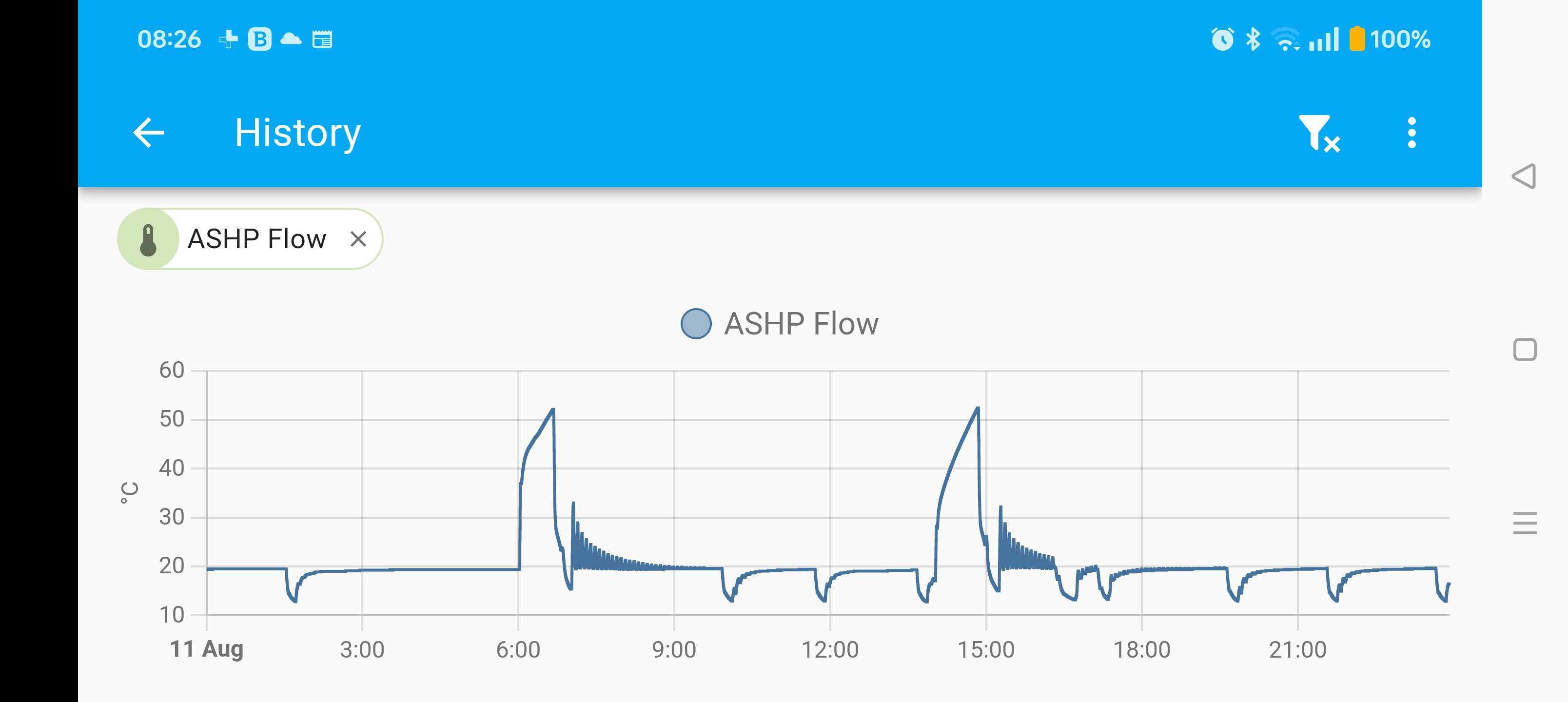

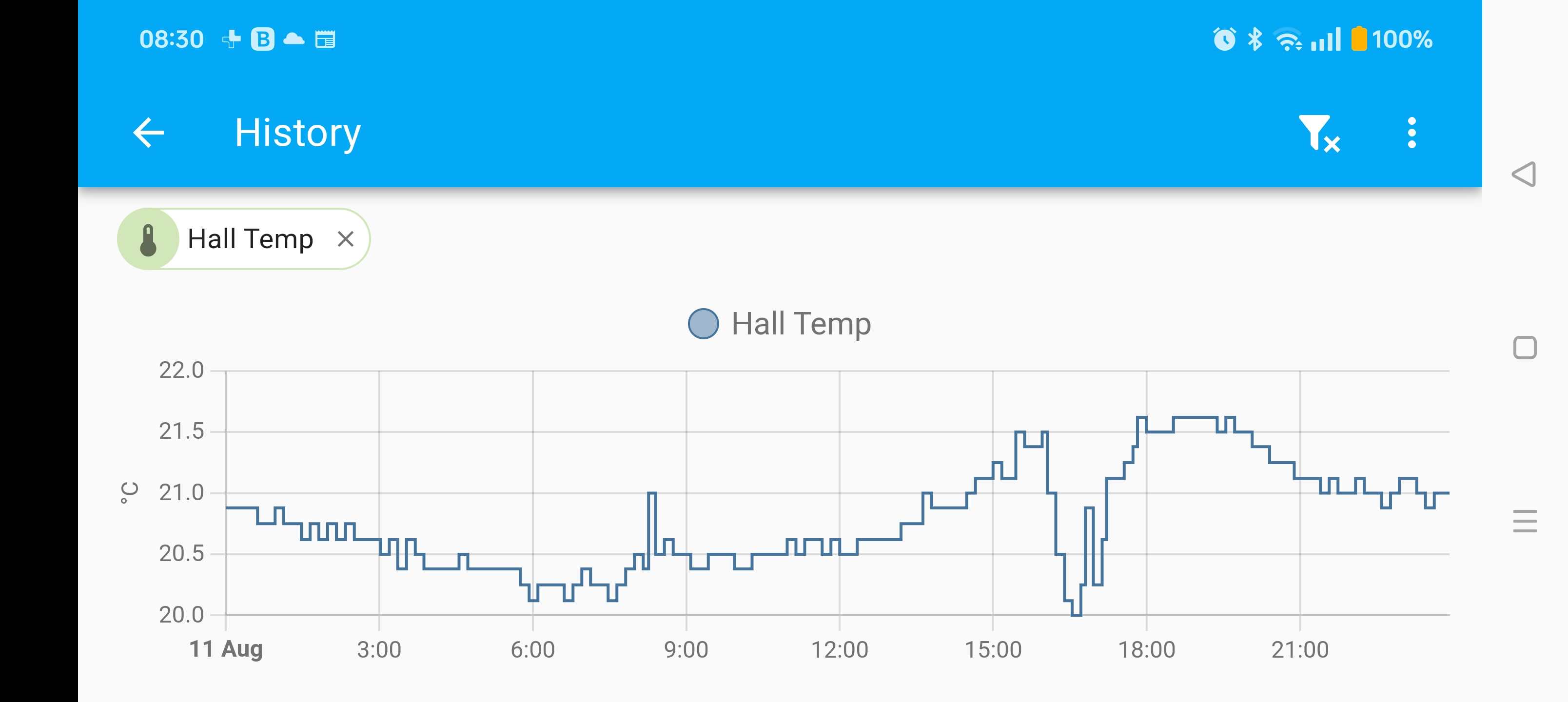

JohnMo Posted August 12, 2024 Posted August 12, 2024 Just to add further. We have had our cooling on 24/7 for the past 6 weeks. It just cools when it needs to no thermostat, no timers. Made some adjustments to get the system self modulating. Settings are such that the when the return temp to the heat pump gets to 19.4 degs the heat pump starts. If rooms are hotter from solar gain etc, the heat pump runs longer and more frequently. Overnight the heat pump may start a couple of times. Below are the flow temps over 24 hrs (yesterday), the two big spikes are DHW heating. As you can see the heat pump doesn't actually run that much. 11 starts in 24 hrs for cooling. Power consumed around 1.5kWh, about 8-10kWh of cooling delivered. Below is house temperature, it's pretty stable. House temps do spike a little when we get solar gain but they settle back down quite quickly.

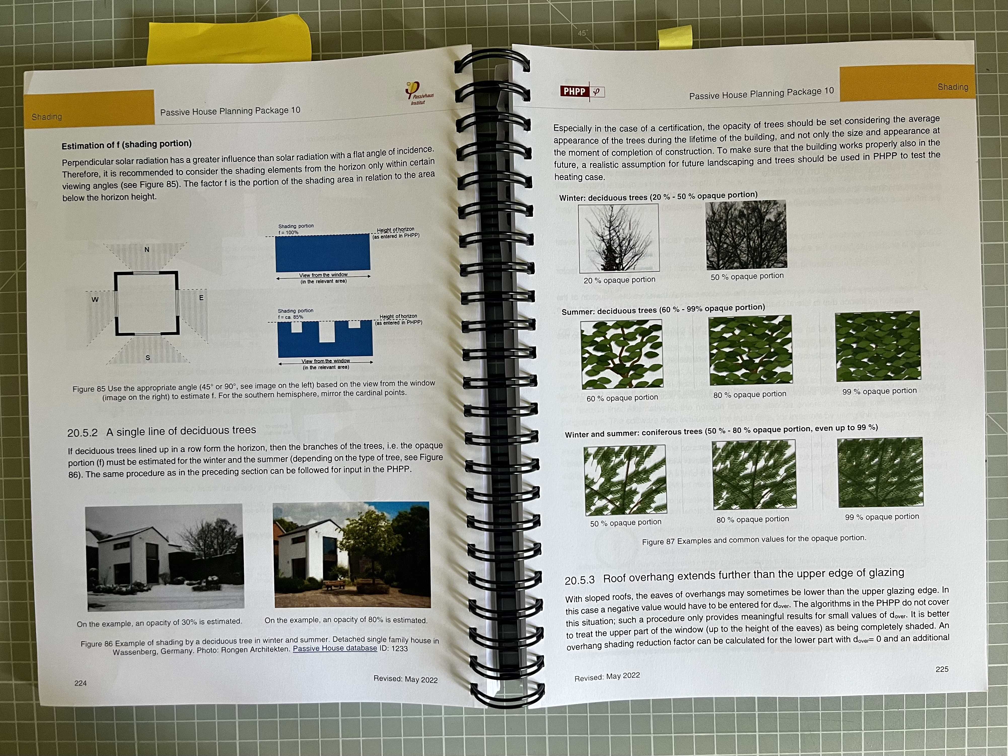

Alan Ambrose Posted August 12, 2024 Posted August 12, 2024 (edited) FYI: Part O - "Foliage from shrubs or trees is not a valid method of shading for calculation." An unfortunate choice by the algorithm designers, as that's by far the greenest solution. PHPP has a busy system of shading calcs that includes window reveals, adjacent buildings, eave overhangs, brise soleil, external blinds, low-g glazing etc. It also allows external software calcs. It has a section for trees but nothing for shrubs as far as I can see. TM59 (I don't have direct experience yet) seems to have a similar feature set to PHPP. The relevant PHPP page below: FYI: Edited August 12, 2024 by Alan Ambrose
