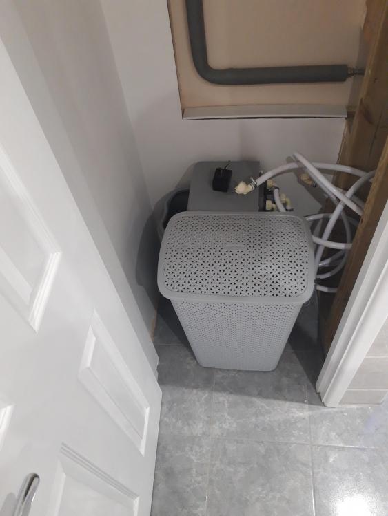

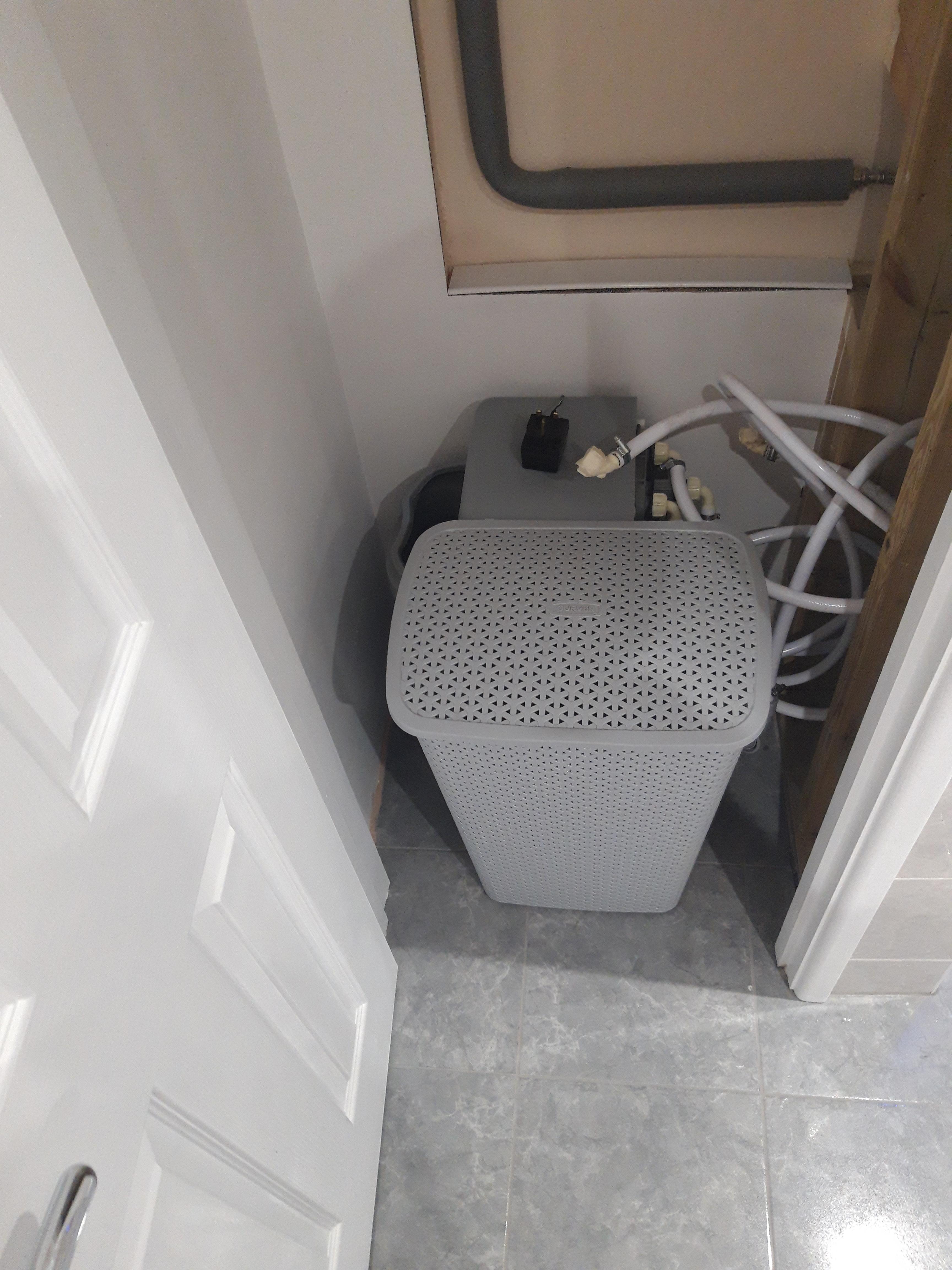

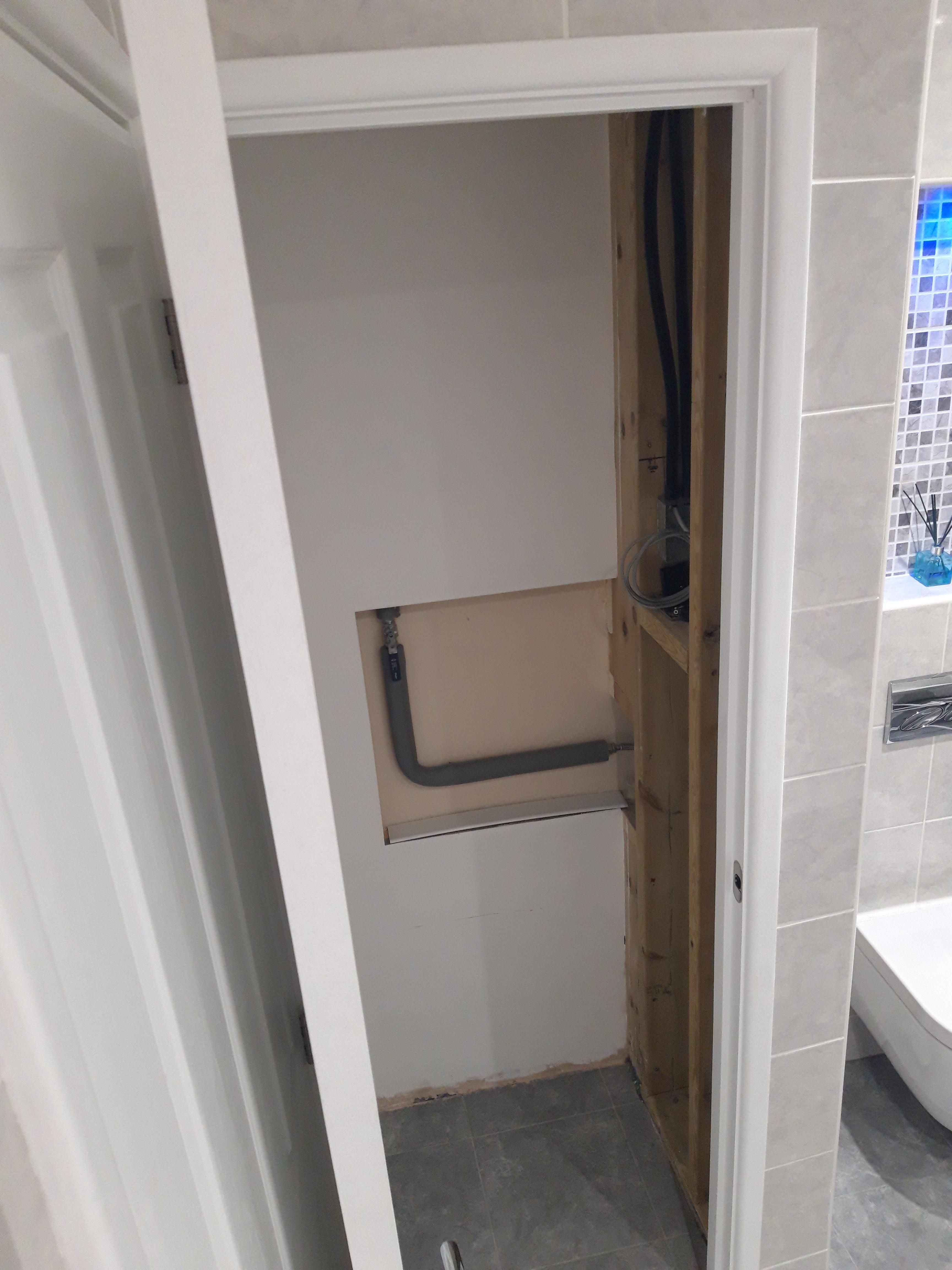

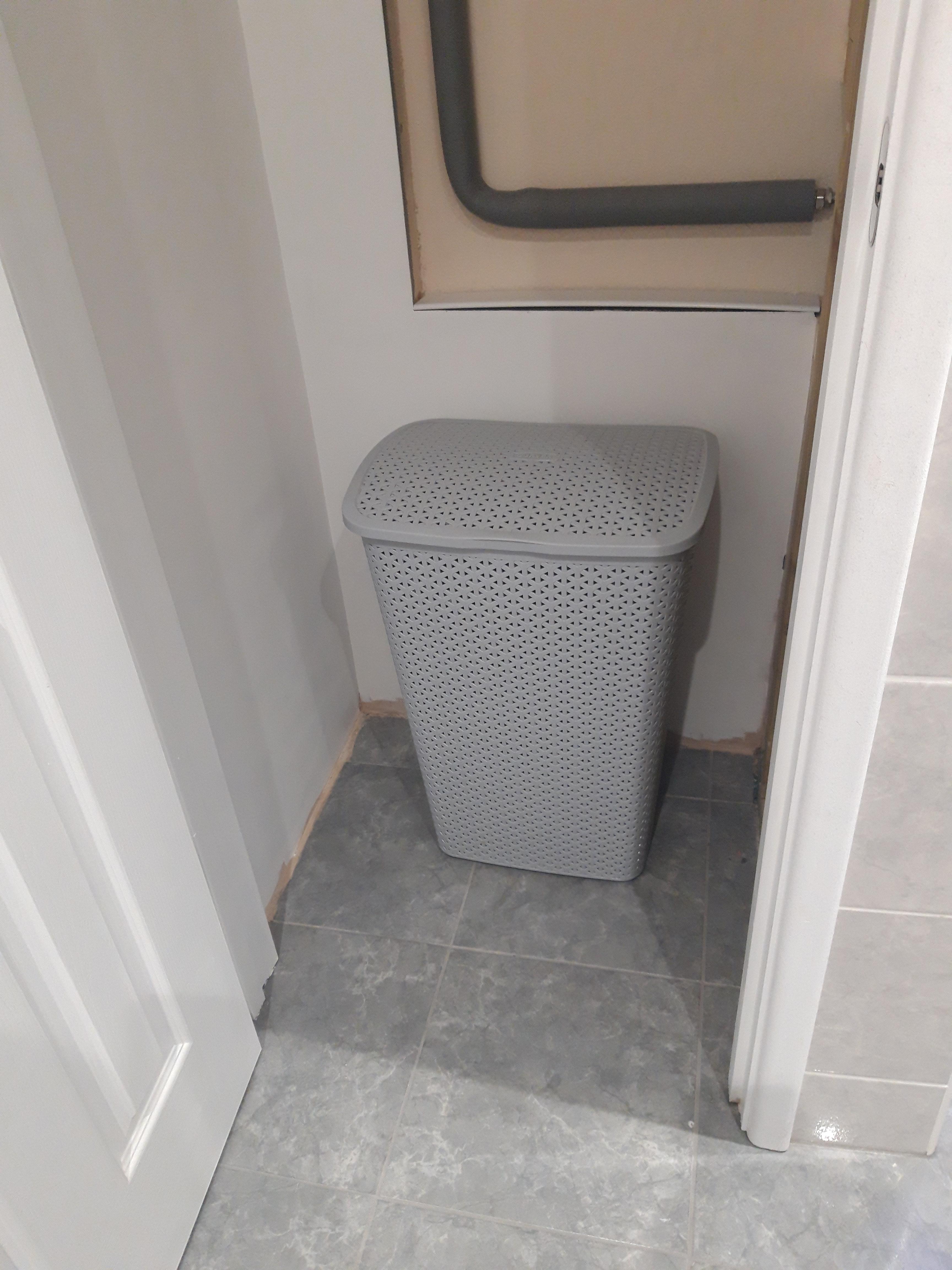

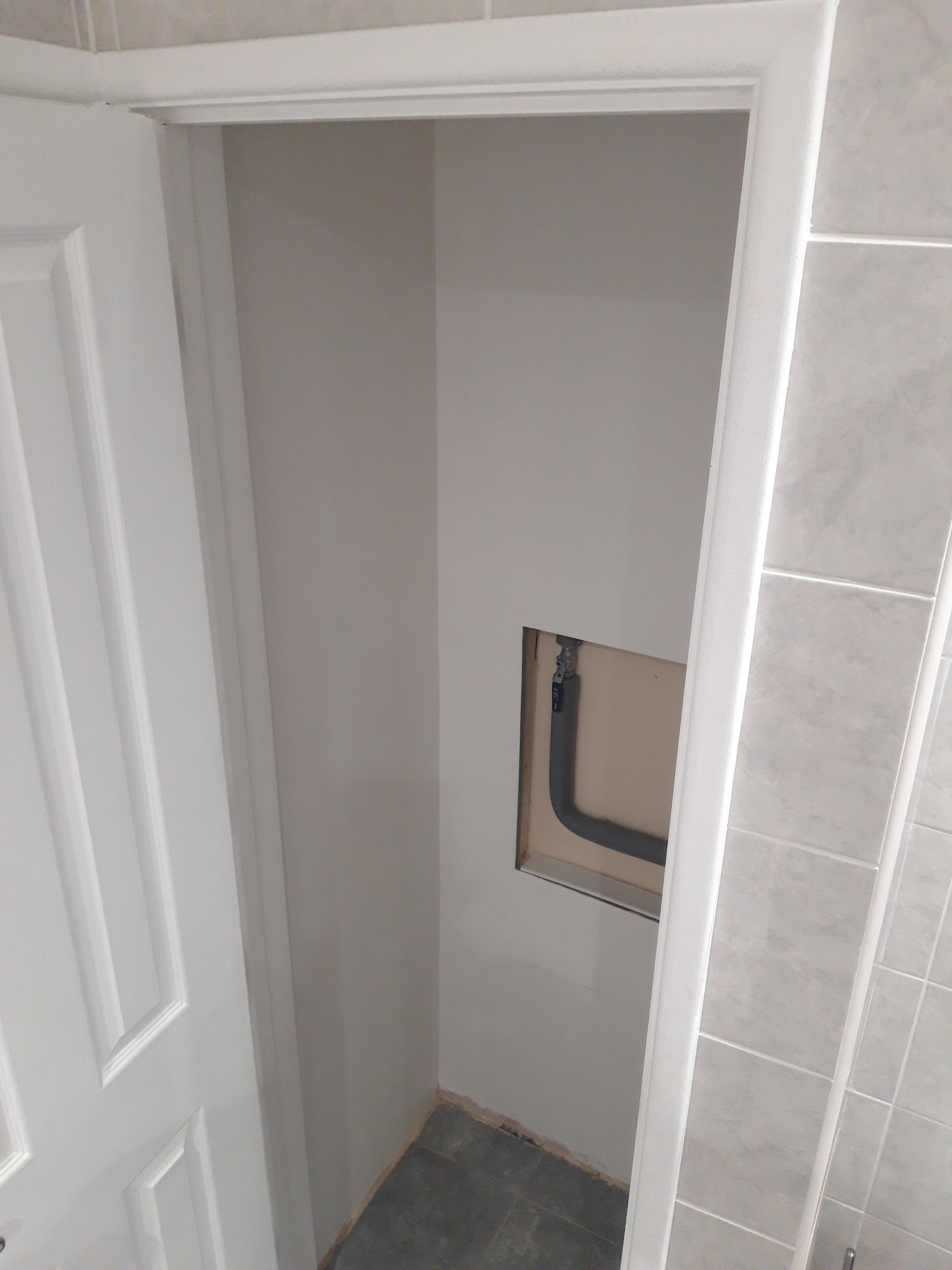

Onoff Posted November 24, 2019 Author Posted November 24, 2019 SWMBO wants 4 shelves in this cupboard. Towels on one, toiletries on another, cleaning products on one etc. Can't decide whether to make a rolling shelf or "airing cupboard" style, slatted shelves. Just playing with ideas really: Not convinced about having clean towels above a (dirty) linen basket in an enclosed cupboard! I think someone else mentioned the same thing previously. As I'll want access later to the right hand side, to the loo roll holder mechanism etc, maybe I stop the shelves short if I go with battens on the wall and slats? Rolling seems most sensible? Easy to move out to access everything else? SWMBO insistent that the linen bin presents width wise when the door is open: If I put the water softener in the cupboard that'll have to go width wise...not then easy to access itself: 1
