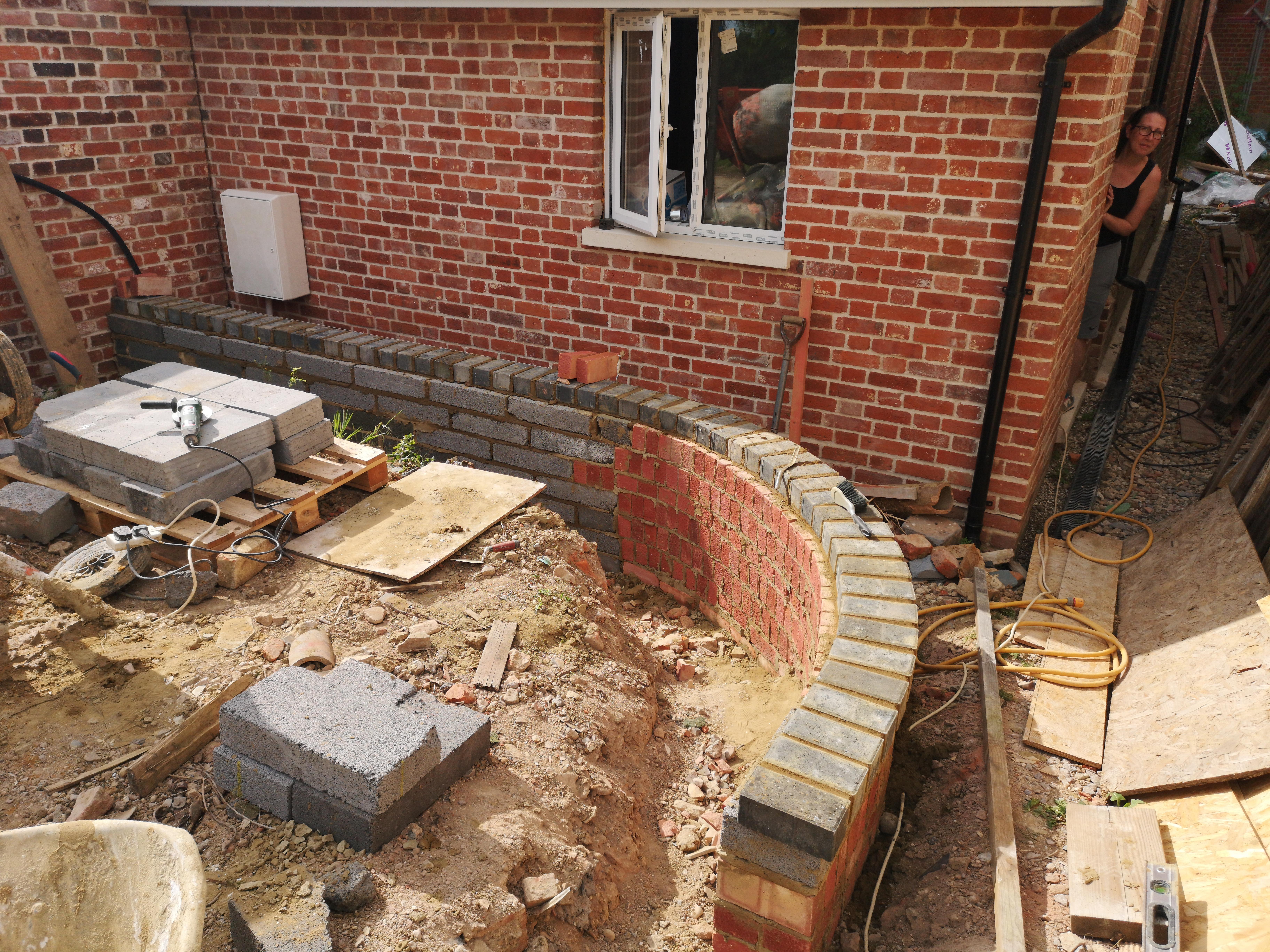

Construction Channel Posted June 1, 2019 Posted June 1, 2019 The brick is still in the form of moist clay in a bin bag and will stay that way for a little while yet. But I have had a productive day laying a curved retaining wall in the baking sun. (it's getting rendered) 2

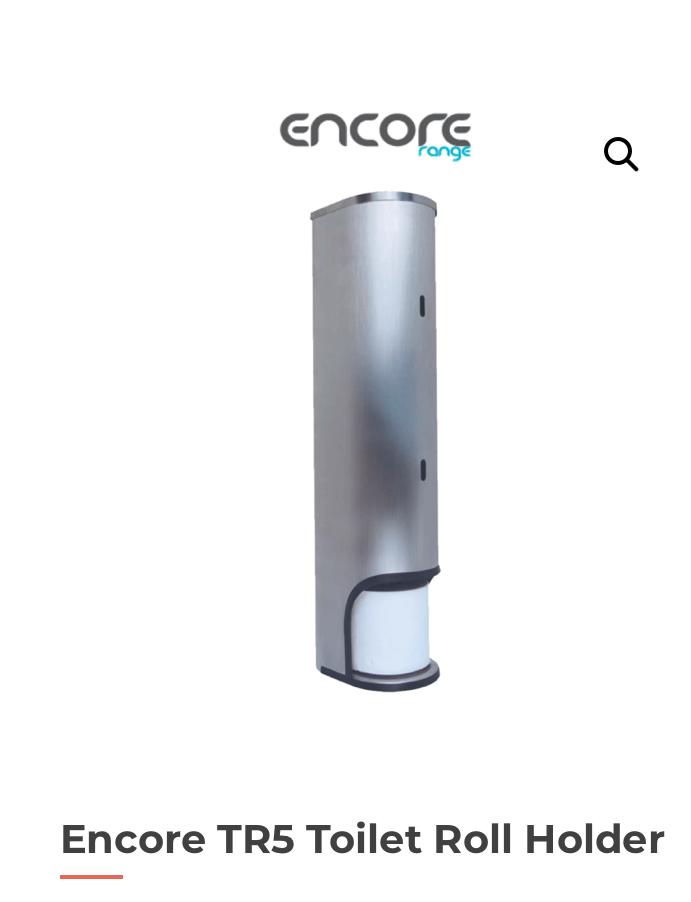

Nickfromwales Posted June 2, 2019 Posted June 2, 2019 Good old Viz..... A lot of great inventions born from there. Some thoughts now, as to how the bog-roll holder will work..... Maybe have them coming down and sideways rather than down and out towards you? That would naturally arrest the avalanche, and you simply slide a fresh round out as necessary. A buildhub first, "The ACME magazine-fed arse wipe dispenser." 10/10.

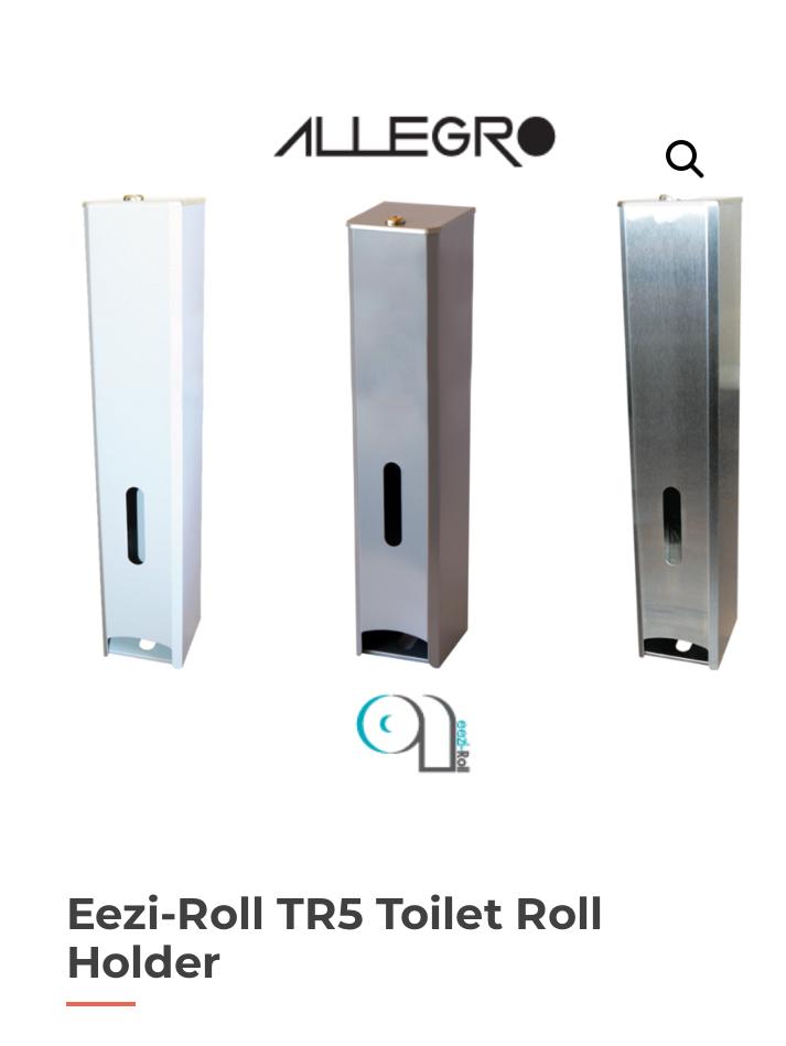

Tennentslager Posted June 2, 2019 Posted June 2, 2019 Copy the patented design? https://atkproducts.co.za/product/eezi-roll-tr5-toilet-roll-holder/ 1
Nickfromwales Posted June 2, 2019 Posted June 2, 2019 18 minutes ago, Tennentslager said: Copy the patented design? https://atkproducts.co.za/product/eezi-roll-tr5-toilet-roll-holder/ This is @Onoff we’re talking about here. That would be quick and simple, so clearly won’t be an option ?
Onoff Posted June 2, 2019 Author Posted June 2, 2019 (edited) 1 hour ago, Nickfromwales said: Good old Viz..... A lot of great inventions born from there. Some thoughts now, as to how the bog-roll holder will work..... Maybe have them coming down and sideways rather than down and out towards you? That would naturally arrest the avalanche, and you simply slide a fresh round out as necessary. A buildhub first, "The ACME magazine-fed arse wipe dispenser." 10/10. Aim is to mock up the bog roll dispenser on the bench with a Perspex side to observe the action and tweak as required. I'm bringing power down into the cupboard anyway so can tap off for any "rolls left" counter, auto retracting holder etc. Edited June 2, 2019 by Onoff
