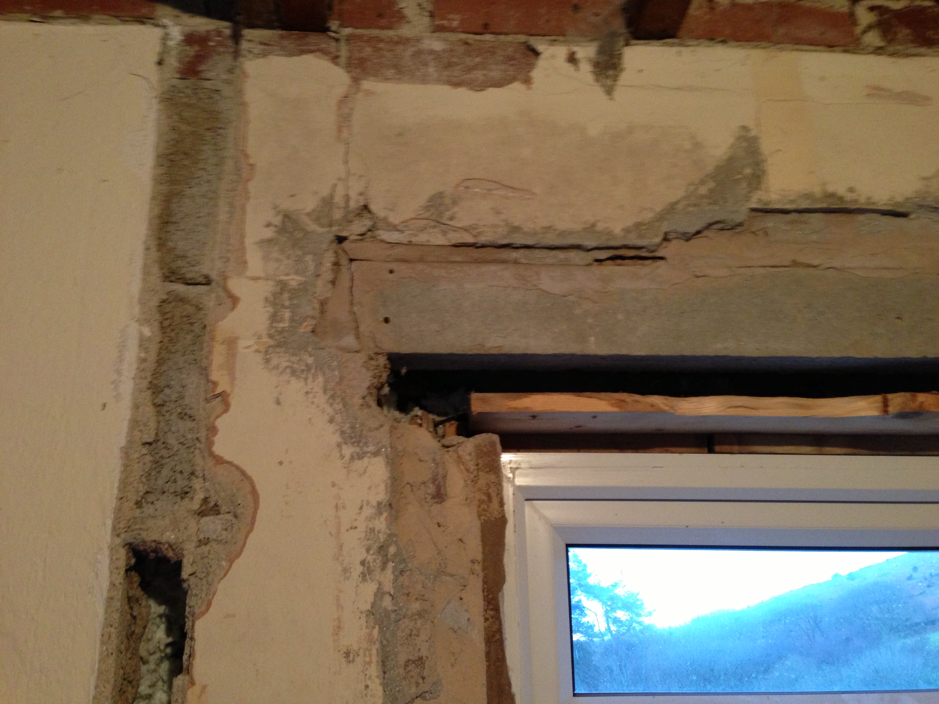

Onoff Posted November 9, 2016 Author Share Posted November 9, 2016 Took off the nasty (mitre bonded?) trim with an old wood chisel. MASSIVE GAPS! 20mm plus along the top, sides vary between about 3 and 8mm. Figure the best thing is fire in some Soudal expanding foam (the ordinary expanding type) and just keep the window shut till it sets. Then just before I push the insulated plasterboard on I can run a line of decent silicon along it. Link to comment Share on other sites More sharing options...
PeterW Posted November 9, 2016 Share Posted November 9, 2016 That's ordinary fitting tolerance for most DG companies .... Link to comment Share on other sites More sharing options...
Onoff Posted November 9, 2016 Author Share Posted November 9, 2016 (edited) 22 minutes ago, PeterW said: That's ordinary fitting tolerance for most DG companies .... It's an eye opener for me and tbh I only even looked as this juncture because of what I've learnt on here. Makes a mockery of the whole concept of "double glazing". I can imagine DG fitters on a price doing the same with TRIPLE glazing As I say making the best of a bad job! Foaming around the window just now makes the gale coming up through the cavity even more noticeable! I masked the edges with tape so I can cut it level when set: Edited November 9, 2016 by Onoff Link to comment Share on other sites More sharing options...
Barney12 Posted November 10, 2016 Share Posted November 10, 2016 15 hours ago, PeterW said: That's ordinary fitting tolerance for most DG companies .... Indeed. Now let me show you a "proper" gap from our place: The piece of timber you can see was to support the plasterboard, its was completely loose. Oh and yes that is the ground floor and that gap below the lintel was also behind the plasterboard. the lintel has about 20mm supported, JUST! I don't have a picture of the outside but the gap was covered by a circa 3" wide piece of uPVC trim. Link to comment Share on other sites More sharing options...

daiking Posted November 10, 2016 Share Posted November 10, 2016 37 minutes ago, Onoff said: @daiking - 1 @Onoff - 0 I don't understand. That happens a lot. Link to comment Share on other sites More sharing options...
Onoff Posted November 10, 2016 Author Share Posted November 10, 2016 3 minutes ago, daiking said: I don't understand. That happens a lot. You WIN! Your gap's bigger than mine! Link to comment Share on other sites More sharing options...
daiking Posted November 10, 2016 Share Posted November 10, 2016 4 minutes ago, Onoff said: You WIN! Your gap's bigger than mine! Should have gone to specsavers, its @Barney12 gap, not mine. Where I win is that I can now ignore sure fripperies as window gaps because I know I'd be better off burning it down than trying to fix. 2 Link to comment Share on other sites More sharing options...
Onoff Posted November 10, 2016 Author Share Posted November 10, 2016 1 hour ago, daiking said: Should have gone to specsavers, its @Barney12 gap, not mine. Where I win is that I can now ignore sure fripperies as window gaps because I know I'd be better off burning it down than trying to fix. I looked at the picture rather than who posted it and as it wasn't mine thought it must be yours! I've been putting off my eye test. I don't need any help to see how bad mine all is. Link to comment Share on other sites More sharing options...

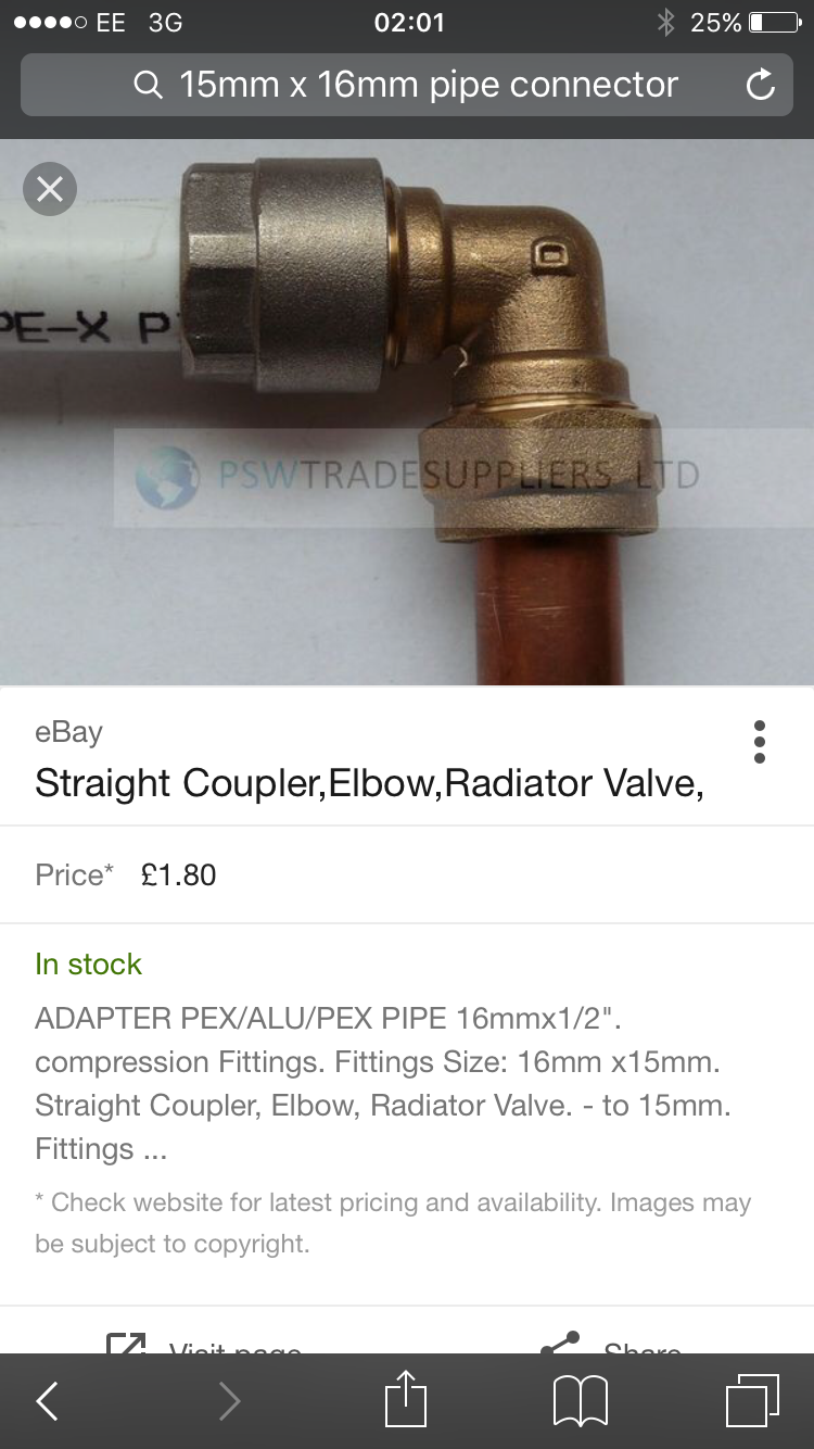

Onoff Posted November 10, 2016 Author Share Posted November 10, 2016 Asked on another post about the min rad of Pex-Al Pex pipe. After a bit of experimentation the questions possibly irrelevant tbh. 80mm rad seems most appropriate measured to the inside of the pipe bend. That'd get me around the internal corner OK with minimal channeling out of the Celotex: BUT.....trying to bring an r80mm bend along and out through the plasterboard (20mm hole drilled) is a non starter: The plasterboard won't sit flush against the studs. Having the pipe on the slant would look appalling. It needs to be perpendicular to the wall. Thinking copper now, at least round into the dwarf wall then a 15 to 16mm straight joint behind an accessible panel / removable (breakable?) tile. Going to have to fit some sort of elbow which I was trying to avoid. The next question was going to be can I affix 16mm UFH pipe to a radiator! Link to comment Share on other sites More sharing options...
Nickfromwales Posted November 11, 2016 Share Posted November 11, 2016 3 hours ago, Onoff said: The next question was going to be can I affix 16mm UFH pipe to a radiator! Nope. Quick search found this , Thats about as good as it gets, but with the added bonus of the compression side being able to accept chromed 15mm pipe, so the exposed stuff can be nice and shiny to match the 'radiator'. Then straight into these ?? Link to comment Share on other sites More sharing options...
Nickfromwales Posted November 11, 2016 Share Posted November 11, 2016 Bingo Link to comment Share on other sites More sharing options...
Onoff Posted November 11, 2016 Author Share Posted November 11, 2016 (edited) Cheers @Nickfromwales. I was looking at similar myself but that still puts a compression joint in an inaccessible place behind the tiled wall and behind/under the radiator. From the same seller I've found these straight 16/15 couplers: http://m.ebay.co.uk/itm/COMPRESSION-ADAPTER-REDUCER-COPPER-x-PLASTIC-16mm-x-15mm-pipe-/131271352568?var=430551659381&hash=item1e9061e0f8%3Am%3Am2V2jydUBoxQHhYO3dwtxhA&_trkparms=pageci%3A4d48e681-a7d3-11e6-b1ac-74dbd180b28a%7Cparentrq%3A51f38d771580a6a5ca233ebcfffdf6cd%7Ciid%3A3&varId=430551659381 I could as I said go with copper from the rad tails, along the wall and round the corner to behind a "knockout" tile or even at the end of the bath as there'll be an access panel there. Can't see though that even a copper bend coming out the wall to the rad will be tight enough..... Lucky I don't do this for a living! I'll get a couple of elbows and straight couplers to have a play. Edited November 11, 2016 by Onoff Link to comment Share on other sites More sharing options...
