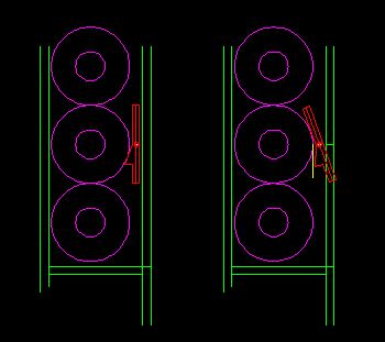

When I get to the opposite corner of the room I need to build a stud wall to create a cupboard for the linen basket etc. It'll give a wall alongside the wc. An ideal place for the loo roll holder but it got me thinking...
I don't like the ones where the loo rolls are stacked with their axis vertical. Need to come up with something on these lines:
loo_roll_mag
That needs a "hatch" also higher up on the inside of the cupboard to fill the stack from above.
I have never seen someone set the spacing of a stud wall to match the standard size of a loo roll before.
The idea is twofold, number one storage. We always seen to have a half opened pack of loo rolls sitting in the bottom of the cupboard. Number two, just seems like a fun but practical thing to do. Need to figure how to, whilst "sitting":
- remove the empty roll - thinking may be a cardboard tube sized hole on the left stud so the empties fall into another stack for removal later.
- to "load" the next one thinking some sort of sliding rod arrangement with the "lever" under the roll in use. Needs to drop one roll whilst stopping the others above dropping and take into account the stacked weight.
I can see different size rolls being an issue.

Plasterboard either side of the 145mm timber stud. The (red) "cam" is held against the roll by opposing / attracting (tba) magnets (?) instead of a spring I'm thinking. Pull the cam towards you and the roll drops down. Maybe extend the cam at the top to abut the roll "in waiting" above and stop it interfering with the action initially. Let go of the cam and the roll above drops into place.
Early days but it's something to go on.....

Quite seriously THAT is the design's Achille's Heel. Different sizes will likely not work in some way. Drawing this up based on 120dia x 105lg.
