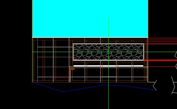

Onoff Posted August 16, 2017 Author Share Posted August 16, 2017 (edited) A great philosopher once wrote; "Naught..", Sorry, wrong thread! Anyway, he said on the lines that "everything focuses on the bath". So this will mean the inset panel: It's 430mm between faces of mrpb. I marked the centreline, 215mm up: So in trying to plan this I figure a line projected around the room is the way to go. Laser mounted in the wet room corner: And nudged until I hit the marked line (just under): Pretty happy it's the same both sides, says something for my manual methods with a level up until now. I'll nudge until the laser is dead centre on the line before marking the wall: So I'm now going to project this line all round the room as a datum. Which brings me onto tiling! I acquired this bad boy, a picture framing guillotine. As sharp as a sharp thing and really heavy duty: Because of a nick in the blade I had to pack the work piece up a bit but it cuts tile trim nicely: I'm happy enough with this fit I think (actually looks worse than it is): But wtf do I start in attaching this trim? The trims are 10mm (actually 11mm o/a height). This for 8mm tiles. I know I need to use mitre bond. But how do you keep the runs of trim straight? Only thing I can think is to set it against a 10mm pack? Oh' and I'm thinking to tank this pocket before I stick any trims on? EDIT: Holy crap! Looks like this is a MORSO guillotine, the price of blades!!! Edited August 16, 2017 by Onoff Link to comment Share on other sites More sharing options...

Onoff Posted August 16, 2017 Author Share Posted August 16, 2017 (edited) 7 minutes ago, Nickfromwales said: Don't take the first line as gospel. Hold a tile above it / below it and start looking for micro rips ( 50mm or less ) and try shifting the datum up / down to rid you of these. Check window heads and cills, last tile against floor and ceiling ( making sure you have a cut tile against each, more so for the floor as you'll need to run down into the shower 'well'. I'll spend a half day sometimes on a line out, but you can see in seconds when it's not been done with enough commitment . Lost me, the bit in red??? You mean the first LASER line? Edited August 16, 2017 by Onoff Link to comment Share on other sites More sharing options...
bassanclan Posted August 16, 2017 Share Posted August 16, 2017 There is no point setting an arbitrary line round, then starting tiling and finding you need a 50mm sliver to finish at the top/bottom when you could have simply moved the line up/down 50mm at the planning stage. Why mark a line then paint tanking liquid over it, you won't see it!? Link to comment Share on other sites More sharing options...
Nickfromwales Posted August 16, 2017 Share Posted August 16, 2017 (edited) 17 minutes ago, bassanclan said: There is no point setting an arbitrary line round, then starting tiling and finding you need a 50mm sliver to finish at the top/bottom when you could have simply moved the line up/down 50mm at the planning stage. What he said Worse still a 10mm rip. 17 minutes ago, bassanclan said: Why mark a line then paint tanking liquid over it, you won't see it!? I always do that first so all the scribbles get tanked over. Then with the final datum marked ( on the door frame / other spot not being tanked ) you then re-mark the room with nice clean walls. Eliminates the "bollocks, that's not the line I'm meant to be tiling to" accident. Edited August 16, 2017 by Nickfromwales Link to comment Share on other sites More sharing options...
Onoff Posted August 16, 2017 Author Share Posted August 16, 2017 (edited) 2 hours ago, bassanclan said: There is no point setting an arbitrary line round, then starting tiling and finding you need a 50mm sliver to finish at the top/bottom when you could have simply moved the line up/down 50mm at the planning stage. Why mark a line then paint tanking liquid over it, you won't see it!? Very far from an arbitrary line. Considered a long tome ago on CAD! The idea was to have a 250 high tile dead centre of the bath pocket: So far it seems to work out pretty much as expected. The oddity here is I have a ceiling height about 2470mm high so I'll have to have a "strip" up at the ceiling. With hindsight, lower ceiling! Was half thinking of a border tile either along the top or mid way up the wall: And the cut tile along the base means I have no issue tile height wise when it falls to the shower corner: EDIT: "Accuracy".....I've gone over the laser line with a fine black Sharpie for the datum line. Would I be better this line being in (a sharp) pencil or Biro? Do I go around marking horizontal tile lines on all the walls up/down from the datum as a guide? Cheers And where do I start tiling from? Edited August 16, 2017 by Onoff Link to comment Share on other sites More sharing options...

Onoff Posted August 16, 2017 Author Share Posted August 16, 2017 Thought I'd see what it would look like NOT putting a horizontal tile on the centre line of the bath pocket: Plotted tiles on another vertical line by the door way. Better at the top in terms on no tiny rip but at the bottom nom 265mm to the slab. Would work here and most areas by the time the floor gets tiled but maybe NOT in the wet room corner where I need 13 to 26mm lower than FFL to get my falls for the wall drain: Link to comment Share on other sites More sharing options...
bassanclan Posted August 16, 2017 Share Posted August 16, 2017 If you use the right hand layout of tiles, how they work out in the pocket shelf? There might be some fussy slivers there, but otherwise it looks good. A border tile or listello trim all round thing might help you to get rid of that tiny sliver if you prefer the left hand layout 1 Link to comment Share on other sites More sharing options...

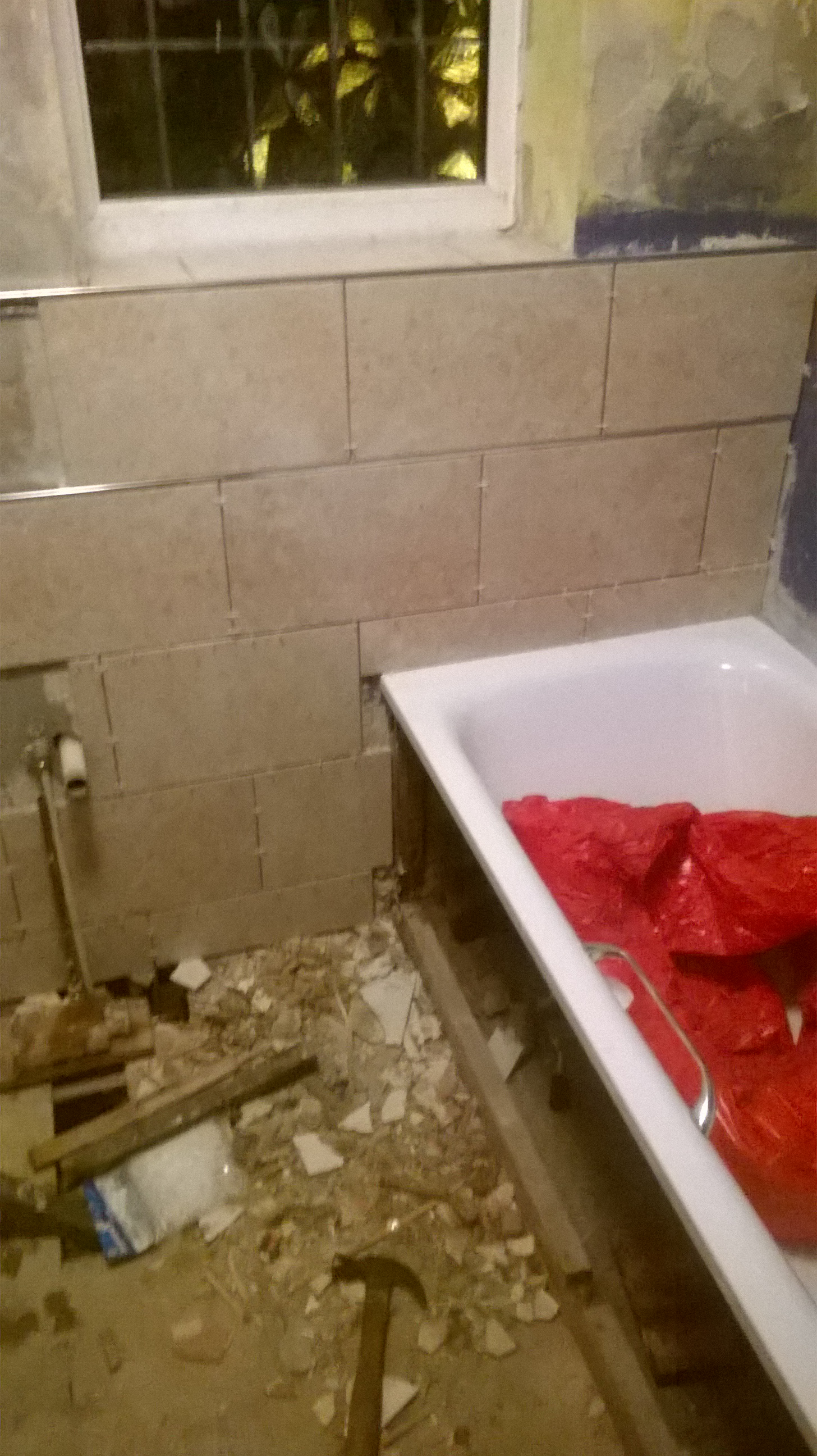

bassanclan Posted August 16, 2017 Share Posted August 16, 2017 I found this old photo showing how you can use metal tile trim to run a line around the whole room, breaking up the tiles and giving you an extra few mm Link to comment Share on other sites More sharing options...
Onoff Posted August 16, 2017 Author Share Posted August 16, 2017 7 minutes ago, bassanclan said: I found this old photo showing how you can use metal tile trim to run a line around the whole room, breaking up the tiles and giving you an extra few mm SWMBO is very anti "metal" tile trim. Wants white PVC so she can bleach it! Wouldn't let me have the bath taps I wanted either! Link to comment Share on other sites More sharing options...
