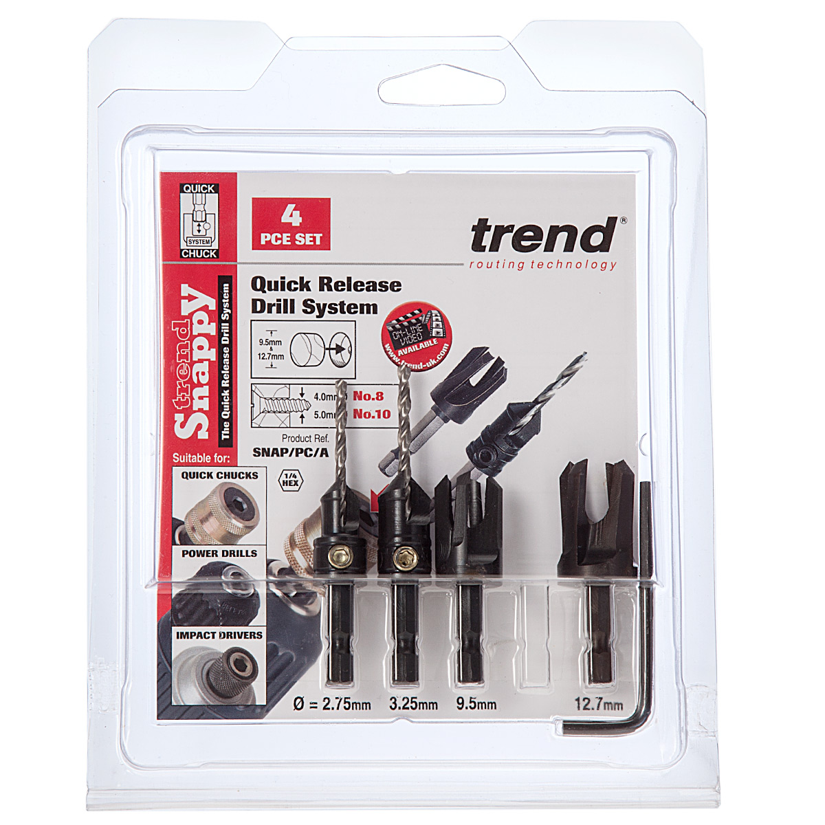

2 hours ago, Simplysimon said:
they all look blunt!
Done a lot of st/st, the ones on the left!
I do have a couple sets of those Ed.
