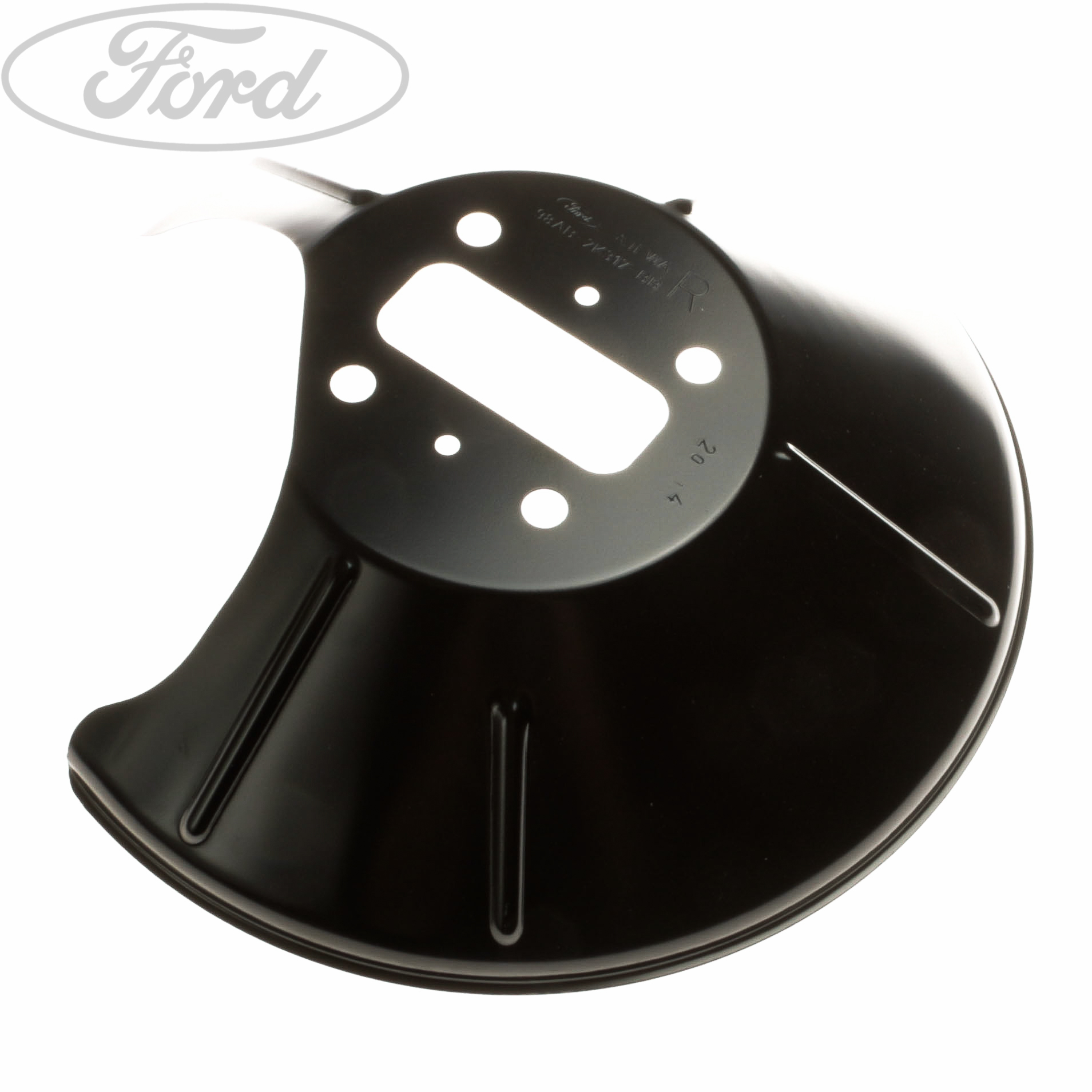

have you considered making one out of stainless?
:) Enough to do! Am actually thing about making a pair of st/st brake disc shields when I replace the discs later this week as the the old shields (and discs) are a bit ropey. Either that or I'll knock up a washing soda derusting tank and see how the old ones come out.
Tbh it's the trailing arm bushes I'm not looking forward to!

:) Sheet metal and MIG actually:
http://craig-russell.co.uk/demos/cone_calculator/
