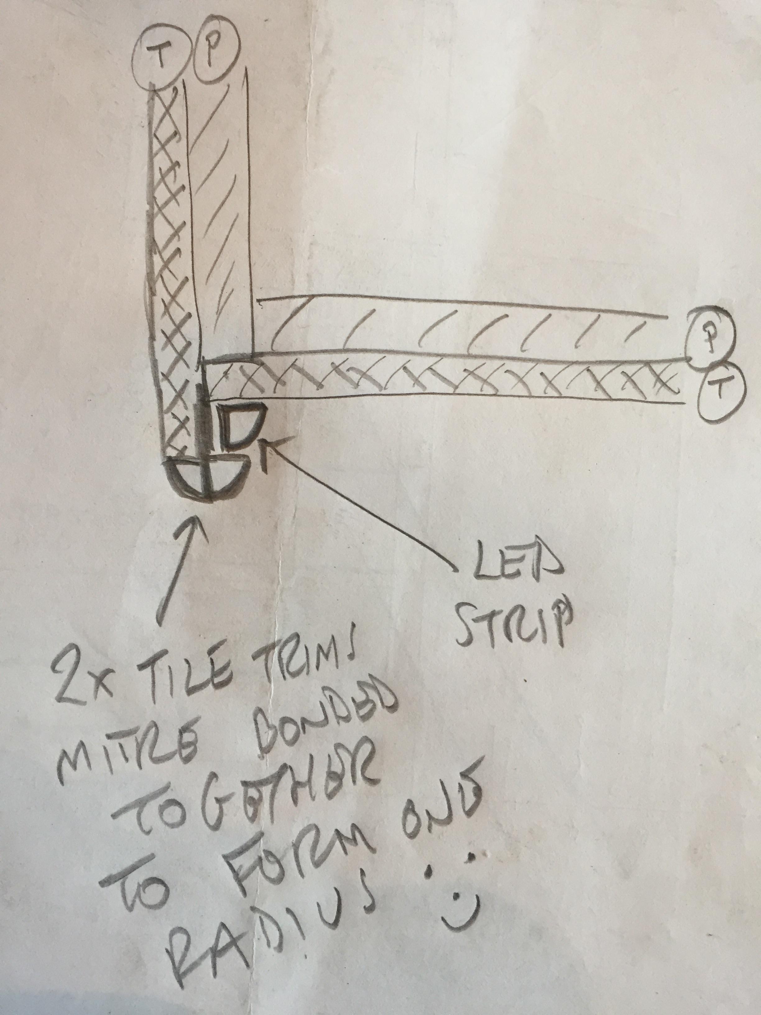

A bit involved but should work:
led_004
(Ignore red circles).
Close......
Now how about getting the underhang extended down the thickness of the tile so the strip doesn't leave the leading edge of the cut exposed ?
Shame, so close to me not criticising it :D
27 minutes ago, Nickfromwales said:
Close......
You mean in effect drop the pink bit lower?

So this maybe? I can bring 12mm ply down the front then infill with a 26x13.5 (aka 12mm) strip and some 6mm thick:
led_006
Tbh that 16.5mm tile strip.....not sure.....if done well I guess.....
Will mean sticking that back bit of tile up to the marine ply with something "thin" i.e. other than tile adhesive.
Edited by Onoff
Like it, should give more colour "wash" down the reveal whilst being better hidden.

i don't mean to pick holes but what are you going to fix the tile trims to?

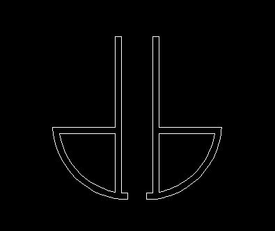

Ref @Nickfromwales idea; the red dashed hole is where I've my flexible conduit exit and it's immovable tbh. I wanted it to line up with the light strip really:
led_007
I need to make a decision asap ref what tile trims to get. White, plastic quadrant is a given as that's what SWMBO wants. But with an 8mm tile do I go for 8 or 10 I just don't know.....I've shown the 10mm one.
Edited by Onoff
The trims get sikaflex'd to the tile and mitre bonded together. To stop them 'flapping', the reverse gets bonded to the rear of the alu LED profile. ;).
Bomb-chuffin'-proof.

Oh, and go for a 10mm tile trim as you'll need some void for whatever adhesive you use.

Doing it "your way" which tbh I'd prefer then the LED extrusion would be offset to the conduit by about 22mm. Going to have to go for this:
led_008
Thinking that instead of 16.5mm wide tile I could mitre bond a bit of 16mm mini trunking between the two tile trims.

This 10mm Genesis pvc trim has a little lip. Can't see two trims abutting neatly because of this?
2017-01-05_10-37-00
Can't see how they'll butt neatly:
Edited by Onoff
