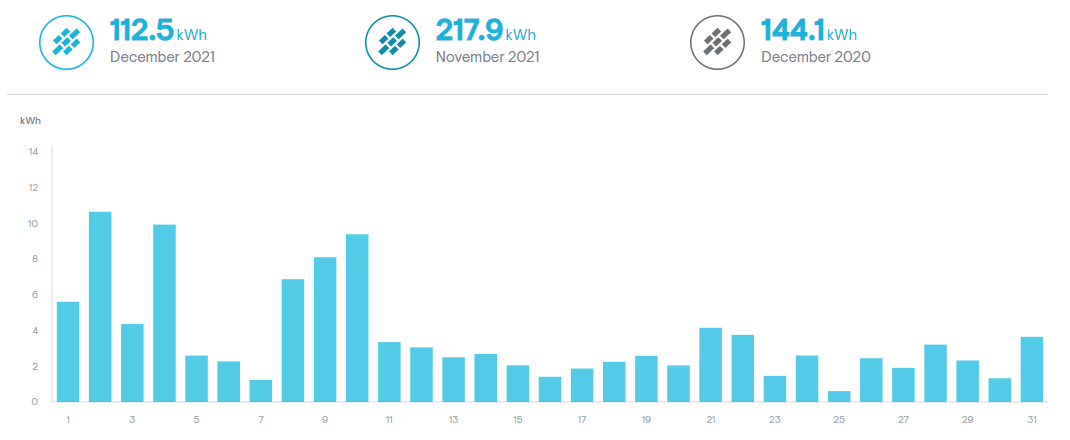

JohnMo Posted July 26, 2022 Share Posted July 26, 2022 Background, I have a gas boiler. But the assertion that heat pump don't work and he wouldn't sell to his worst enemy, is more a statement of his skill set, or lack of. A correctly designed, installed and commissioned heat pump will work and shouldn't cost any more to run than a gas boiler. The key is correctly designed, installed and commissioning. Solar PV and thermal, can work great in the shoulder months, but they cannot deliver a heating system. Example I live in NE Scotland and have 3.1kW of PV. The other day it was generating 3.01 kW at around midday, today it was generating 0.1kW at the same time, as it was very heavy cloud and pouring with rain. Generation is winter is about a 10th of that. IR rads work great in a single direction, so they warm your body that is exposed to the heater. If your back is away from the heater they will remain cold. They are 100% efficient, but that's not good compared to a well installed heat pump which could be 400% in the same weather. If I had a shed used as an office for a hour or so a day, IR would be fine. LPG, not convinced with your argument. 2 Link to comment Share on other sites More sharing options...
