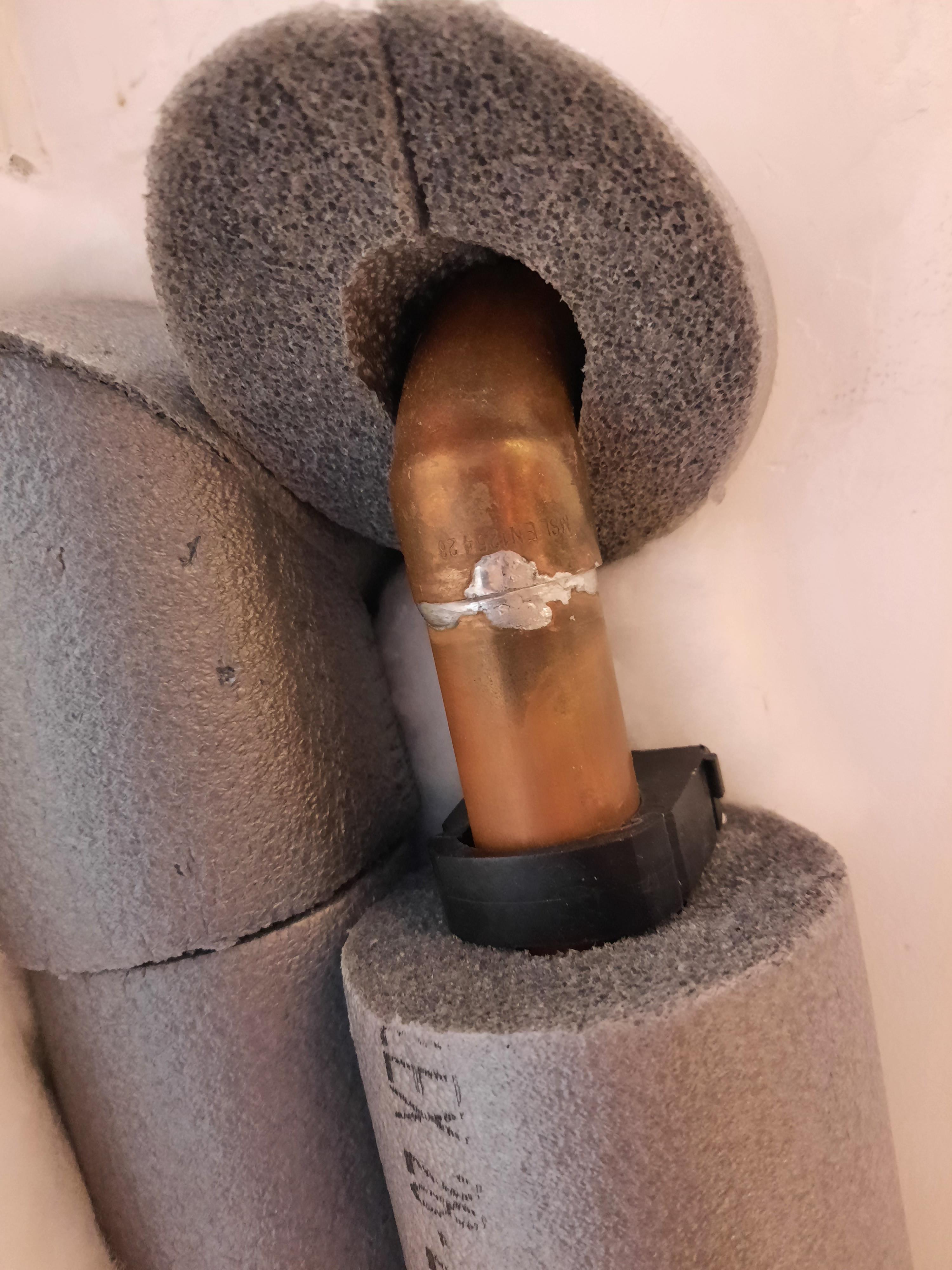

PeterW Posted July 28, 2022 Share Posted July 28, 2022 2 minutes ago, Adsibob said: The copper pipes which are exposed coming out of the cylinder and coming out of the boiler are NOT insulated at all. Not only building control but part of the Manufacturers Instructions for installation that all pipe work is insulated. Link to comment Share on other sites More sharing options...

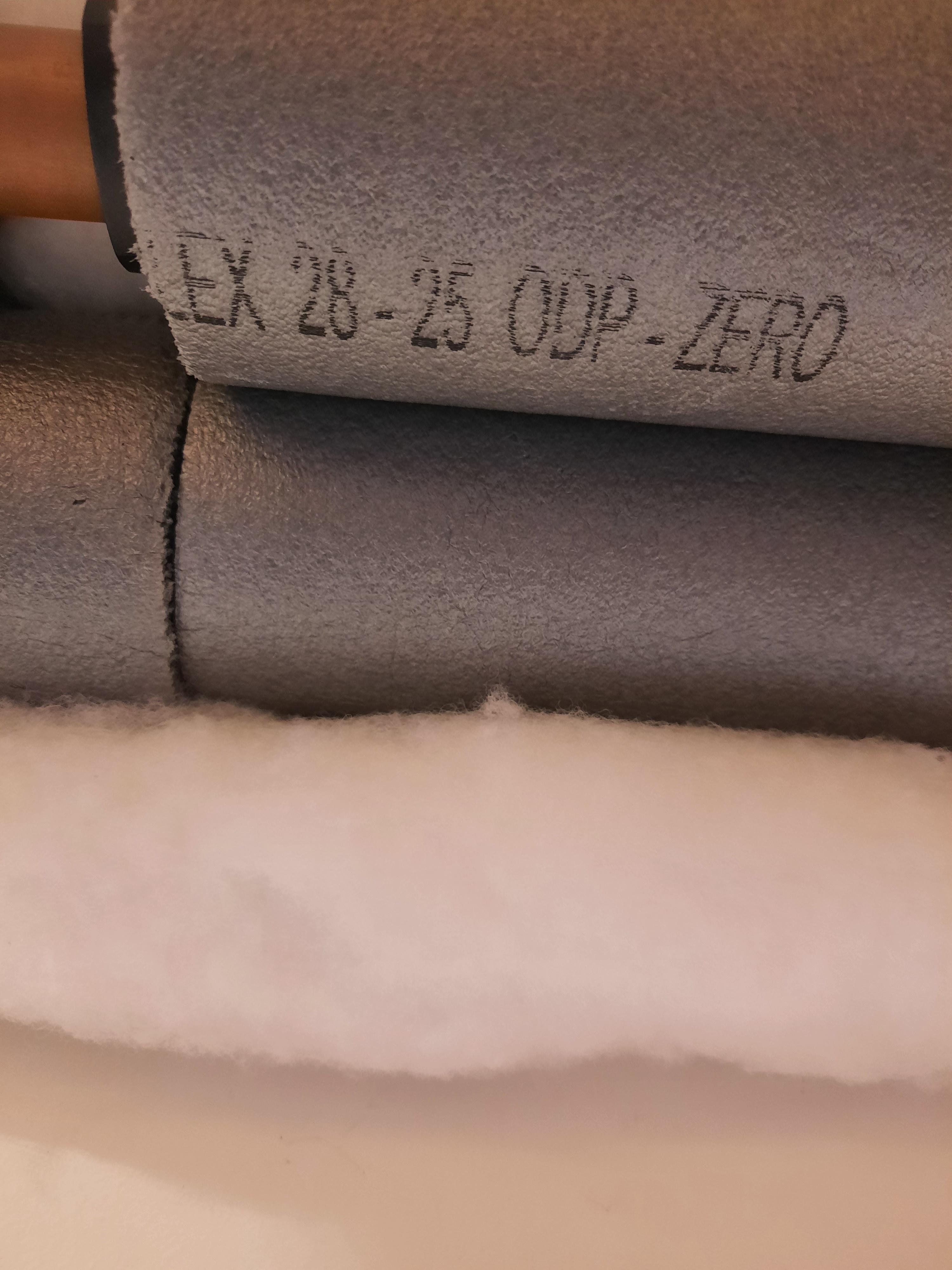

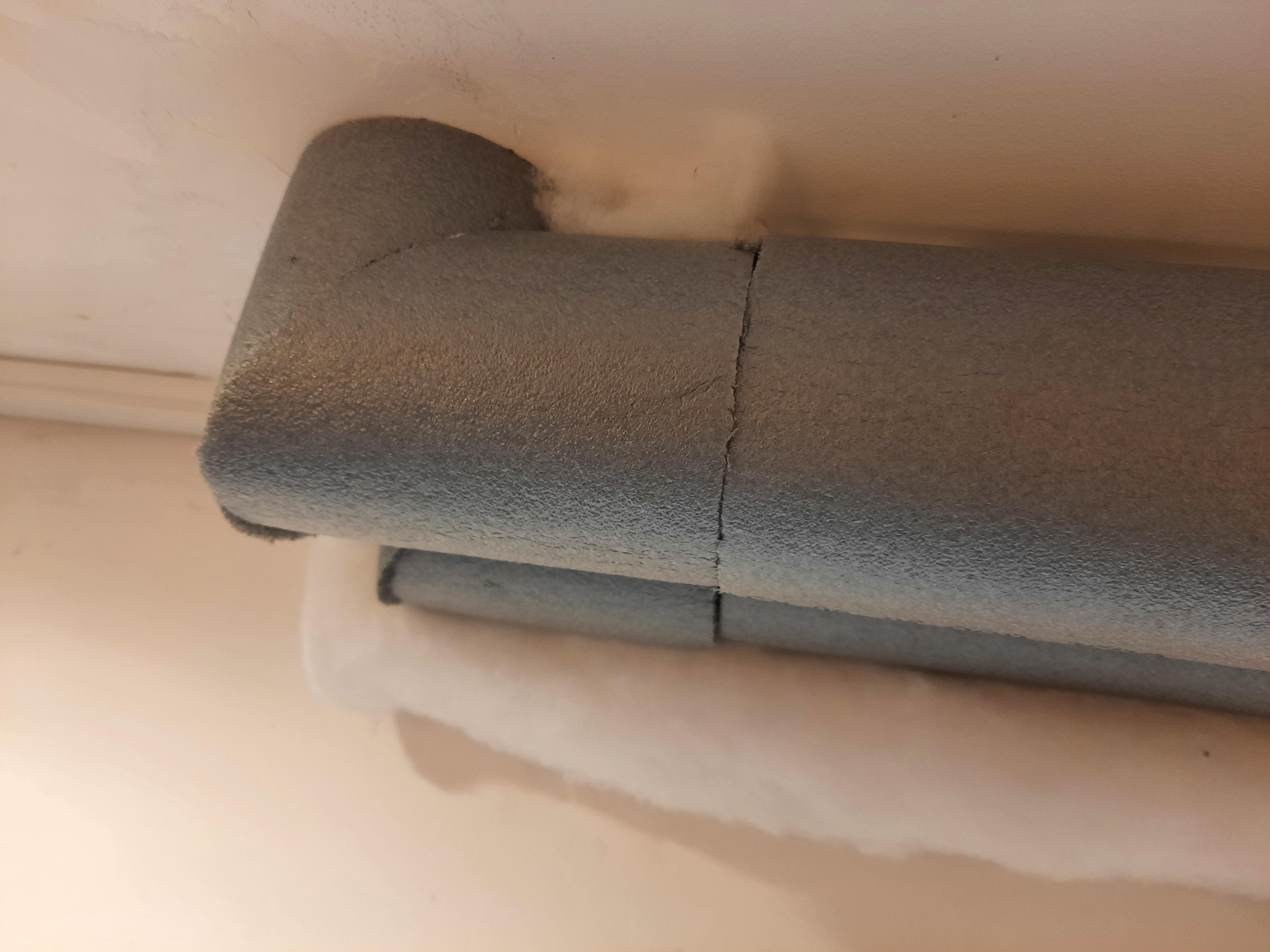

Marvin Posted July 28, 2022 Share Posted July 28, 2022 2 hours ago, Adsibob said: Any good recommendations for 22mm and 15mm pipe insulation? If the pipework is not subject to very high temperatures and not external, for me, climaflex was the best option. I bought it as thick as I could get on the pipes for any hot pipes. I set my pipes away from the wall to allow for this.Cuts easily with a hacksaw. Mitre the corners. Don't leave any gaps. It will shrink a bit over time so buy spare. Mine went about 10mm a metre. I used 25mm wall thickness on my 28mm pipe. This thickness is not cheap..... Link to comment Share on other sites More sharing options...

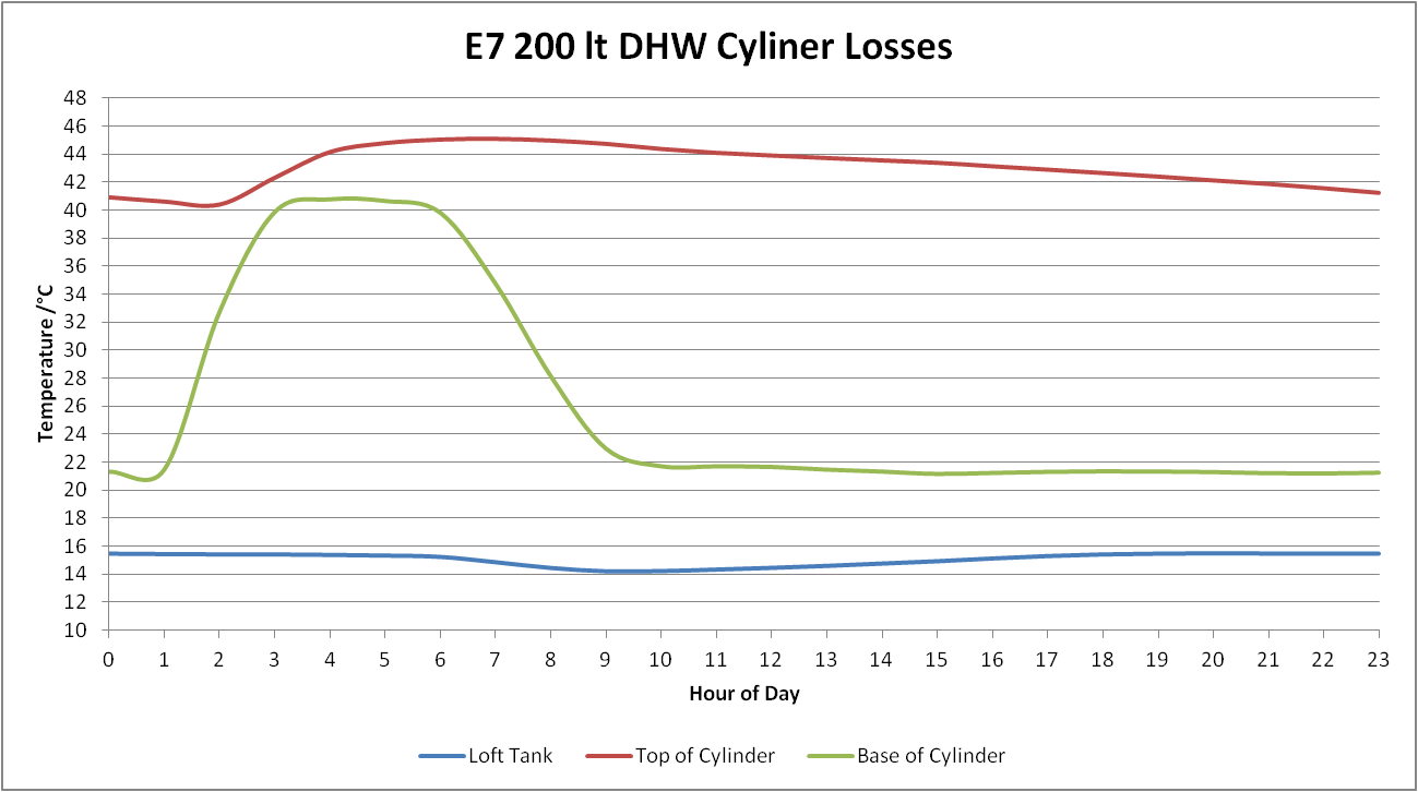

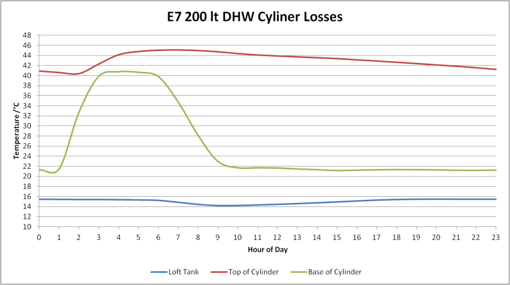

SteamyTea Posted September 21, 2022 Share Posted September 21, 2022 Shown this before. This is the temperatures logged on my E7 cylinder last year. The mean temperature differences (top of tank) are 4°C, but if taking just the times minimal water is drawn off (10AM to 1 AM next day), the standing losses is 3°C over 15 hours, that is 0.2°/hour. There is nothing special about my installation other than the cupboard it is kept in is stuffed full of insulation and I limit the charging times to 3 hours. So, I would not be happy with that sort of unnecessary losses. 11 hours ago, Nickfromwales said: Clients with these installed ( in PH settings ) have reported sub 1oC/hr losses from the Telford cylinders. 1 Link to comment Share on other sites More sharing options...
