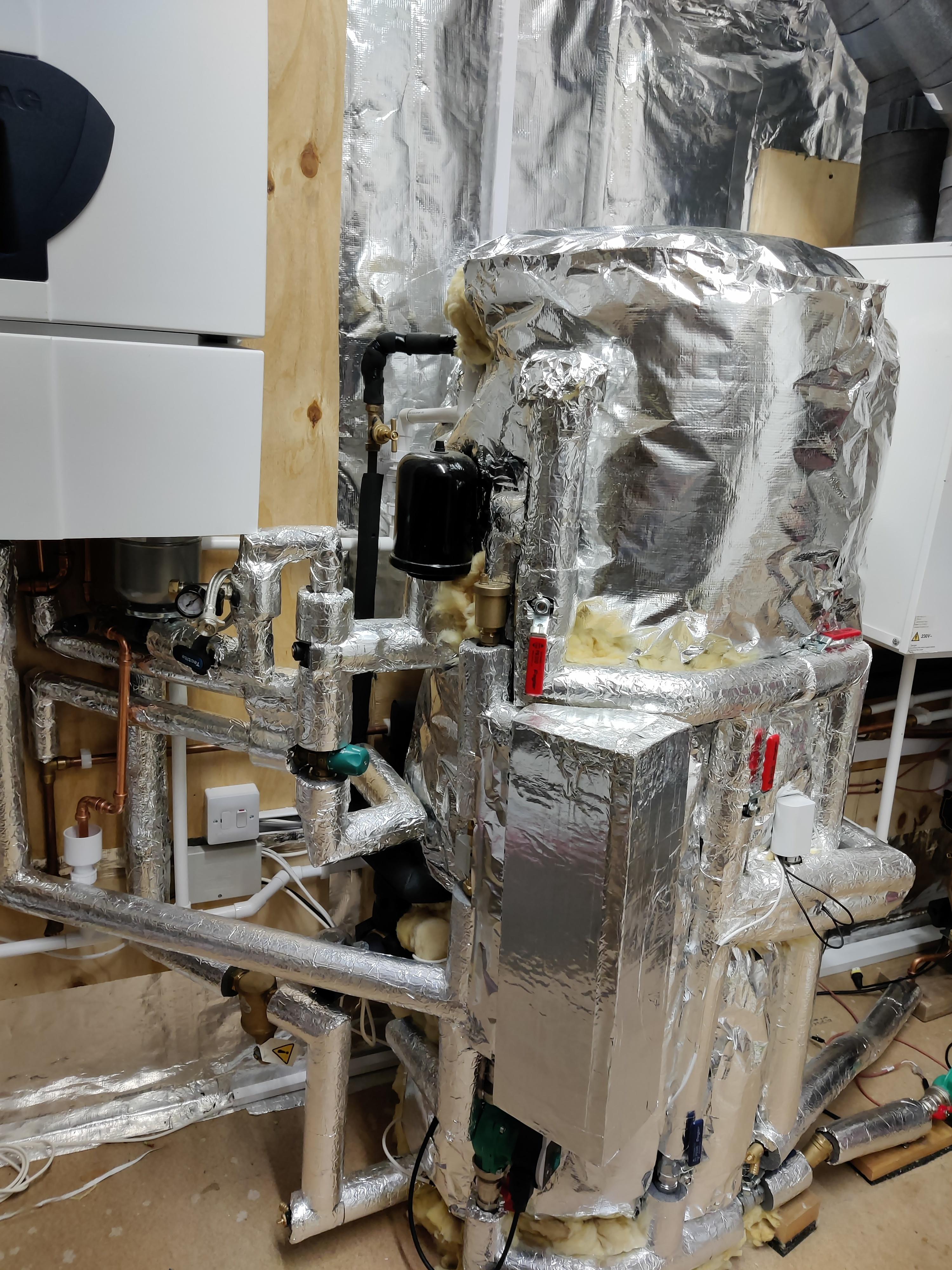

JohnMo Posted July 23, 2022 Share Posted July 23, 2022 I made one for mine, used off some vapour control fabric/foil, some left over mineral wool and double sided tape. Made a load of pillow/cushions, shaped to go around the cylinder. Two layers of vapour control fabric (back to back), double sided tape on 3 sides, fill with mineral wool seal with double sided tape. They can be easily removed if I needed access. Heat exchanger is wrapped in 25mm PIR. Took about an hour. 2 Link to comment Share on other sites More sharing options...
Adsibob Posted July 24, 2022 Author Share Posted July 24, 2022 17 hours ago, JohnMo said: I made one for mine, used off some vapour control fabric/foil, some left over mineral wool and double sided tape. Made a load of pillow/cushions, shaped to go around the cylinder. Two layers of vapour control fabric (back to back), double sided tape on 3 sides, fill with mineral wool seal with double sided tape. They can be easily removed if I needed access. Heat exchanger is wrapped in 25mm PIR. Took about an hour. Impressive! What was the energy rating of the cylinder before though, and what do you think you boosted it to with all that insulation? Link to comment Share on other sites More sharing options...
JohnMo Posted July 24, 2022 Share Posted July 24, 2022 Not sure of the original energy rating. But it leaked heat quite well. I had a section of the additional insulation off yesterday and you could feel outside of the cylinder hot. Which you didn't before. It still looses heat quicker than I want. Link to comment Share on other sites More sharing options...
scottishjohn Posted July 24, 2022 Share Posted July 24, 2022 8 minutes ago, JohnMo said: Not sure of the original energy rating. But it leaked heat quite well. I had a section of the additional insulation off yesterday and you could feel outside of the cylinder hot. Which you didn't before. It still looses heat quicker than I want. that does not suprise me If you add insulation to cylinder that will trap any heat loss of the cylinder between it and your better insulation . more important is how much heat can you feel on outside of the insulation layer , that is now your heat loss . so it would be important to make the room all this heating plant is to be very well insulated ,unless you are happy with the heat adding to your background house heating input. Link to comment Share on other sites More sharing options...

JohnMo Posted July 24, 2022 Share Posted July 24, 2022 OSO, do A rated cylinders, heat loss about 0.8kWh per 24 HR. Link to comment Share on other sites More sharing options...

Adsibob Posted July 24, 2022 Author Share Posted July 24, 2022 (edited) 1 hour ago, ProDave said: What is VERY important with any cylinder is insulate ALL the pipework connecting to the cylinder very well. That means good thick insulation and neat joints that are at least taped so no gaps. without insulation or with poor insulation you will lose more heat from the connecting pipes than from the cylinder. Yes, I’m finding that when I run the secondary loop pump, the heat loss is noticeably much more. The loop is insulated, but very badly. Plumber told me only a thin sheath of foam insulation was necessary because he was using buteline pipe for the loop, which being plastic doesn’t conduct heat very well. I believed him and now it’s too late to do much about it. I think I will invest in a couple of Shelley sensors and a Shelley switch and make the secondary loop pump only come in when two taps are walked near to, which are the only two taps where it is really necessary. The room where the cylinder is in is very well insulated and in the loft conversion so already quite warm, but I will wrap it in insulation anyway. I don’t have much space though. Suggestions for variable depth insulation (I have 4cm to 5cm of space on two sides of cylinder but zero on a third side as cylinder right up against the wall, and obviously space tends from 4cm to zero as one gets closer to that join with the wall). Edited July 24, 2022 by Adsibob Link to comment Share on other sites More sharing options...
SteamyTea Posted July 24, 2022 Share Posted July 24, 2022 52 minutes ago, Adsibob said: have 4cm to 5cm of space on two sides of cylinder but zero on a third side as cylinder right up against the wall Why do plumbers fit them like that every place I have owned has been the same. I lined two sides of my cylinder cupboard with Celotex, then filled the 'corners' with mineral wool. Celotex lid for the top. Pipe insulation does not have to be pipe shaped. Boxed in mineral wool works just as well, sometimes better. Thermal losses are not like water leaks, you don't loose a disproportionate extra amount of energy on a tiny length of uninsulated pipe. Unlike a water leak which seems to squirts further the small the hole is. 1 Link to comment Share on other sites More sharing options...

JohnMo Posted July 24, 2022 Share Posted July 24, 2022 Spurred on by this thread, have made an effort to reduce the piping heat losses further. Covering the hot piping areas in 25mm PIR sheeting (more left overs got rid off) and aluminium tape. Wife saying - your always messing about, don't know why your bothering. Link to comment Share on other sites More sharing options...

JohnMo Posted July 24, 2022 Share Posted July 24, 2022 Does look a bit like that and very silver. Link to comment Share on other sites More sharing options...

Adsibob Posted July 28, 2022 Author Share Posted July 28, 2022 @Marvin that's very interesting and useful info. I query though why you did it that way as opposed to buying one of those jackets from screwfix for £13. If i did use your method, I will need to change thermostats, which i fear will require draining the whole system. Also, why is this necessary: 20 minutes ago, Marvin said: All power cables in the insulation will need to be ducted. Link to comment Share on other sites More sharing options...
Marvin Posted July 28, 2022 Share Posted July 28, 2022 Hi @Adsibob You can always just chuck a jacket on, as long as you avoid the electric cable and immersion covers. My tank is a simple indirect one, and by the sounds of it yours sounds more complicated. what is it? It's unusual to drain down a tank to replace a thermostat. My buffer tank has pockets in which the probes fit in to. These pockets are a copper or brass tube which separates the space in the pocket from the water so no need to drain down. The electric cable supplying high energy to an emersion will heat up when there is demand and the heat in the cable needs to dissipate which it will not if encased in insulation. Link to comment Share on other sites More sharing options...
Marvin Posted July 28, 2022 Share Posted July 28, 2022 Hi @Adsibob A further thought... Going the simple way of jackets, you can put as many as you like around and on top of the tank, so long as you don't cover cables or immersion covers (leaving a clear flow of air to the immersion metal caps) If the tank is in the corner of a room and there are no cables in the area you can just fill all the gap no problem. The jackets are just loft insulation stuff wrapped in a plastic covering. You can condense them to squeeze them into gaps. if you fill the gap between the tank and the wall the thermal resistance of the heat coming out of your tank will now include the makeup of the wall so even better. (mine purposely had PIR installed in the wall for that reason). For clarity, the insulation's thermal resistance is measured by it resistance to temperature change and its thickness, however, as I understand it, squeezing two 100mm thicknesses into a 100mm gap will not make it twice as resistant because , as I understand it, the air gaps between the fibres are what cause it to resist thermal change. Definitely where possible wrap as much around as possible, squeeze thinner where no alternative, and you'll definetly save money in the long run. Link to comment Share on other sites More sharing options...
