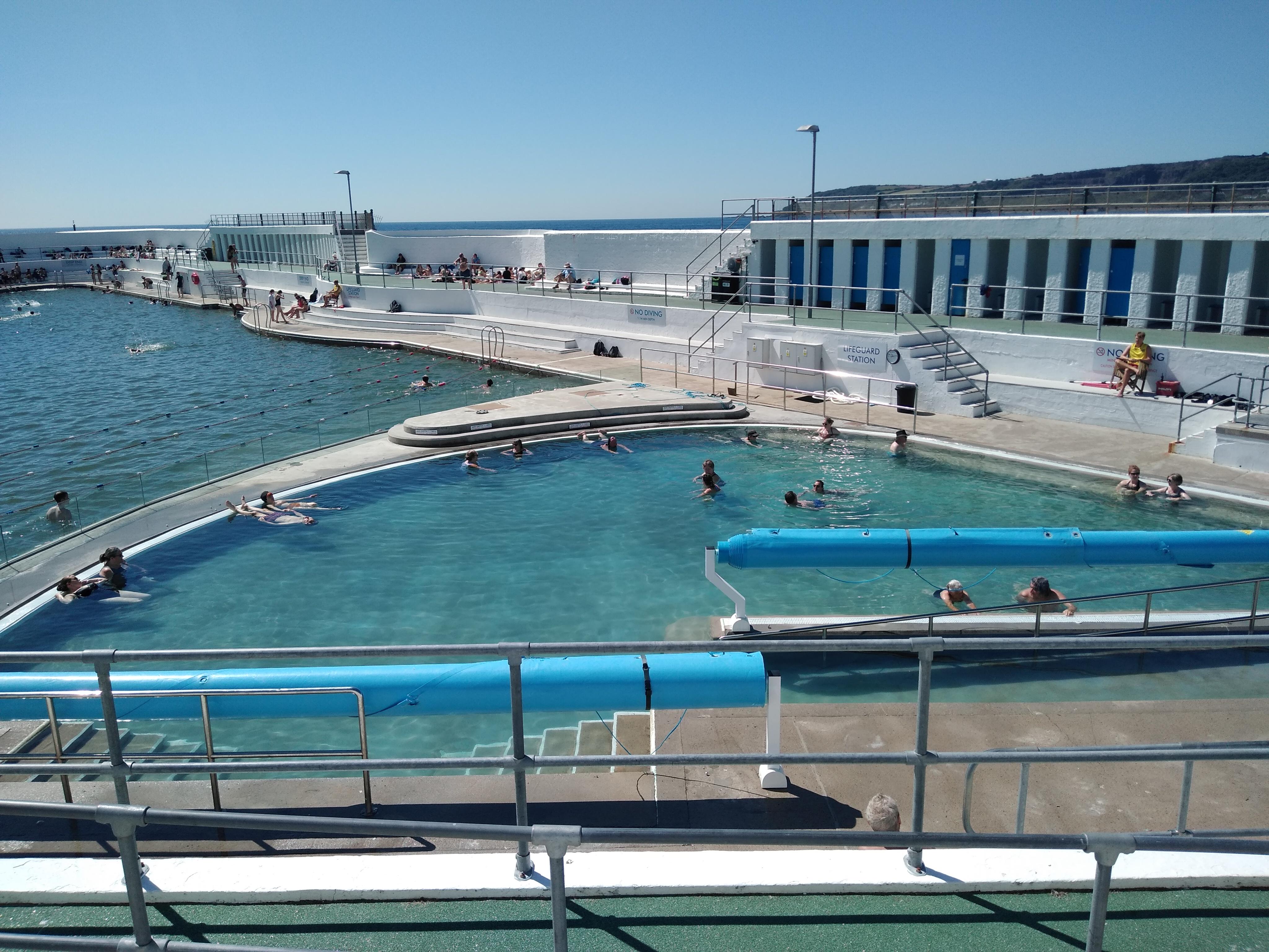

Here is what it costs to heat a small section of pool.
https://jubileepool.co.uk/pool-info/geothermal/
It was meant to be all GT, but as they were over enthusiastic amateurs, it all went wrong and they fitted a HP.
So really just a GSHP.
Odd choice as they have one if the world's largest bodies of seawater, that they pump in anyway, a few meters away.
It is 34°C today, they are proud to say it is too warm.
So they have no thermostat on it.
They also have the phones switched off 'because it is Monday, we don't open Mondays'. They do, (expletive deleted)ing amateurs spending my money.
