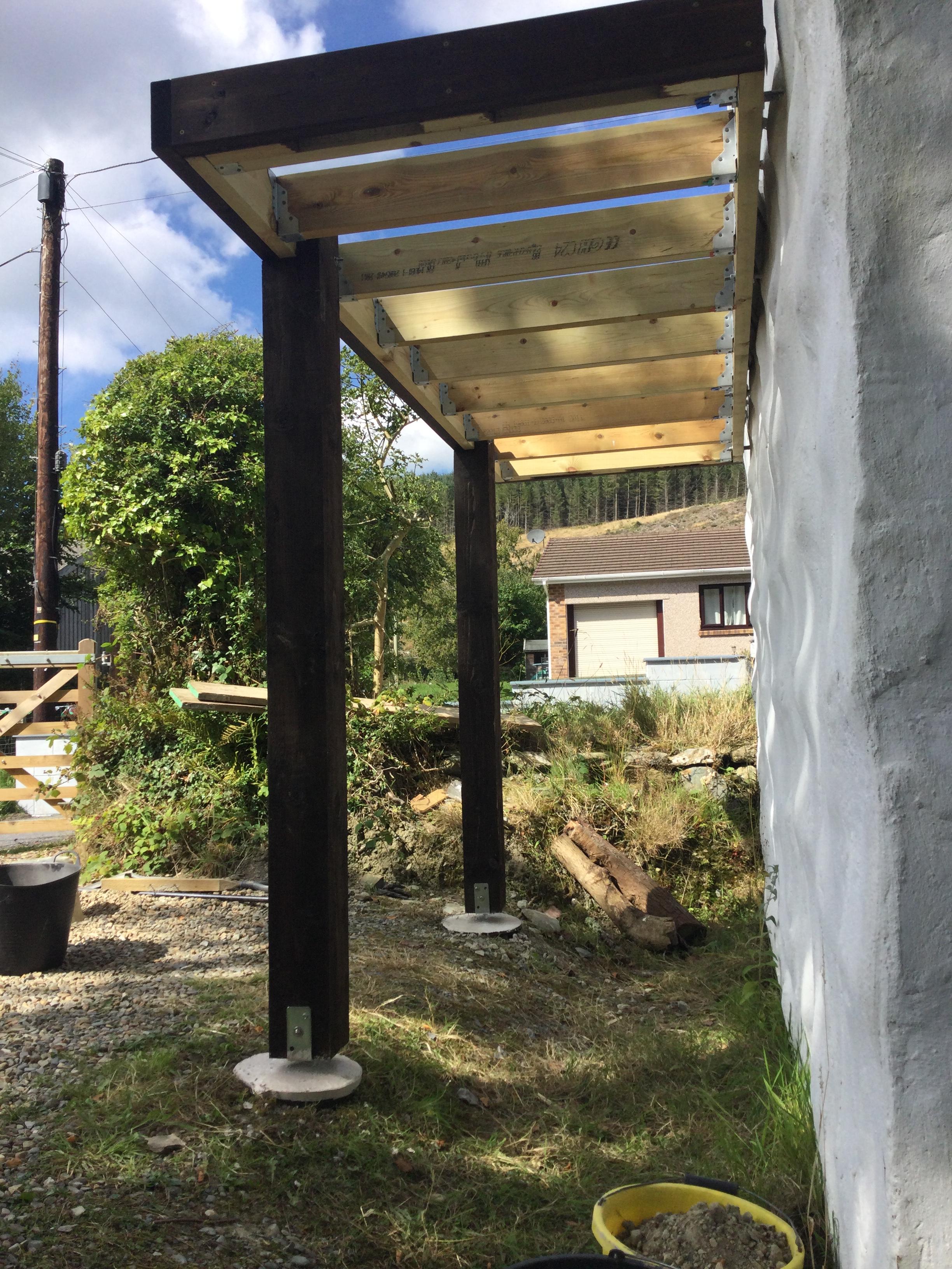

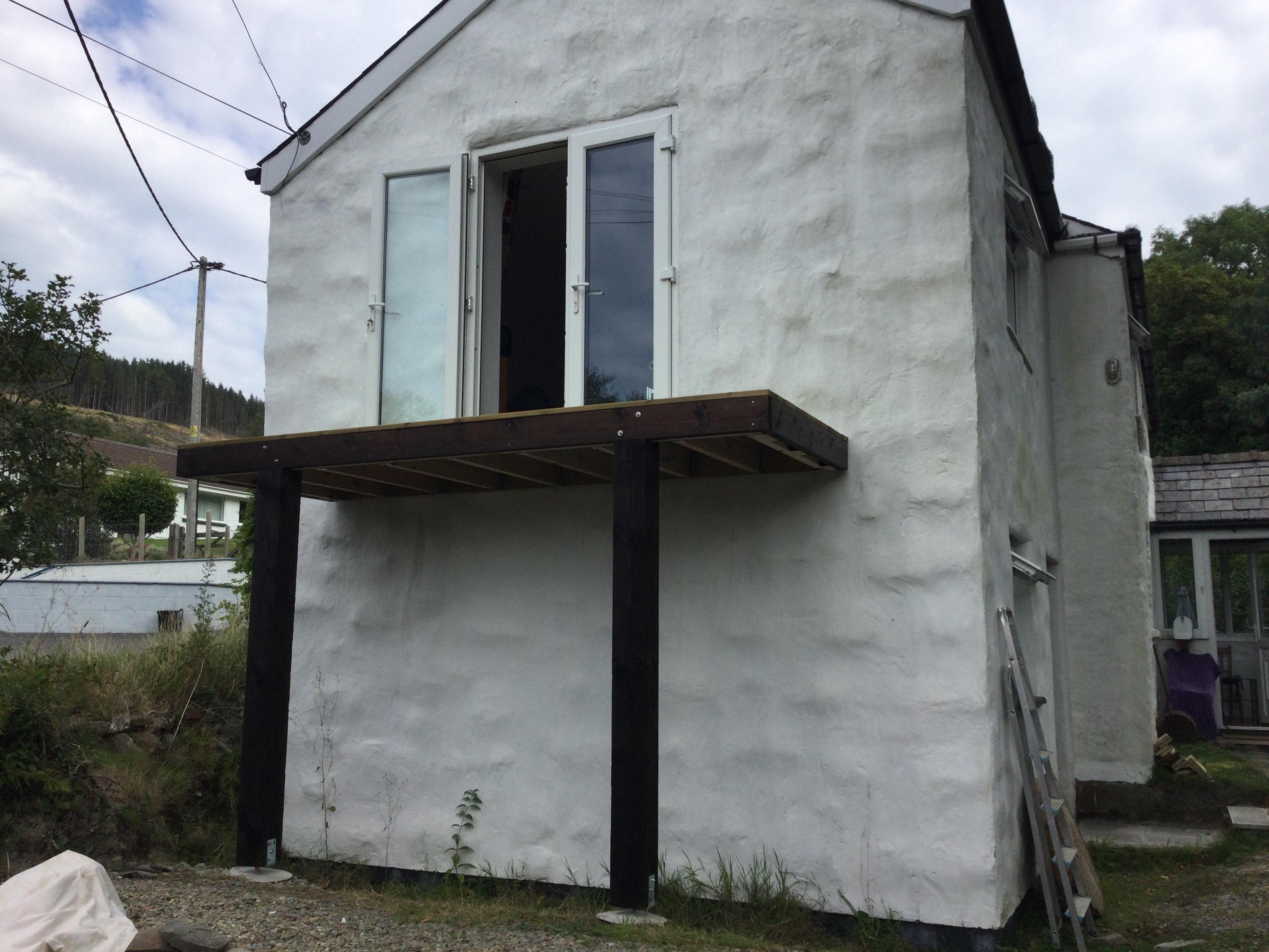

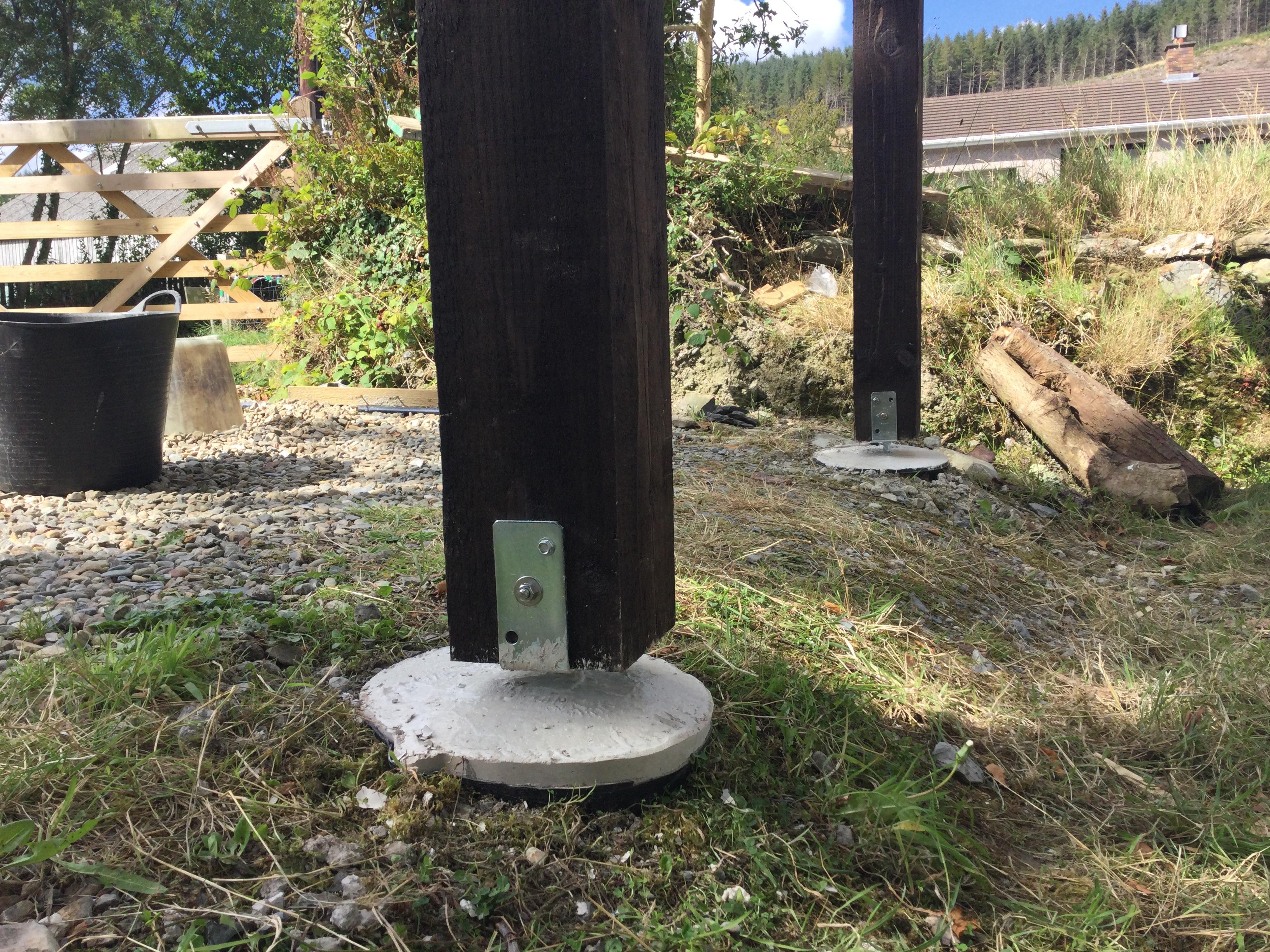

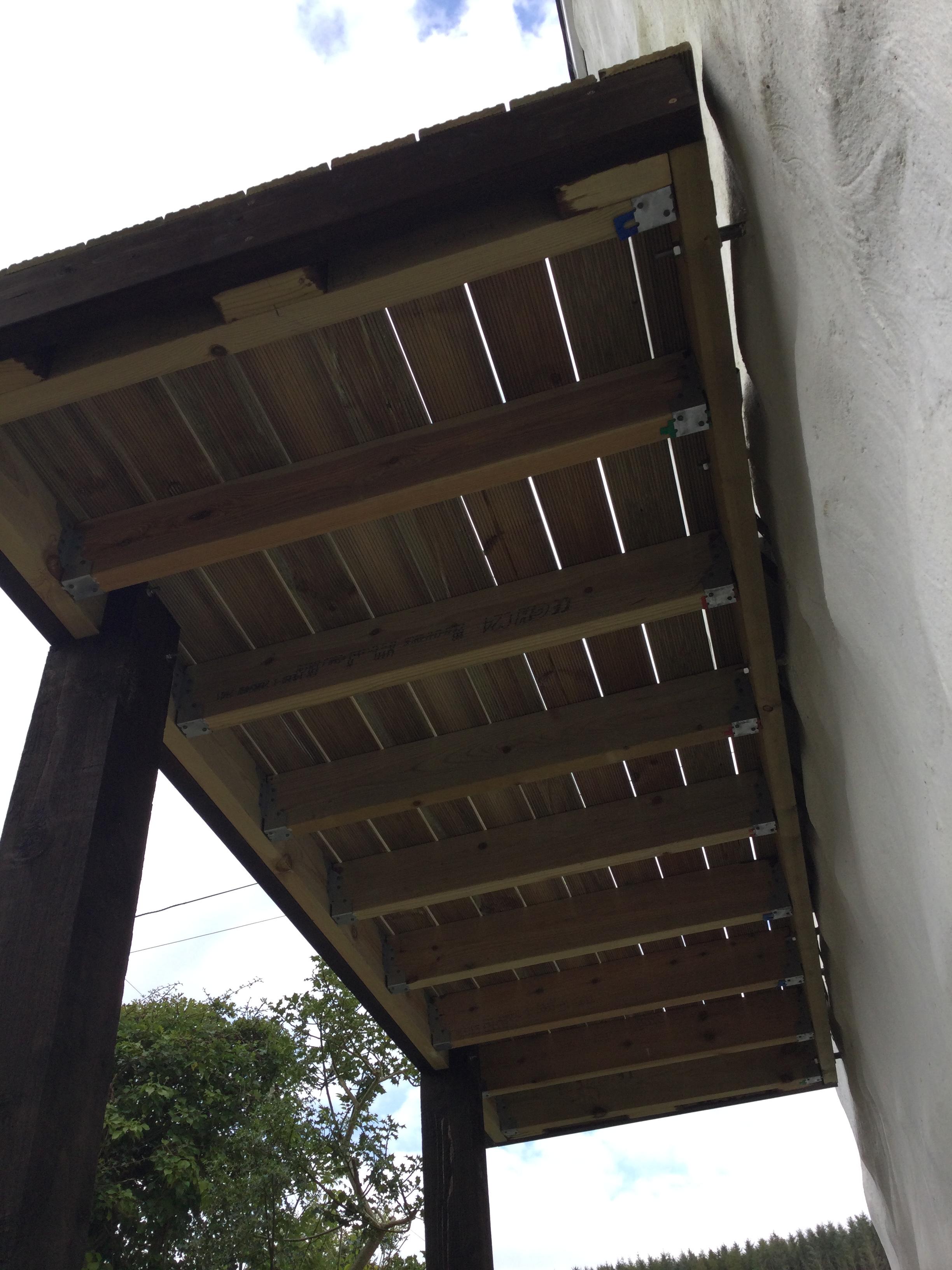

zoothorn Posted August 30, 2022 Author Posted August 30, 2022 (edited) Chaps, I have about 10mm-15mm of lateral 'flex' of the structure as it is.. at the front. Likely because of the steel tether points of both pillar spikes, & the steel ledger fix points (outwards of the wall by 50mm). Is this anything to worry about? Maybe expected before the handrail addition sures things up-? I wonder if this diagnosis suggests noggins needed. Thanks, Zoothorn Edited August 30, 2022 by zoothorn
markc Posted August 30, 2022 Posted August 30, 2022 Some flex and racking is to be expected until it is held square by bracing or the deck you put on it
zoothorn Posted August 30, 2022 Author Posted August 30, 2022 4 minutes ago, markc said: Some flex and racking is to be expected until it is held square by bracing or the deck you put on it Hi markc, ah yes of course: understand the deck boards ( delivery here tmrw) will hopefully sure things up. Will report back tmrw once these put down tmrw. Update photos too- concrete pads seems good, if a bit unsightly! Thx zh
TonyT Posted August 30, 2022 Posted August 30, 2022 I think full depth noggins would be good. maybe put half the decking in first then you will ensure that the noggins land right under a board and not in the gap between 2 boards ( this just traps water) I did 6mm gap, used offcut of plywood to ensure space was accurate
zoothorn Posted August 30, 2022 Author Posted August 30, 2022 1 hour ago, TonyT said: I think full depth noggins would be good. maybe put half the decking in first then you will ensure that the noggins land right under a board and not in the gap between 2 boards ( this just traps water) I did 6mm gap, used offcut of plywood to ensure space was accurate Is there any reason you can't put nogs in after the boards on? Am I being daft asking this? I have some unused 4x2 I could put in as nogs.. don't suppose they -have- to be 6x2'x, do they? And nogs are just 2 nails in each end, right? Nothing more than that needed. I could come back to this job, if the deck boards don't fix my flex I guess.. wait until. Thanks, useful replies TT.. zh

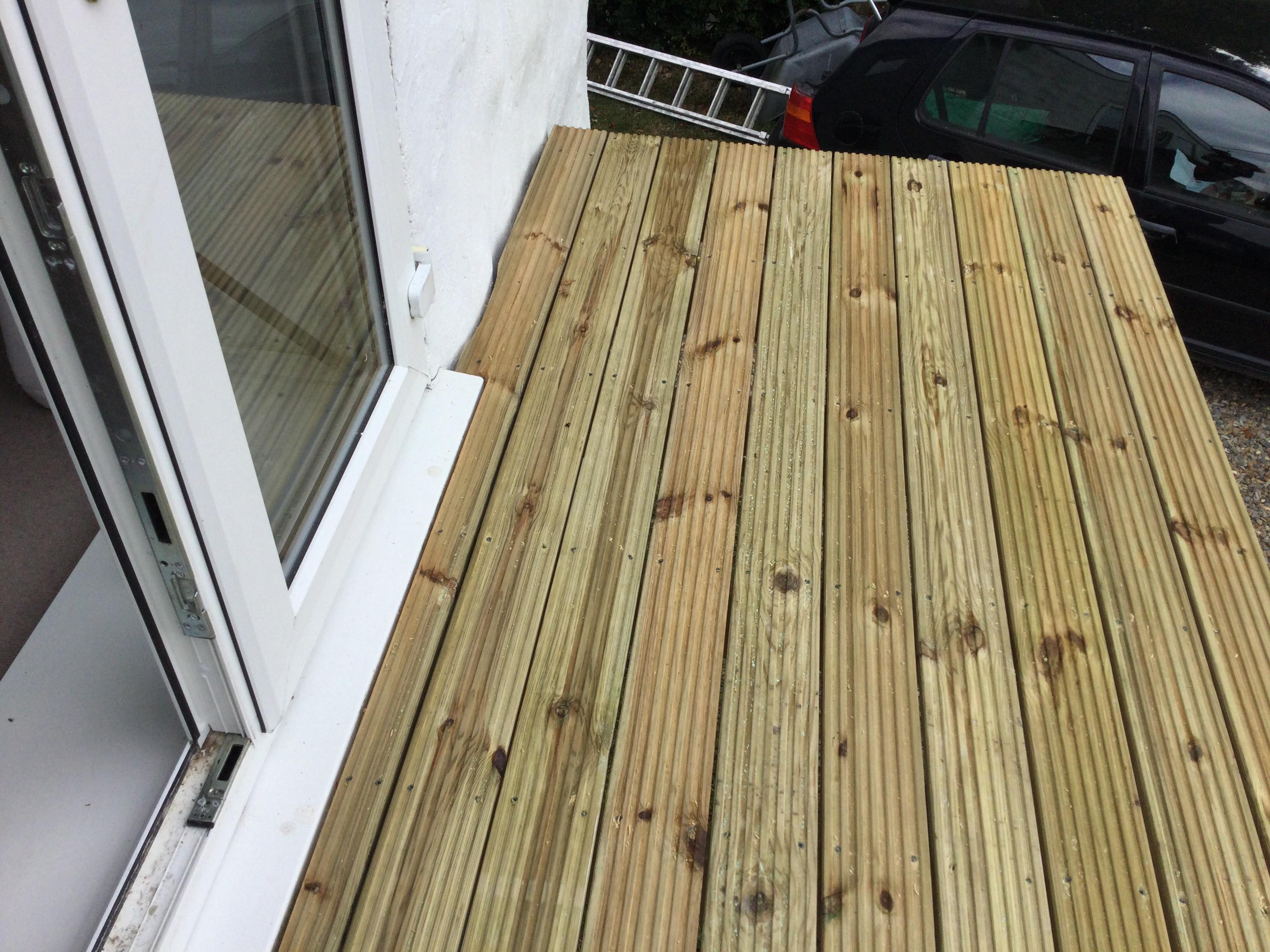

zoothorn Posted August 31, 2022 Author Posted August 31, 2022 Update. Deck boards here. Joists all nailed in. Which way to start the boards? from front edge, or back? The back has the doors' cill jutting out say 50mm, so I need to "board around" this.
zoothorn Posted September 1, 2022 Author Posted September 1, 2022 I don't think I need nogs now- boards sured things up well. All set to come back to & do hand rails, in a week or so. It's a fab spot to sit- real knockout views. Thanks alot chaps, zoot

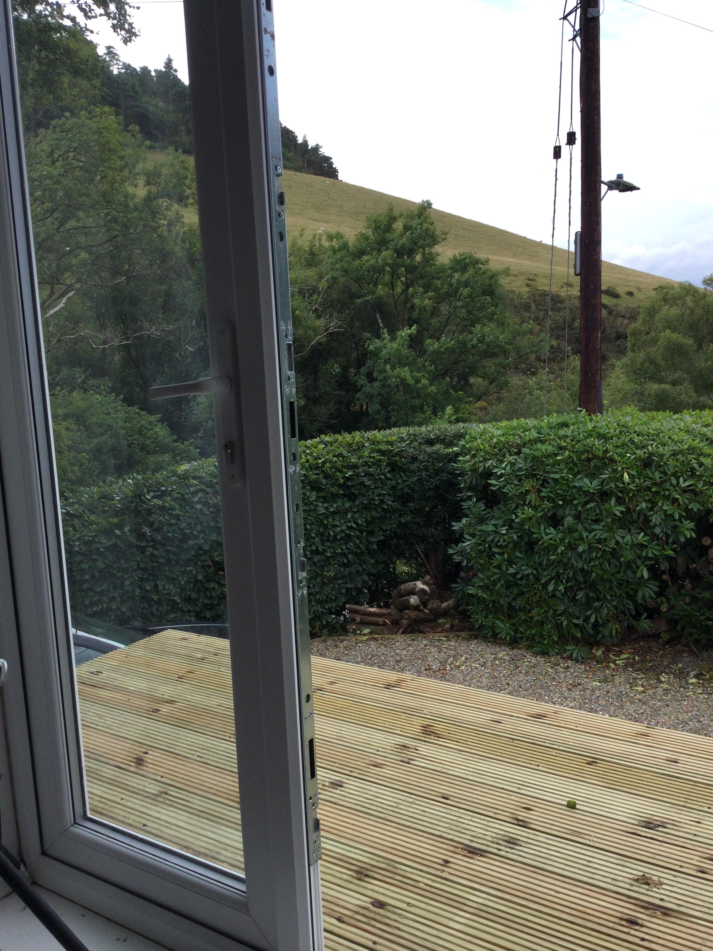

zoothorn Posted September 3, 2022 Author Posted September 3, 2022 On 01/09/2022 at 17:19, Canski said: fantastic views. Hi Canski, sat out 1st time last ev.. on this LHS, & it's an absolute knockout spot. And the RHS door gives me a bit of privacy in fact/ damn useful choice doors opening out this way after all. 1
