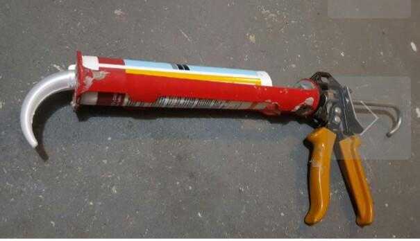

zoothorn Posted August 13, 2022 Author Share Posted August 13, 2022 29 minutes ago, Onoff said: ย Also see comments made on 12th & 15th June ref "siliconing" around the spacer. This was before you'd gone I think with recessing the spacer into the render.ย ย Assumed you'd done this already. Will you be able to get in there to do it with the ledger board in the way? Sorry I glossed over this/ didn't click at the time. ย I can only get a gun tube nozzle into the topside of the upper ones, & underneath for the green lower ones. ย I need to get a finger or a very thin trowel in the tricky sides. ย Zh Link to comment Share on other sites More sharing options...

zoothorn Posted August 13, 2022 Author Share Posted August 13, 2022 I cant get to the centre top one, at all. But if I silicone my 5mm gap between cill & ledger, before the deck boards go on.. I should be ok just. ย The rest half I can only get a finger to, on the tricky side as it were. 1 inch mask tale for reference. ย 1 Link to comment Share on other sites More sharing options...
zoothorn Posted August 13, 2022 Author Share Posted August 13, 2022 You see I can get nozzle under here.. but accessing from above is n/a. ย I'll buy the sika anyway, use a wet finger or summink. ย @Onoffย could you tell me if postcrete is ok for my bucket-filled concrete pads idea? ย Thanks, zoot ย ย Link to comment Share on other sites More sharing options...

Onoff Posted August 13, 2022 Share Posted August 13, 2022 47 minutes ago, zoothorn said: You see I can get nozzle under here.. but accessing from above is n/a. ย I'll buy the sika anyway, use a wet finger or summink. ย @Onoffย could you tell me if postcrete is ok for my bucket-filled concrete pads idea? ย Thanks, zoot ย ย ย Should have "siliconed" it before the ledger went on. Oh well!ย ย ย Link to comment Share on other sites More sharing options...
Onoff Posted August 13, 2022 Share Posted August 13, 2022 Wondering at a custom 3D printed nozzle: ย ย https://www.thingiverse.com/thing:4215459 Link to comment Share on other sites More sharing options...
zoothorn Posted August 13, 2022 Author Share Posted August 13, 2022 1 hour ago, Onoff said: ย Should have "siliconed" it before the ledger went on. Oh well!ย ย ย Got a bit excited. The weird nozzles a leftfield idea! ย I need to do today tho, before weather breaks. So got some Sika sbt+ & will have to wangle it in somehow. ย Got a postcrete bag, & cheapo buckets. But no galv brackets in town. So.. will have to wait for amazon ones, i 'll buy today. ย Damn useful link that one Onoff, your help invaluable of course.ย ย I can crack on with side outer 6x 2's, the sika job, ย get the joists in maybe too.. if you think ok to? Or maybe leave this added weight until pillars done . ย Thanks, Zoot Link to comment Share on other sites More sharing options...

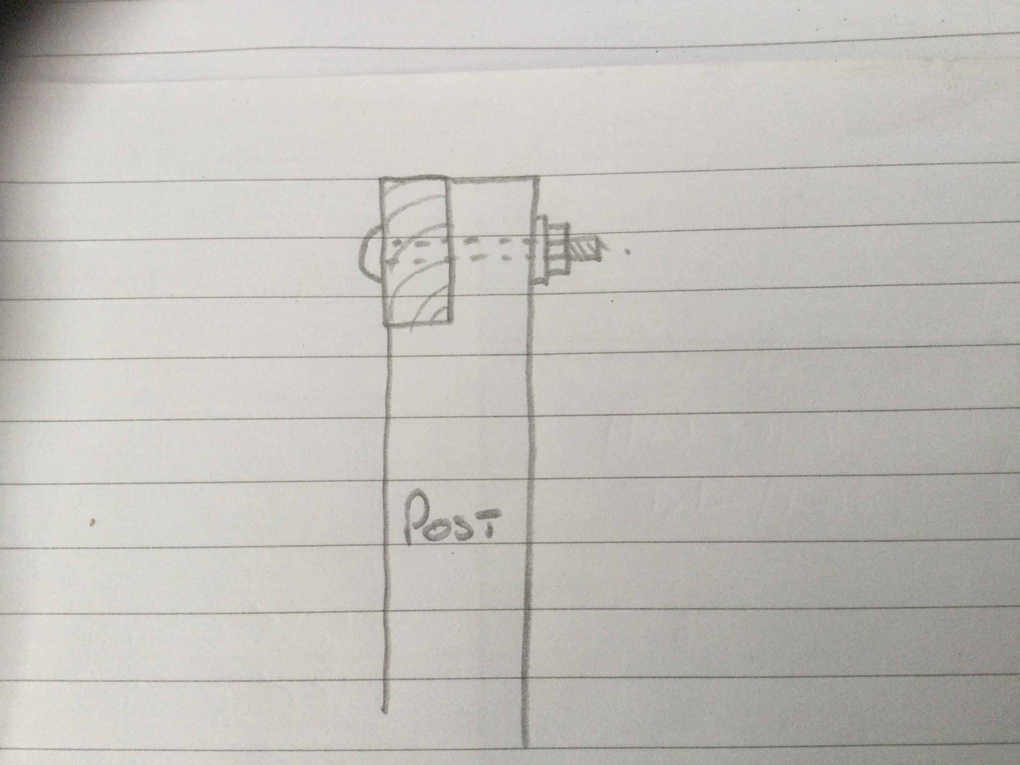

joe90 Posted August 13, 2022 Share Posted August 13, 2022 How are you going to join pillars to 6x2,s? I would do thisโฆ. Link to comment Share on other sites More sharing options...

zoothorn Posted August 13, 2022 Author Share Posted August 13, 2022 2 hours ago, joe90 said: How are you going to join pillars to 6x2,s? I would do thisโฆ. Hi J, yes exactly what I had in mind. On the LHS here, a bit of 8x2 goes as cladding.. just along the front. ย Video simply has the chap fire thru 2 long torque screws thru both 2" D timbers, & onward into the pillar. Maybe some of my bigass turbo screws. Or your coach bolts idea here is possibly ย best. ย A wait on the galv shoe brackets tho. Thx zoot Link to comment Share on other sites More sharing options...
