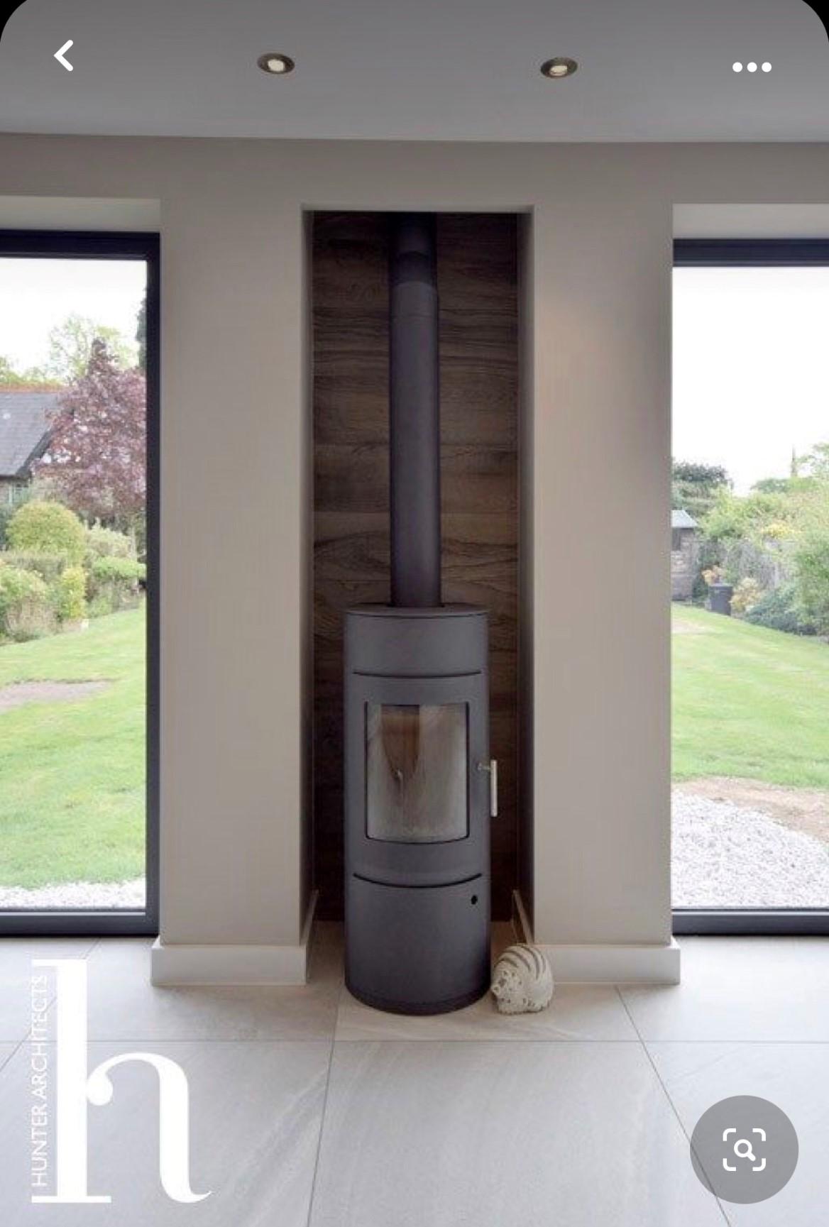

richo106 Posted June 1, 2022 Share Posted June 1, 2022 Hi All We are just going through some bits with our builder, we will be having a new chimney constructed and having a log burner installed, I have attached a pic that we (the wife) has decided on I have a couple of questions if any one could help: Can the log burner just sit on a tiled floor? Or does it need a hearth? What is the best way to line inside the fireplace, I am guessing plaster will just crack? When does the fire get installed or can the builder do everything first and the fire place can be installed after? It will be a direct air fed log burner so just planning on going straight out the back...this the best way to do it? Do the builders need to do anything to leave it ready for the fire installers? Any other advice/information would be greatly appreciate on this matter Link to comment Share on other sites More sharing options...

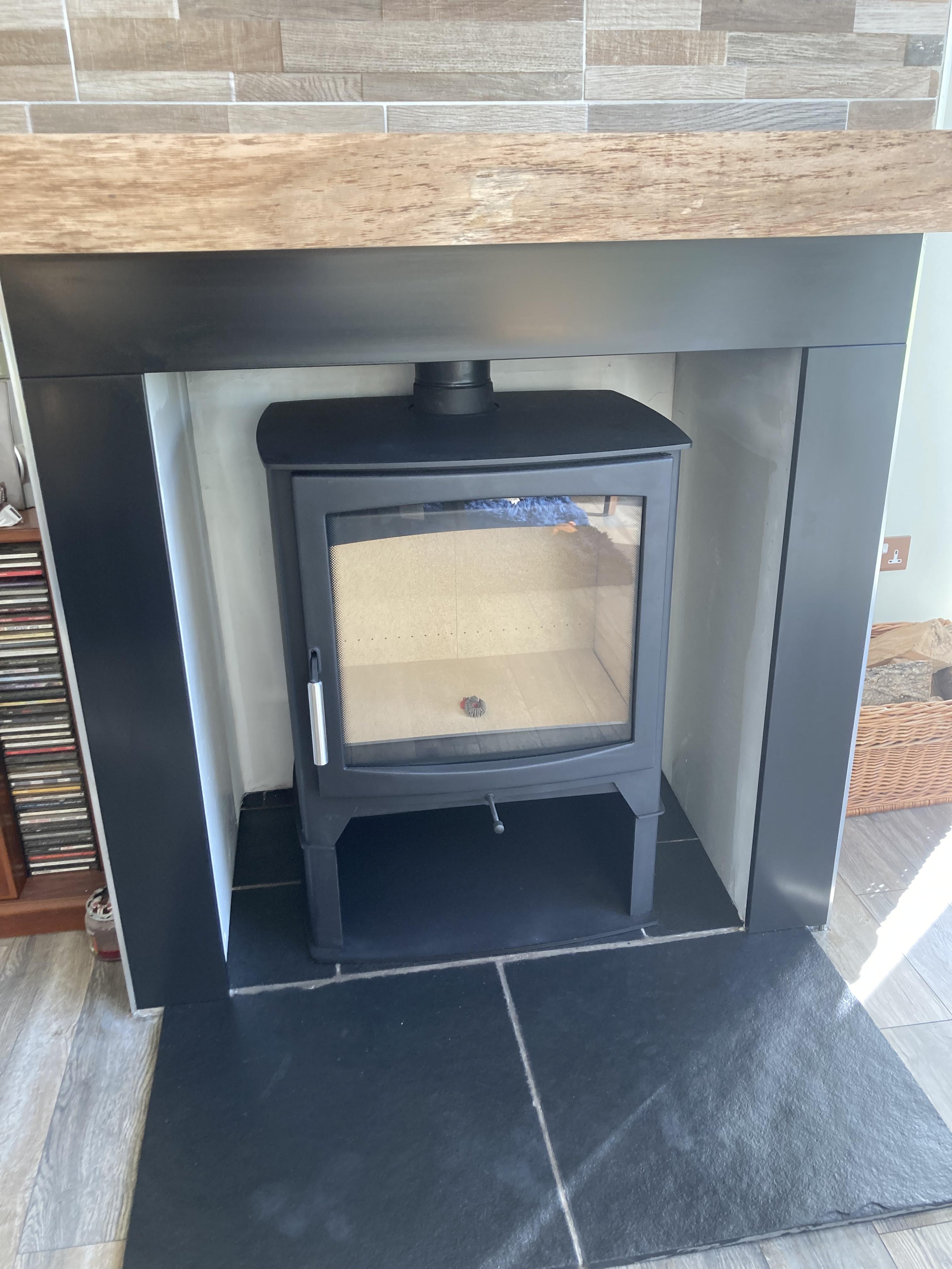

recoveringbuilder Posted June 2, 2022 Share Posted June 2, 2022 On 01/06/2022 at 16:20, Ralph said: Do you mind me asking what kind of price the install was? We've not got round to putting one in yet but a mate had some quotes in our area and they were north of £8k for the install alone. We put in a 15kw parkray, we had a good bit of the twin wall already in situ because we previously had a biomass stove so we only needed a length and a couple of bends. The installer also lined the space it went into and provided slate for around the opening and an oak beam. The whole thing cost £4.5k , installation was just over £1k included in that price Link to comment Share on other sites More sharing options...
Ralph Posted June 2, 2022 Share Posted June 2, 2022 50 minutes ago, recoveringbuilder said: We put in a 15kw parkray, we had a good bit of the twin wall already in situ because we previously had a biomass stove so we only needed a length and a couple of bends. The installer also lined the space it went into and provided slate for around the opening and an oak beam. The whole thing cost £4.5k , installation was just over £1k included in that price Looks nice. Link to comment Share on other sites More sharing options...

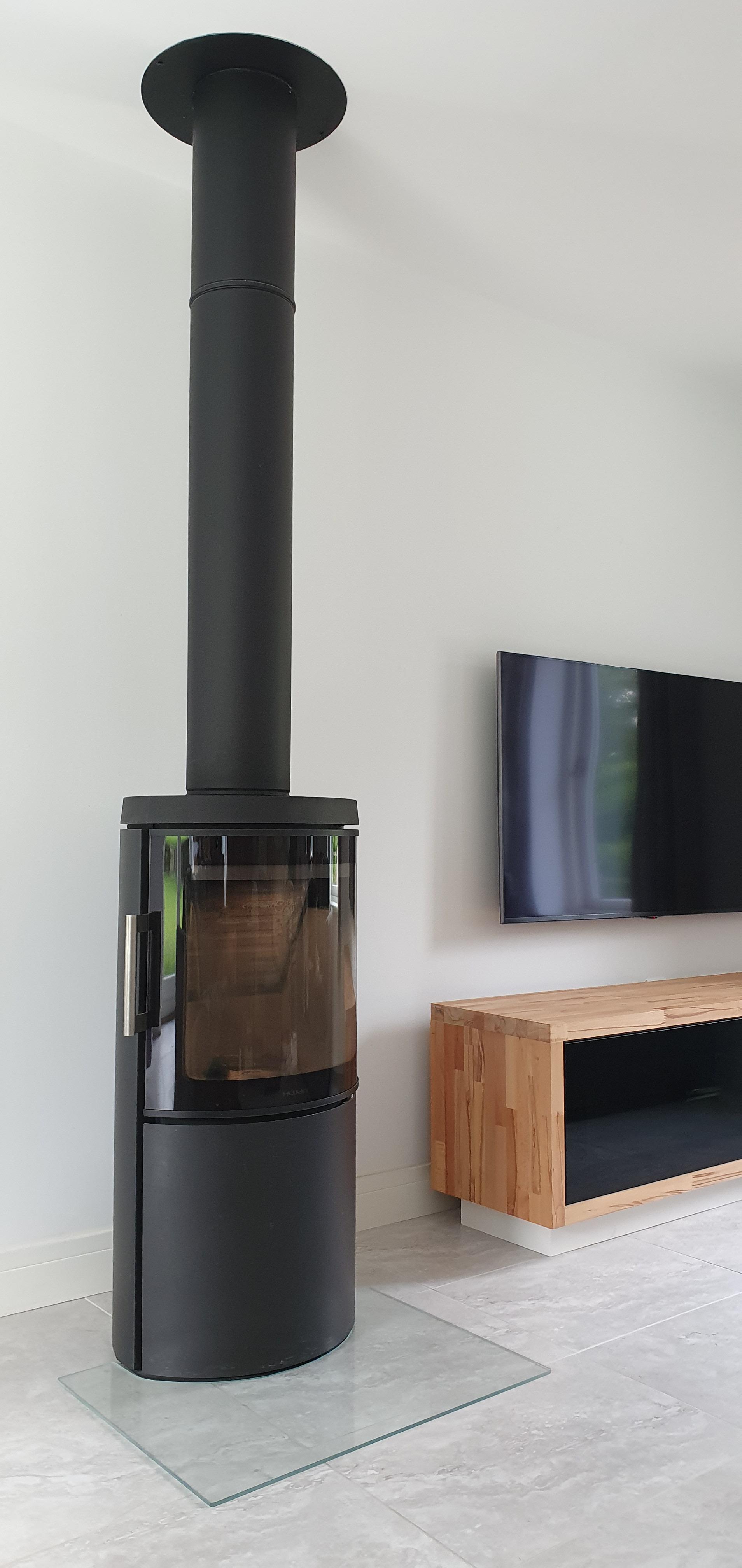

Roundtuit Posted June 3, 2022 Share Posted June 3, 2022 A hearth isn't always needed, it depends on your choice of stove. This is ours; ceramic tiles over anhydrous screed, HETAS installed and no issue with BC at sign-off (England). (The glass on the floor was a later addition to keep the grout clean). 1 Link to comment Share on other sites More sharing options...
