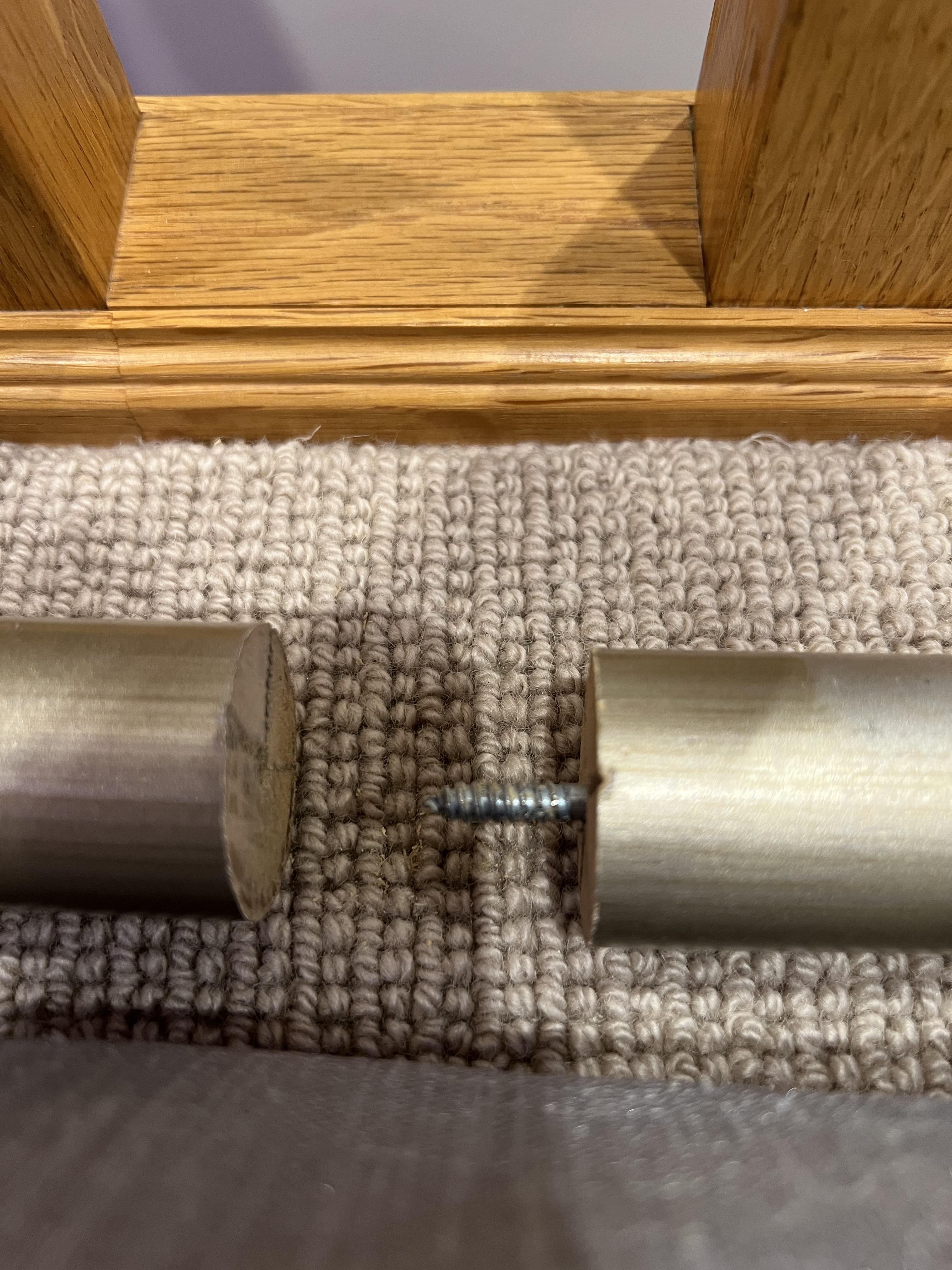

steveoelliott Posted May 11, 2022 Posted May 11, 2022 Hi Folks, After taking down a couple of existing long Laura Ashley wooden curtain rails in our house, I've noticed that where the two parts of the pole screw together in the middle, the hole is now too large for the screw and it just turns. Probably a really simple solution but I am thinking wrapping some electric tape around the screw before attempting to tighten of stick a broken matchstick into the hole but the last thing I want to do is split the pole. Thanks in advance.

ProDave Posted May 11, 2022 Posted May 11, 2022 Typical rubbish design (don't be fooled by a posh make) A screw self tapping into a hole in a bit of wood that has worn and the screw now falls out. Post a very close up / macro shot of where the 2 bits meet and someone might suggest an alternative way of securing them. I would be looking personally at trilling a hole right through and a nut and bolt, or simply a larger screw but would need to see the details of what is there first.
Simplysimon Posted May 11, 2022 Posted May 11, 2022 araldite the hole and smear the screw with light oil if you wish it to come back out. screwing it in will allow the araldite to conform to the thread 1
steveoelliott Posted May 11, 2022 Author Posted May 11, 2022 Thanks all… one end of the screw is in one pole and the other is just a pre drilled hole. If it had a steel thread in the female side initially I think it would be better. Anyway glue and or plugging seem to be way to go. Personally I don’t think it needs to come apart after.
steveoelliott Posted May 11, 2022 Author Posted May 11, 2022 (edited) 11 minutes ago, ProDave said: Typical rubbish design (don't be fooled by a posh make) A screw self tapping into a hole in a bit of wood that has worn and the screw now falls out. Post a very close up / macro shot of where the 2 bits meet and someone might suggest an alternative way of securing them. I would be looking personally at trilling a hole right through and a nut and bolt, or simply a larger screw but would need to see the details of what is there first. Edited May 11, 2022 by steveoelliott
steveoelliott Posted May 11, 2022 Author Posted May 11, 2022 Agree on the rubbish design… here is a pic
ProDave Posted May 11, 2022 Posted May 11, 2022 Yes you could spend ages to engineer a better solution such as embeding a metal thread into the pole. Or just glue it. Actually i would first try running a 5.5mm drill down the hole and inserting a red 6mm rawl plug for the screw to screw into. 1
steveoelliott Posted May 11, 2022 Author Posted May 11, 2022 6 minutes ago, ProDave said: Yes you could spend ages to engineer a better solution such as embeding a metal thread into the pole. Or just glue it. Actually i would first try running a 5.5mm drill down the hole and inserting a red 6mm rawl plug for the screw to screw into. Sounds sensible to me. Much appreciated.
Onoff Posted May 11, 2022 Posted May 11, 2022 Remove the existing screw with mole grips. Drill & put one of these in each face. These are M6 but M5 would be fine. Short bit of stud between the two. https://www.screwfix.com/p/insert-nuts-type-d-m6-x-13mm-50-pack/59937 1

Temp Posted May 12, 2022 Posted May 12, 2022 14 hours ago, Onoff said: Remove the existing screw with mole grips. Drill & put one of these in each face. These are M6 but M5 would be fine. Short bit of stud between the two. https://www.screwfix.com/p/insert-nuts-type-d-m6-x-13mm-50-pack/59937 or drill and glue in M5 round connector nuts with a length of threaded rod.. https://www.ebay.co.uk/itm/111805113838?hash=item1a081aa5ee:g:sHwAAOSwTzVcms95 https://www.ebay.co.uk/itm/322308108964?hash=item4b0b0f72a4:g:5-oAAOSwcd9feIHO 1
markocosic Posted May 12, 2022 Posted May 12, 2022 Drill it 12 mm and glue in a length of M12 threaded rod...as a permanent dowel? 1
saveasteading Posted May 12, 2022 Posted May 12, 2022 I would fill the hole with a paste of wood glue and sawdust. Then fix as originally. 1
SteamyTea Posted May 12, 2022 Posted May 12, 2022 You could, take it to a specialist engineering company and get them to accurately bore holes the complete length of each half. Then get a tie rod and washers and nuts at each end. Tension the tie rod up. Think of it as a pre-stressed structural member. Where is @Gus Potter he could calculate how many turns on a threaded bar will be needed. Or just stick a rawl plug in a hole. 1
