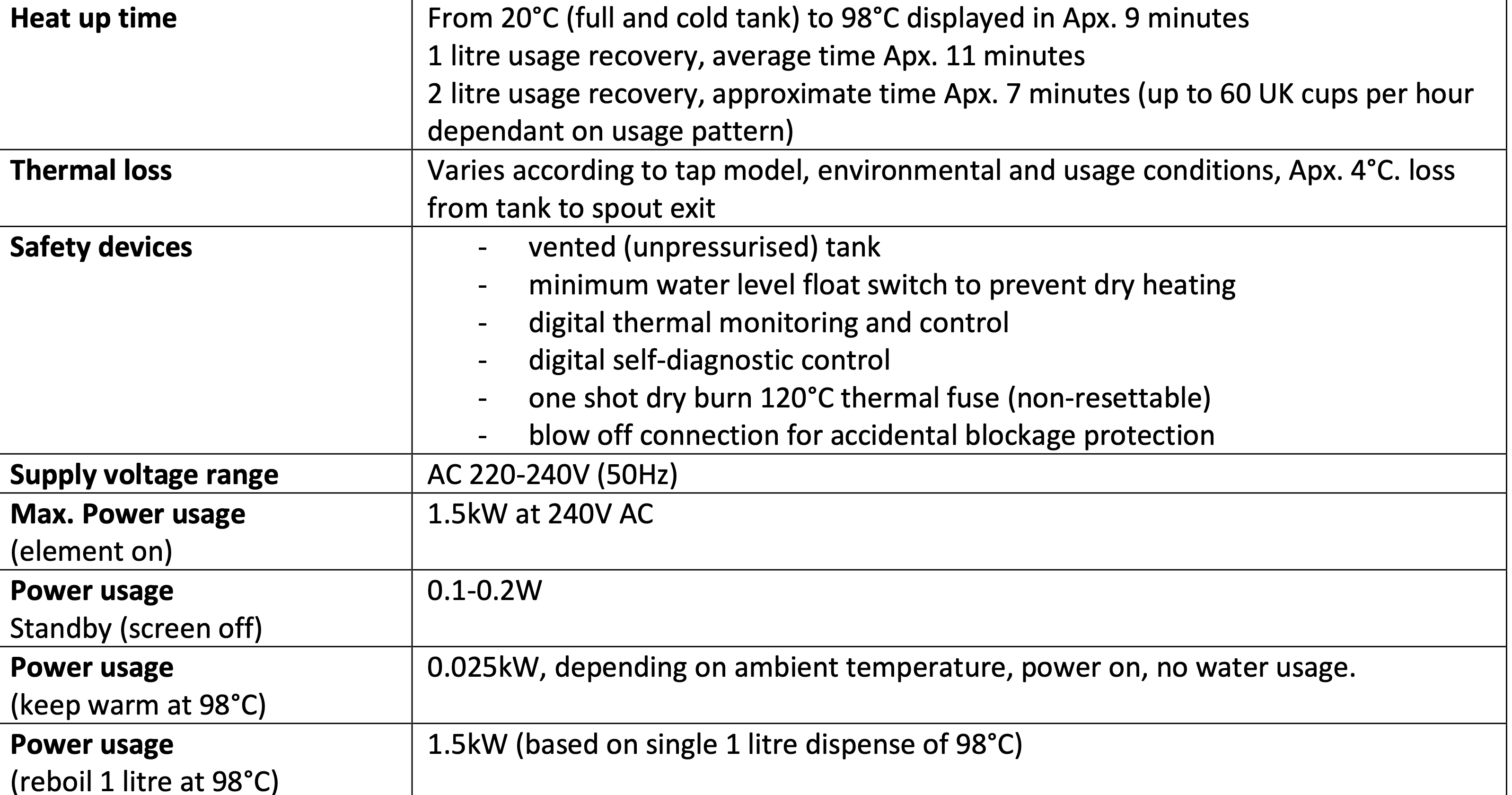

AliG Posted May 11, 2022 Posted May 11, 2022 i would guess it is this kind of boiler unit as it is 2.1litres in size and heats to 98C. https://www.pronteau.co.uk/downloads/installation/proboil-2x-user-and-installation-guide.pdf The manual is not exactly clear, but mentions 0.025kW heat loss at 98C. It doesn't say per what period, but I would guess per hour. It also says that the maximum energy use is 1.5kW and it takes 9 minutes to heat the tank from 20 to 98C. It also says it takes 11 minutes to recover from 1l use and 7 minutes from 2l use which makes no sense at all. The 9 minute heat up time is consistent with a 1.5kW heating element and 2.1l of water. Anyway assuming 0.025kW heat loss then it would use 0.6kWh of energy per day or approx 18p. This suggests that it loses almost 10C per hour so I could see why it comes on quite often to reheat. However the element should only be running for approx 1 minute an hour. It may be that once it has been on the sound continues for a while, worth checking that's it is not running for as long as the sound can be heard. To save money by turning it off it would have to get down to a point where the heat loss slowed considerably. The trouble is that the heat loss slows as it gets cooler and I don't know how to calculate the time it would take to cool all the way down. The least it could be would be 8 hours, but it would be somewhat less as it would slow as it cools down. There is an argument to turn it off when you go on holiday, saving just over £1 a week, but not to turn it off overnight.
ProDave Posted May 11, 2022 Posted May 11, 2022 21 minutes ago, AliG said: The manual is not exactly clear, but mentions 0.025kW heat loss at 98C. It doesn't say per what period, but I would guess per hour. That means it is losing heat like having a 25w heating element under your sink. So it will consume (thanks to that heat loss) 25wh in an hour and 600wh or 0.6kWh in a 24 hour period, just to make up the heat that it has lost. so at present electricity prices it will be costing about 15p per day just to keep the water inside it hot and ready for use.
AliG Posted May 11, 2022 Posted May 11, 2022 Each time you boil 1l of water it uses around 0.1kWh so this is using the equivalent of 6 boils per day to keep the water hot, whereas a Quooker is using the equivalent of 2.5 boils/day. Assuming an average boil is around 1l. We have a Quooker, but I am under no illusions that it is simply a very expensive and convenient kettle. I would note that almost everyone I know who has one loves it. If something does the intended job and you find it useful then the expense is less of an issue. They try to make an argument that it saves money over a kettle as people tend to boil too much water. If you boil the kettle 10 times a day this would be true of a Quooker. This less well insulated device would probably need you to be boiling the kettle 13-14 times a day to save anything in terms of running costs. We certainly would never have boiled the kettle more than 10 times a day. The reality is that no one should be buying these for running cost savings. You might save 10p a day in electricity, but only if you drink a lot of tea/coffee, but they cost the best part of £500-1500 to buy and install which more than offsets this. For most people they also actually cost a bit more to run than a kettle.
