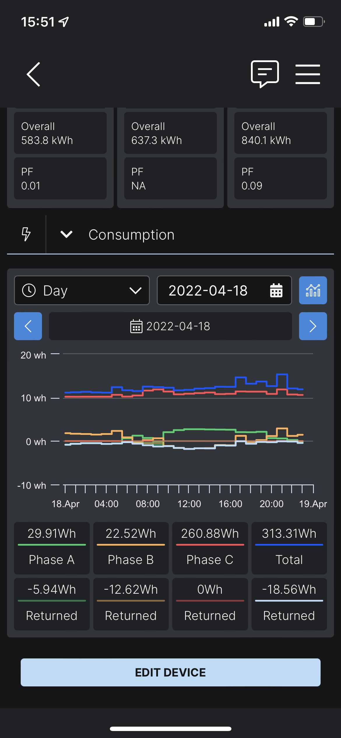

Wil Posted April 27, 2022 Share Posted April 27, 2022 (edited) Ah the missing h. I apologise for my sit units. It was apparently 313.31Wh if we’re being pedantic. And only applies to the iVT26. And I’m on economy 7 so it was less than 10p in standby for each unit for the day. But hopefully the information is actually useful to the thread. Edited April 27, 2022 by Wil 1 Link to comment Share on other sites More sharing options...
joth Posted April 27, 2022 Share Posted April 27, 2022 37 minutes ago, Wil said: Ah the missing h. I apologise for my sit units. It was apparently 313.31Wh if we’re being pedantic. 🙂 I don't care much about KwH vs kWh etc, but W vs Wh is a very important difference. It's like asking someone "how far is it to Scunthorpe?" and getting the reply "yesterday I did 45 mph" Link to comment Share on other sites More sharing options...
Wil Posted April 27, 2022 Share Posted April 27, 2022 I know, I know, I’m even an electrical engineer so it’s just slightly upsetting to get caught getting it wrong. I’m still waiting for ST to come back and tell me that’s more than he consumed in his one bed flat for the entire week… 😂 1 Link to comment Share on other sites More sharing options...

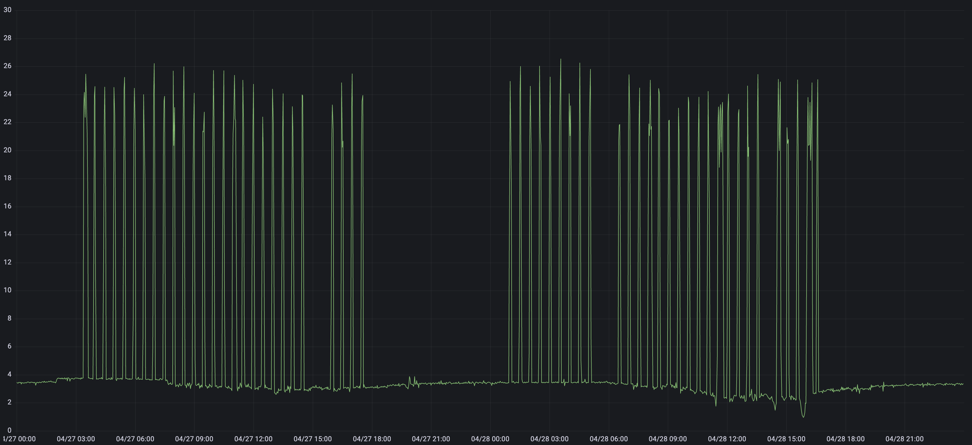

joth Posted April 29, 2022 Share Posted April 29, 2022 4 minutes ago, SteamyTea said: Do we think that ~25W is a reasonable standby load? Still about 70 quid a year. Personally I'd be unhappy with 25W continuous. But my hunch is @Kevm has only sampled periods when the compressor heater is "on" , and hasn't averaged it out over the 'off' periods. As you see below, it draws about 25W peak For me, over 2 days on standby (in April), it's only on for less that 25% of the time, hence my measured 5.5W average standby load. 5.5W I can live with. It's not ideal, I'd much rather have a (scroll) compressor that avoids the need for this by design. Ecodan has certainly dropped off the list I'd recommend to someone because of this. For an occasional use property (holiday let, etc) this becomes even more stark. Link to comment Share on other sites More sharing options...

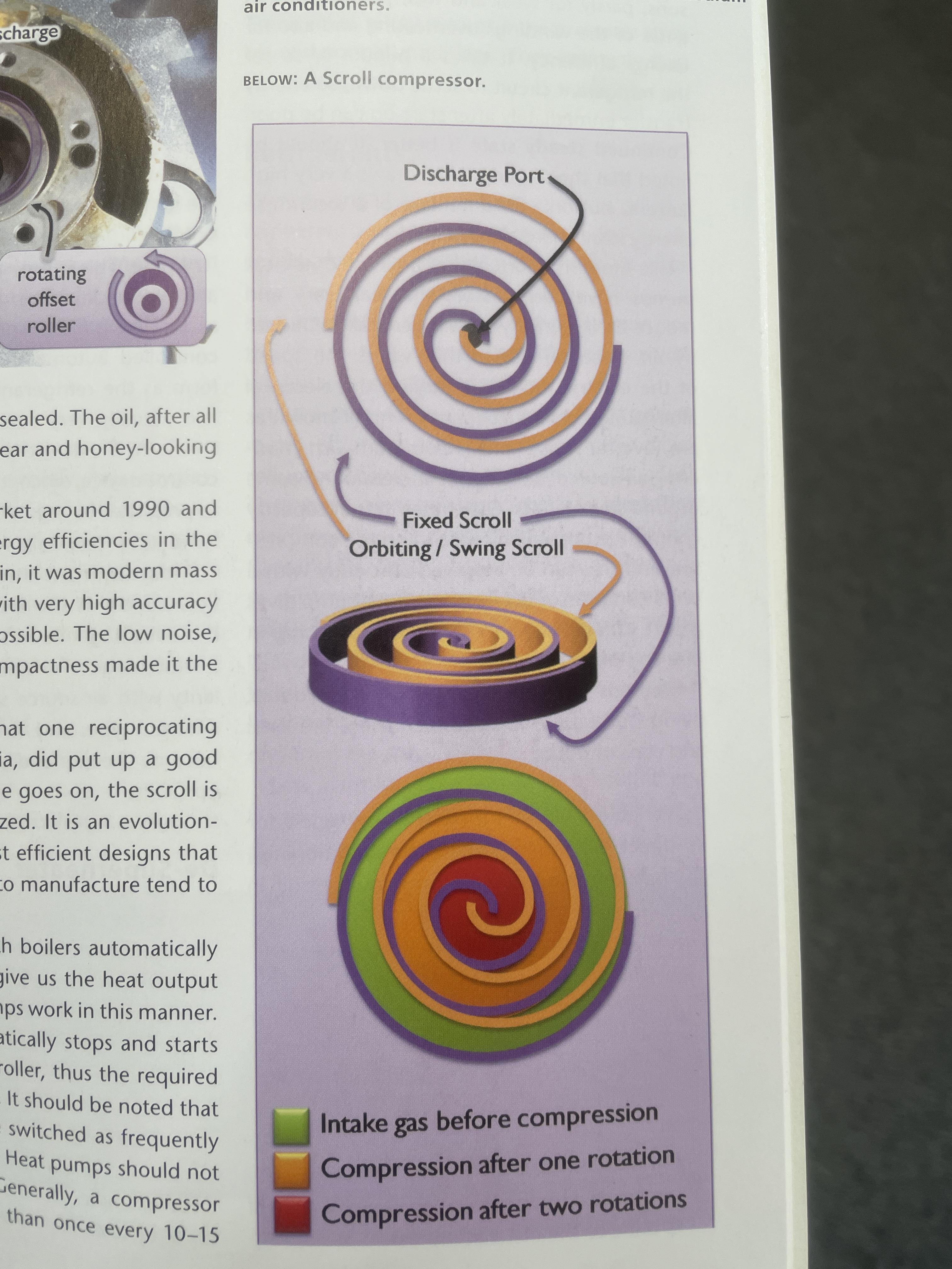

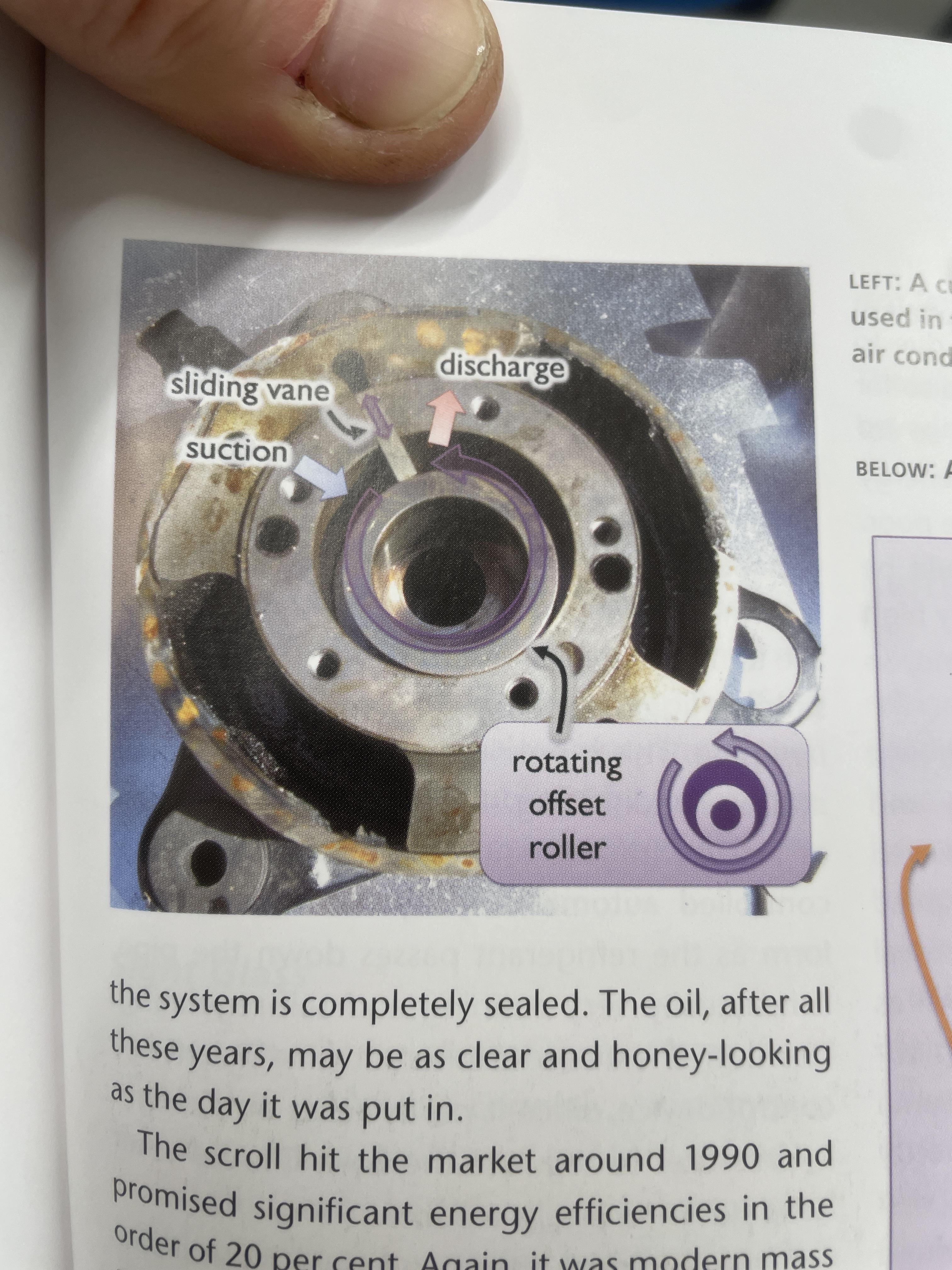

rh2205 Posted April 29, 2022 Share Posted April 29, 2022 We have an ASHP with a twin rotary compressor, do I just not understand compressors as I thought that was neither reciprocating nor scroll… we haven’t noticed any obvious standby use, but I’m going to do a more thorough recording over next few days as I try not worry myself with the finer details! Link to comment Share on other sites More sharing options...
HughF Posted April 29, 2022 Share Posted April 29, 2022 (edited) 1 hour ago, rh2205 said: We have an ASHP with a twin rotary compressor, do I just not understand compressors as I thought that was neither reciprocating nor scroll… we haven’t noticed any obvious standby use, but I’m going to do a more thorough recording over next few days as I try not worry myself with the finer details! Reciprocating is a piston compressor, rotary is a rotary vane, scroll is an oscillating scroll Edited April 29, 2022 by HughF Link to comment Share on other sites More sharing options...
HughF Posted April 29, 2022 Share Posted April 29, 2022 Link to comment Share on other sites More sharing options...
Kevm Posted April 29, 2022 Share Posted April 29, 2022 6 hours ago, joth said: Personally I'd be unhappy with 25W continuous. But my hunch is @Kevm has only sampled periods when the compressor heater is "on" , and hasn't averaged it out over the 'off' periods. As you see below, it draws about 25W peak For me, over 2 days on standby (in April), it's only on for less that 25% of the time, hence my measured 5.5W average standby load. 5.5W I can live with. It's not ideal, I'd much rather have a (scroll) compressor that avoids the need for this by design. Ecodan has certainly dropped off the list I'd recommend to someone because of this. For an occasional use property (holiday let, etc) this becomes even more stark. You might be right; I don't have any data (yet) for long periods of off time. My longest 'stop' samples are from my overnight 5 hour downtime. Link to comment Share on other sites More sharing options...
