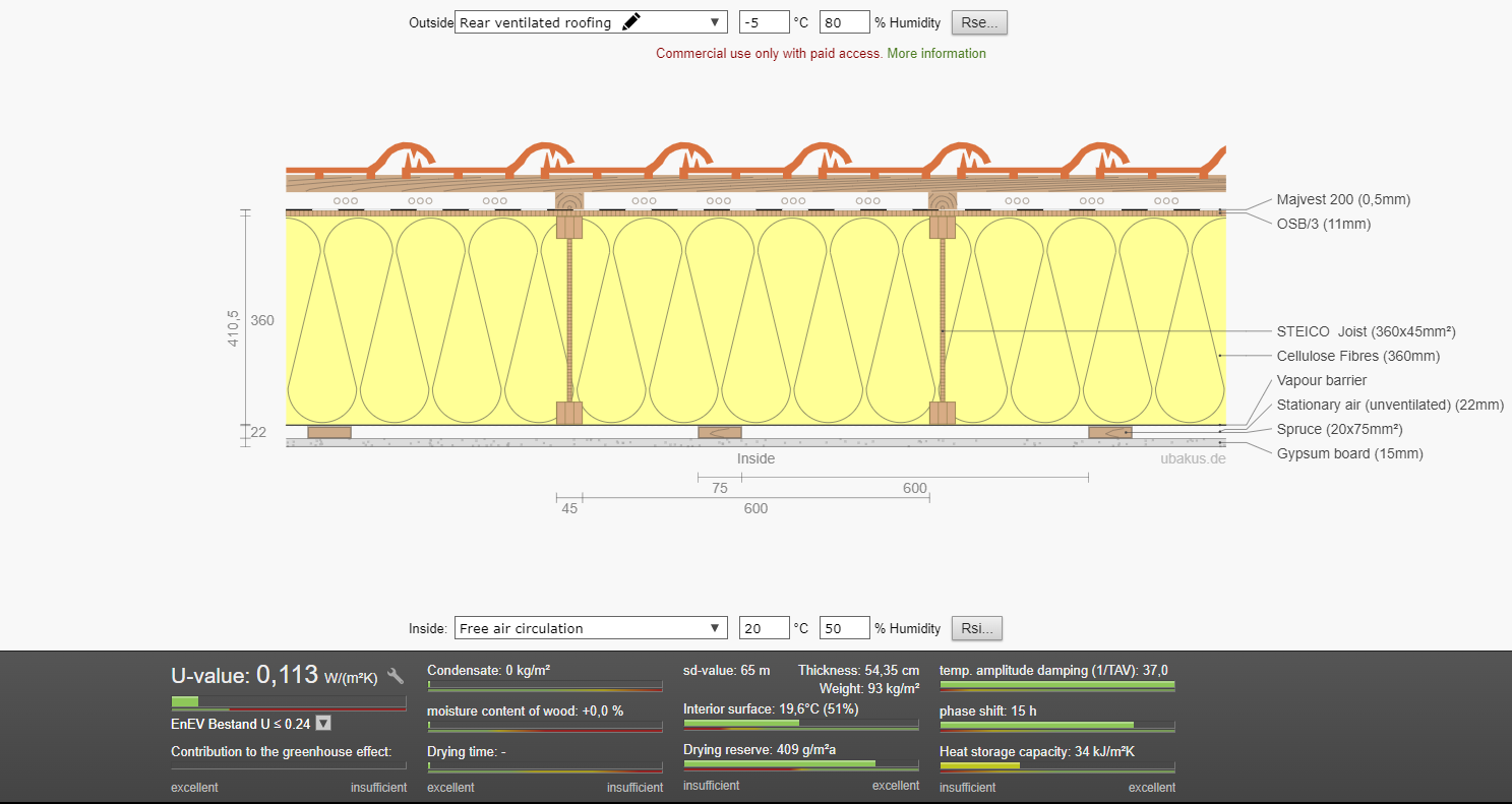

Iceverge Posted April 7, 2022 Share Posted April 7, 2022 I joists + Dense Pack Cellulose Cellulose is about €100/m3 inc VAT installed near me. If there's something better for heat protection/ cost/ sound protection / airtightness/ VOC's/ carbon/ mess/ ease of install I'm yet to hear about it. 1 Link to comment Share on other sites More sharing options...

oldkettle Posted April 8, 2022 Share Posted April 8, 2022 19 hours ago, Iceverge said: I joists + Dense Pack Cellulose What is holding all this cellulose on the inside? This image seems to only show vapour barrier which is probably not strong enough? Link to comment Share on other sites More sharing options...
Iceverge Posted April 8, 2022 Share Posted April 8, 2022 (edited) 10 minutes ago, oldkettle said: This image seems to only show vapour barrier which is probably not strong enough? A good vapour membrane stapled and pinched between SC battons and Rafters would be quite capable. I reckon if you were careful you could lie on it yourself! We have 400mm Above ours and it's fine. They regularly use netting in the US which looks infinitely more flimsy. I think @Nickfromwales has some cellulose contacts from memory. Edited April 8, 2022 by Iceverge 1 Link to comment Share on other sites More sharing options...
oldkettle Posted April 8, 2022 Share Posted April 8, 2022 7 minutes ago, Iceverge said: A good vapour membrane stapled and pinched between SC battons and Rafters would be quite capable. I reckon if you were careful you could lie on it yourself! We have 400mm Above ours and it's fine. They regularly use netting in the US which looks infinitely more flimsy. I think @Nickfromwales has some cellulose contacts from memory. This is impressive - I was sure OSB or similar would be required. So to be absolutely sure: 100/m3 at 400mm means it's £40/m2 installed? Or is it in Ireland since you quoted euros? Link to comment Share on other sites More sharing options...

Iceverge Posted April 8, 2022 Share Posted April 8, 2022 (edited) 2 hours ago, oldkettle said: So to be absolutely sure: 100/m3 at 400mm means it's £40/m2 installed? Or is it in Ireland since you quoted euros? We paid €28 +VAT for 400mm for a cold roof in 2020 per m2. That's €70/m3 +VAT /m3. It's probably increased a bit and I can imagine the labour for dense packing between rafters might be a bit more. Edited April 8, 2022 by Iceverge 1 Link to comment Share on other sites More sharing options...
