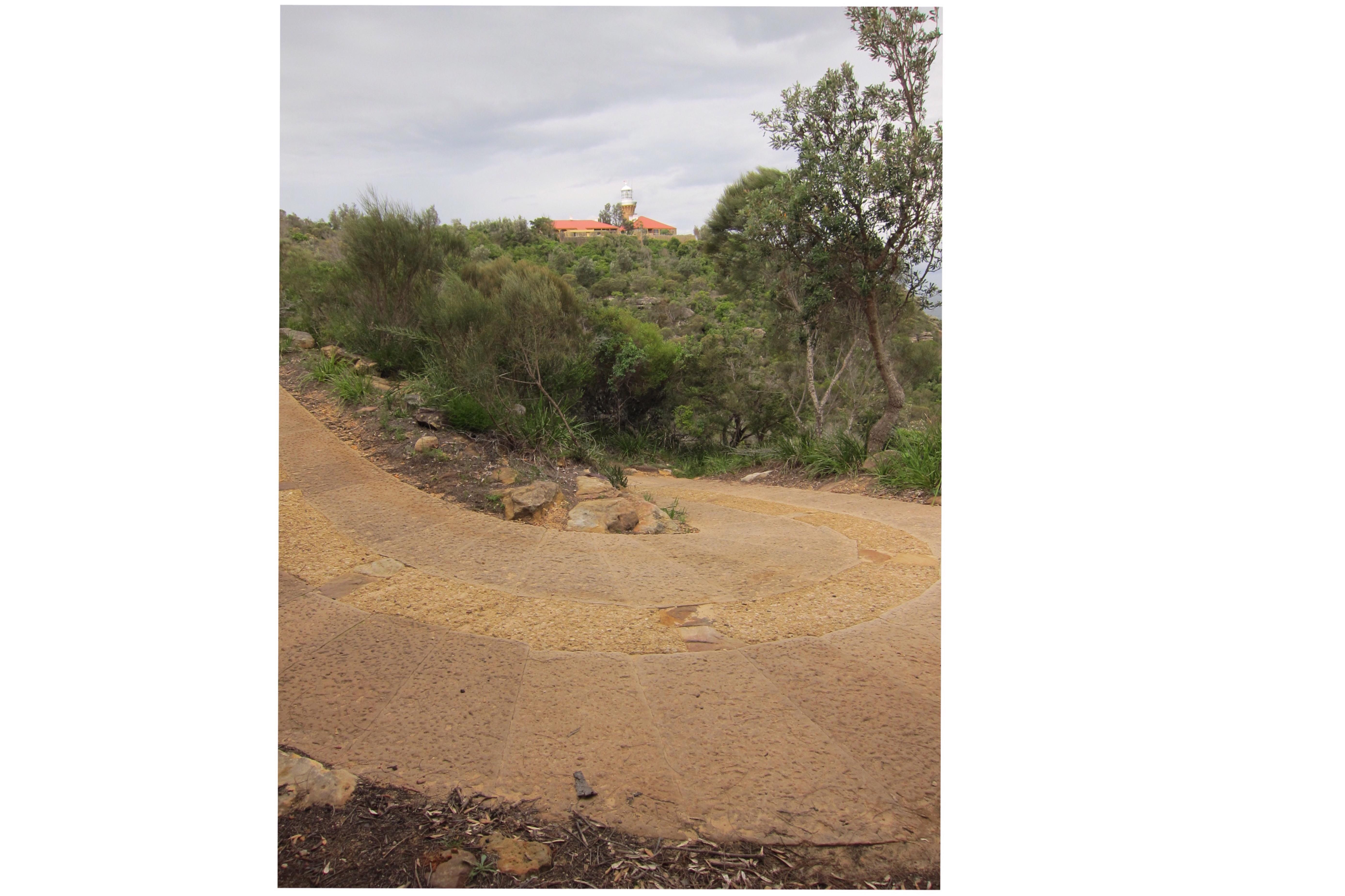

Cpd Posted March 27, 2022 Posted March 27, 2022 I guess your going to be constrained by the SE but what about filling the trench with stone as you have suggested and then trying to acquire some large cut stones to lay dry on top of this instead of blocks, when I built a road in Australia I used over one ton sandstone blocks purchased from a local quarry, they worked out very cheap for what they were and will be there is a few thousand years. Tightly fitted they will go nowhere and if absolutely necessary you can join them in the middle with stainless steel rod, the stones I laid were just put down on a crushed stone bed and laid without mortar between the joints (there is mortar in the middle of the track but it’s not structural to the outer stones, just there to “look” like loose crushed sandstone) these stones were aprox 1200mm long x 600mm wide x 250mm deep. The road was full designed by a structural engineer to closely resemble my design. 1
